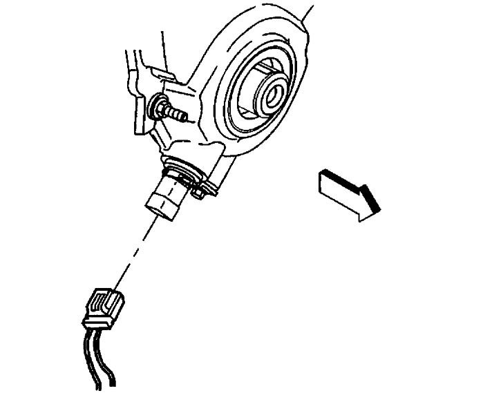

It could be a crank sensor. That controls both spark and the fuel pump.

I replaced the crankshaft sensor yesterday, she still cranks over but will not start.

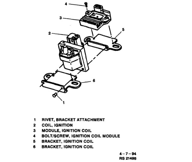

There is a control module by the ignition coil. It could be the issue.
What I suggest is to remove it and take it to a parts store and have them test it. That is a free service.
The Ignition Coil Driver Module is mounted on a bracket next to the coil. The Vehicle Control Module (VCM) signals the Ignition Control Driver (ICD) to turn "ON" primary current to the ignition coil by pulling the Ignition Control (IC) line high (4 volts). The IC turns the primary current "ON" and "OFF" by applying and removing the ground to the primary winding at the appropriate time. This module is of 'minimum function" and does not contain backup calibrations that would allow the engine to continue to rim if the IC signal is lost.
Sunday, August 12th, 2018 AT 5:43 AM

I replaced the coil driver yesterday and cleaned up the aluminum heat distribution plate it is mounted to. She still will not start. Rechecked the distributor, rotor, and pick up while I was in that area.
I spent a few hours going over the fuse pannels and wiring harness looking for faults and shorts, I even pulled the steering wheel cover off and checked the ignition leads, and everything looks normal.
I am starting to get a bit frustrated, I have not kept track on how much I have put into this, but it is getting near the $400.00 mark and still not working.

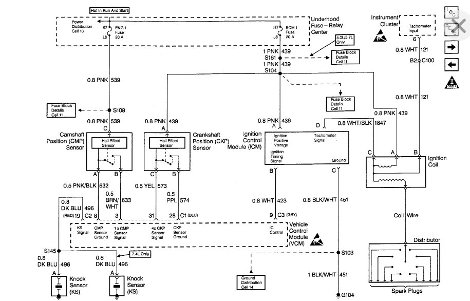

Okay, take the test light and with the key on. Check the power to the pink wire. If you do, then check for power to the white/black.
If you have both powers, crank the engine and see if the white/black flashes while cranking. If it does, then it may be coil. If it does not it could be either the module or the crank sensor or wiring.

Here are the test results. Tried it with both the new and old PCMs I could not find a white/black, but I did find black/white.
Black connector - pink strong signal - black/white weak signal.
Blue connector - pink strong signal - black/white strong signal.
Red connector - pink strong signal - black/white no signal.
White connector - pink no signal - black/white strong signal.
No "pulsing" however, the test light did dim during the cranking, likely from the draw on the battery
results the same for both PCMs.
