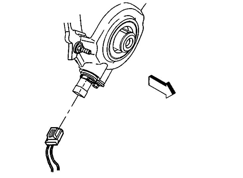

I got the OBD II reader from NAPA, only one stored code P0122=Throttle/Pedal position sensor/switch "A" circuit low.
And all the Live and I/M Readiness readings. Wrote them all down, what are you looking for?

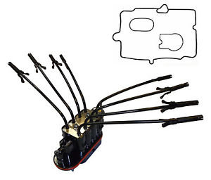

Sorry to bother you Roy, I cannot seem to find any way to test a CSFI system with a noid light.
Could you send me some reference or guides?
Sep 11, 2018 at 8:37 AM
Does this have eight injectors or just two on the throttle body?
Sep 11, 2018 at 8:41 AM
KEITH LOTHROP
  • 46 POSTS
8 poppet valves in a CSFI.
Sep 11, 2018 at 4:41 PM
Okay, that system you cannot check with a noid.
Do you have a full blown scan tool that can read live data for the injectors?

Back when the no starts began I poured a bottle of Lucas fuel system cleaner into the tank (about half full, fifteen gallons) with all the cranking over and allowing her to sit afterward, maybe it loosened something up. From what I have read, black smoke, some uneven idle, a few backfires, and no start are all signs of a bad fuel pressure regulator. What is your opinion?
Sep 16, 2018 at 5:36 PM
Good morning.
First of all never, never ignore inactive codes. They could be a clue. Erasing them was a big mistake because they contained vital freeze frame information.
What O2 code? O2 codes do not mean the sensor is bad at all.
What was the fuel pressure?
Yes, it could be the regulator but it is part of the spider.

Well Roy, she is starting right up just like always, but she is showing all of the tell-tale signs of a bad fuel pressure regulator.
I am going to start driving it into work again today, praying it gets me home again.
NAPA wants $65.00 for a new fuel pressure regulator. I have found some online for as low as $15.00, but it is going to be a pain in the backside to replace. I am going to stick with the ACDelco when I do it I will let you know what happens, so you may help others later on.
