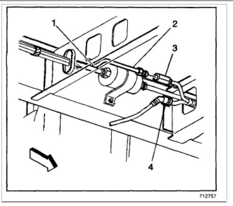

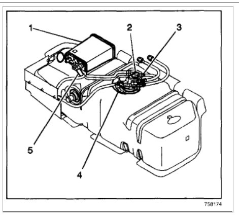

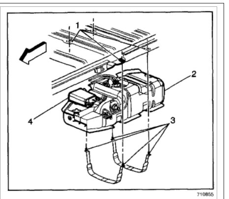

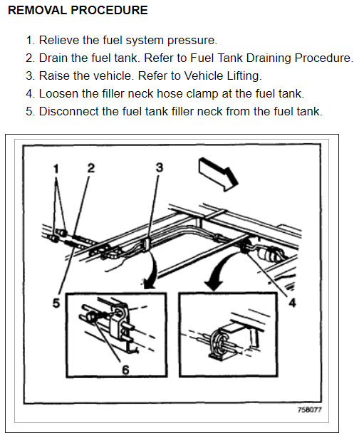

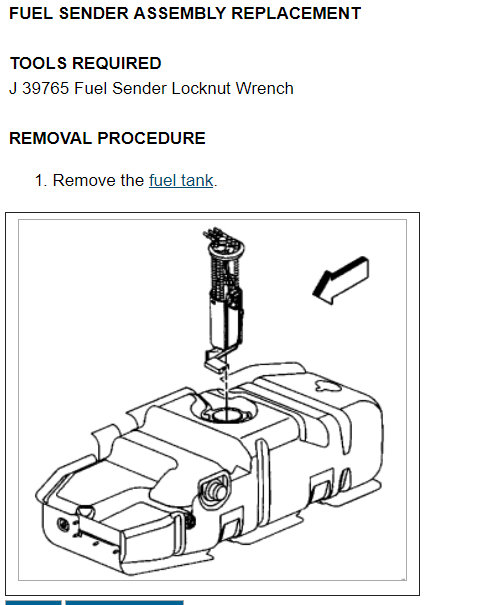

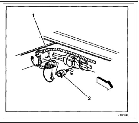

It looks like my pump is bad, no fuel pressure. How do I replace it?
Saturday, October 20th, 2018 AT 4:43 PM (Merged)
SATURNTECH9
  • 30,869 POSTS
Yep I thought so. Here is a guide that can help you see what you are in for when doing the job
https://www.2carpros.com/articles/how-to-replace-an-electric-fuel-pump
Here is what it will be like on your car.
Cheers
