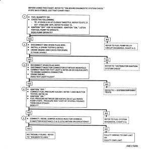

Starting problems/doesn't stay running. Some days will start run for 4-5 mins then shut itself off cannot drive.
New parts by self or mechanics: distributor assembly, egr valve throttle position sensor, fuel pump, fuel pump relay, plugs, wires, coil
Fuel pressure 60psI at stop 58psi and holds Only code was 32 EGR and replaced it. Fuel injection unit was replaced 70 thousand miles ago.

Since powertrain management seeks to maintain or reduce emmisions, it will set codes that find something in error and is using other sensors input data to make changes to try to manage a problem. It then would set a code or codes for any incorrect data. Since the EGR code is gone and the no other codes exist, it takes us to a mechanical scenario rather than management. At least it is how I see it.
So I would think either weak spark or too much fuel as you say. Sice the CFI fuel pressure is good, I would lean towards spark or poor compression.
https://www.2carpros.com/forum/automotive_pictures/30961_nost_1.jpg

Hoping to get to the compression check on sat that left bank of plugs are a treat to get in and out. I seen you listed a ladder chart for testing, couldn't read it by the time I zoomed it up where it was readable it was to blurry. Maybe do it to silkplantplace@means. Net

I have more charts if needbe. YEah, the left side plugs are an engineering feat. Otta hang that bastard that approved that one.
I sent the diagram. To your email

So compression readings are all between150-154 psi. All plugs fouled #3 dripping wet.
Off for new plugs, will clear codes and start, re- test codes.
Thanks for the sentiments on the plug access factor a new 1" hole now exists threw the lower dog house rim allowing access to # 5 plug with 3/8 drive tools. Under the rug it's out of sight. Tired of the hassle.
Meanwhile what's causing the gas overload?
Ok back together now, no start, next step 5oz gas down intake turn over starts runs until gas fumes run out
I 'd say we are at step 4 on chart. I need to see if the light flashes. On step 5 I first tested 4 ohms charts states there should only be 1.6, will retest

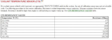

First two things on too much fuel is a bad fuel pressure regulator (but the spec is good..eliminates that) and a bad coolant temp sensor.
https://www.2carpros.com/forum/automotive_pictures/30961_cts_2.jpg
I would have thought a code for it would set, but it says here it may not.
