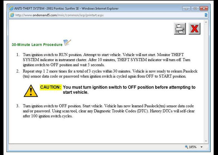

I put van in revers went 20 ft. And it just died instantly tried. To start it. But will not start. I noticed the security. Light on.
I tried unhooking battery. To reset but stiil not starting. I got a new key from dealship because old one is really worn. Still not starting. Van has 8 gal of fuel. I desperately new van for work can you please advise. Thanks
Saturday, October 20th, 2018 AT 4:42 PM (Merged)
HMAC300
  • 48,601 POSTS
See pic for resetting security.

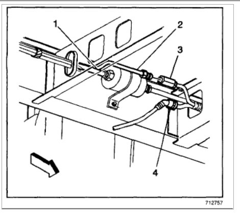

MARK STEVENSON
  • 6 POSTS
I just replaced the fuel filter and I've never seen fuel so dark. It was very hard to blow through the filter. How do I get my vehicle running now.
