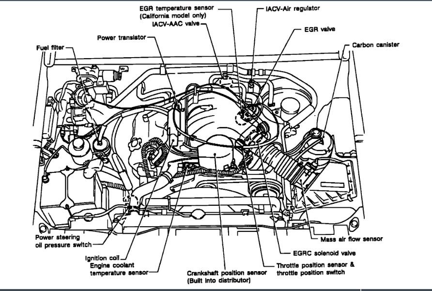

Thank you for the information it made my day. Can you tell me if the coil is inside the distributor?
Sep 23, 2018 at 10:45 AM
It is external. Follow the coil wire in the center of the cap to the other end.
Picture attached.
