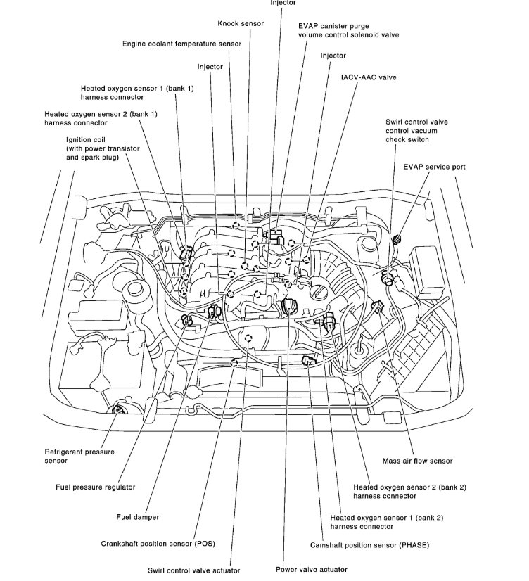

I have a SE with 245,000 km, V6 3.3L and all of a sudden it would not start, only intermittently.
When I just turn the key it cranks but will not start.
When I press the pedal down full and then try to start. it cranks and seems to want to start but then does not.
I checked:
- spark plugs and there is a good spark.
- for two to three seconds of whining of fuel pump when key is turned 3/4 prior to trying to start.
- fuel tank is full.
- fuel lines seem to be pressurized?
Any idea what it could be?

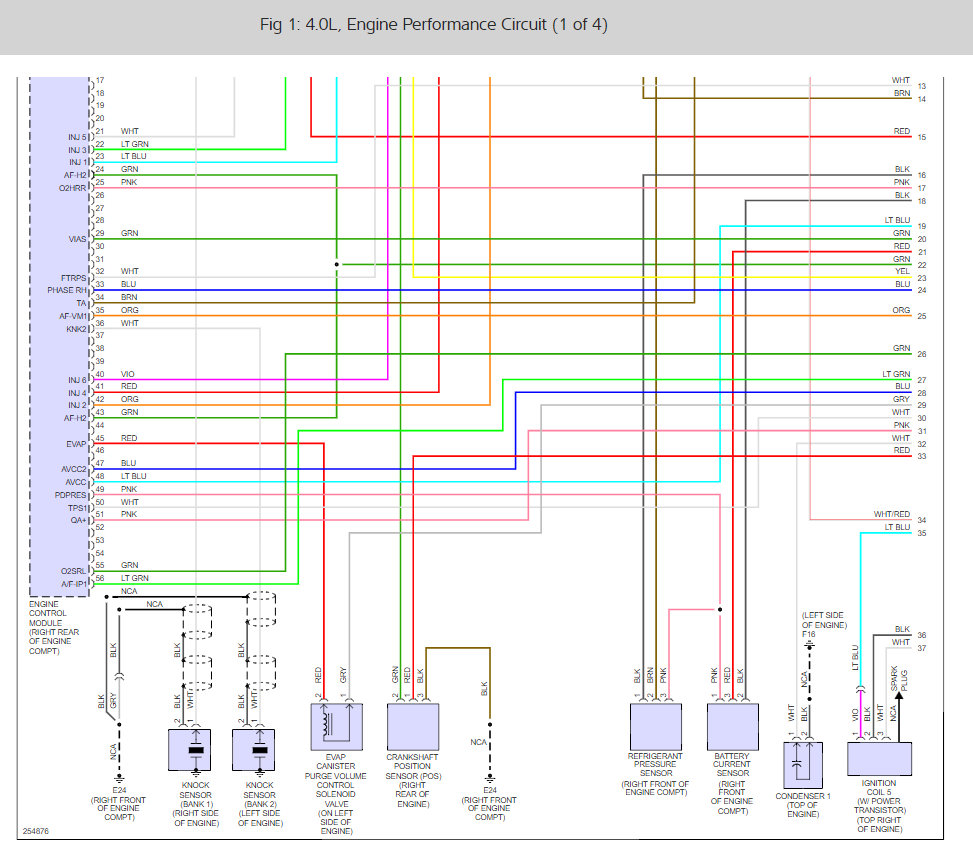

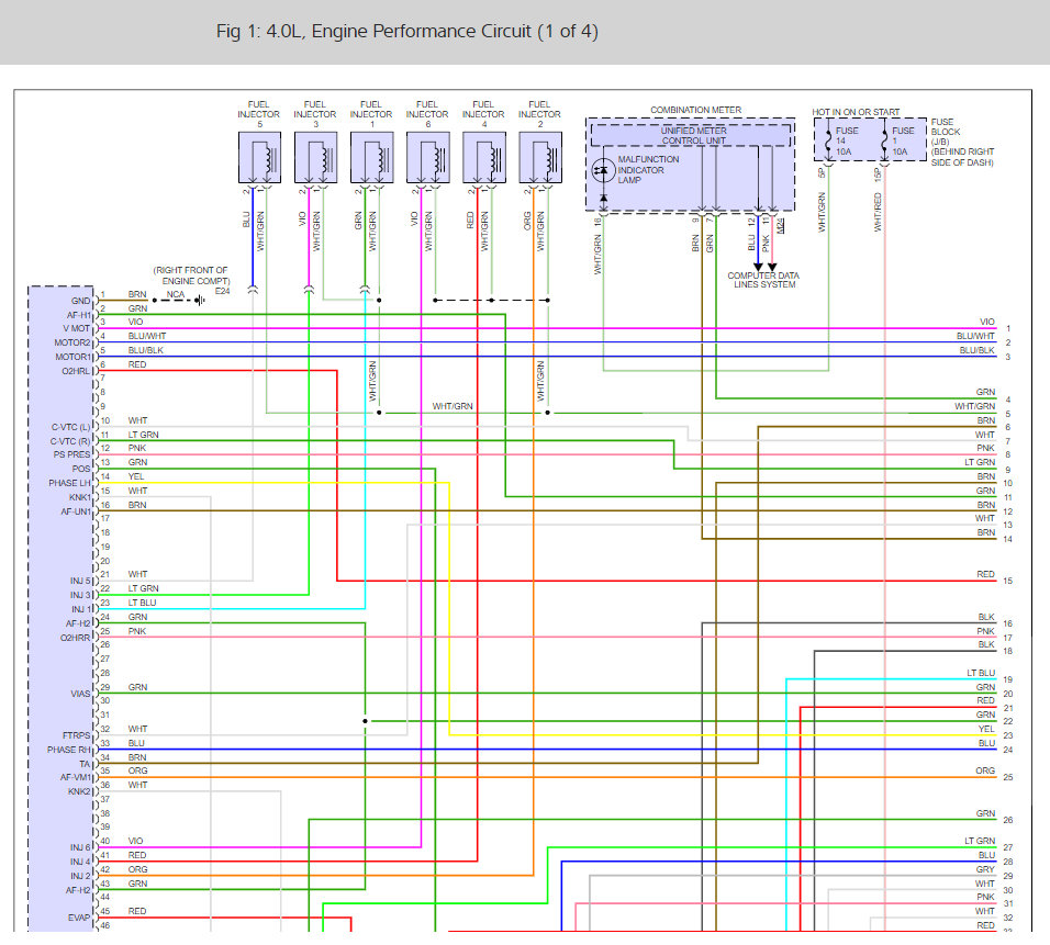

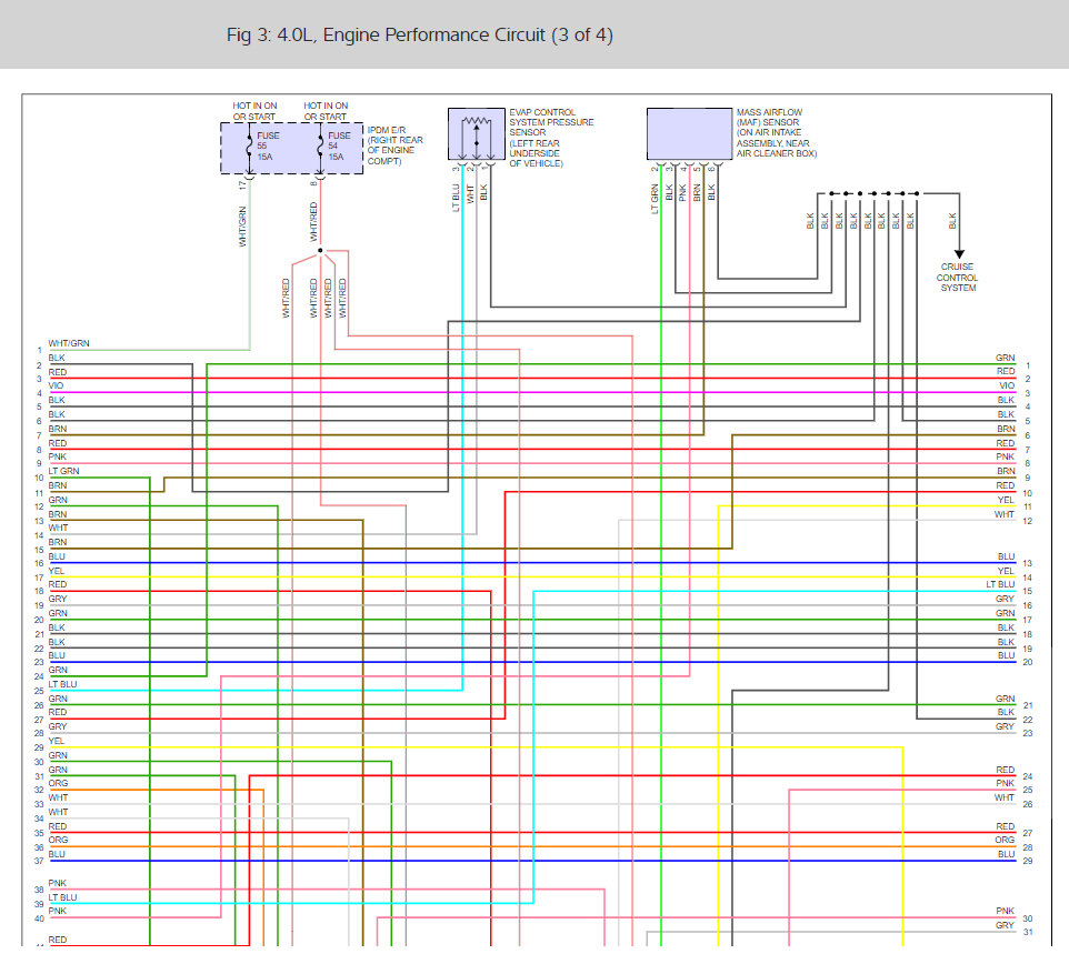

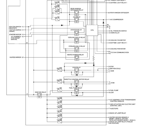

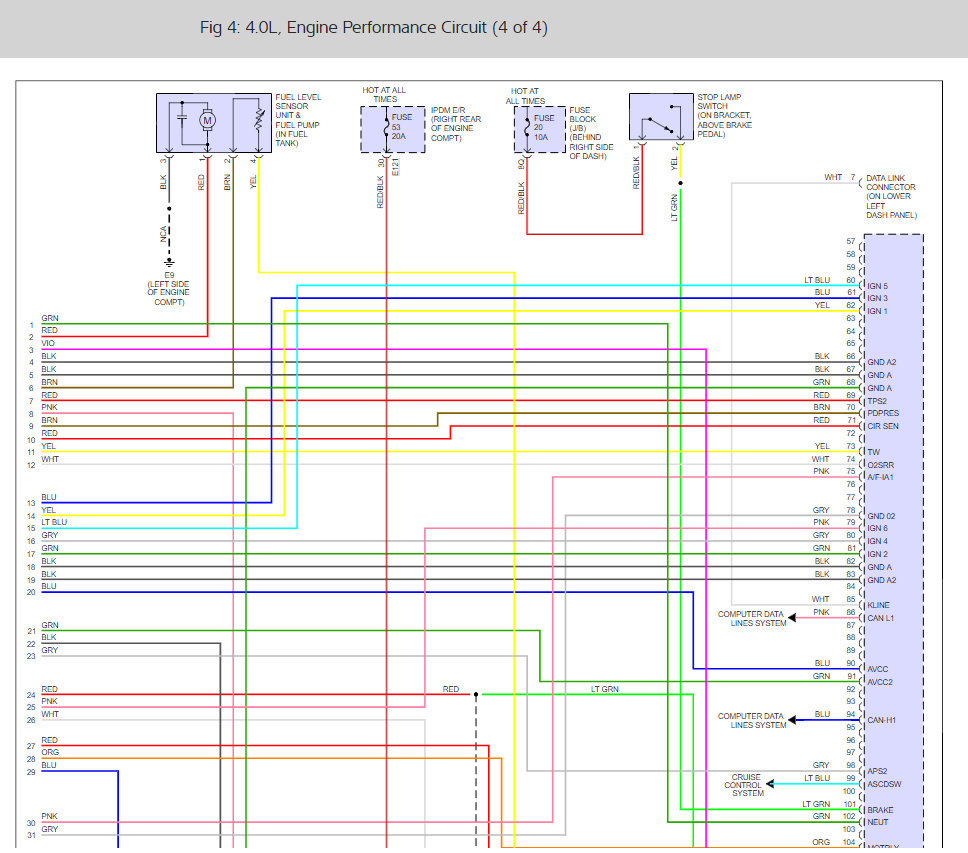

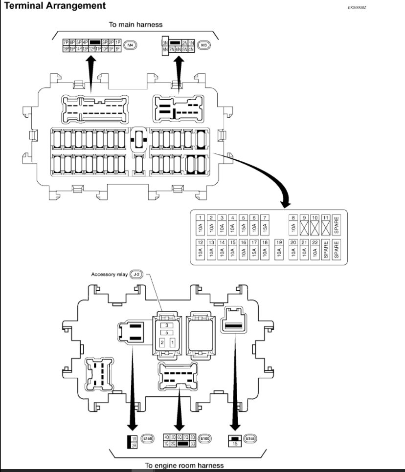

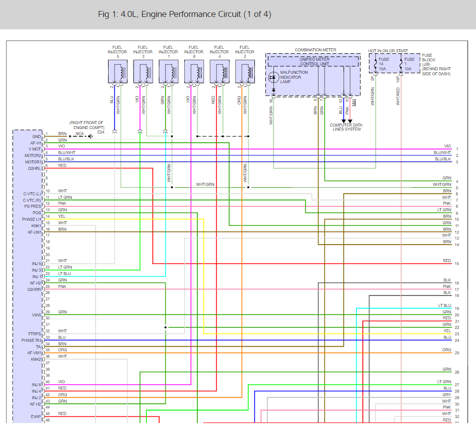

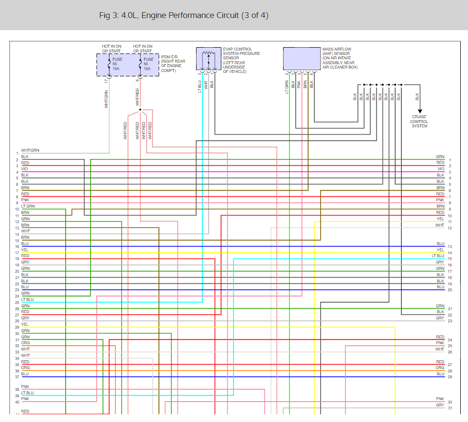

You need to check to see if there is injector pulse. I have a feeling you may have an ECM that is out or a fuse that is blown. Here is a guide to help you with checking the injector pulse:
https://www.2carpros.com/articles/how-to-test-a-fuel-injector

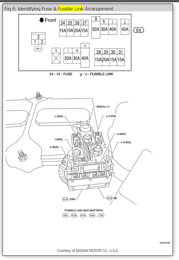

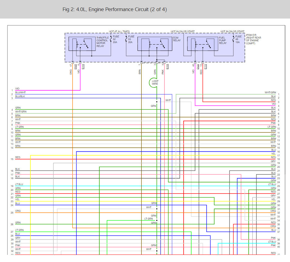

Here is a guide to check the fuses. There is an injector fuse # 55
Plus a load of others including# 1, 14, 48, 52, 53, 54
Check out the diagrams (below) I have found the engine wiring so you can see from yourself the fuse configuration.
Please run this test and get back to us so we can keep helping you.

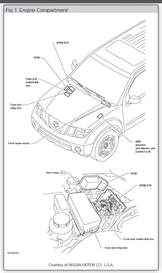

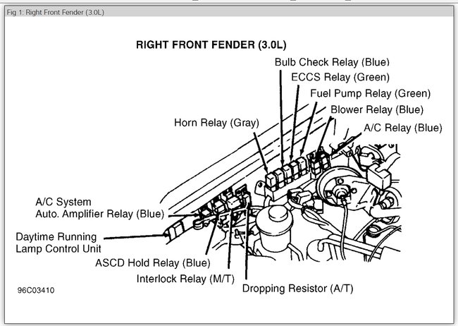

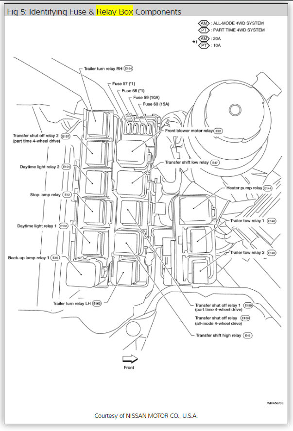

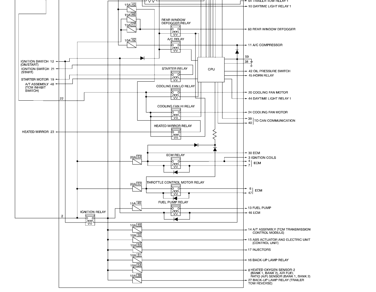

The problem was the relay for the fuel injectors was not working properly, so by changing the relay it solved everything. That is why no fuel was getting into the cylinders.
Thanks all for your help. Hope this helps someone else.
From Ken: The location of the relay in the post below
Jun 27, 2007 at 1:51 PM
DAMIEN SHRIMP
hi pathfinderrs, I am having the some problem you were having when I read through this when I see how you fixed it. I went looking for that relay on my pathfinder but could not find it anywhere so could you please tell me where about is the fuel injectors relay? I have a 2001 pathfinder.
Aug 31, 2016 at 8:14 AM
  • CERTIFIED EXPERT
  • 53,872 POSTS
Hey Damien,
Yes, I got you covered and found this for you.
Please let us know what you find so it will help others.
Best, Ken
Nov 29, 2016 at 12:00 PM

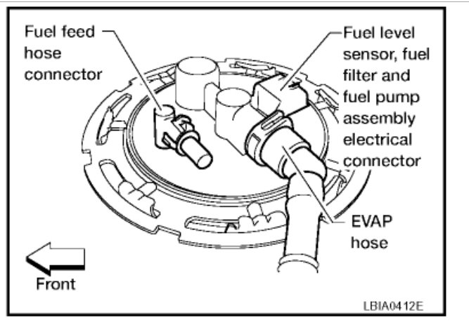

My 1996 Pathy has the same problem. But each time I put in a new Fuel Pump Relay it starts right up, but it wont start after an hour or more. Just cranks and won't fire or even try to turn over. Could it be clogged catalytic converters?
Oct 2, 2017 at 3:14 PM
  • CERTIFIED EXPERT
  • 53,872 POSTS

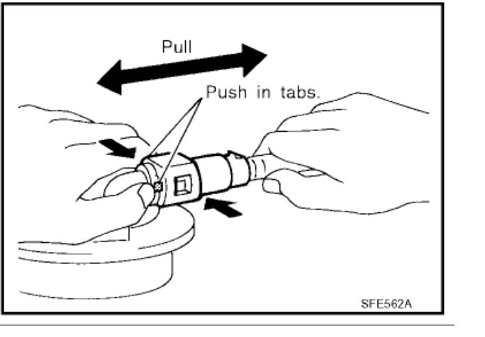

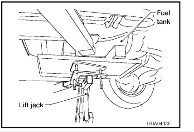

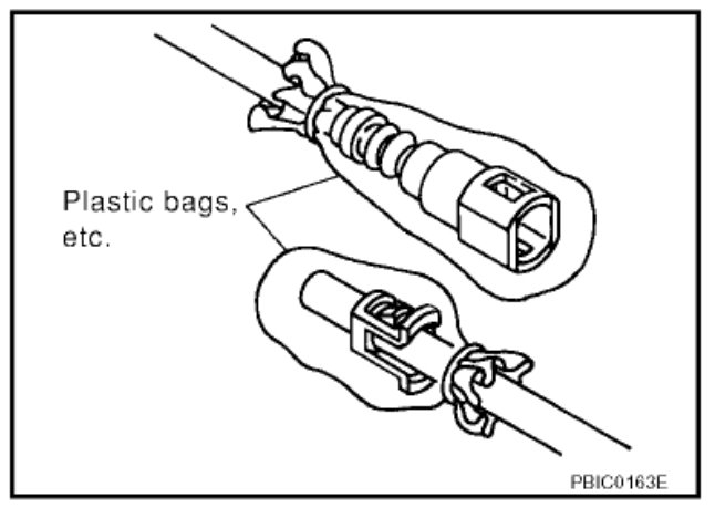

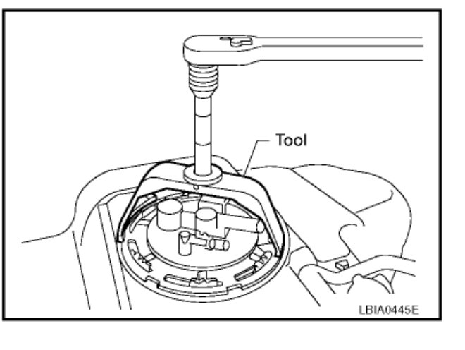

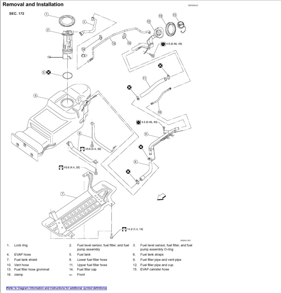

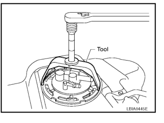

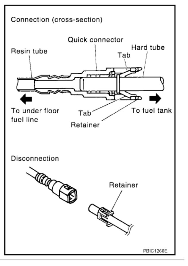

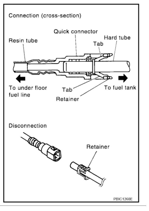

It sounds more like the fuel pump is going out. When the engine does not start lets check the fuel pressure
Here is a guide to help you see what you are in for when doing the test.
and if weak here is a guide and some diagrams (below) to show you how to change the pump out.
https://www.2carpros.com/articles/how-to-replace-an-electric-fuel-pump
Please let us know what happens so it will help others.

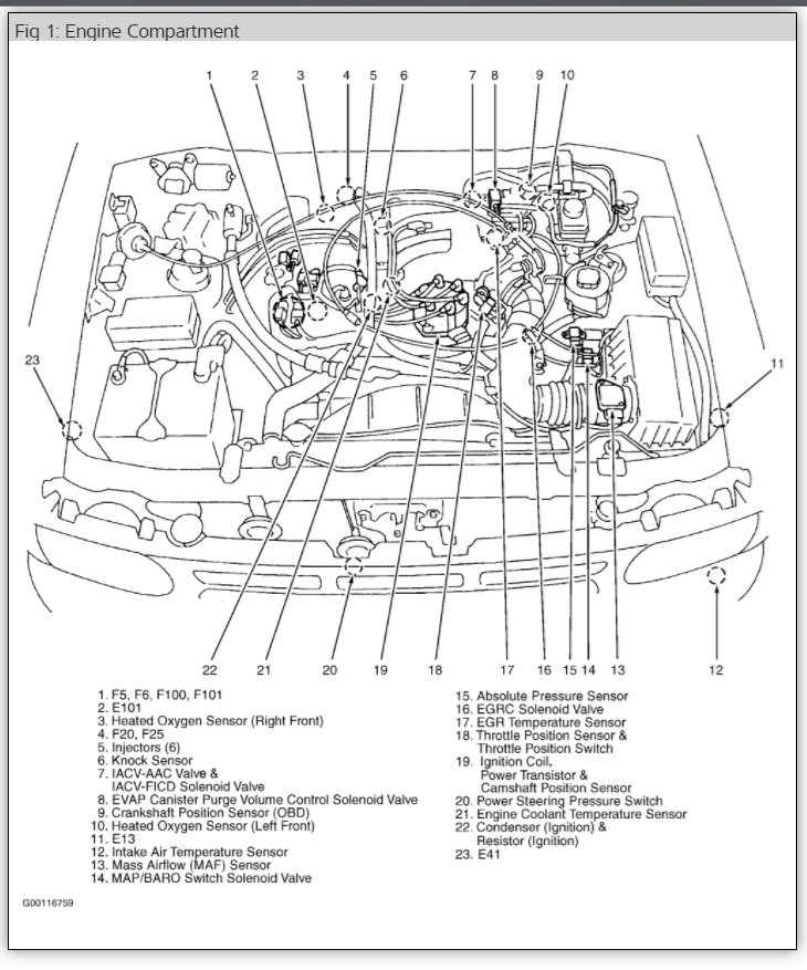

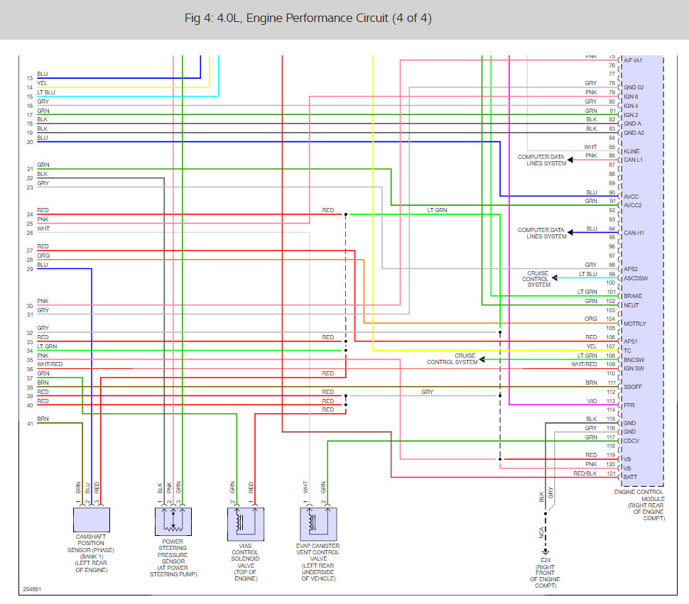

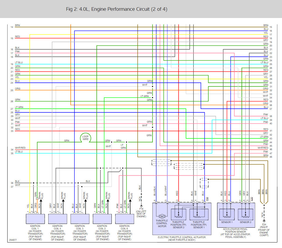

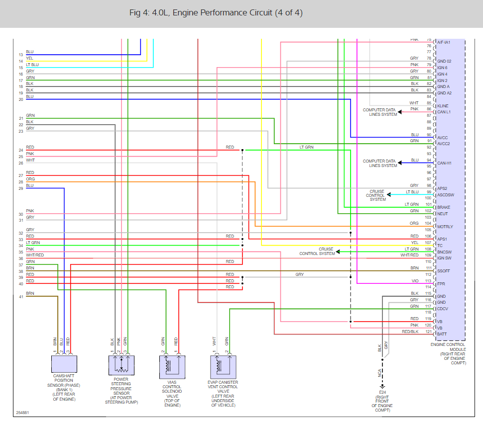

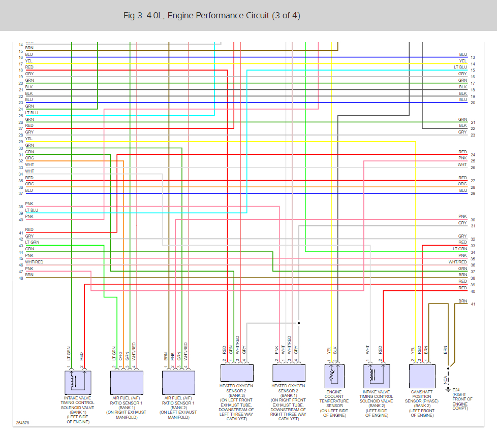

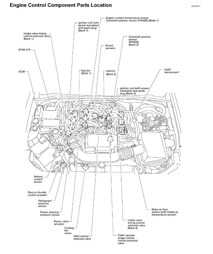

This sounds like a crankshaft angle sensor that has gone out what year is your car so I can get you diagrams?
Oct 9, 2017 at 10:06 AM
SAVANNAH WEST
Hi Ken, it's a 1999
Oct 11, 2017 at 11:54 AM
  • CERTIFIED EXPERT
  • 53,872 POSTS
Okay here is a guide that will show you what you are in for when doing the job.
Here is the location for your car (below)
Please let us know what you find. I'm interested to see what it is.

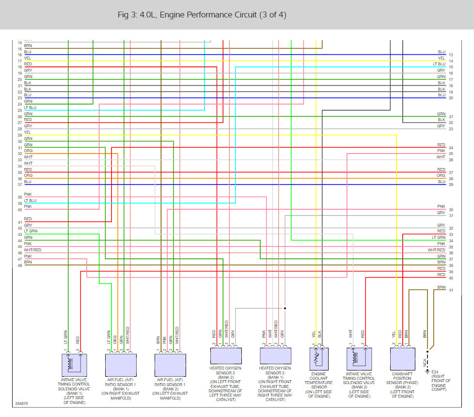

I have a 2002 Pathfinder Ti and have intermittent start but only when the car is hot, Have had a new fuel pump put in plug fuel filter, new crank sensor and had new spark plugs put in but it is still doing it. I am about ready to trade it in
Nov 1, 2019 at 10:25 PM
  • CERTIFIED EXPERT
  • 53,872 POSTS
I have nsee the engine coolant sensor short out "hot" causing the engine not to start we should run the codes even though it may not pick up this problem. Here is the location of the coolant sensor so you can check it out. (rear of the engine)
