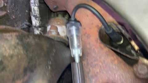

So I was able to do a little checking, after finding, cleaning and re-attaching the core support ground( I even ran an extra one in case it needed some extra love), the shorting or I guess you call it an open ground circuit, that was observed by pulling positive post off battery and connecting 12v test light to the post and other end to the terminal, the only fuse that had any change was #9, IGN/BATT, and it would get very dim but not go completely out. We went away after redoing the core support ground. The only DTC code at the time was TPS sensor, which has been there since this problem started, even though I’ve put two different new ones in. Gave it a crank and ut basically just cranked. I can smell fuel, pulled three plugs from passenger side (2-4-6) and they were wet with gas. Now it gets interesting, # 4 plug was didn’t show me any spark, #2&6 did then come to find out the plug in 4 was cracked, ok I’ll accept that I probably over tightened it. I have some videos I’ll send also. While getting the video I noticed the plug in the #6 spot is arching through the plug boot I guess to the block, got a little footage of that and that kind of freaked me out because I never saw it before and plugs, wires, cap and rotor are new. Looking it up I guess it could happen because it’s a little wet there from the little bit of gas, but I don’t know. DTC code p1335 was added to TPS sensor and p1335 says crank position sensor however the guy I was working with here before you said that meant low voltage to ignition system & has me do voltage test for crank, ICM and coil, I’ll send those results as well as I haven’t heard back from him in a while and that’s totally fine, I appreciate any and all help !!! Then the storm came and shut me down again. So, to summarize, had fuel and spark (in 2 of the three cylinders checked anyway) but no ignition. I’m just getting going down here today (in Florida) and I’ll send the video and results from test done previously and anything else I can find to you shortly ok. Thanks B again man I can’t tell you how much I appreciate you input.

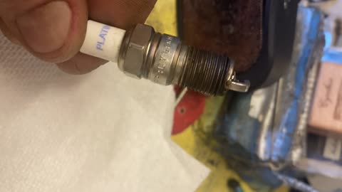

BRIAN333
  • 99 POSTS

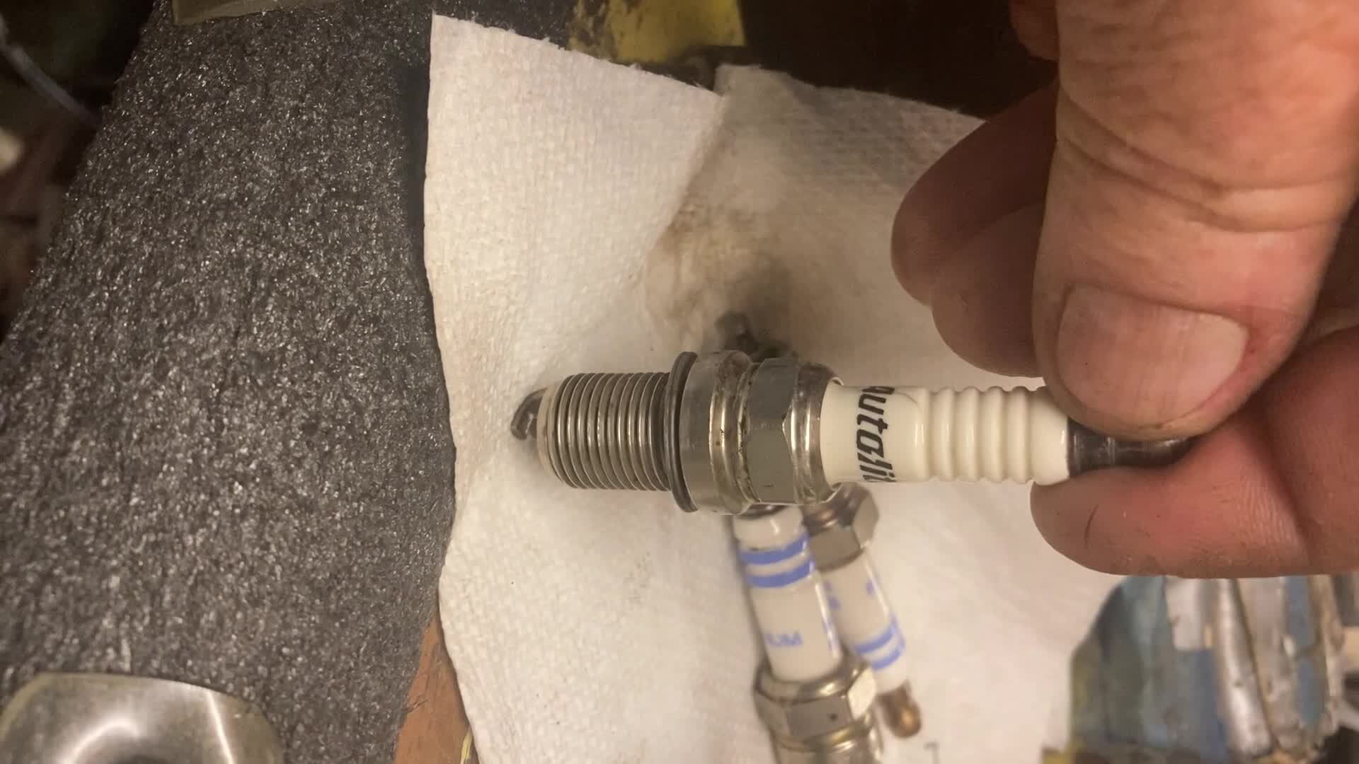

When I noticed the arching, I had a different set of plugs in than the new ones as they had all been pulled, this is the plug that had the arching, and I didn’t even notice it has a little bit of a crack in the ceramic.
Jun 9, 2023 at 1:13 AM

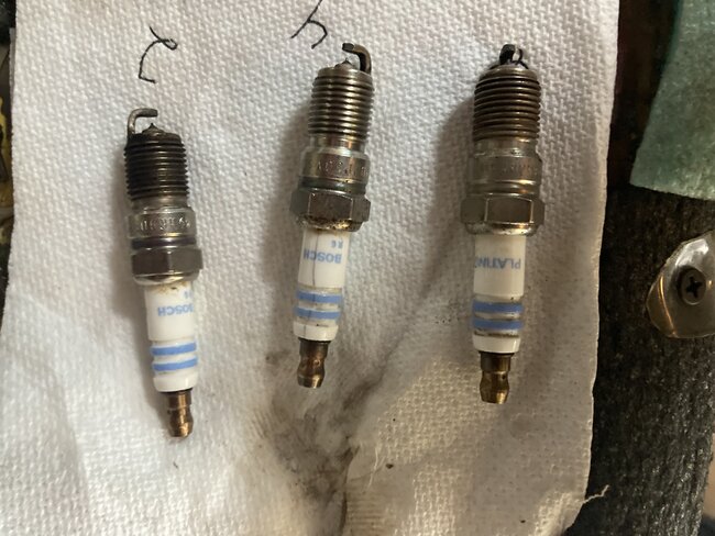

BRIAN333
  • 99 POSTS

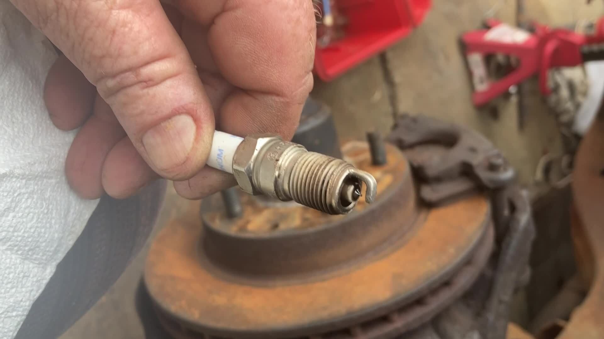

Cylinder #2 after I pulled it and pouring the gas out
Jun 9, 2023 at 1:14 AM
BRIAN333
  • 99 POSTS
#4
BRIAN333
  • 99 POSTS
#6
Jun 9, 2023 at 1:17 AM
BRIAN333
  • 99 POSTS
The plugs.

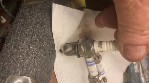

BRIAN333
  • 99 POSTS

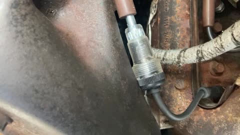

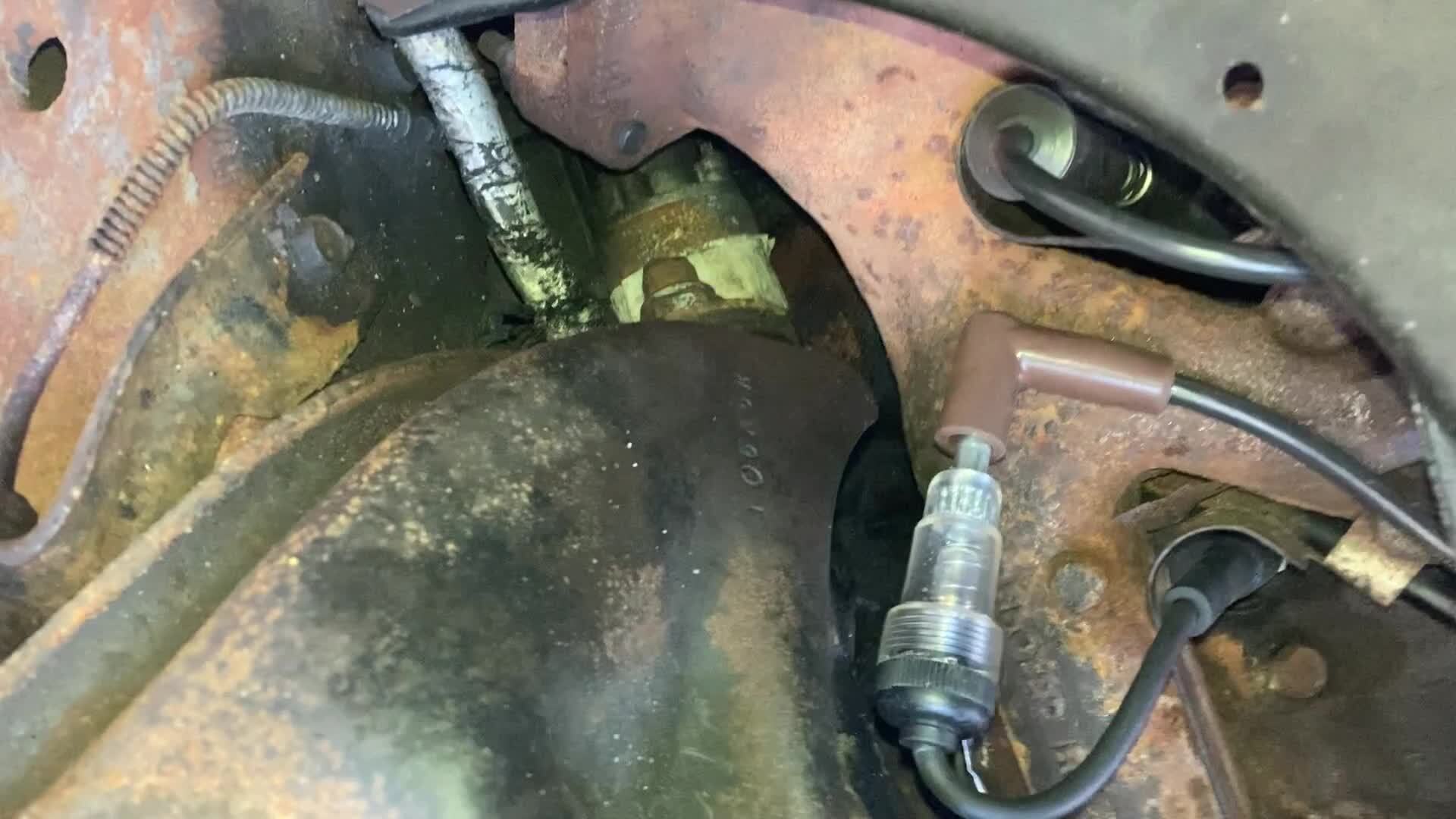

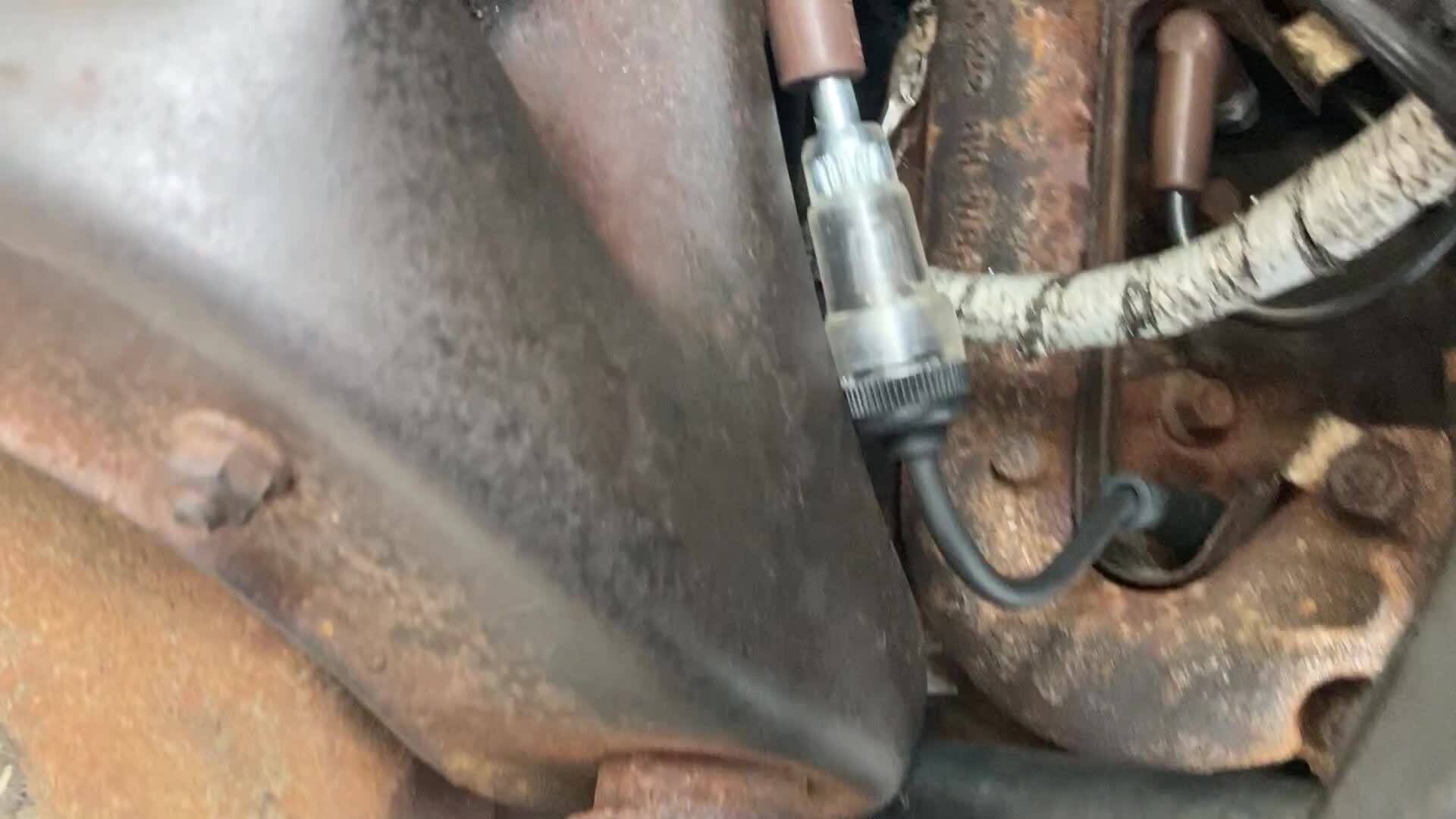

Spark test #2.
Jun 9, 2023 at 1:19 AM
BRIAN333
  • 99 POSTS

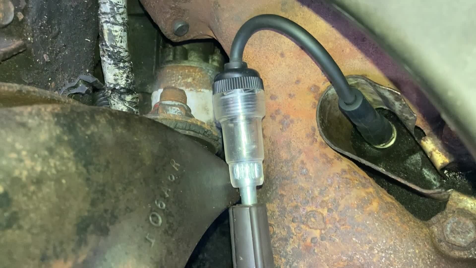

Spark test # 4, no spark, cracked plug
Jun 9, 2023 at 1:20 AM

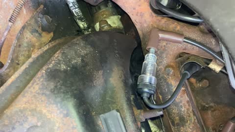

BRIAN333
  • 99 POSTS

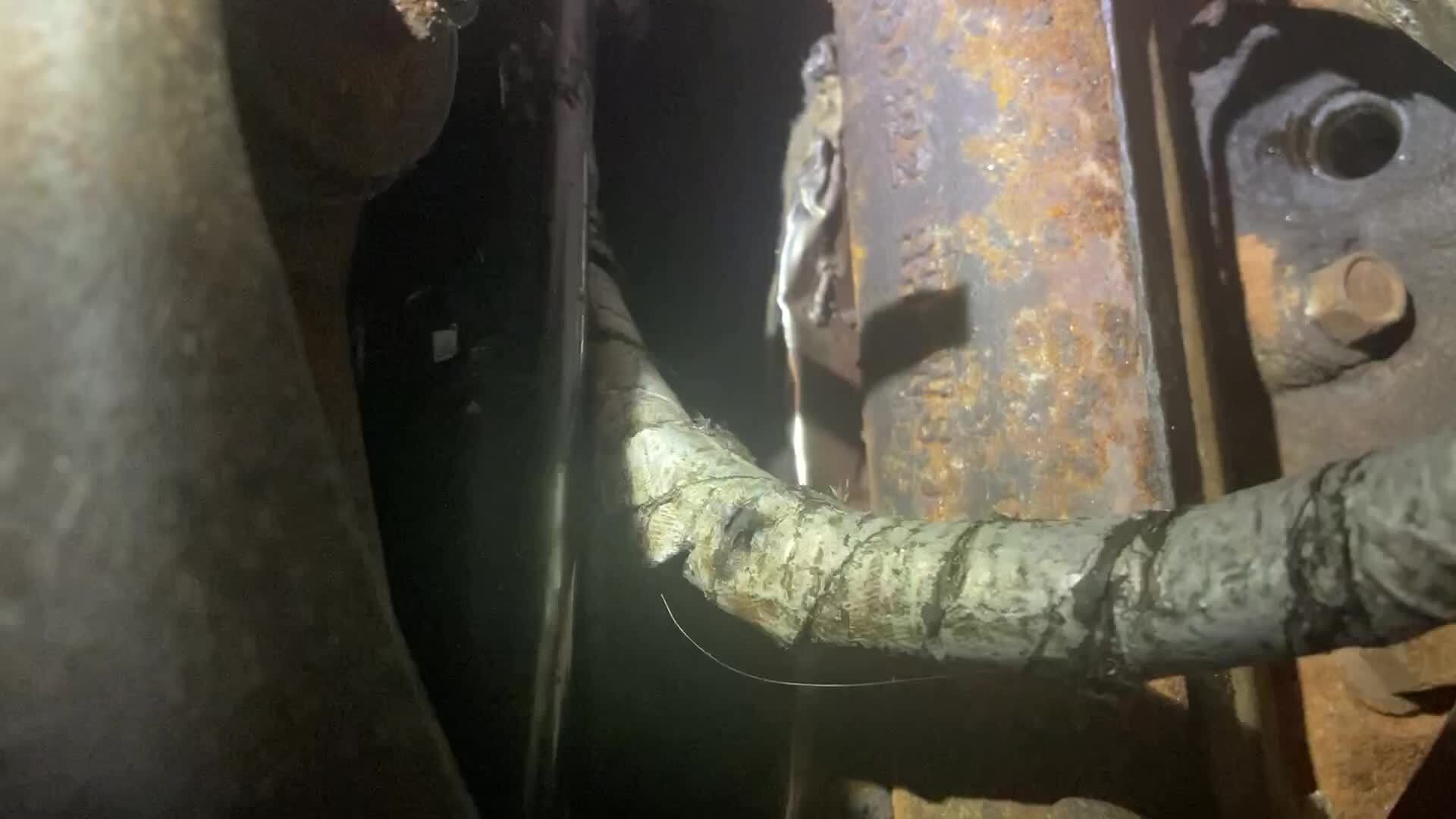

Spark test #6 you can see the spark go to the frame because it’s too close, sorry about that.
Jun 9, 2023 at 1:22 AM

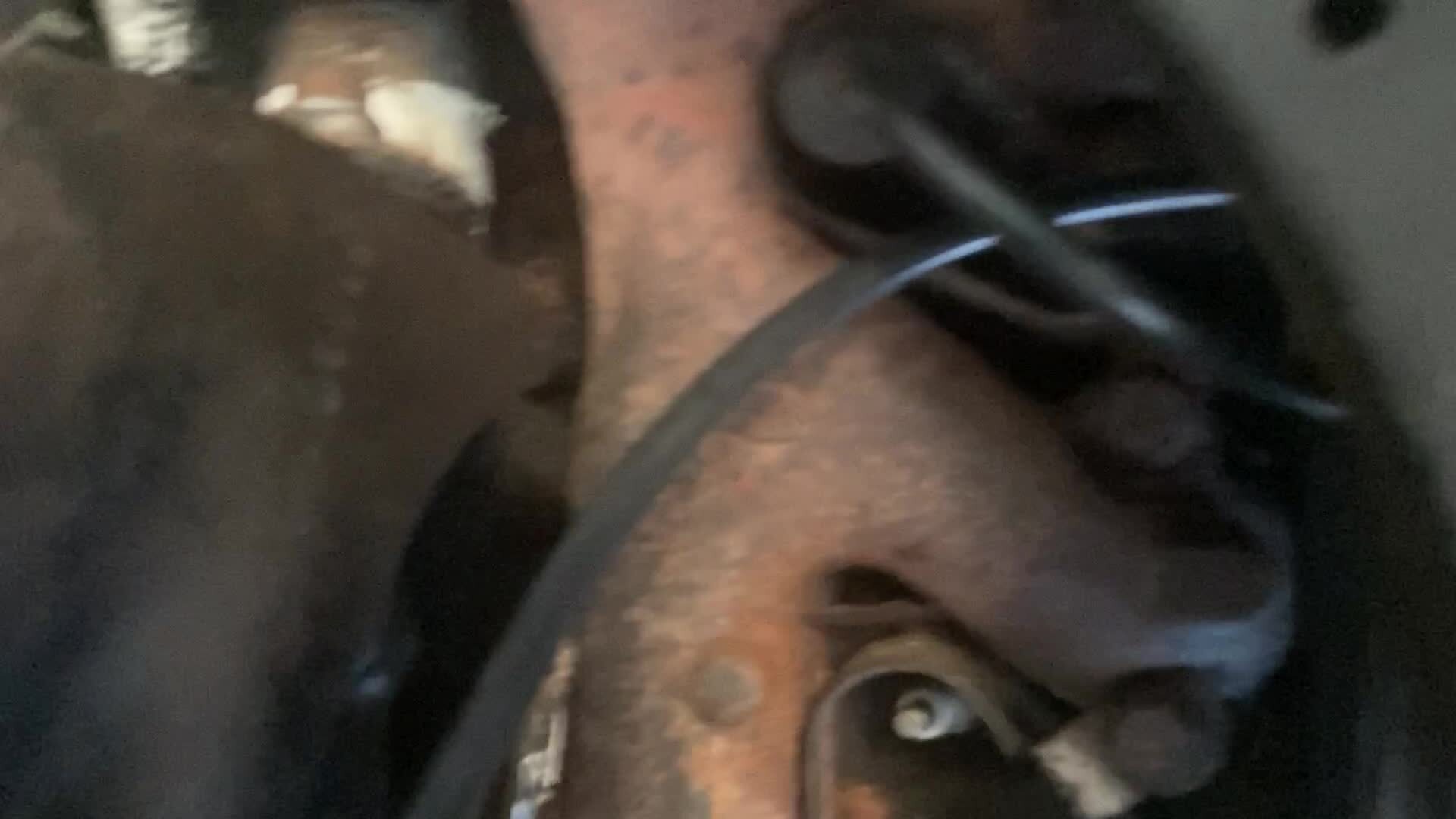

This is where you can see the arching in #6 with that Autolite plug in.

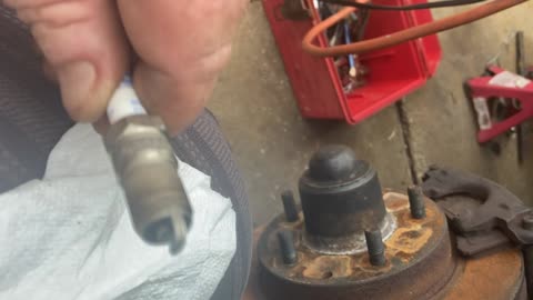

BRIAN333
  • 99 POSTS
This you can see the little bit of gas coming out plug hole, I think that’s 4 cylinder.
Jun 9, 2023 at 1:24 AM

Still waiting for the rain. LOL If you have that much fuel in the cylinder, either we have a leaking injector, a faulty regulator, or no spark. I watched the videos and am I correct in assuming the cylinder with the fuel leaking out had no spark? Was that the only cylinder like that?

The cylinder with no spark had the same amount of fuel as all the others. I guess I’m just realizing that I don’t know how much fuel would normally be in there because I’ve never pulled a plug and had fuel come out of them. If I shorted the videos to much or they didn’t have enough info just let me know and I’ll adjust, there is sound in all of those if you wanted to hear it cranking, one has the battery weakening but the others aren’t like that. They all have just about enough fuel to pour out of the plug after you take it out, or maybe it’s just that’s all it will hold, lol, sorry for the most part I usually am figuring some things out as I am saying or typing them, however no fuel pours out after removing a plug, that cylinder that didn’t spark(#4) did have the cracked ceramic on the plug and I'm hoping that’s why it didn’t show signs of firing. I didn’t retest the other side for the video. However, previous test showed all cylinders having what appears to be the same amount of fuel being injected. I'm guessing that would be more of a regulator problem, also wondering if said regulator would be cause for it to shut down while driving ? In reality it could have been a combination of things because I did have some ground wires that were concerning once I looked at them. I’ve never done the fuel regulator or injectors; any advice is surely appreciated. With that fuel being in the cylinders, do i need to do anything to clear it or will it evaporate with the plugs removed being good enough?
Oh yea, what do you think about the arcing in that one cylinder (#6)?

Okay, if the cylinder isn't firing and doesn't have spark but the others do, that takes me to the distributor. Is the cap in good condition? If you place your spark tester right at the cap, do you get spark for that cylinder?
