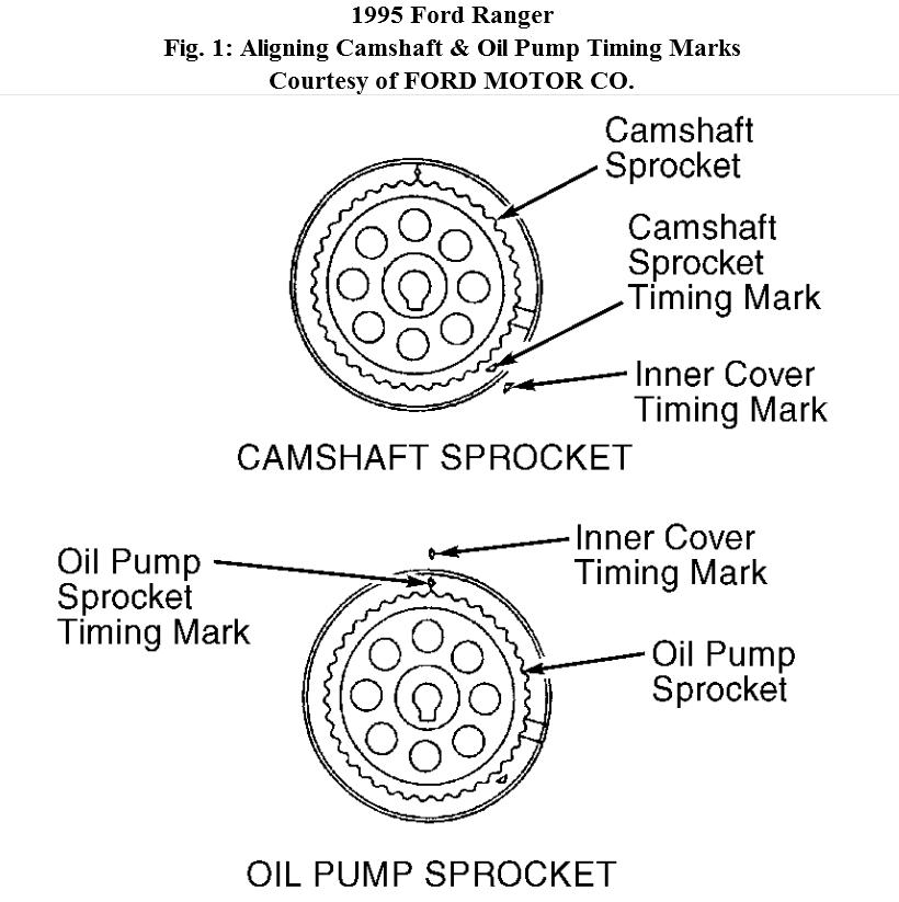

I have a 1992 ford ranger distributorless ignition 8 plug 4 cylinder I have installed the head from a 95 head the old head was ruin I have tried timing marks for the 92cam and 95 cam neither has worked plenty of fire plenty of fuel will only spin have even tried swapping cam sprocket no luck witch marks should I use the inner timing cover cam alignment differs between both engines even when I swapped sprockets the timing marks differ by about 30 degre
Jul 29, 2020 at 3:48 AM (Merged)
KHLOW2008
  • 41,814 POSTS
Since you are using the 95 head and cam, you should be using the timing for this engine.
If you are not able to get the correct timing, turn the # 1 piston to TDC and then use the valve overlapping method for cylinder # 4 to get the correct valve timing and compare with the marks.
