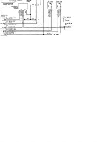

Timing belt is good. Thanx for the tip about the check engine lite indicating comp has power. I'm not sure how best to check battery power to coil with these coil packs. Would I unplug connector to coil pack, turn key on, and use meter to probe the unplugged connector? I assume there is a constant 12V to coil pack w/ key on?

RED/LT GRN wire is battery power with key on
https://www.2carpros.com/forum/automotive_pictures/99387_wiringranger_1.jpg

To verify no spark I removed plug wire on intake side, connected to a new plug, grounded it & watched while my wife cranked it. No spark, not even a weak one. When key is first turned on you can hear the fuel pump pressurize the fuel rail, (I also just installed a new fuel pump/strainer/sender unit. It's definitely a no spark problem. The volt/ohm meter I have is not digital, so reading small amounts of voltage is not really possible. Payday I plan to get a new one that is auto specific & digital.
Thanx for the wiring schematic. I will check the RED/LT GREEN wire to coil with key on to verify power to coil. Thanx much for your continued assistance.
