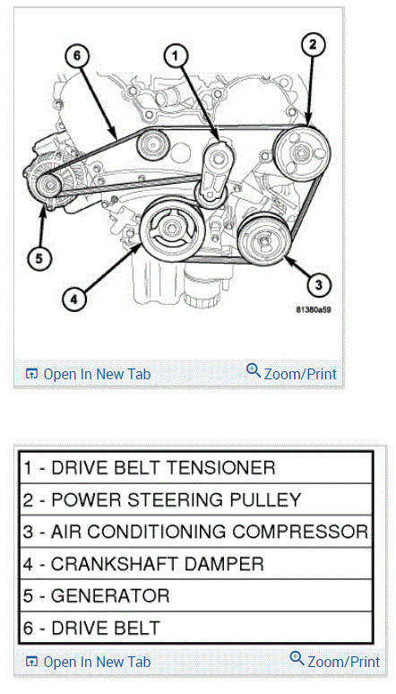

Is there a special holding tool for the crankshaft pulley? I tried to find one T advance auto, but they don't have one for this car.
Friday, October 15th, 2021 AT 10:06 AM
DIVIDES
  • 898 POSTS
Or maybe it doesn't need to remove it actually, I turned the crank until the loose part of the belt is around the tensioner, I can the the move the tensioner and install the new one, correct?

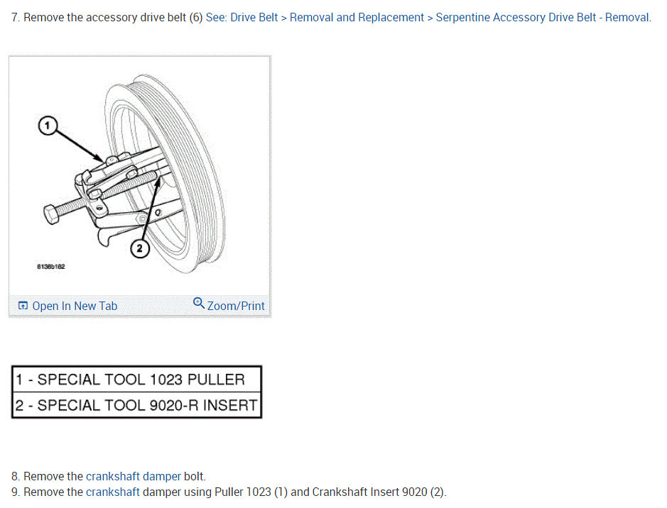

  • 109,885 POSTS

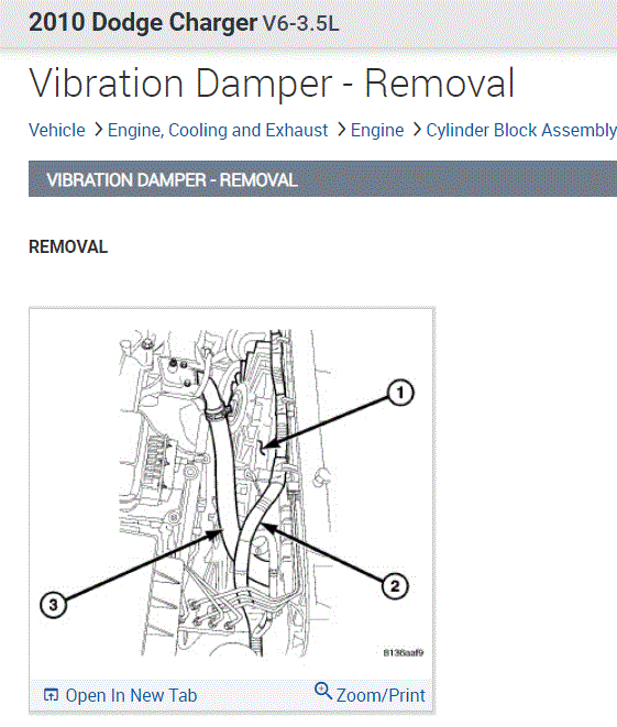

If the rocker assemblies are removed, you can turn the cams or the crank independently. As far as the harmonic balancer/crank pulley, I don't believe there is a mark on it. Check to see if there is a small V cut out of the pulley. If there is, then check to see if there is an indicator on the timing cover. If both are missing, it needs to be removed.
All you need is a standard wheel puller. Most parts stores will lend one to you.
I attached the directions below for the removal of the pulley.

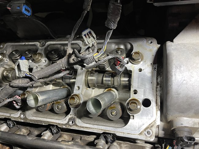

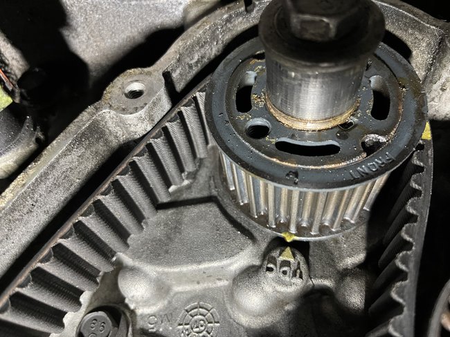

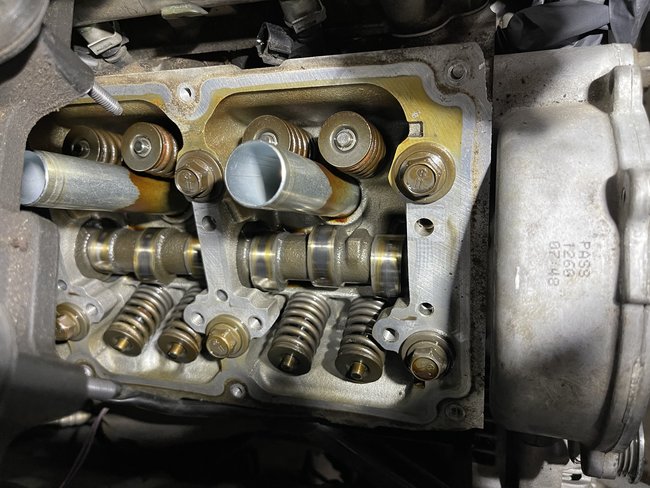

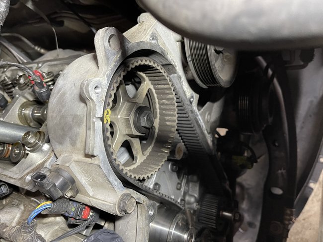

  • 898 POSTS

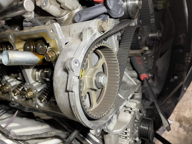

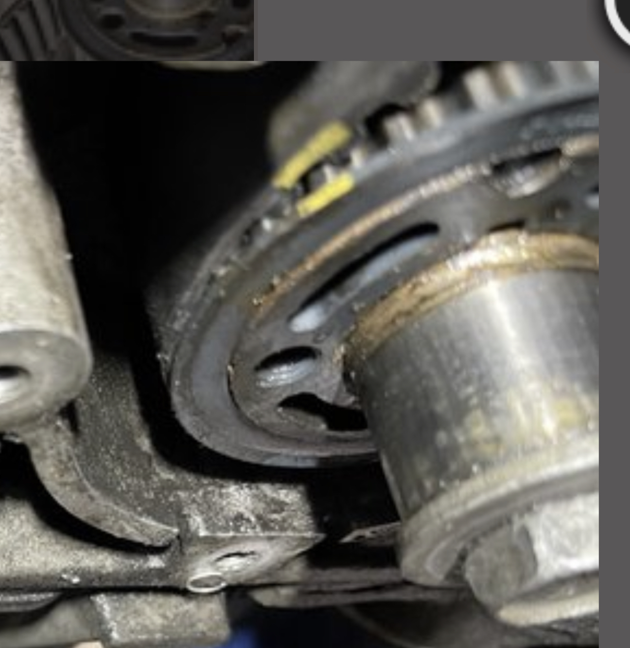

Does this look right?
And I guess I don't have to worry about valves for now since they are all closed, meaning even if I rotate the cam 180 degrees now it won't matter, right?

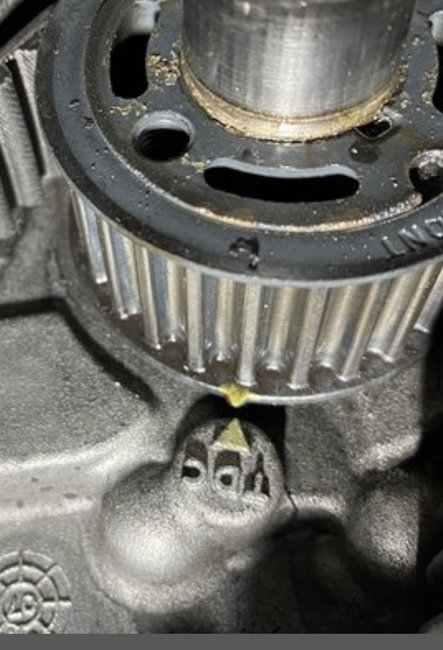

What about the crankshaft mark, how do I confirm its TDC and not 180 degrees off as it is, all yellow marks are from previous installation and I aligned them all. Once the tensioner is on the left cam will pull a bit to the left to align.
Thursday, October 21st, 2021 AT 1:31 PM
  • 109,885 POSTS
Yes, with all valves closed, you can rotate it. As far as the timing marks, the left bank does look slightly off, but I do see play in the belt. Also, I can't see the crankshaft for certain (pic 4) because of the angle.
As long as the crankshaft marks are good, you won't be 180 out.
Thursday, October 21st, 2021 AT 6:47 PM
