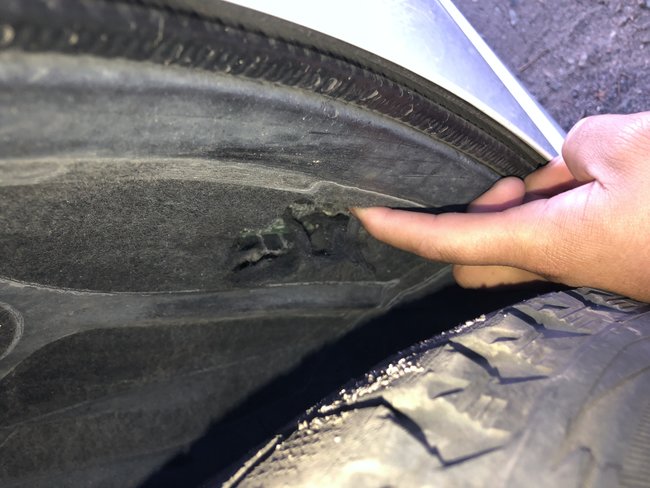

Not too long ago I noticed there was a hole in the splash fabric the car has connected to the chassis in the space that the rear right wheel goes in. In that hole I noticed there was a like a computer chip looking sensor that was broken from a rock, I assume, and now my car is constantly shutting off on me because it's causing shorts in the battery. I would like to know what sensor that is because I can't seem to find it anywhere.

Can you please take a picture of the sensor and upload it here for us?

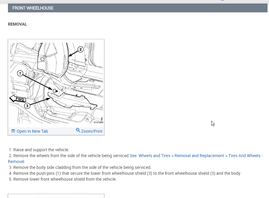

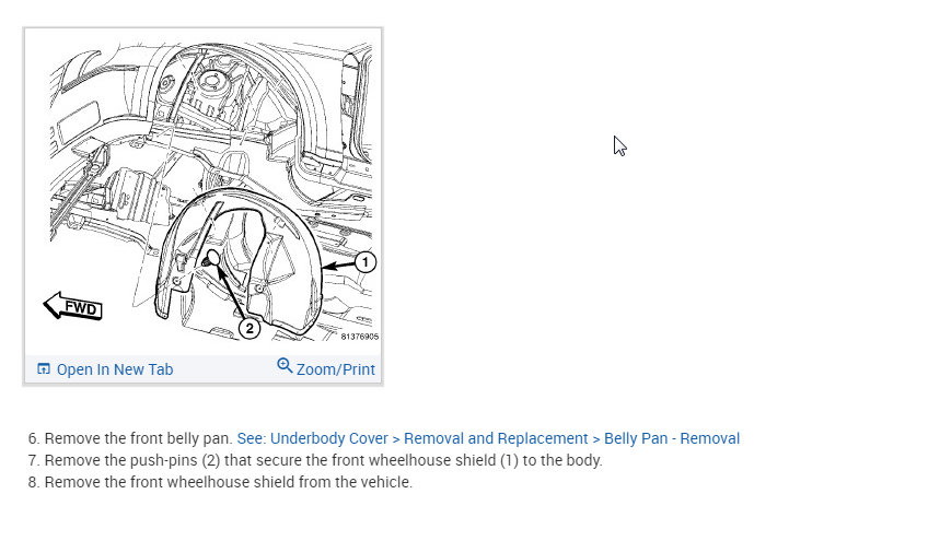

Which wheel is this? More then likely it is speed sensor but we will more than likely need to remove the liner and see if it is actually damaged. However, if you have a short then it could because a battery draw which will cause it to drain.
Here is the process to remove the wheel liner and once it is out, get a picture of this sensor and I will be able to identify it for you. Thanks

I ended up taking what was left of it out and realized it was the Tire Pressure Monitoring Module

Okay. Thanks for the update. Glad you figured it out. Please come back and use 2CarPros in the future.

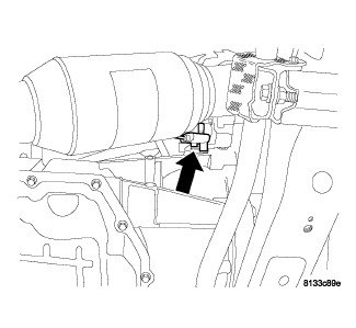

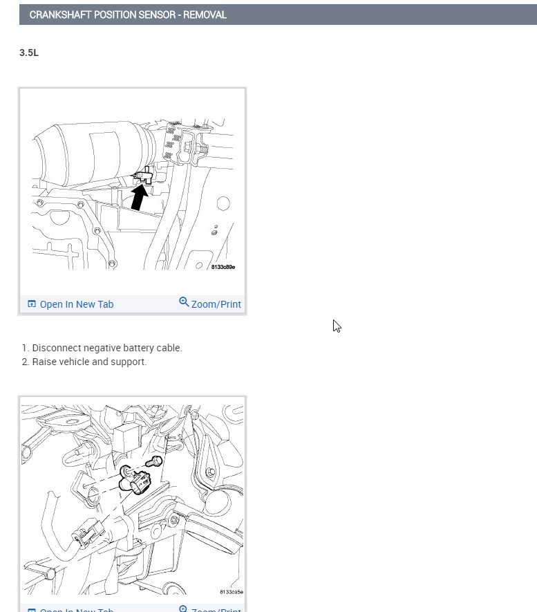

When cold runs perfect when it gets warm it vibrates and shuts down.
I changed all spark plugs and coils ran Thur scan say misfire 301.
I did see a piece of rubber around the spark plug that I thought was suppose to be there not sure now because the others didn’t have it. I found the rubber around the first spark plug position I have no idea what it is. please help. also which is the first cylinder? thanks
Aug 15, 2020 at 3:21 AM (Merged)
  • 110,244 POSTS
Welcome to 2CarPros.

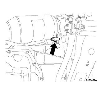

I suspect you have two different things happening. The P0301 indicates a cylinder 1 misfire, so I suspect the piece of rubber you find belongs to the insulator on the coil pack. That would allow it to arc and misfire.
Now, the stalling when warm sounds like a bad crankshaft position sensor. Take a look through these links to better understand its purpose, symptoms, and in general how one is replaced.
https://www.2carpros.com/articles/how-a-crank-shaft-angle-sensor-works

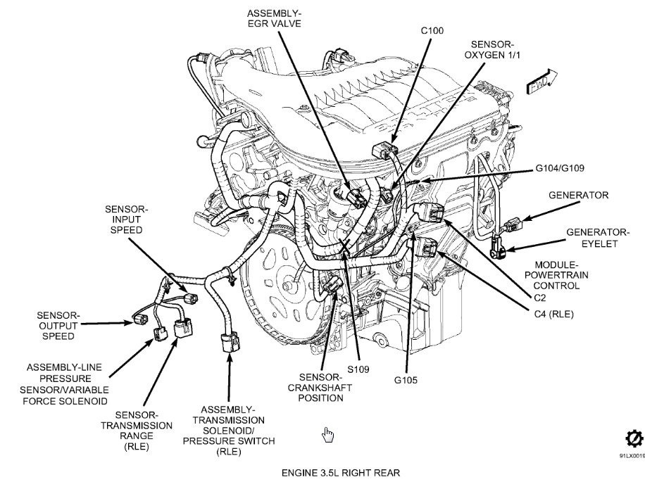

What to do is check if there is spark to the plugs when it won't start or using a live data scanner, see if there is an RPM signal when cranking. Here are a few more links you may find helpful:

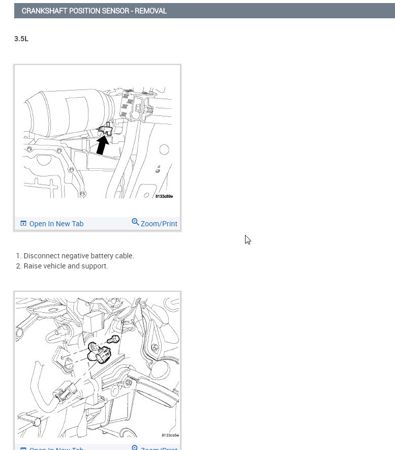

If you determine the crankshaft position sensor is bad, here are the directions specific to your vehicle for removal and replacement. The attached pictures correlate with the directions.
______________________________________
2009 Dodge Charger V6-2.7L
Crankshaft Position Sensor - Removal
Vehicle Powertrain Management Sensors and Switches - Powertrain Management Sensors and Switches - Computers and Control Systems Crankshaft Position Sensor Service and Repair Removal and Replacement Crankshaft Position Sensor - Removal
CRANKSHAFT POSITION SENSOR - REMOVAL
2.7L
pic 1
1. Disconnect negative battery cable.
2. Raise vehicle and support.

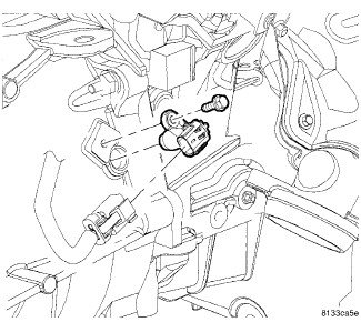

pic 2

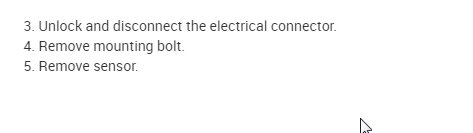

3. Unlock and disconnect the electrical connector.
4. Remove mounting bolt.
5. Remove sensor.

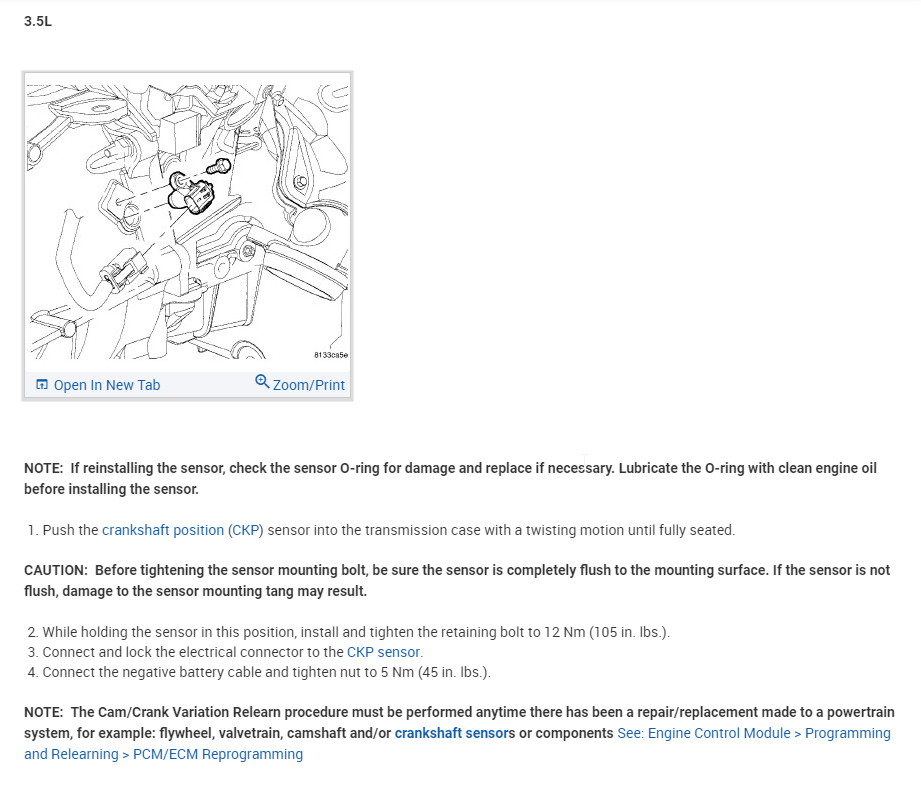

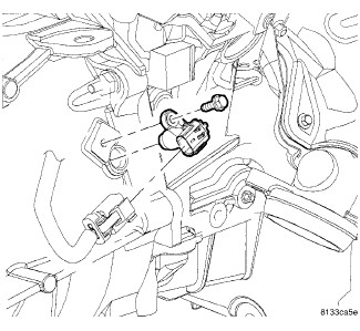

Crankshaft Position Sensor - Installation
Vehicle Powertrain Management Sensors and Switches - Powertrain Management Sensors and Switches - Computers and Control Systems Crankshaft Position Sensor Service and Repair Removal and Replacement Crankshaft Position Sensor - Installation

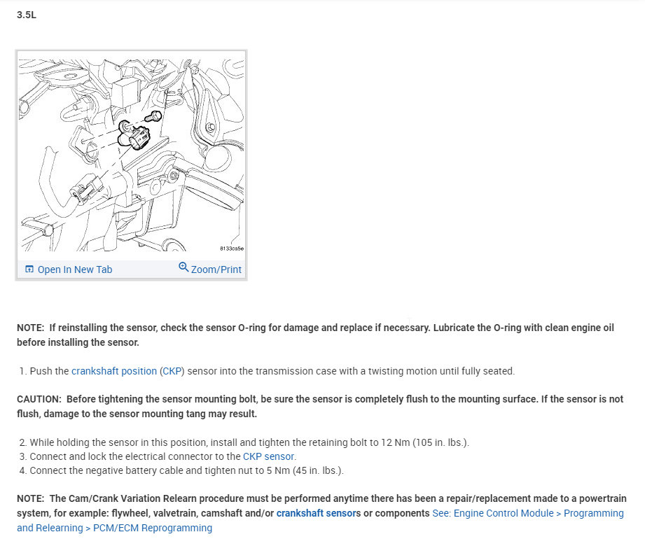

CRANKSHAFT POSITION SENSOR - INSTALLATION
2.7L
pic 3
NOTE: If reinstalling the sensor, check the sensor O-ring for damage and replace if necessary. Lubricate the O-ring with clean engine oil before installing the sensor.
1. Push the crankshaft position (CKP) sensor into the transmission case with a twisting motion until fully seated.
CAUTION: Before tightening the sensor mounting bolt, be sure the sensor is completely flush to the mounting surface. If the sensor is not flush, damage to the sensor mounting tang may result.
2. While holding the sensor in this position, install and tighten the retaining bolt to 9 Nm (79.5 in. lbs.).
3. Connect and lock the electrical connector to the CKP sensor.
4. Connect the negative battery cable and tighten nut to 5 Nm (45 in. lbs.).
NOTE: The Cam/Crank Variation Relearn procedure must be performed anytime there has been a repair/replacement made to a powertrain system, for example: flywheel, valvetrain, camshaft and/or crankshaft sensors or components See: Engine Control Module > Programming and Relearning > PCM/ECM Reprogramming
If the sensor is replaced, the relearn / reprogramming will be required. This will require specific tooling to be done and you may not have the scanner to do it.
