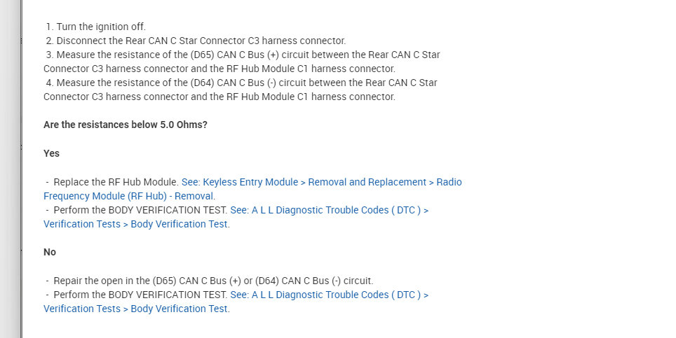

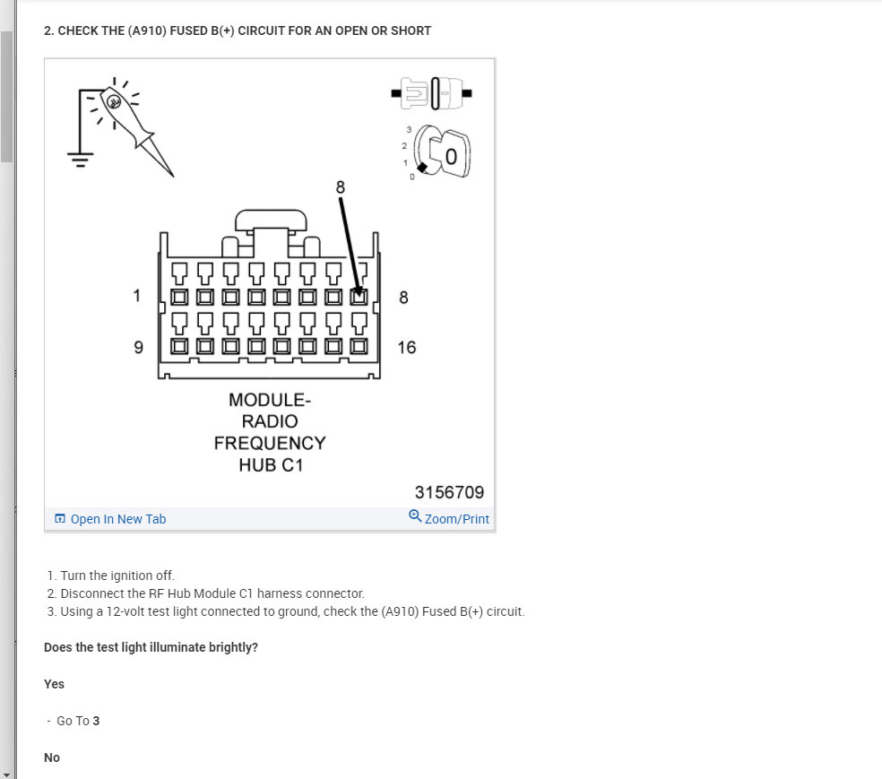

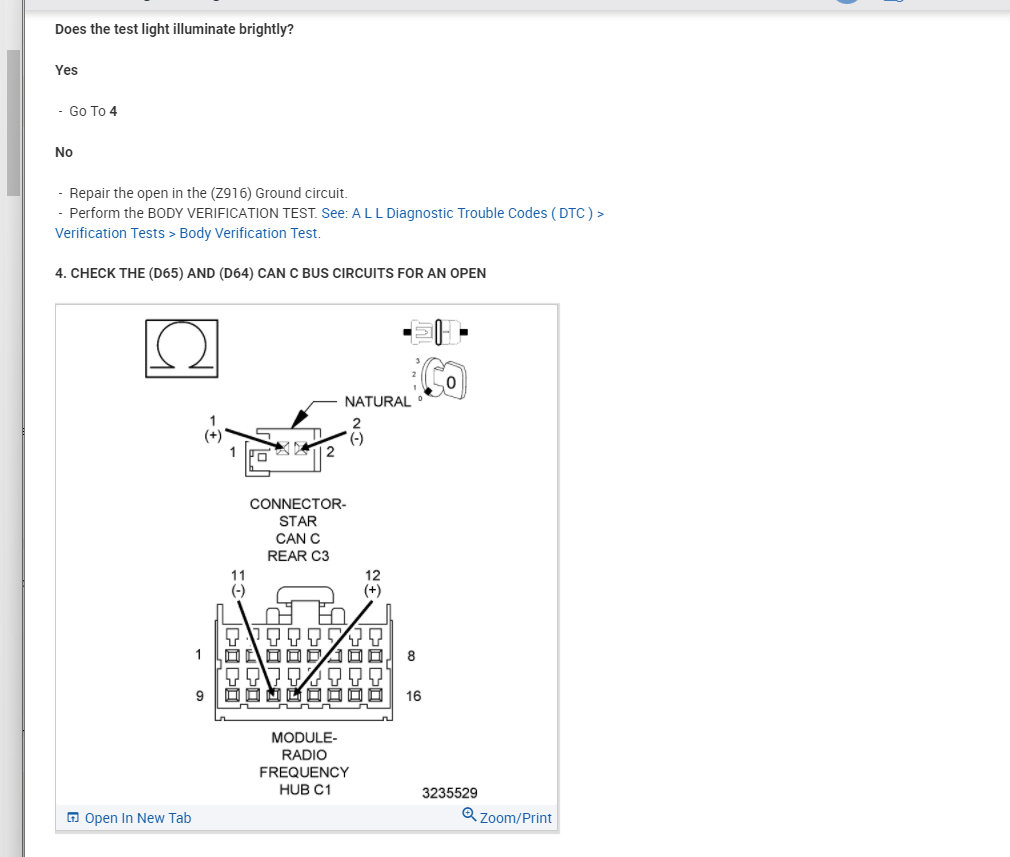

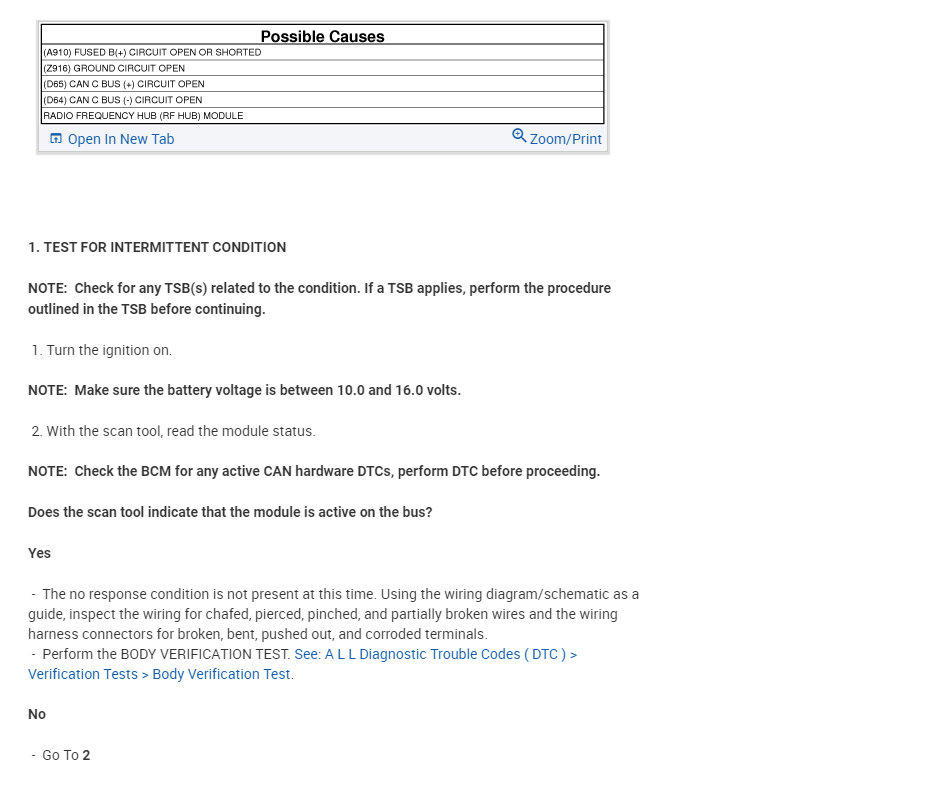

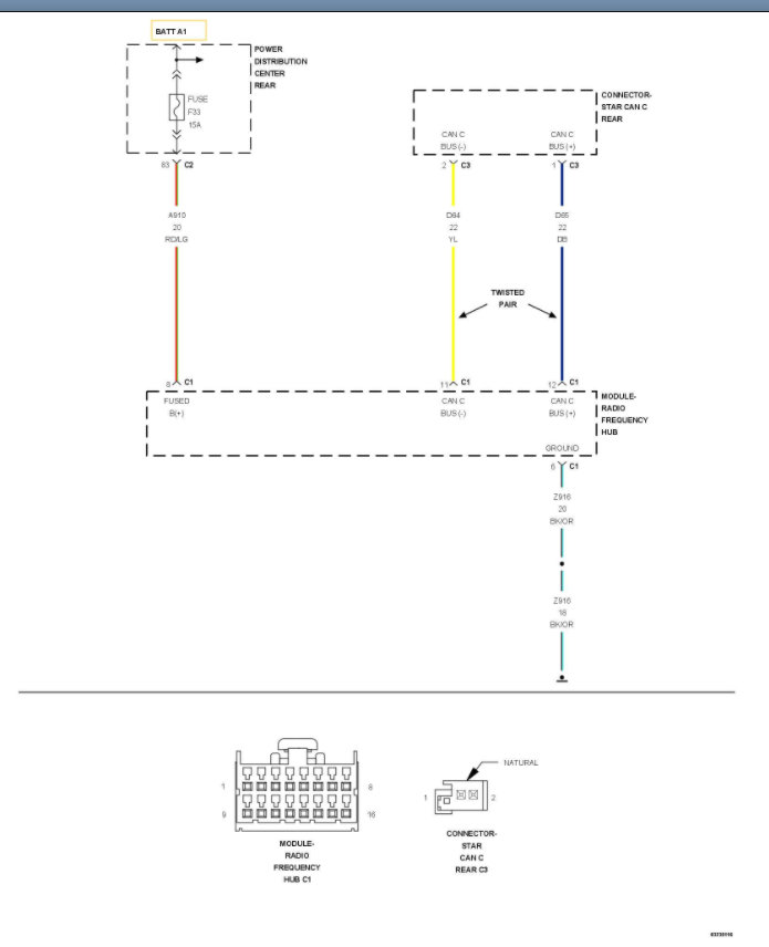

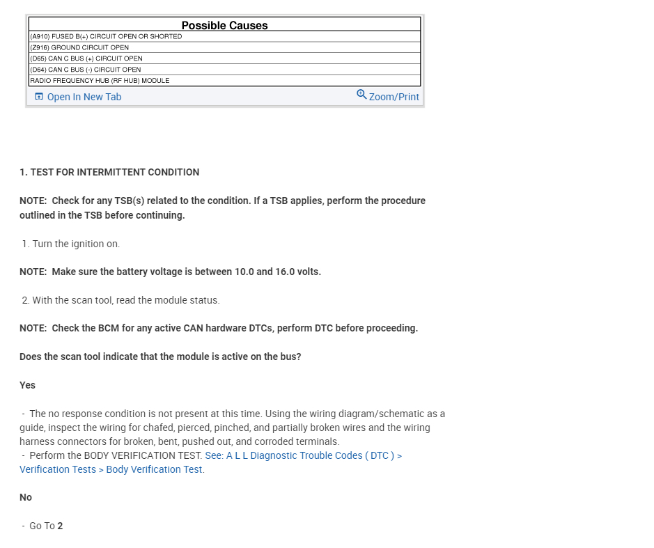

My 2012 dodge charger won't start!! At first it didn't recognize my key then it completely went blank... meaning doors locks don't work, trunk don't open, everything.... someone help me...
Nov 30, 2014 at 11:06 PM
More than likely you have a failure in what is called the RFH or Radio Frequency Hub.
The way to confirm this is run through the testing that I am attaching below. Here are a couple guides that will help with doing this testing:
Please run through these test and let us know what questions you have, and we can go from there.
