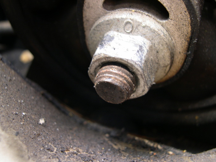

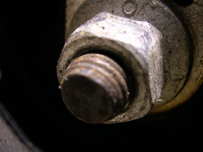

what kind and size nut(5 sided) holds the right motor mount to the medal part of it on the motor side? have a replacement on hand but not the nut or bolt. got it removed but can't separate it for the medal part of it.
Apr 16, 2020 at 10:18 AM (Merged)
10 mm bolts are the motor mount bolts.
EVIL_SANTA
  • 6 POSTS
i wish they were that small this one has 3 18mm bolts but this it the bolt n nut that goes thru the mount. its 5 not 6 sided n its around 18mm but 5 sided. thx
are you talking about the diameter of the bolt or the socket necessary to remove it??
EVIL_SANTA
  • 6 POSTS
the socket
ok, the size of the bolt is 10 mm. the size of the socket is not the size of the bolt, just the external part of the nut.

EVIL_SANTA
  • 6 POSTS
thx i asked the question wrong i guess. where can i buy a "5 or 10 point wrench" say 18mm not a standard 6 or 12 point. the nut looks like the dodge emblem. Google search turns up nothing.
Apr 16, 2020 at 10:19 AM (Merged)

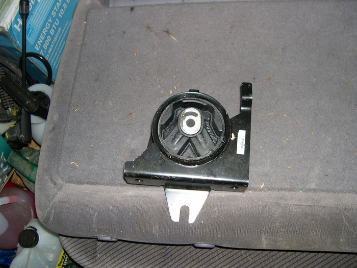

EVIL_SANTA
  • 6 POSTS
here ya go hope this helps. its shape it like the dodge emblem on my repair manual. the manual says not to remove the nut/bolt but to replace the complete unit but they don't sell the mount with the motor side medal mount piece. maybe i am reading to much into to there instructions. with all my tools I've got most wrenches/sockets but none with 5 or 10 points.
you can just use an open end wrench on the nut and use your socket on the other side to remove.

EVIL_SANTA
  • 6 POSTS
nope. the nut is "5 sided" not 6 sided so an open end wrench only would have one flat surface to grip too. they need two flat surface to get a good grip(already tried it didn't work).
CRAWLER
I USED a 12 Point 18MM Socket(After I tried everything else and rounded the corners a little, HAD TO PRESS (an 8" "C" Clamp and a 2 pound Persuasion implement) the socket on to the nut. Not A Fireman, or Plumber(Water Box KEY) so it worked. My Bolt was a 12MMX 1.75 pitch thread. so, I bought a 10.9 12MMX1.75 NYLOK Nut and it worked Just Fine. The New nut was a 19MM Socket. I did this on 10-15-2017

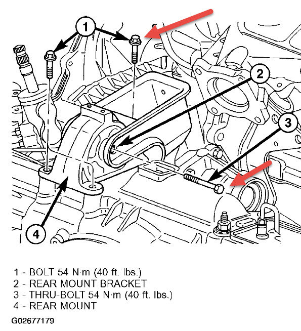

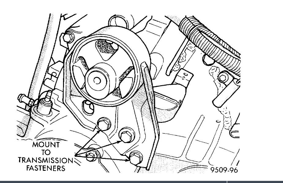

Good morning,
I will attach the procedures for you.
Which mount do you need?
Left
LEFT SIDE MOUNT
REMOVAL
1. Raise vehicle on hoist and remove left front wheel.
2. Support the transmission with a transmission jack.
3. Remove the insulator through bolt from the mount.
4. Remove the transmission mount fasteners and remove mount.
INSTALLATION
1. Reverse removal procedure for installation.
2. Tighten mount to transmission bolts to 55 Nm (40 ft. lbs.).
Engine Mounting-Left
3. Tighten through bolt to 75 Nm (55 ft. lbs.).
4. Adjust engine mount, refer to Adjustment.
Rear
REAR MOUNT
REMOVAL
1. Raise vehicle on hoist.
2. Support the transmission with a transmission jack so it will not rotate.
3. Remove the insulator through bolt from the mount and rear suspension crossmember.
4. Remove the four transmission mount fasteners and remove the mount.
INSTALLATION
Engine Mounting-Rear
1. Reverse the removal procedure for installation. Tighten through bolt to 75 Nm (55 ft. lbs.).

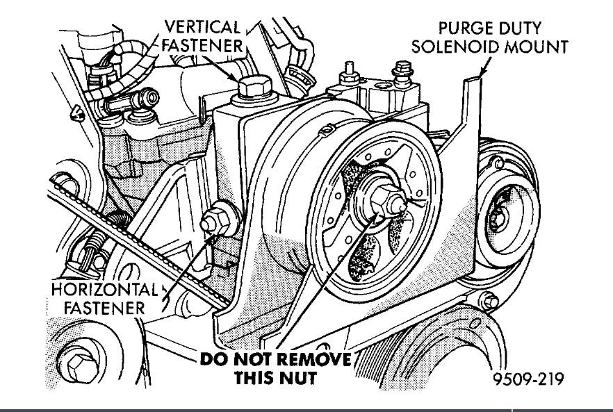

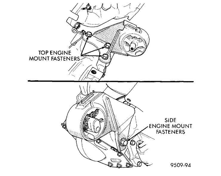

Right side
RIGHT SIDE MOUNT
REMOVAL
NOTE: Right mount should only be serviced as an assembly to prevent noise, vibration and harshness concerns.
1. Remove the purge duty solenoid and wiring harness from engine mount.
Engine Mount-Right
2. Remove the two right engine mount insulator vertical fasteners and loosen the horizontal fastener, do not remove the large nut on the end of the core from frame rail.
3. Remove the load on the engine motor mounts by carefully supporting the engine and transmission assembly with a floor jack.
4. Remove the vertical and horizontal fasteners from the engine side bracket. Remove the engine mount assembly.
INSTALLATION
1. Reverse removal procedure for installation. Tighten assembly in the following order:
a. Engine mount to rail fasteners to 68 Nm (50 ft. lbs.).
b. The vertical engine fastener to 102 Nm (75 ft. lbs.).
c. The horizontal fastener to 150 Nm (111 ft. lbs.).
2. Install the purge duty solenoid and wiring harness to the engine mount.
3. Adjust engine mount, refer to Adjustment.

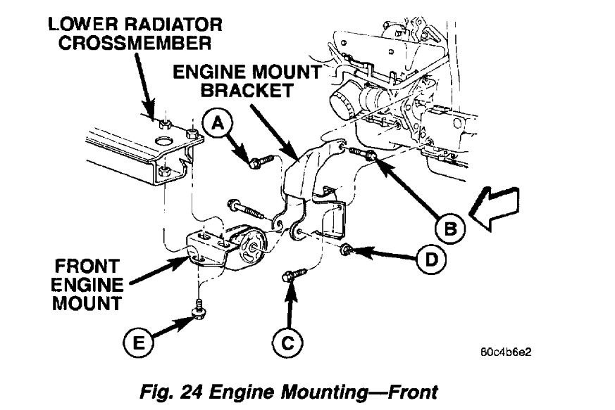

Front
FRONT MOUNT
REMOVAL
1. Support the engine and transmission assembly with a floor jack so it will not rotate.
Engine Mount-Front
2. Remove the front engine mount through bolt from the insulator and front crossmember mounting bracket.
3. Remove six screws from air dam to allow access to the front mount screws.
4. Remove the front engine mount screws and remove the insulator assembly.
5. Remove the front mounting bracket, if necessary.
INSTALLATION
1. Reverse removal procedure for installation and tighten fasteners (Fig. 24) to the following torque.
(A), (C) and (D) to 68 Nm (50 ft. lbs.)
(B) to 102 Nm (75 ft. lbs.)
(E) to 54 Nm (40 ft. lbs.)
2. Install six screws to air dam and tighten to 12 Nm (105 inch lbs.).

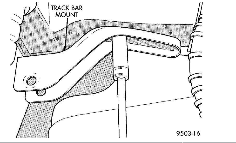

Track
REMOVE
1. Remove the track bar from the track bar mount.
Track Bar Mount
2. Remove the three bolts attaching the track bar mount to the body.
INSTALLATION
1. For installation, reverse removal procedure. Tighten bolts to 61 Nm (45 ft. lbs.).

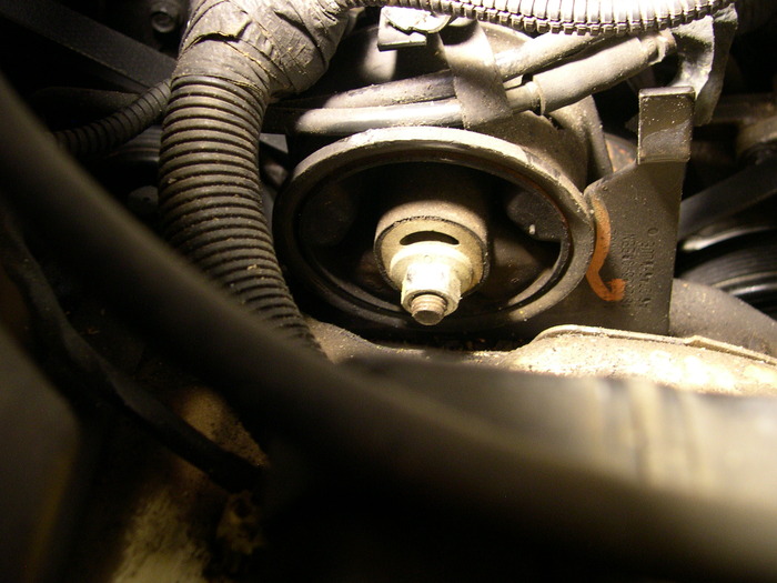

EIDSONJR
How many motor mounts are on a 2000 town and country v6 3.8 front wheel drive & how do you take off the passenger side 5 point bolt on motor mount.
i cant find anyone who can tell me where to get the 5 sided bolt on the passenger side motor mount for this van. All idiots keep saying its 6 sided and it CLEARLY IS NOT. anyone who has this answer please let me know. this was a earlier problem for someone on this site and they did NOT get the answer they were looking for.

I listed all the mounts in my response with the procedure. What step has you confused?
Can you post a picture of the 5 sided bolt?
