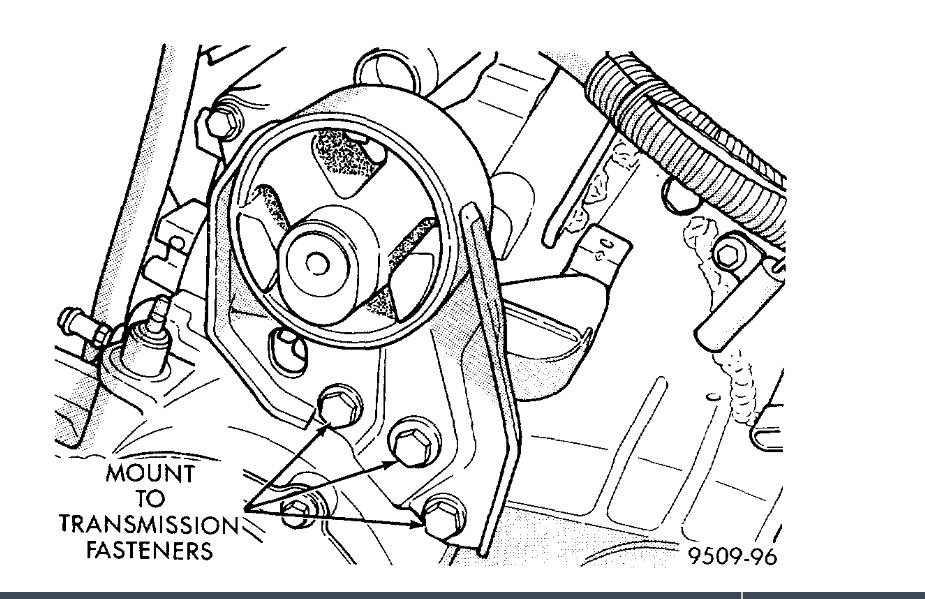

Left
LEFT SIDE MOUNT
REMOVAL
1. Raise vehicle on hoist and remove left front wheel.
2. Support the transmission with a transmission jack.
3. Remove the insulator through bolt from the mount.
4. Remove the transmission mount fasteners and remove mount.
INSTALLATION
1. Reverse removal procedure for installation.
2. Tighten mount to transmission bolts to 55 Nm (40 ft. Lbs.).
Engine Mounting-Left
3. Tighten through bolt to 75 Nm (55 ft. Lbs.).
4. Adjust engine mount, refer to Adjustment.

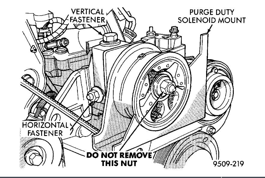

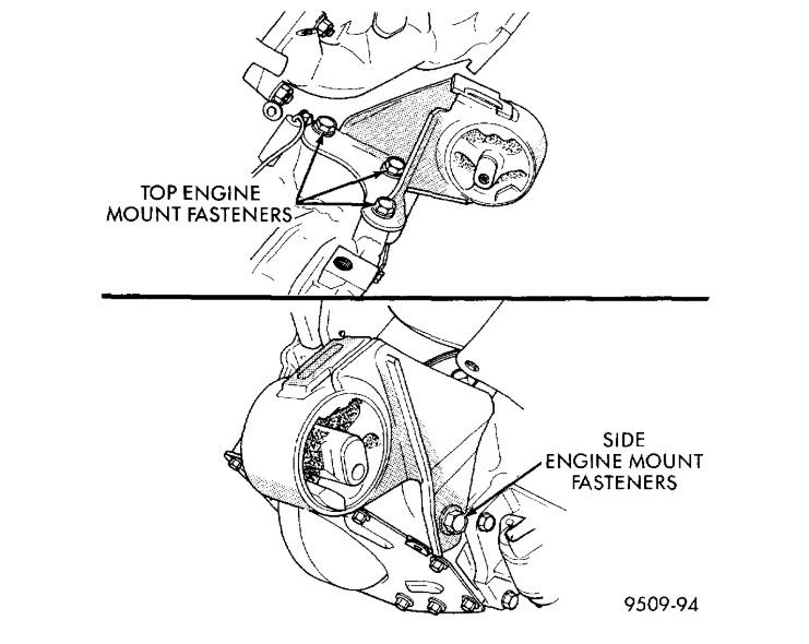

Right side
RIGHT SIDE MOUNT
REMOVAL
NOTE: Right mount should only be serviced as an assembly to prevent noise, vibration and harshness concerns.
1. Remove the purge duty solenoid and wiring harness from engine mount.
Engine Mount-Right
2. Remove the two right engine mount insulator vertical fasteners and loosen the horizontal fastener, do not remove the large nut on the end of the core from frame rail.
3. Remove the load on the engine motor mounts by carefully supporting the engine and transmission assembly with a floor jack.
4. Remove the vertical and horizontal fasteners from the engine side bracket. Remove the engine mount assembly.
INSTALLATION
1. Reverse removal procedure for installation. Tighten assembly in the following order:
a. Engine mount to rail fasteners to 68 Nm (50 ft. Lbs.).
B. The vertical engine fastener to 102 Nm (75 ft. Lbs.).
C. The horizontal fastener to 150 Nm (111 ft. Lbs.).
2. Install the purge duty solenoid and wiring harness to the engine mount.
3. Adjust engine mount, refer to Adjustment.

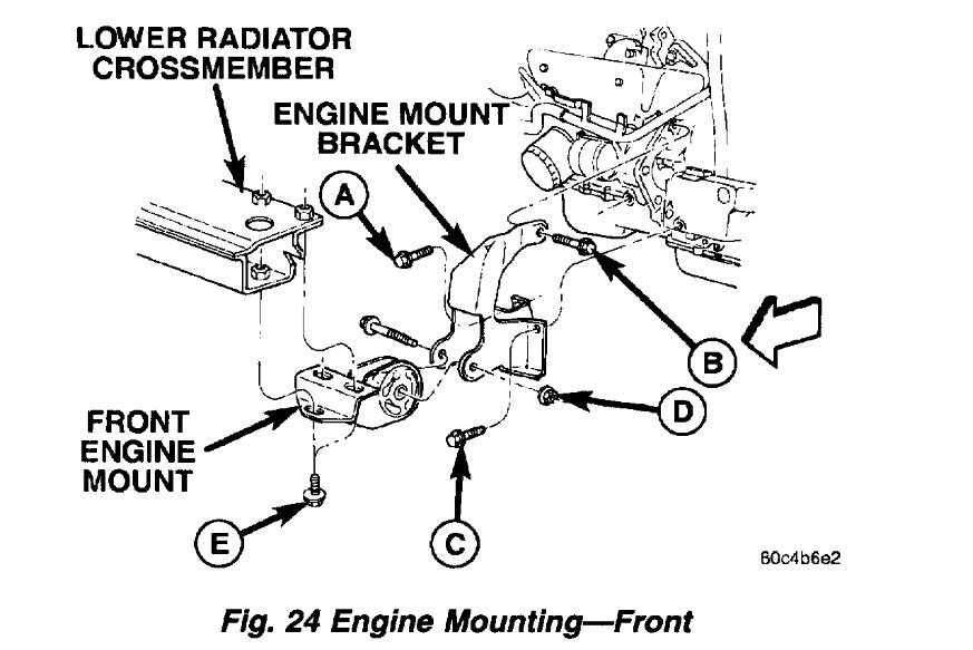

Front
FRONT MOUNT
REMOVAL
1. Support the engine and transmission assembly with a floor jack so it will not rotate.
Engine Mount-Front
2. Remove the front engine mount through bolt from the insulator and front crossmember mounting bracket.
3. Remove six screws from air dam to allow access to the front mount screws.
4. Remove the front engine mount screws and remove the insulator assembly.
5. Remove the front mounting bracket, if necessary.
INSTALLATION
1. Reverse removal procedure for installation and tighten fasteners (Fig. 24) to the following torque.
(A), (C) and (D) to 68 Nm (50 ft. Lbs.)
(B) to 102 Nm (75 ft. Lbs.)
(E) to 54 Nm (40 ft. Lbs.)
2. Install six screws to air dam and tighten to 12 Nm (105 inch lbs.).

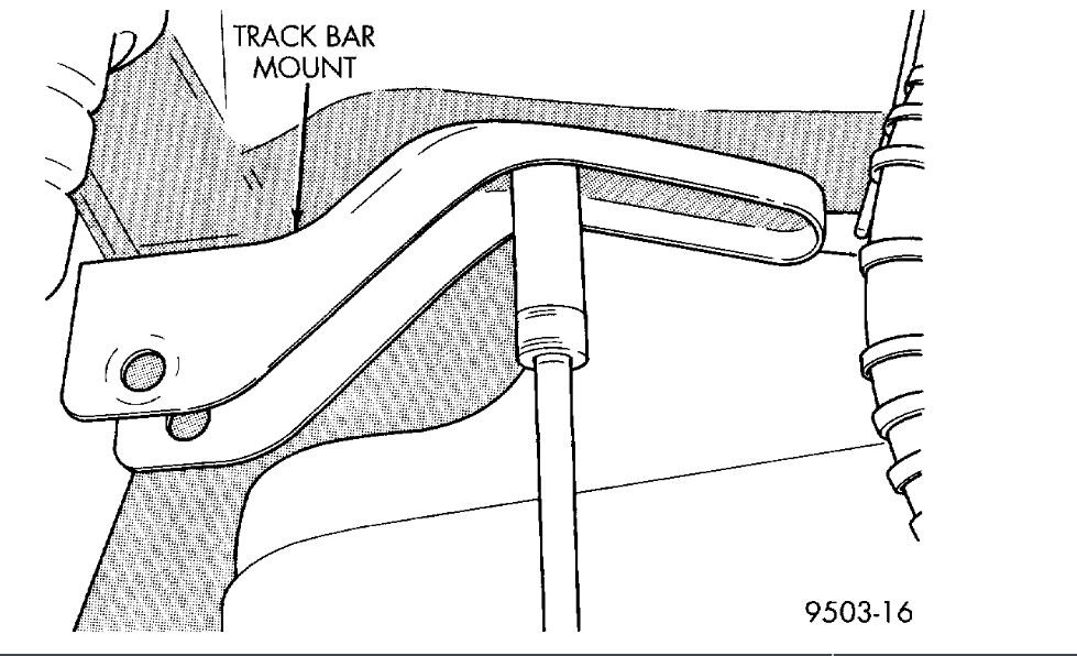

Track
REMOVE
1. Remove the track bar from the track bar mount.
Track Bar Mount
2. Remove the three bolts attaching the track bar mount to the body.
INSTALLATION
1. For installation, reverse removal procedure. Tighten bolts to 61 Nm (45 ft. Lbs.).
