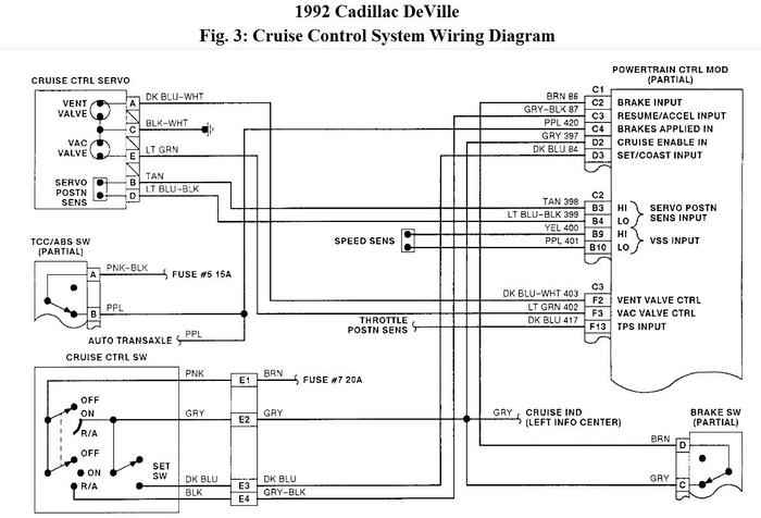

The 11.5 volts indicates pwer is getting there.
There are 4 wires at brake switch, one should be hot at all time and one more only when the cruise control switch is turned on with ignition on. Is that what you are having?
Monday, October 26th, 2020 AT 12:27 PM (Merged)
SEAN03
  • 523 POSTS
No none of them are hot when the car is off. When you turn the cat on then it gets voltage at all of the wires. Their are another set of wires on the brake switch. Orange and two light blues that are connected together in the switch. The orange has 11.5 volts and the light blue has no power. I also tested the cruise switch above the brake switch and everything their has 11.5 to 9.5 volts.
CADIEMAN
  • 3,544 POSTS
Check for voltage on the pink wire at the lever connector with the key on. This is what controls the power to the lever. If no power is their check # 7 fuse 20 amp.

Ok the pink wire has 11.2 volts and their is 12 volts at fuse 7 and the fuse is also good.
CADIEMAN
  • 3,544 POSTS
Test the codes again.U have power at the pink wire test the power on the other side of the connector to the handle power is going their also right? If so the orange light should be on.U will need a new handle.
SEAN03
  • 523 POSTS
I have no codes. Ok so the pink wire has power. Their is power going to the handle and their is power on the other side of the connector. The orange light is still not on. Thanks.
KHLOW2008
  • 41,814 POSTS

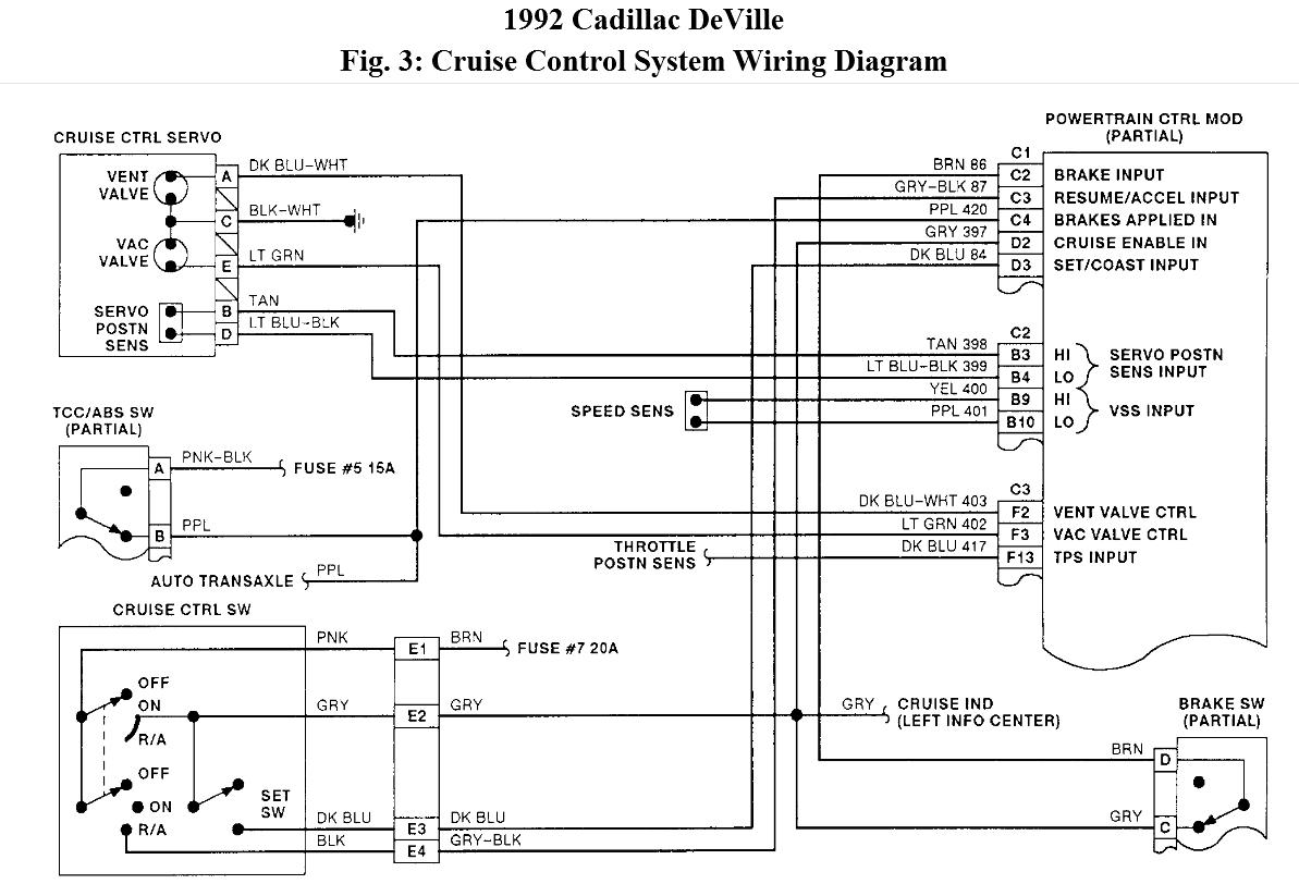

You need to get the orange light to come on. Maybe this is where the problem lies. A break in the circuit to the indicator light and PCM. I am attaching the schematic again.
At PCM D2 terminal, test the Grey wire for battery voltage. If you do not have battery voltage, check the wire for an open between the switch and PCM. Attach test light to a power source and probe the terminal to test if the Orange light comes on.

SEAN03
  • 523 POSTS
Ok so I pulled the clip out and turned the car to the on position and the gray wire had 12 volts to it. So I pushed the harness back into the computer.
KHLOW2008
  • 41,814 POSTS
If the Orange light does not come on, you would need to remove the meter cluster to check the bulb and wiring.

Ok I just did that funny thing happened. I tested the white and gray wire that would plug into the information center. I tested the two wires and their is no power going to those two. The two wires would be the ones that light up the cruise control light. If you test the white and gray wires together their is no power. If you test the white wire to the body of the car it has no voltage. If you test the gray to the body it comes up with 8.5 volts.
SEAN03
  • 523 POSTS
How do I test the light bulb itself to see if it is good.
Monday, October 26th, 2020 AT 12:28 PM (Merged)
CADIEMAN
  • 3,544 POSTS
Find a power wire. Run a jumper wire from a nown good power wire to the gray. Does the lite go orange then.
CADIEMAN
  • 3,544 POSTS
Jack the front end up have someone go over 30 mph and set the cruise. Using a test light at the servo seleniod check to see weather your getting power to the seleniod when u set the cruise.
