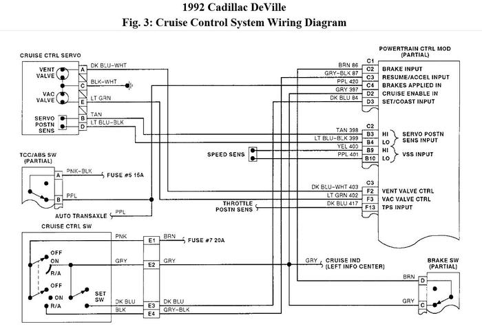

SEAN03
  • 523 POSTS
Hi I am looking at a chiltons manuel to diagnose a cruise control problem. I reposted sorry. But Is a speed sensor on the 1992 cadillac deville related to the cruise control. I have checked the fuse it was good. their is no leak in the vacuum. I changed the cruise lever out. I checked for power it has power. I bought a servo on ebay that was supposobly in working condition. Where is the stepper motor located. From the sounds of it. It is the thing that attaches to the throttle cable and the cruise cable. What is a transducer and how do you test it. Also is their a way to test the cruise servo. Thanks.
Oct 26, 2020 at 5:26 AM (Merged)
KHLOW2008
  • 41,814 POSTS
Yes, speed sensors are a vital part of the system as the system needs to keep the vehicle at the speed it was set at.
Transducer should mean the vacuum unit.
What is the problem you are encountering? Are the brake lights working?
Any component or circuits that is not working correctly?

  • 41,814 POSTS
You are moving too far ahead. The indicator light has to show when the cruise control system is turned on. when it does not glow, it can mean either no power supply to it, the switch is bad or you have a missing ground circuit.
Get a DVOM or testlight and pull the switch out. Ensure you have battery voltage at the Brown wire.

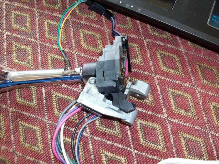

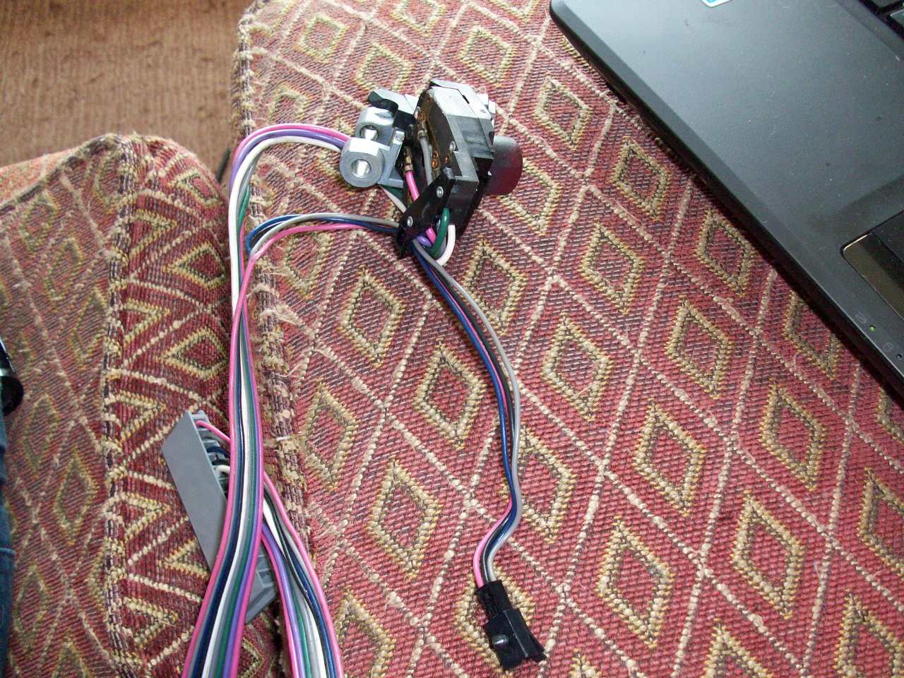

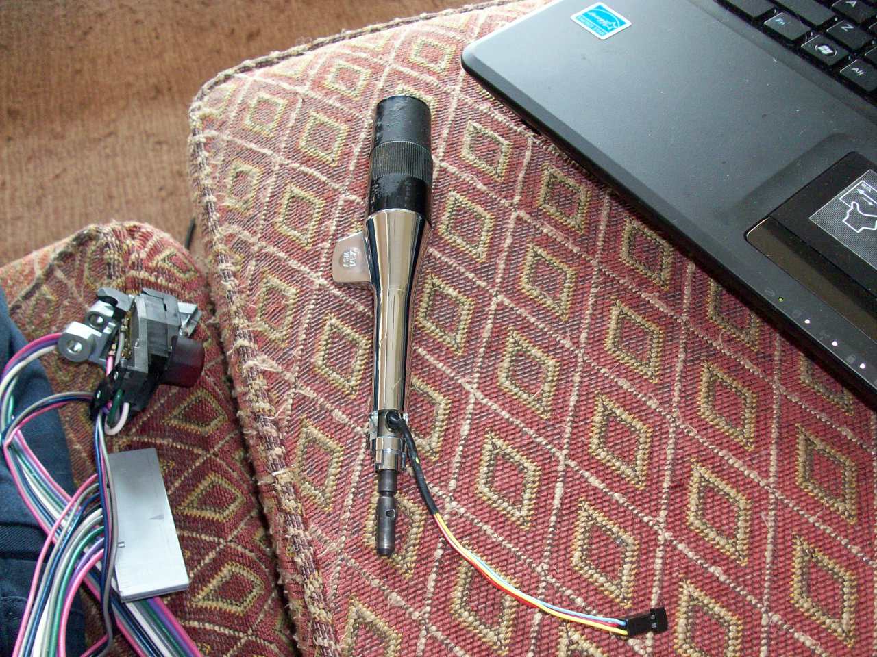

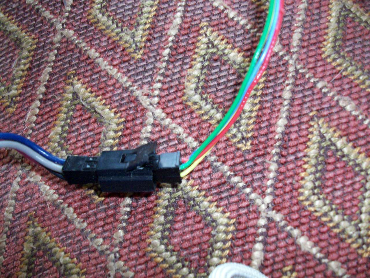

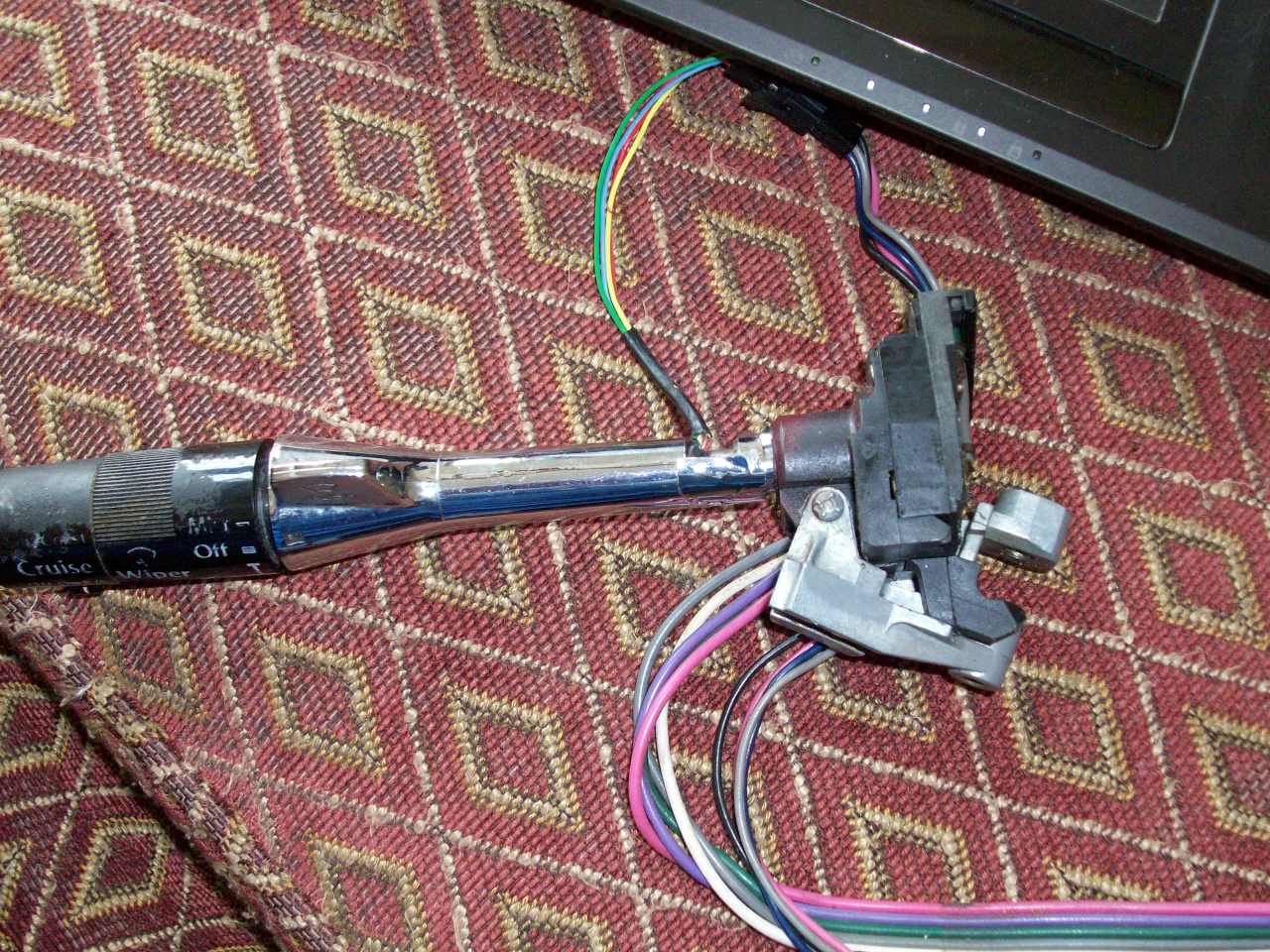

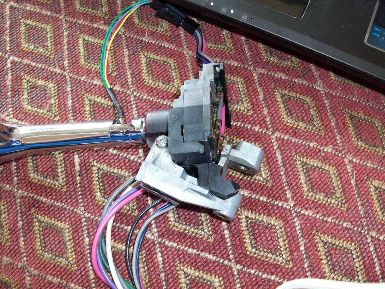

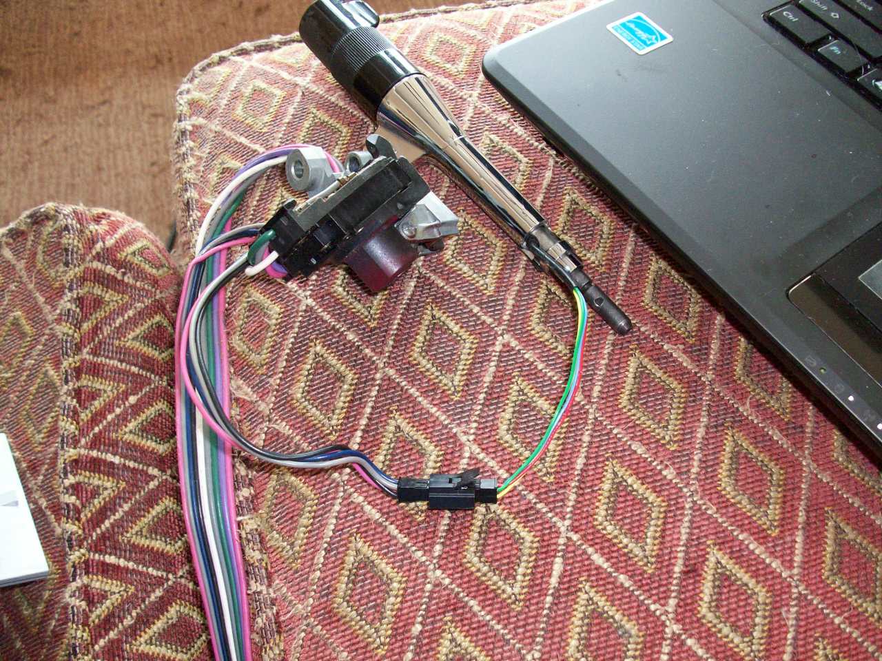

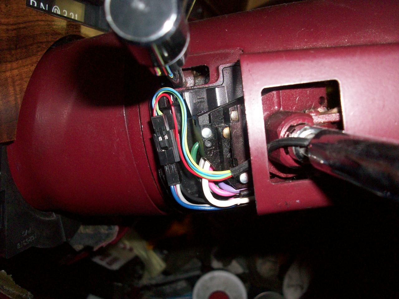

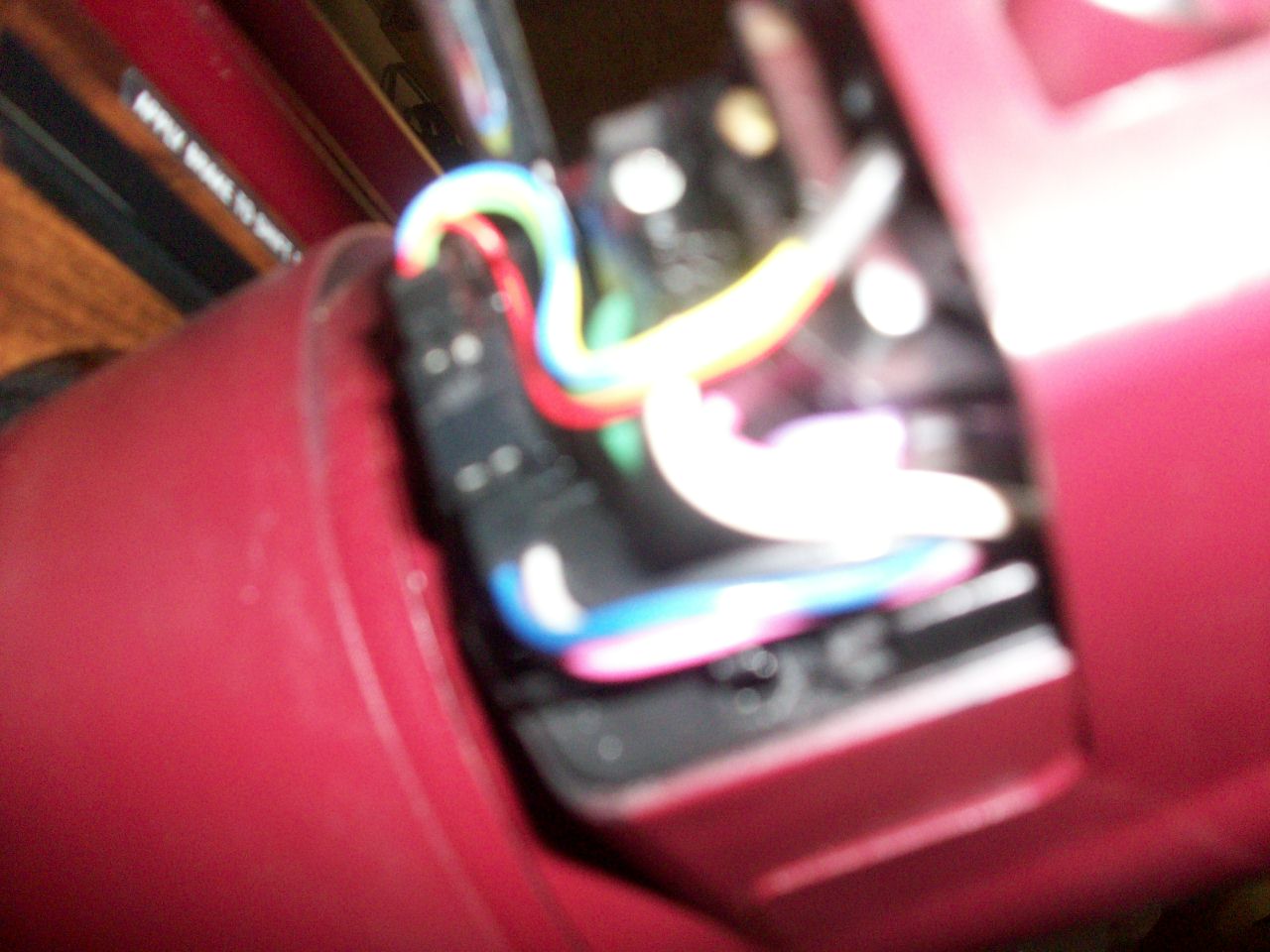

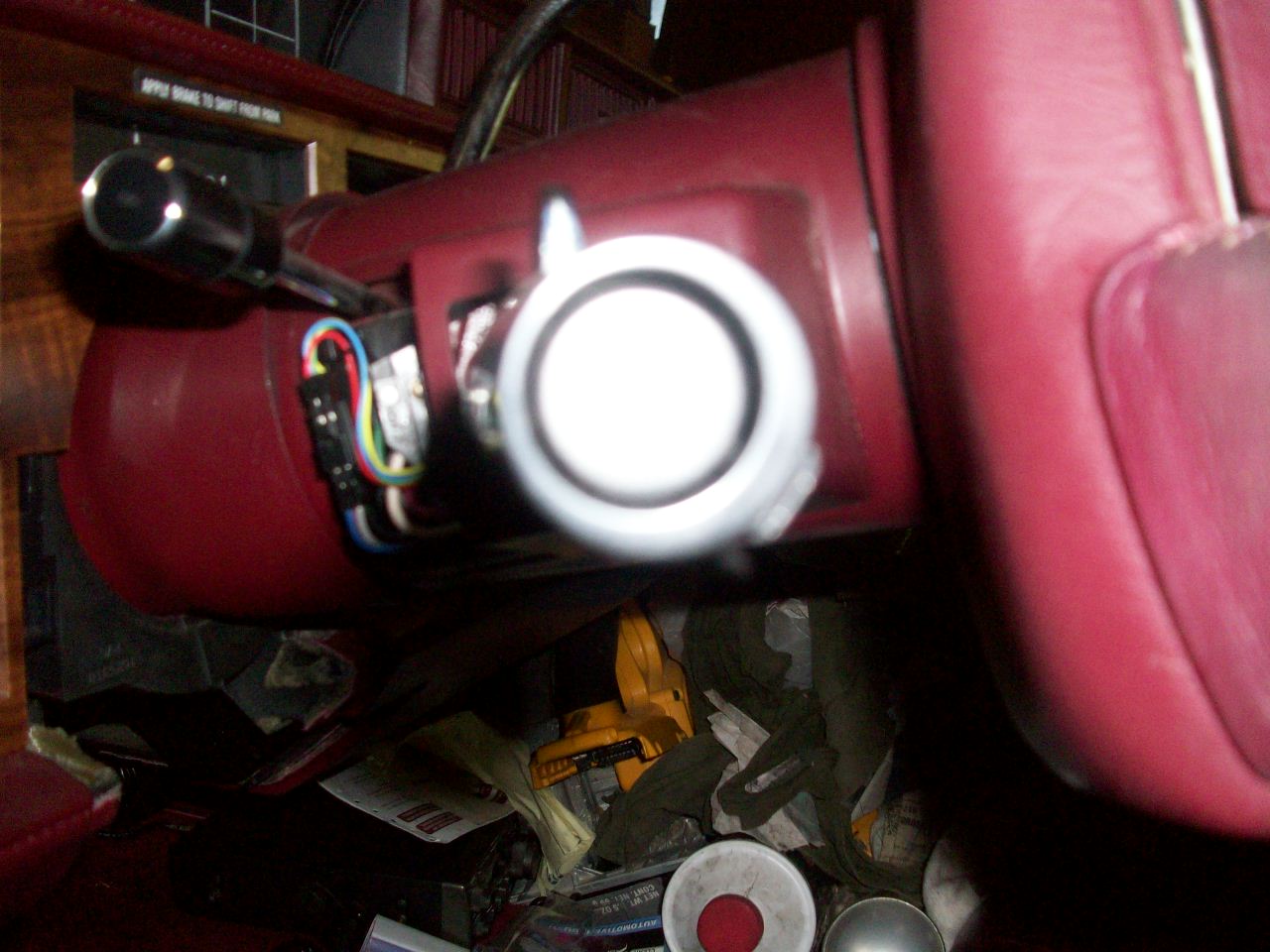

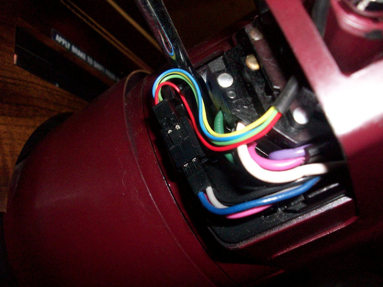

SEAN03
  • 523 POSTS
Ok so I was looking for the brown wire but could not find it. Here are some pictures maybe I am looking in the wrong place.
KHLOW2008
  • 41,814 POSTS
Wire colors seems to be different from the schematic in our database.
There are 4 wires, ensure at least one of it has battery voltage when ignition is turned on.

CADIEMAN

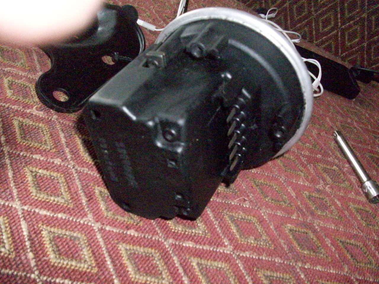

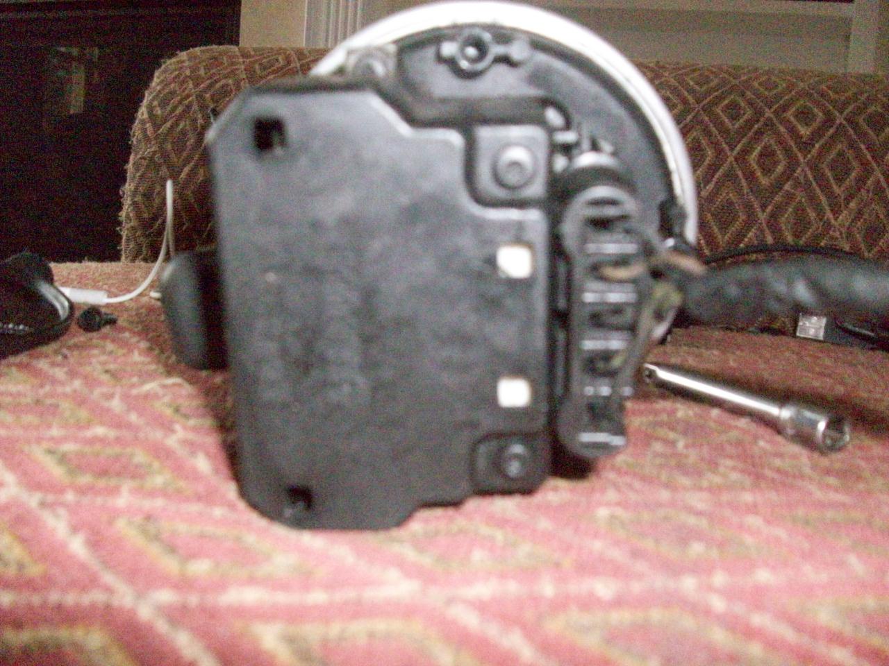

  • 3,544 POSTS
u should be able go in the cpu and ck for cruise codes.just push the off and warmer buttons on the a/c head until you see all segments light release.as it goes thru the cpus.write the codes down.then if no codes are set then its a vacuum problem.next test the small hose at the servo for vacuum.then remove the large hose and blow air through the hose with you mouth.u should not be able to blow into it.start here then come back. gl
SEAN03
  • 523 POSTS
Ok I blew through the large hole and you can not blow through it. Their is no codes in the system. The small hose has a good vacuum. The number 7 fuse is good I changed that out today. I checked for the voltage before I put the fuse in. It had 12.2 volts which is good. I got confused on the diagram. With the grey pink black and dark blue. How do I check this. Do I put the positive volt meter on one and then put the negative probe on the other. If you could explain on how to do this I would greatly appreciate it. Thanks for all your time and help.

CADIEMAN
  • 3,544 POSTS
u needed to do what khl said.test for power with key on on the pink wire and ground on black.as simple as that.
SEAN03
  • 523 POSTS
Ok so I just did this a few seconds ago after you posted I put the positive on the pink wire and the negative on the black wire. It showed 12 volts exact on my volt meter with the car on the run position not started.

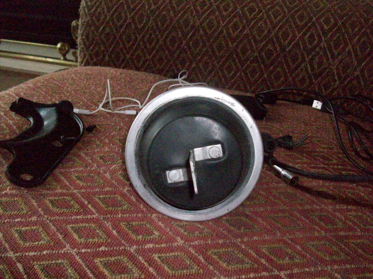

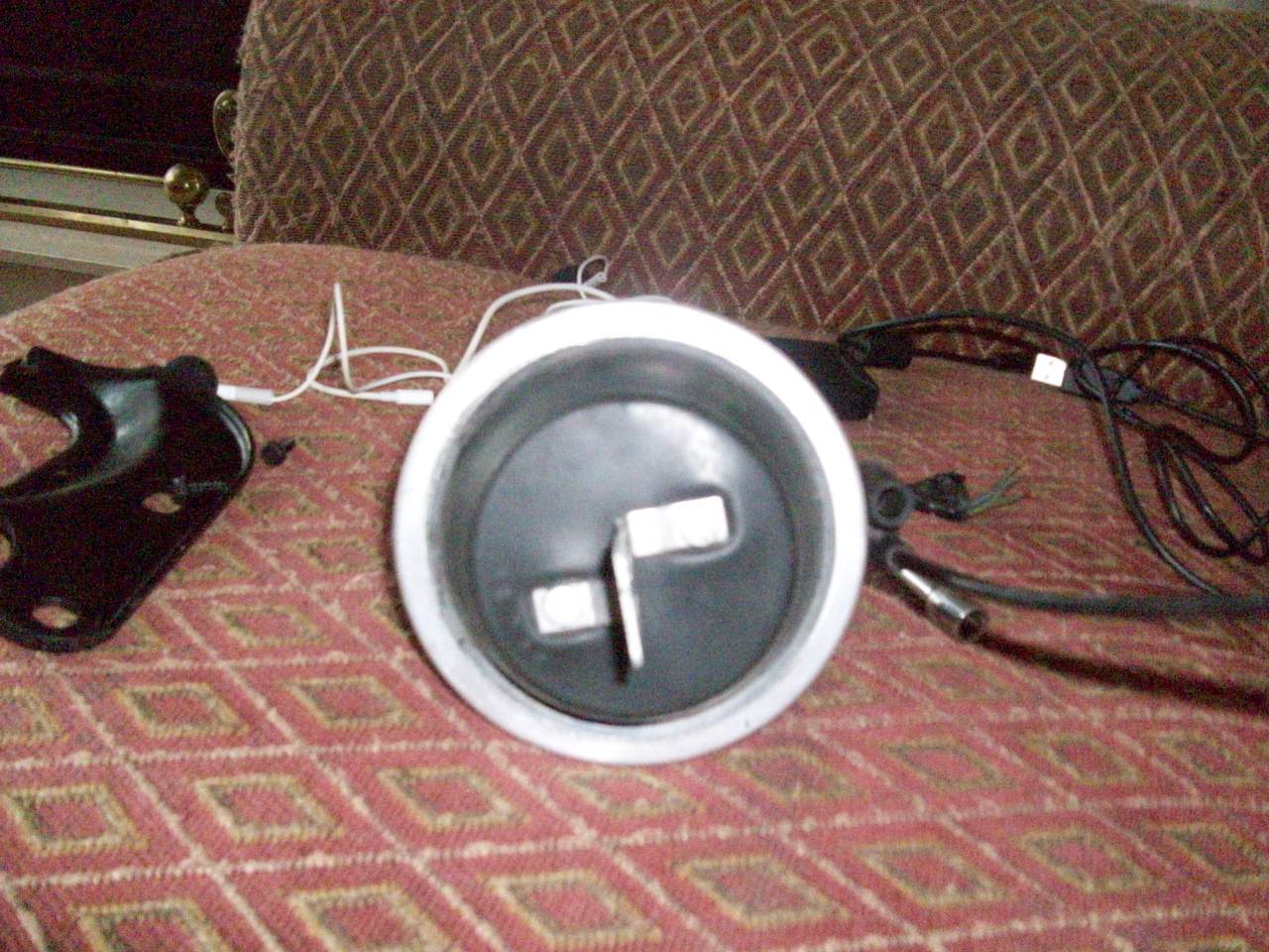

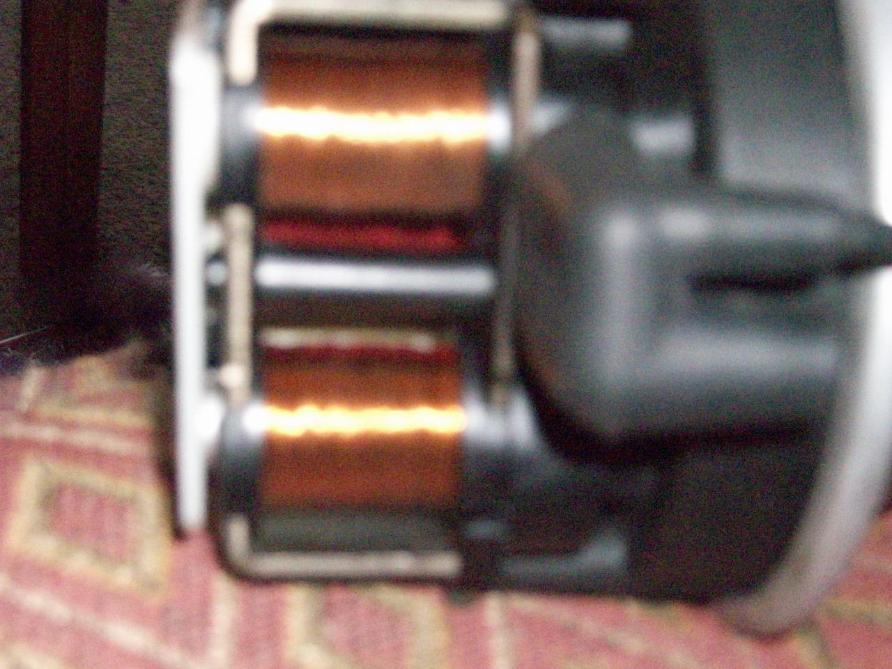

CADIEMAN
  • 3,544 POSTS
key on this is a switch test.it tells u if the cpu is receiving a signal.sounds like that servo is ng.
