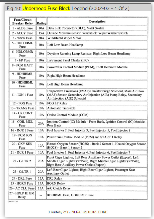

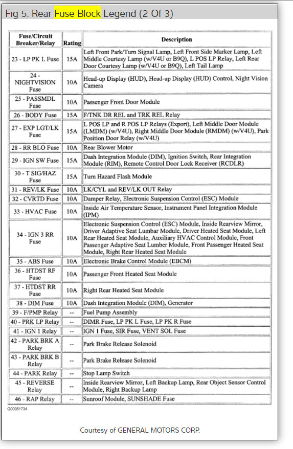

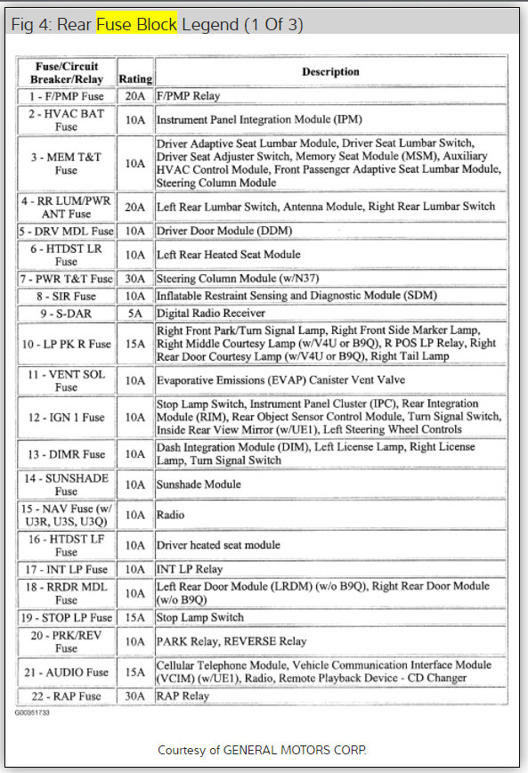

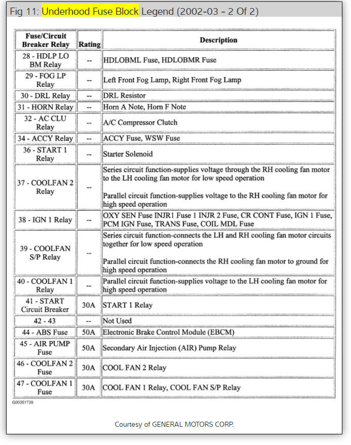

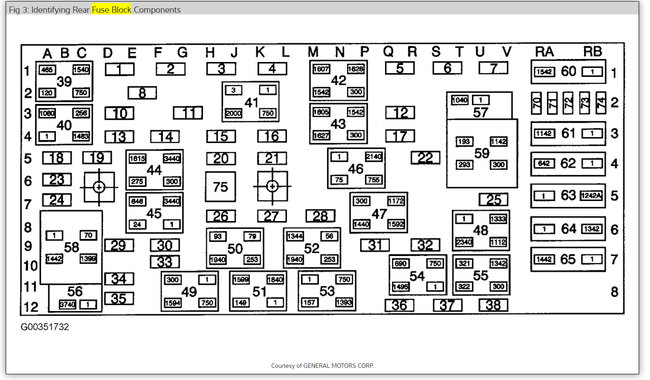

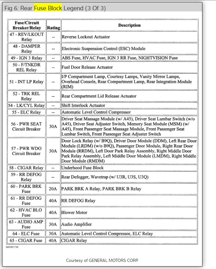

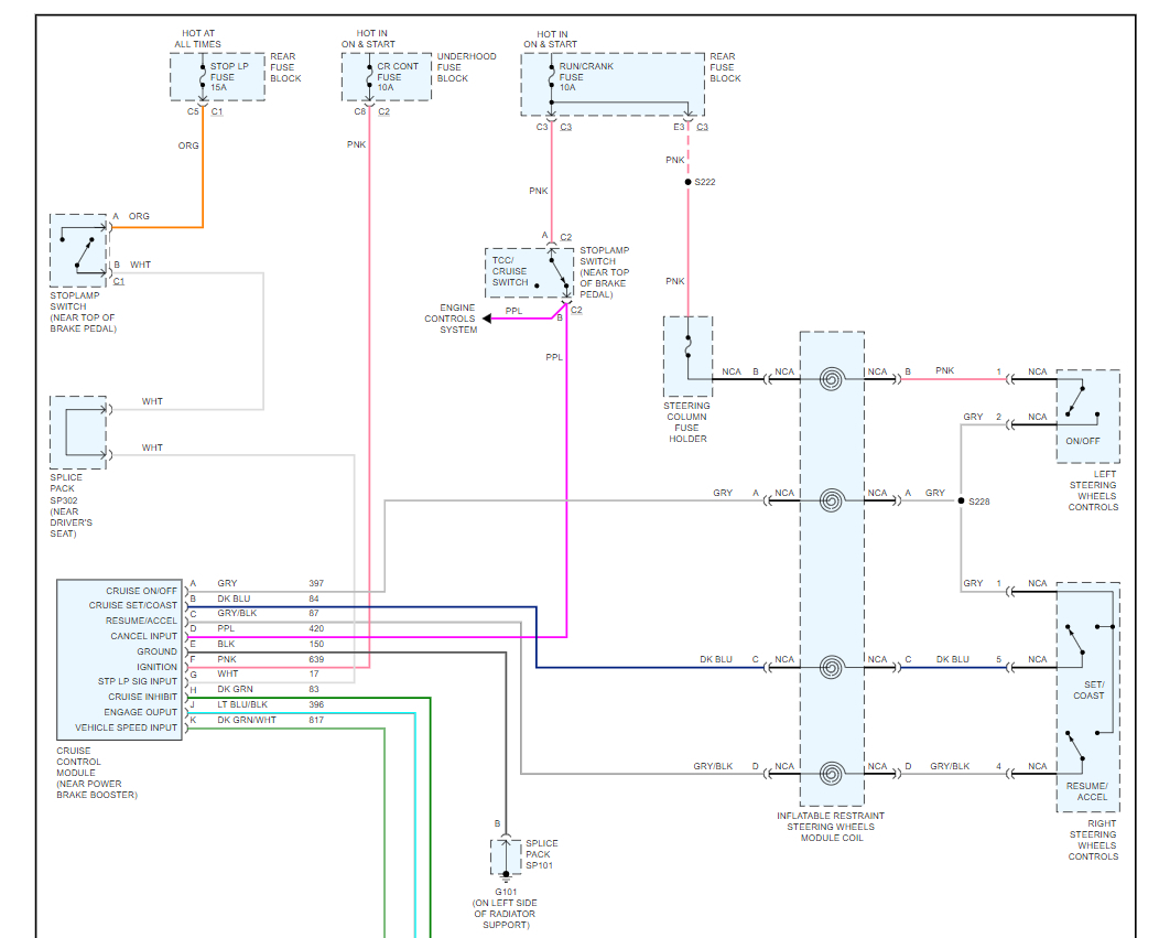

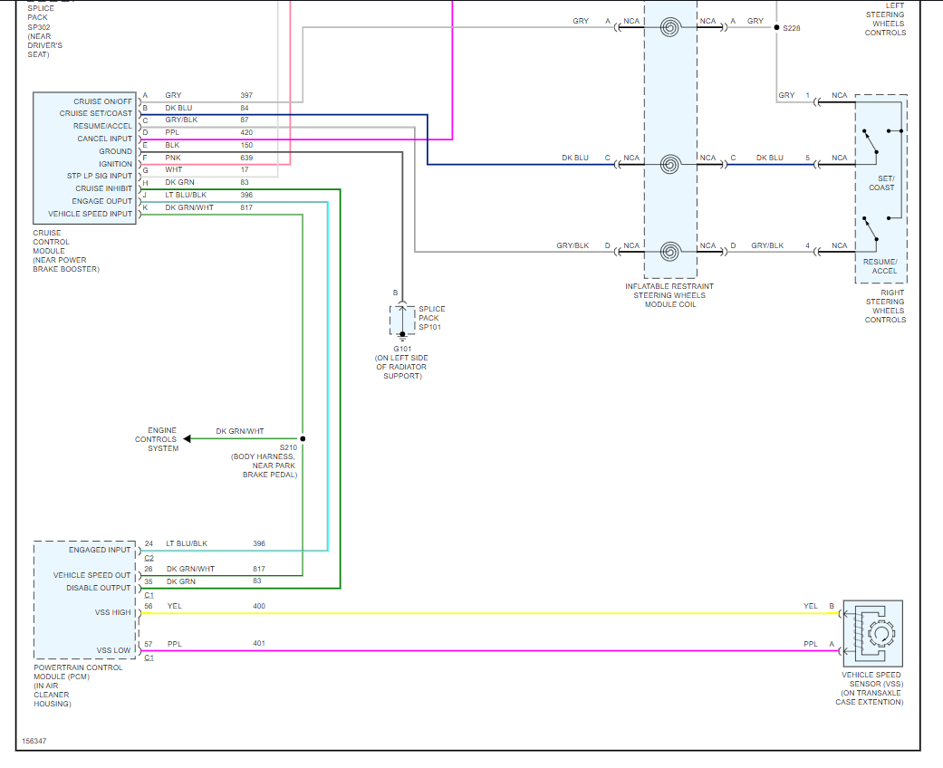

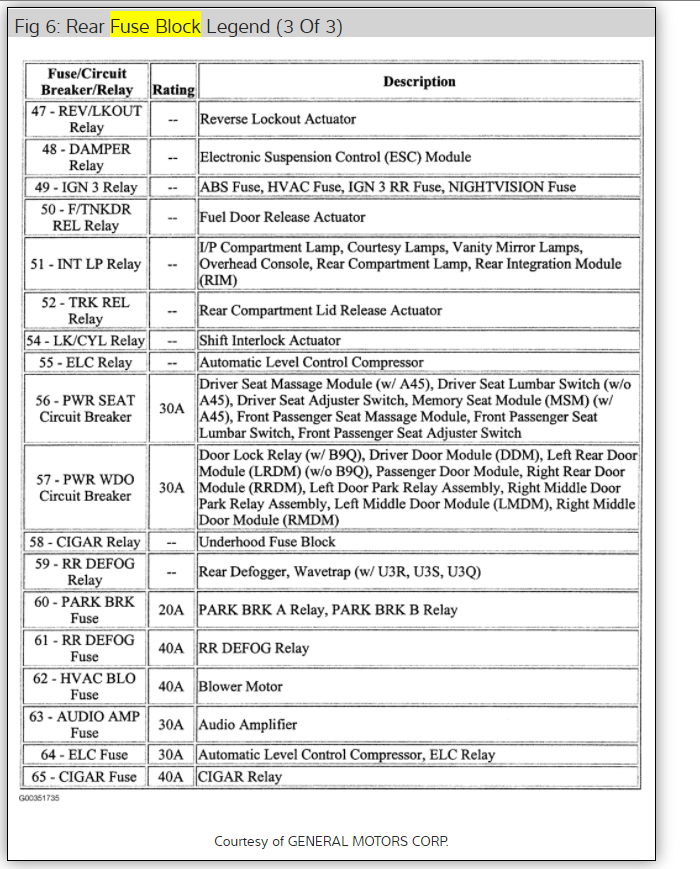

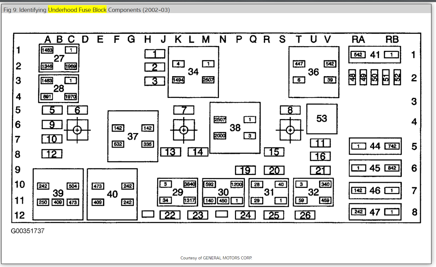

Check to make sure your brake lights are working right. If so it sounds like the clock spring in the steering wheel is out which is common but to be sure here is a guide to help check the writing with the cruise control wiring diagrams below so you can see how the system works and to be able to test the connections.

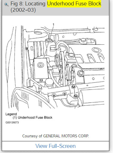

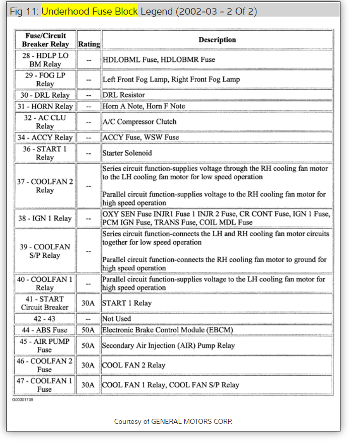

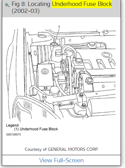

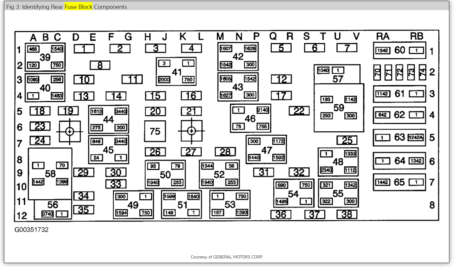

There are three fuses that run the system this guide will help you test the fuses with the fuse location below as well.
Check out the diagrams (Below). Please let us know what you find. We are interested to see what it is.

JAREDR123
  • 29 POSTS
Brake lights are working correctly and the cable is connected. Anything else?

Need to hook a scanner up to see what its doing when you push the buttons, you may have to have a mechanic look at it. Sorry

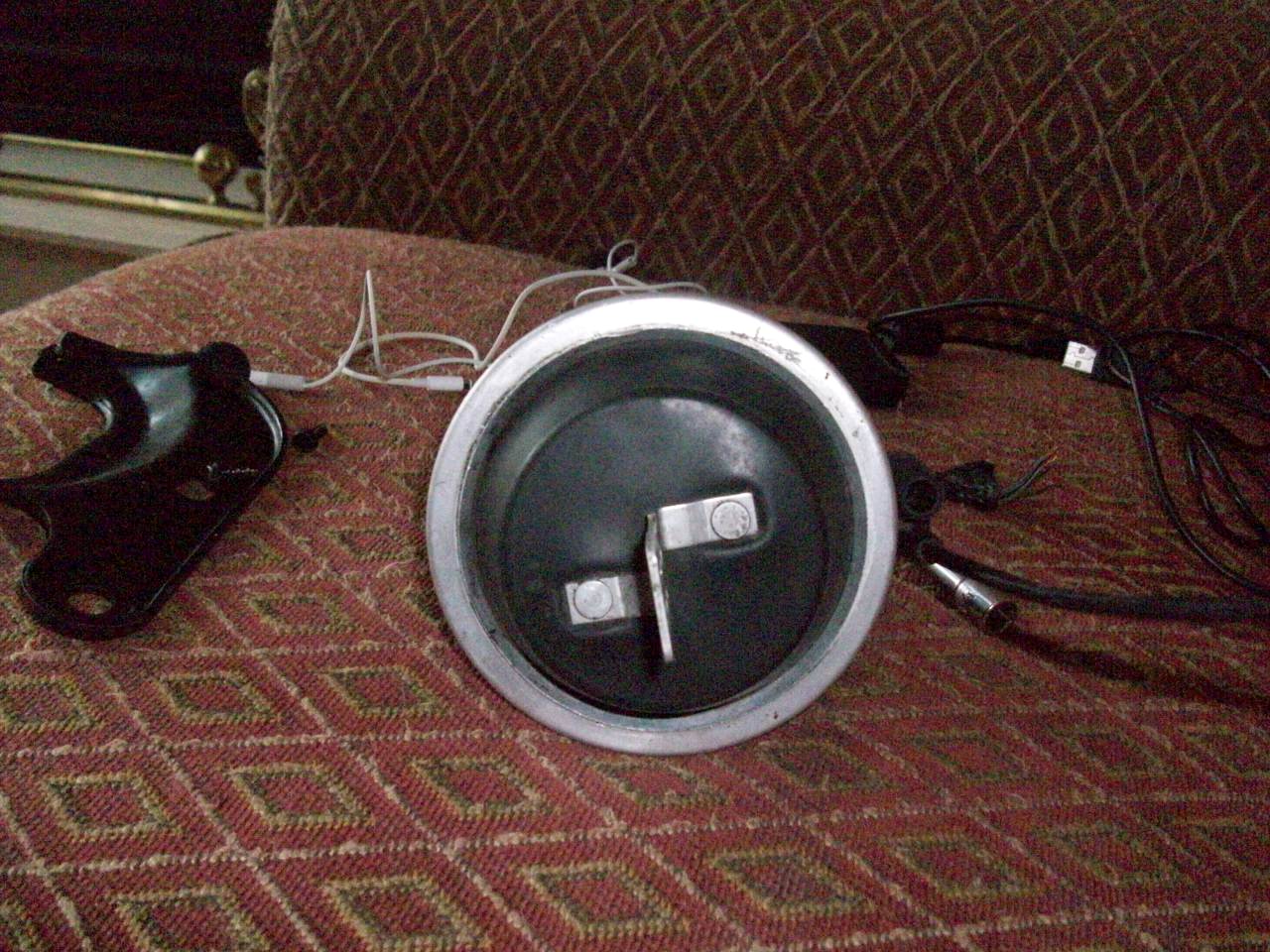

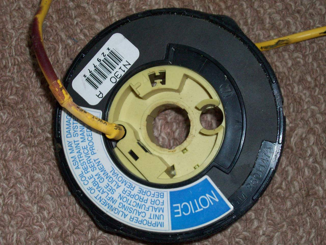

I have a 1992 cadillac deville and the cruise control will not work and the light on the display wont come on either. I was wondering is their a way to check the servo plug in conector. Also is their a way to see if the servo electrical parts are bad. Would the plug or the servo cause the cruise control not to work. Thanks.
Oct 26, 2020 at 5:25 AM (Merged)
CARADIODOC
  • 34,381 POSTS
Of course the cruise won't work if the servo has a problem, but when the dash light doesn't even turn on, the system isn't even trying to run the servo. A more common problem is a broken clock spring. That's a wound-up ribbon cable in a plastic housing under the steering wheel. As it continues to break, the horn will also stop working and the air bag light will turn on.

SEAN03
  • 523 POSTS
When you say broken clock spring does that mean it looks like a airbag inside the spring. Also when you say the plastic housing is under the steering wheel does that mean I have to take the steering wheel off or is it under the steering wheel collum. where can I get a scanner that displays the live data and what is the name of the scanner. Also do you have any diagrams or pictures to help. If not thats ok thanks for any help.
CARADIODOC
  • 34,381 POSTS
In the days before air bags, the connection to the horn button was made by what looked like a brass nail with a spring pushing it up to make contact with a brass ring under the steering wheel. That was sufficient for a horn. A wire would twist and break within a few days so that movable contact avoided that. There could be some dirt or grease get between those contacts and cause intermittent operation but the sliding action of turning the steering wheel would always overcome that and at worst, the horn would honk a few milliseconds after you pressed the button.
Those few milliseconds are not acceptable when referring to an air bag system. The timing of when it pops is critical to its performance and you can't rely on a sliding contact so the electrical connection has to be hard-wired. That's where the ribbon cable comes in. They do not normally break from repeated flexing. They're what's used in laptop screens and anything else that opens and closes a lot.
The air bag computer constantly monitors the integrity of the electrical connection to the air bag in the steering wheel. With the ignition switch on, the slightest momentary break in the circuit would set a diagnostic fault code and turn the system off. That won't happen when a ribbon cable is used. It's about four feet long and coiled inside the housing so it expands and contracts smoothly as you turn the steering wheel. As long as there are two wires in it for the air bag, it's no big deal to add two more wires for the horn and two more for all of the cruise control switches.
A sure-fire way to break a clock spring is to turn the steering wheel when the shaft is disconnected, as in when replacing a rack and pinion assembly or doing some other similar repair. If your steering wheel will turn four revolutions from full-left to full-right, the clock spring will be built to rotate about five revolutions to give it a little safety margin. It's important that the steering system be centered when a new clock spring is installed, as they always come locked in the centered position. If the steering system is one revolution to the side when you install a new clock spring, it will already be one turn off-center when you bring the steering back to center to drive straight ahead, then, when you have to make a turn all the way left or right, the clock spring will reach the end of its travel and be tugged off the rivets at the end where it makes the electrical connection, or it will expand too much and flip over on itself. After doing that a few times it will crack at the end of the cable. Even when it's installed correctly, it's only a matter of time before that ribbon cable will break.

When it comes to replacing the clock spring, the air bag has to be removed first from the steering wheel. I never did one on a Cadillac, but if it's like most cars, there is a nut to remove, then you need a steering wheel puller to remove the steering wheel. By this time you will have unplugged the air bag and cruise control and horn switches. Those wires come out of the clock spring housing. The housing is usually snapped in place with plastic fingers. The easiest way to see how they come off is to have the new one in hand to look at. I tried finding a picture of the part but didn't have any luck.
The wire for the air bag connects to the clock spring with a bright yellow connector. On some versions it is plugged into the backside of the clock spring housing. On other models it is a long wire that has to be pulled down the steering column and connects under the dash. I'm more familiar with the Chrysler products. Some of their older ones are like that. The connectors fit through a tube easier than you would expect, but I like to attach a pull-wire to the old connector, then when you pull it out, the pull-wire will be there to pull the new connector down.
For liability the service manuals always tell you to disconnect the battery before removing the air bag from the steering wheel, then wait two minutes for the storage capacitors in the computer to discharge. Once the air bag or any bright yellow connector in the system is disconnected, a shorting bar engages to connect both terminals so the air bag won't pop from static electricity. I've disconnected dozens of air bags without disconnecting customers' car batteries, but I understand how hard it is to accidentally deploy an air bag, and I know the precautions to follow. For a do-it-yourselfer, I recommend following the service manual procedures just to be safe.

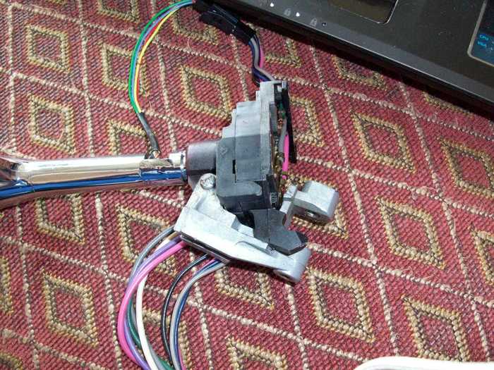

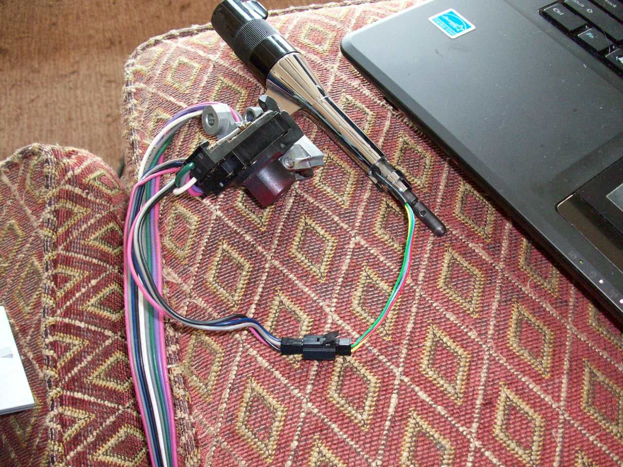

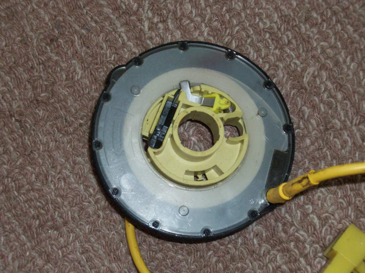

SEAN03
  • 523 POSTS

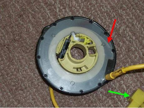

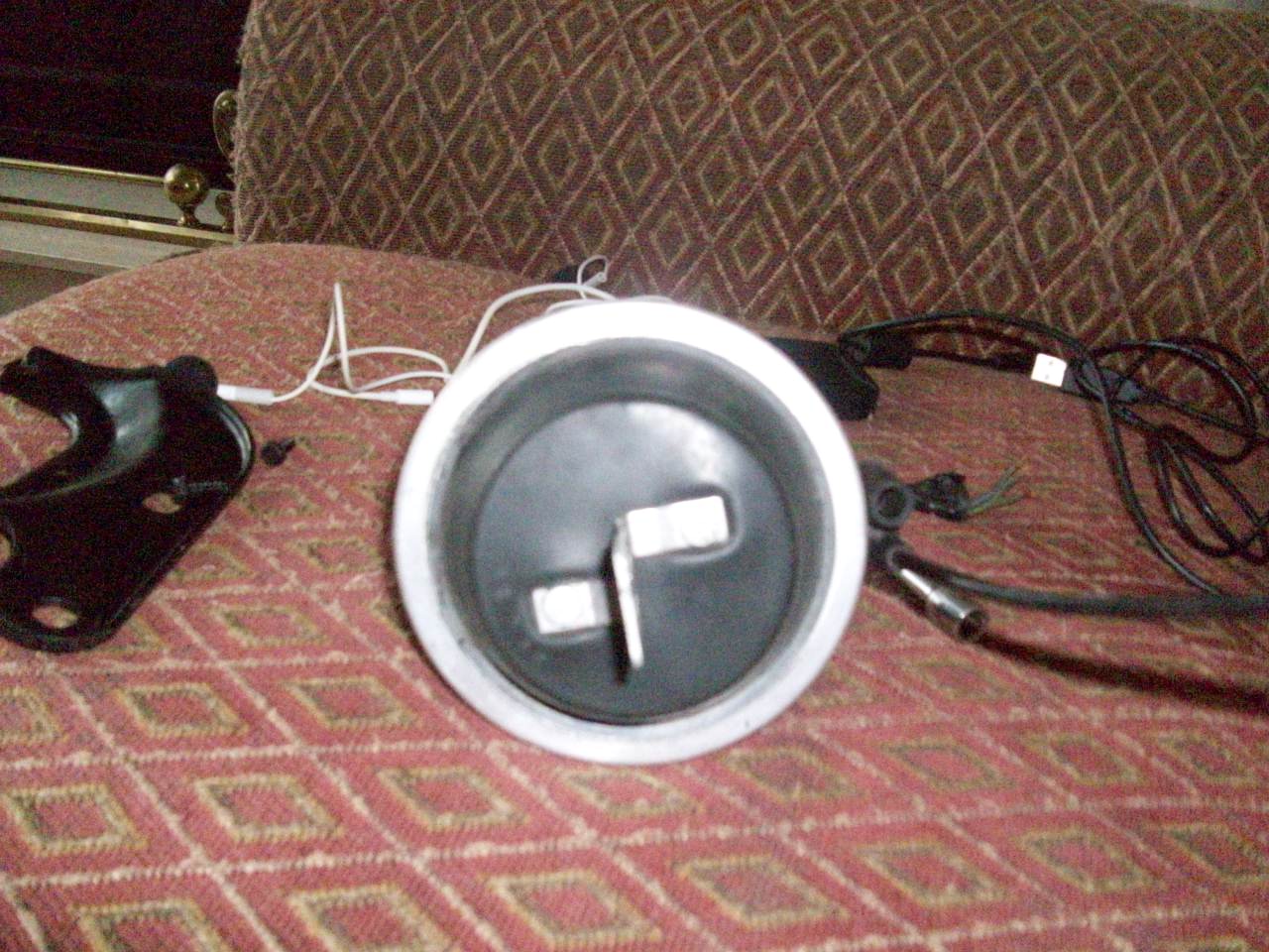

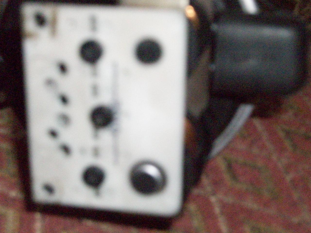

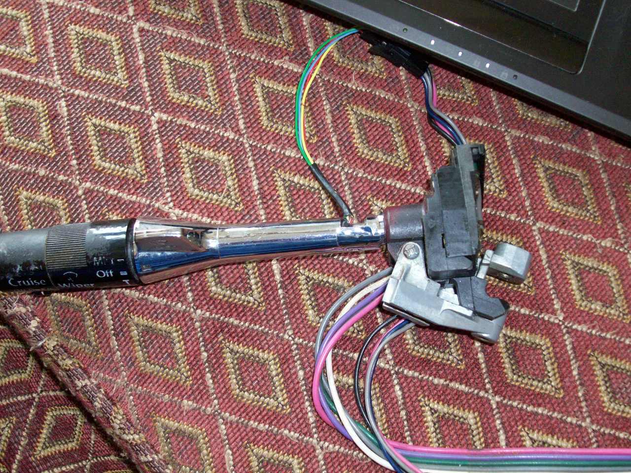

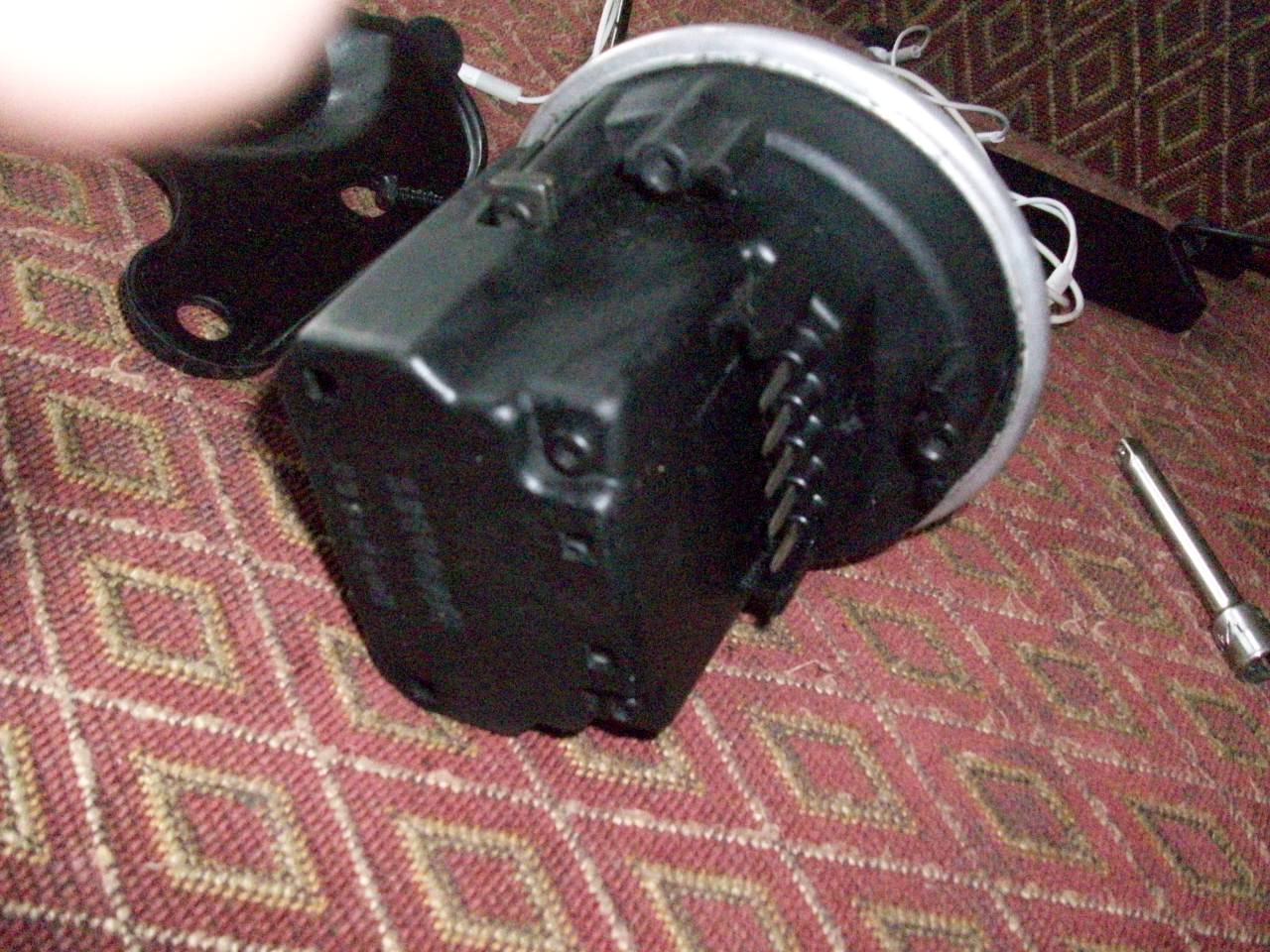

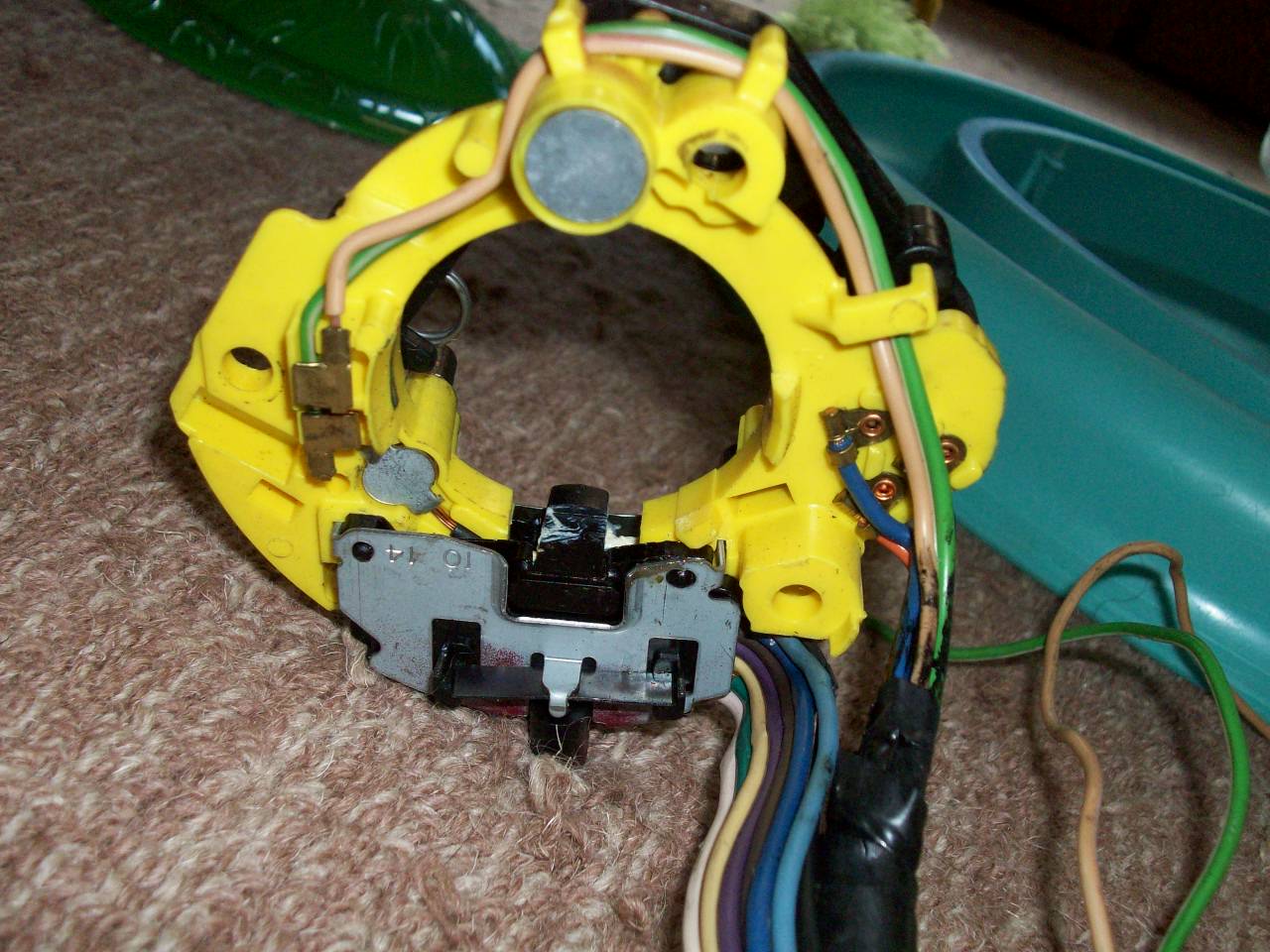

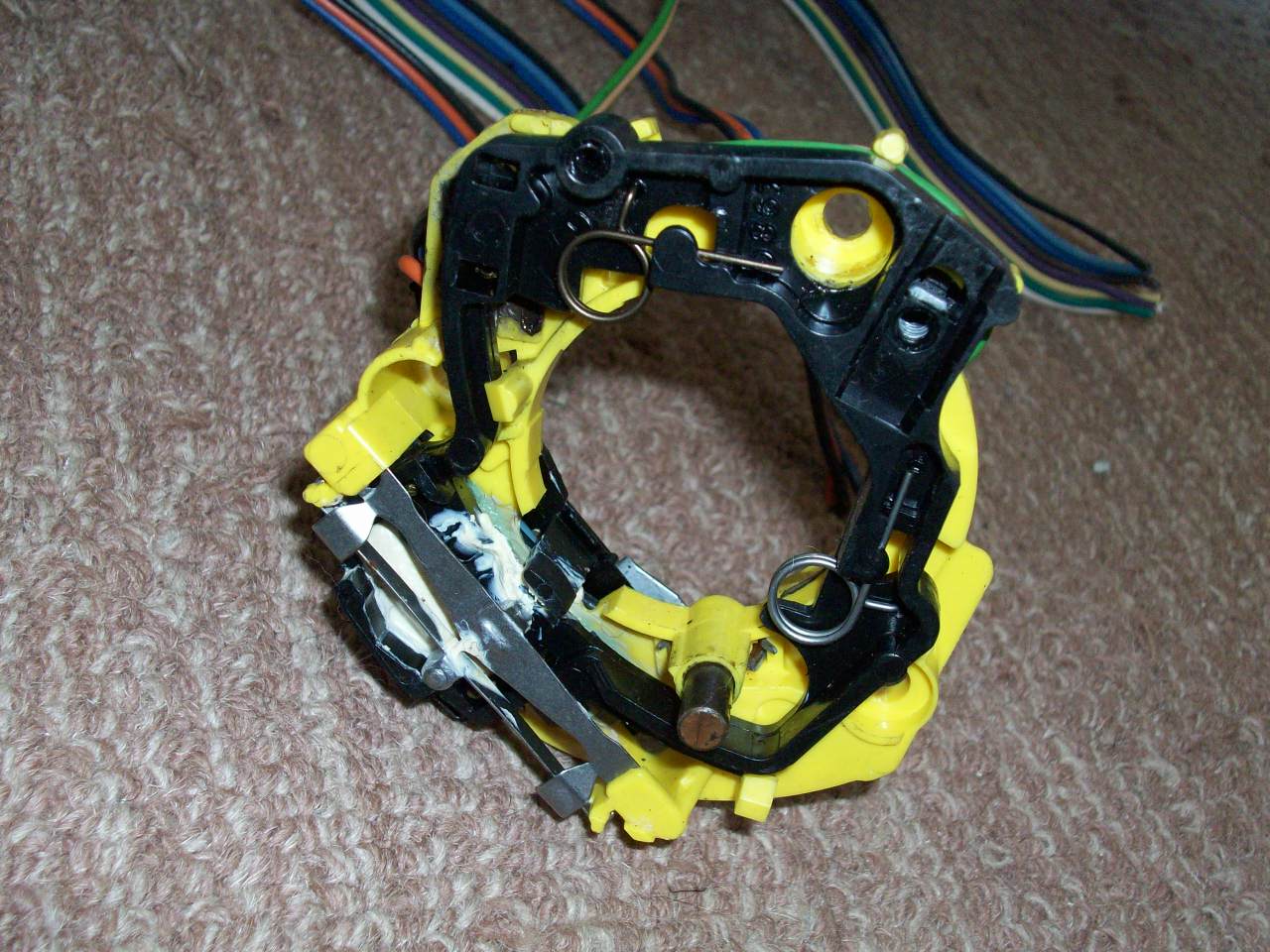

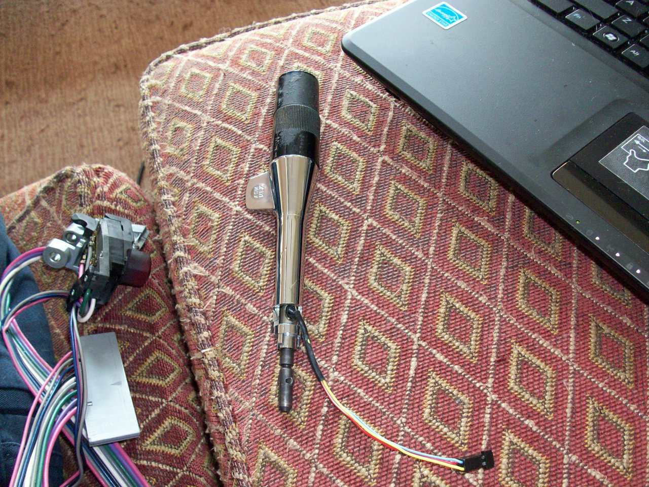

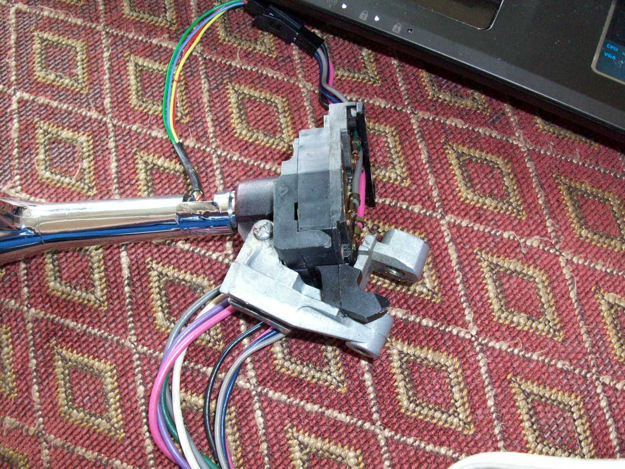

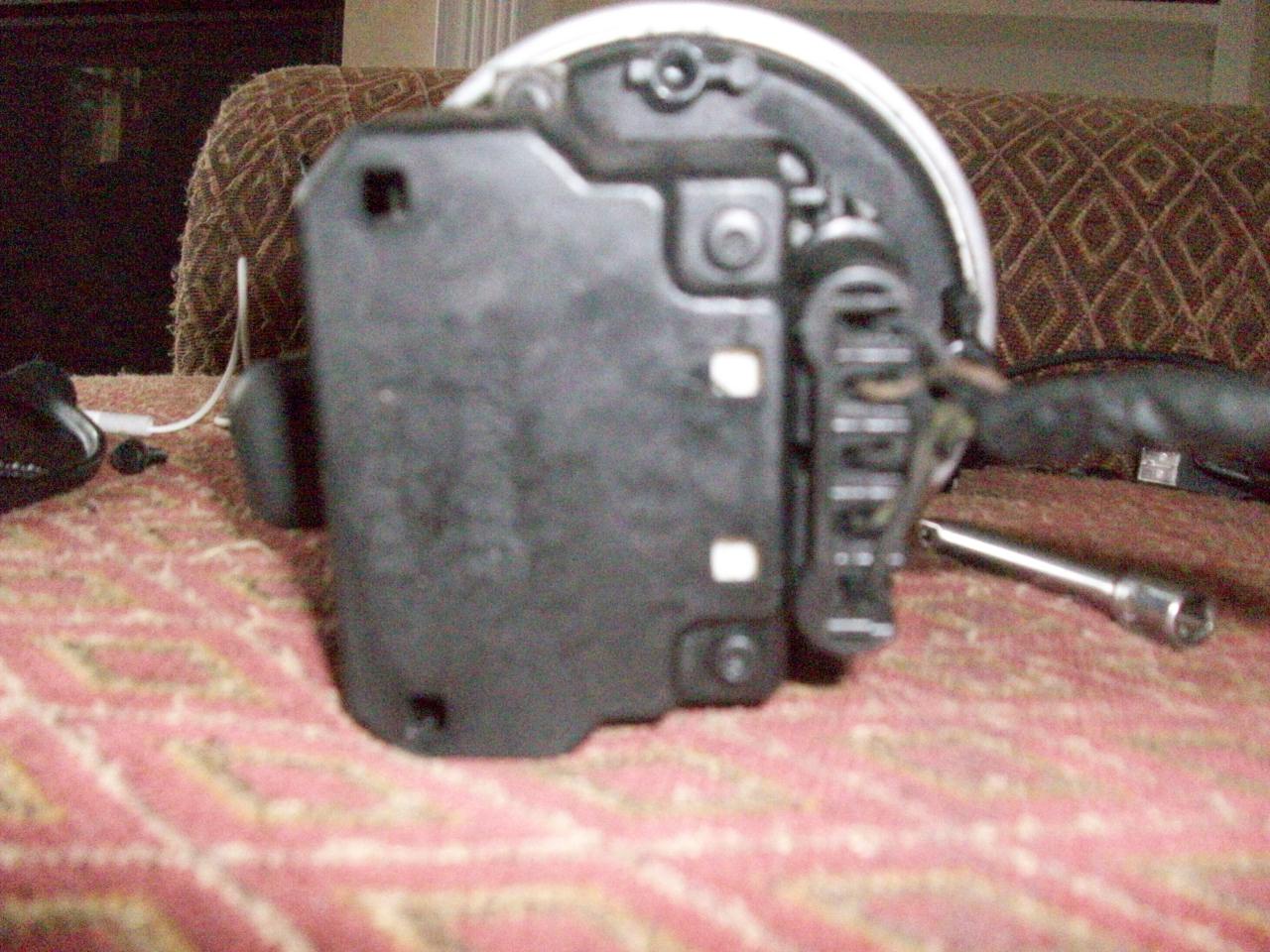

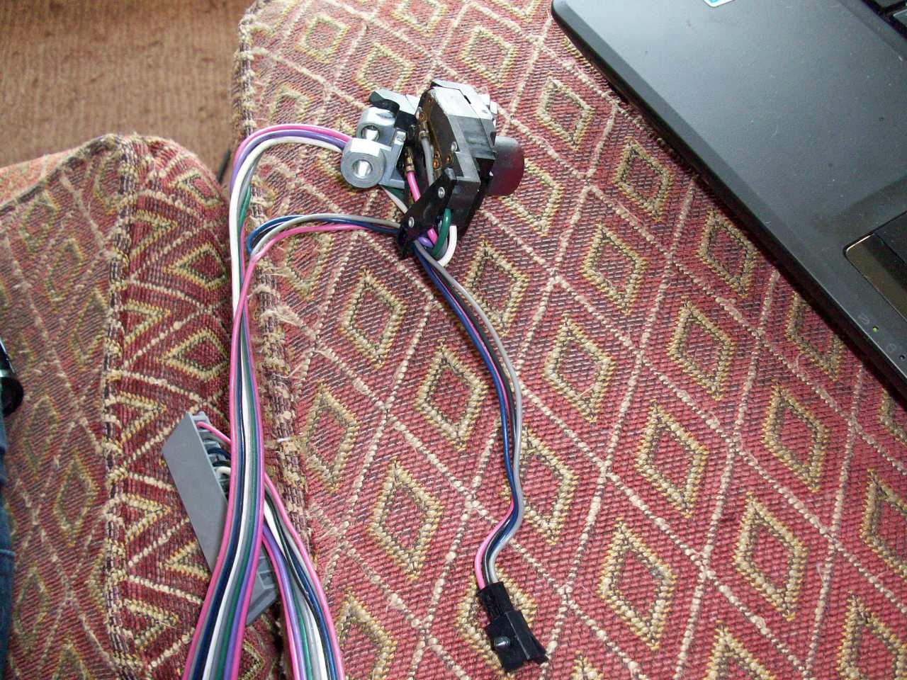

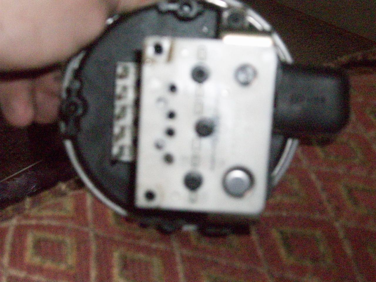

I Am showing 4 pictures. They are front and back of them. So it is actually only two. Is one of the two the clock spring. Thanks.
CARADIODOC
  • 34,381 POSTS
The two photos on the left are of the clock spring. The two on the right are the turn signal switch.
I don't see any electrical connections for the horn or cruise control switches. Thinking back, GM used to put the cruise control switches on the turn signal lever. I'm sorry I didn't think of that sooner. As I recall, the windshield washer button on the end was a high-failure item so there were aftermarket companies making replacement switches. You could find them at almost any auto parts store and they weren't real expensive.
You can likely find a used switch assembly to try at any salvage yard. The switch pulls straight out away from the steering column. Just give it a tug. There will be some wires that pull out with it. That small harness has to be unplugged down at the base of the steering column under the dash. It will not have a regular plastic connector body like you're used to seeing. The connector is actually a small piece of double-sided circuit board, about 1/2" by 3/4" and will be slid into a regular connector. There should be a thin plastic finger on the connector to lift up, then the board will slide out.
Plug the replacement switch into the connector on your car to try it. If it solves the problem, you'll see a small hole in the board. That is to attach a thin wire, then when you pull the old harness out, that wire will come along and can be used to pull the replacement harness back down inside the column.
The good news is the clock spring is not involved with this problem, but I don't see where the horn wires go through it. I added a red arrow to point to one end of the ribbon cable. You can see it through the rear cover. I'm more familiar with Chrysler clock springs. The housings look almost identical but the rear cover can be removed with tiny screws, and they have the connector for the horn and cruise switches. This one is sealed by melting over the plastic pins on the cover. It looks like this ribbon cable is fully wound up. The Chrysler units are locked in the centered position. They have two buttons that are pressed down to unlock it by the steering wheel when it is installed. The lock on this one might be that bright yellow spring-loaded lever to the left of my red arrow.
The green arrow points to the air bag connector. It is bright yellow signifying it's in the "initiator" circuit. That's the circuit that sends the voltage pulse to fire the air bag. Chrysler also calls that the "squib". I don't know if that's an industry-standard term. Most manufacturers state to replace the clock spring when a deployed air bag is being replaced because that connector is usually melted from the heat of the burning rocket fuel.

Hey cadieman. I worked on the cruise control today. I put the switch back in and connected it. I made it to where you cannot blow through it unless you toch the brake. The yellow cruise light still does not come on. What do I need to do now. Will the yellow light come on if I drive it or should it come on when I start it up. The cruise on the lever is set to on but the light wont come on. At one point this car was broken into. Some one tried to steal it but couldnt. They tore a bunch of wires out under the steering colum. We had to buy a new collum and ignition cylinder because they broke that to. Thanks.

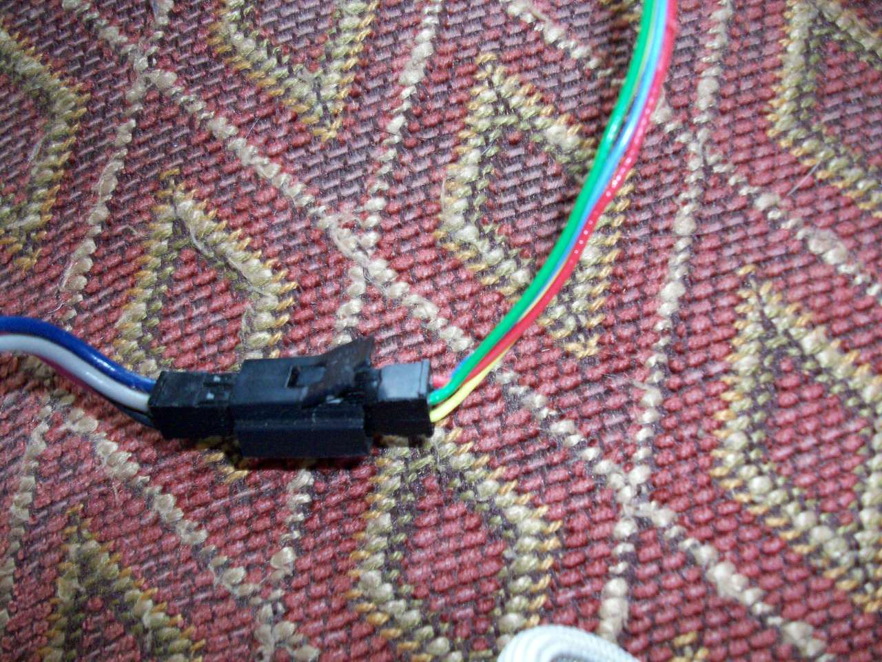

hey I checked it again the red and blue wire where it plugs in has power. However the green and yellow wire has no power. Here is some pics of what I am testing. Thanks
