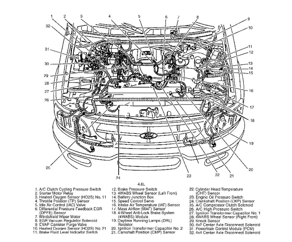

hmac 300, hello, well the truck is an 02 ford f150, 4.6 lt. with 269530 miles. I did see that the anti-theft runs several things. but a mechanic told us that the problem was the censor, I hope that's all. now to see if I can change it myself. thanks
Aug 3, 2020 at 5:11 AM (Merged)
HMAC300
  • 48,601 POSTS
see pic for location

HMAC300
  • 48,601 POSTS
do what I said in the very first reply the pic I sent should point out the coils reset your anti theft like I said as well if no manual look online check all fuses underhood as well as fuel pump relay. you can switch another realy that has the same configuration as the fuel pump one.

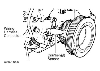

WERE IS THE CRANKSHAFT SENSOR LOCATED ON A 2002 FORD F150. 4.6LITER & HOW DO YOU REMOVE IT AND PUT ONE ON?
Aug 3, 2020 at 5:12 AM (Merged)
DAVE H
  • 13,384 POSTS
Crankshaft position sensor: Note: Engine design precisely locates Crankshaft Position (CKP) sensor. No CKP sensor adjustment is necessary. Removal and Installation: Disconnect negative battery cable. Raise and support vehicle. Remove A/C compressor to gain access. Disconnect crankshaft position (CKP) sensor wire connector from engine harness. See figure 5 . Remove CKP sensor mounting screws. Remove CKP sensor. To install, reverse removal procedure. Tighten fasteners to specification. See torque specifications.
