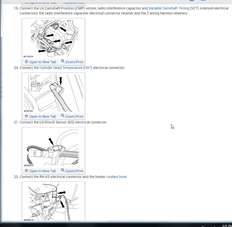

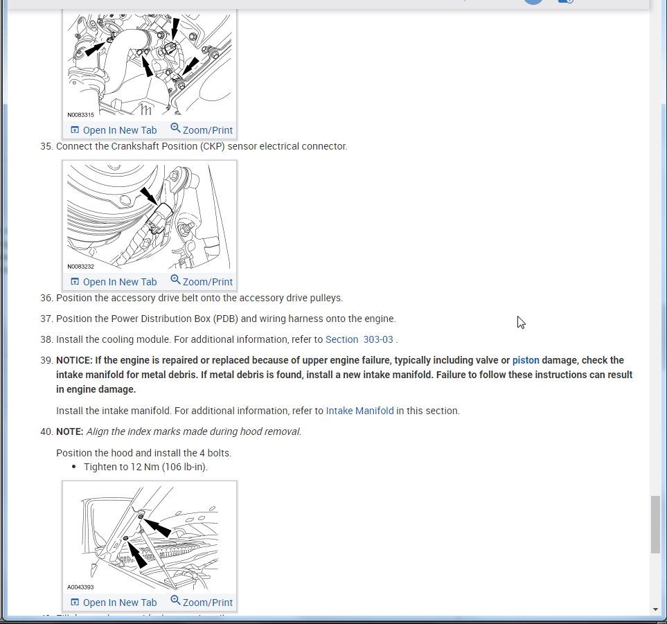

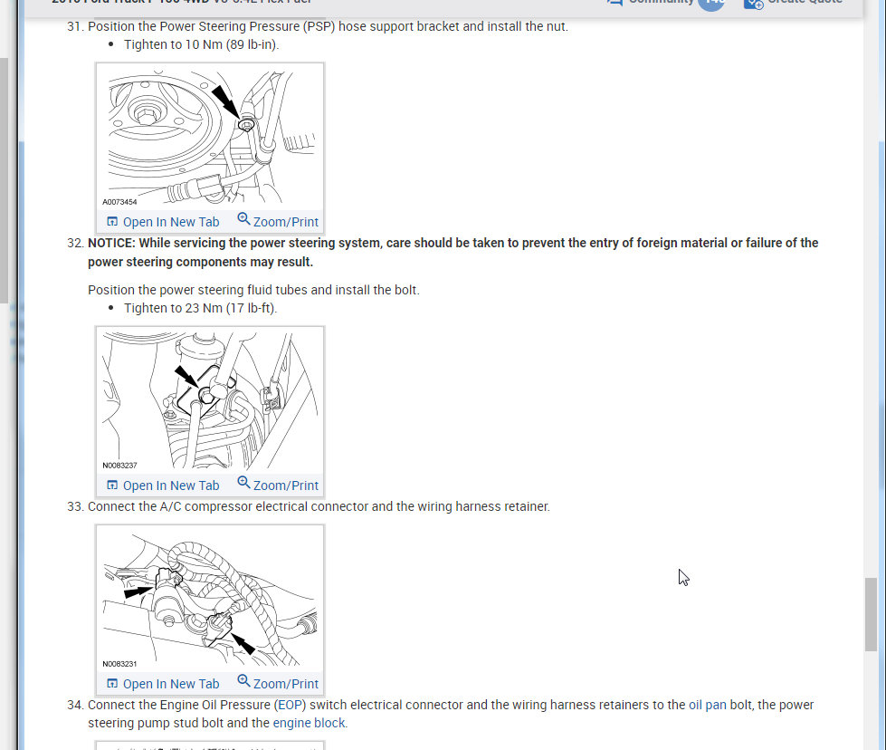

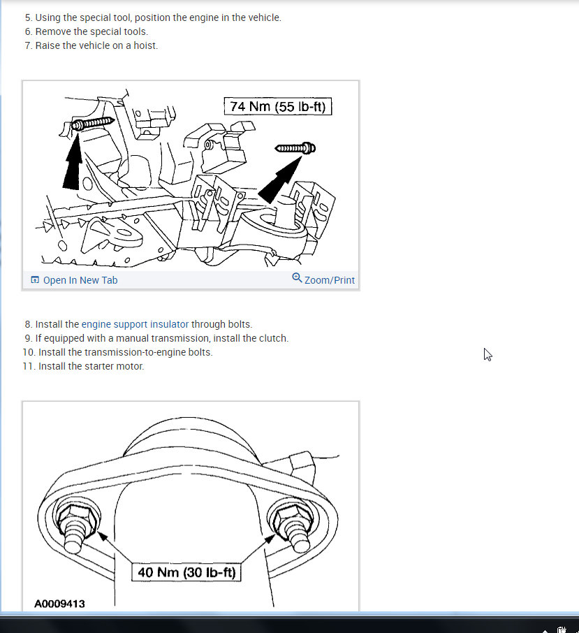

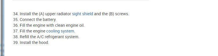

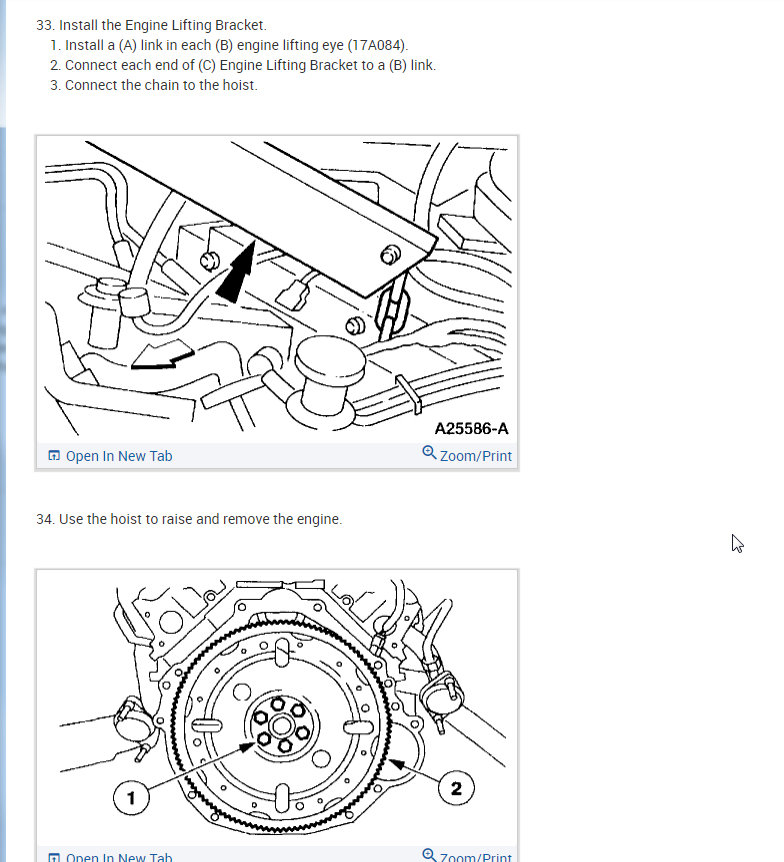

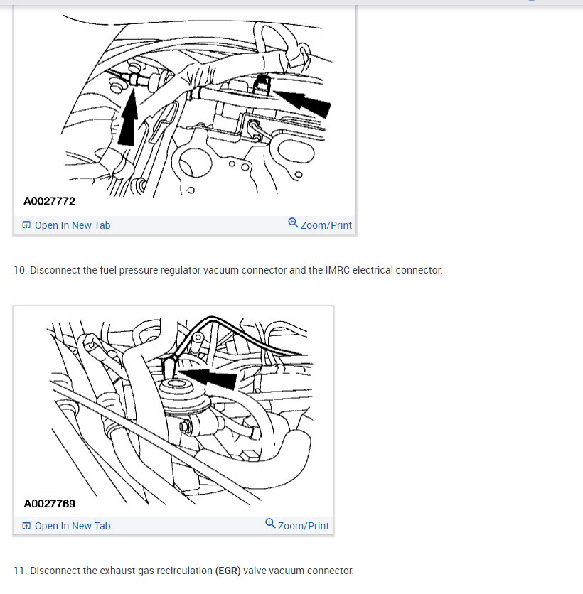

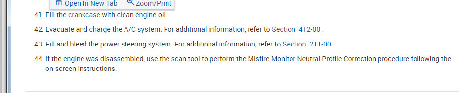

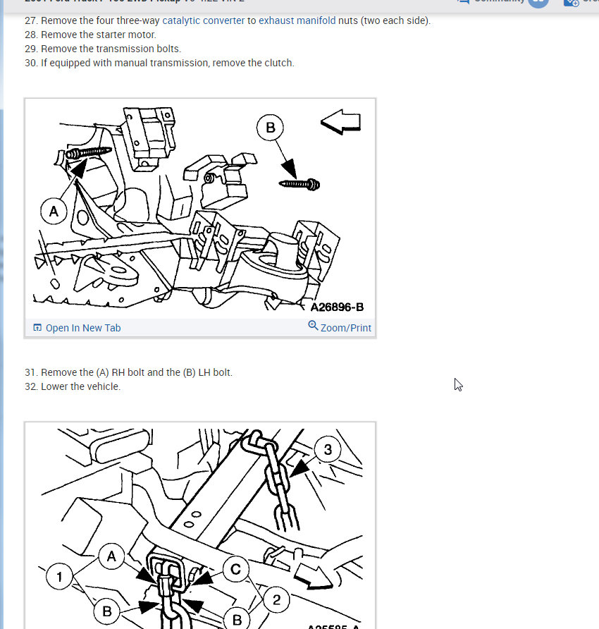

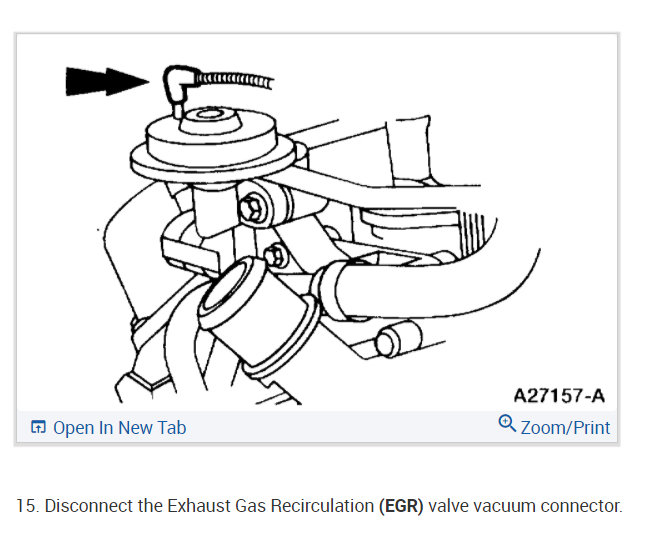

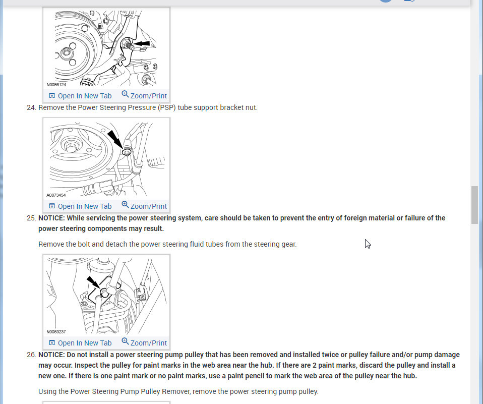

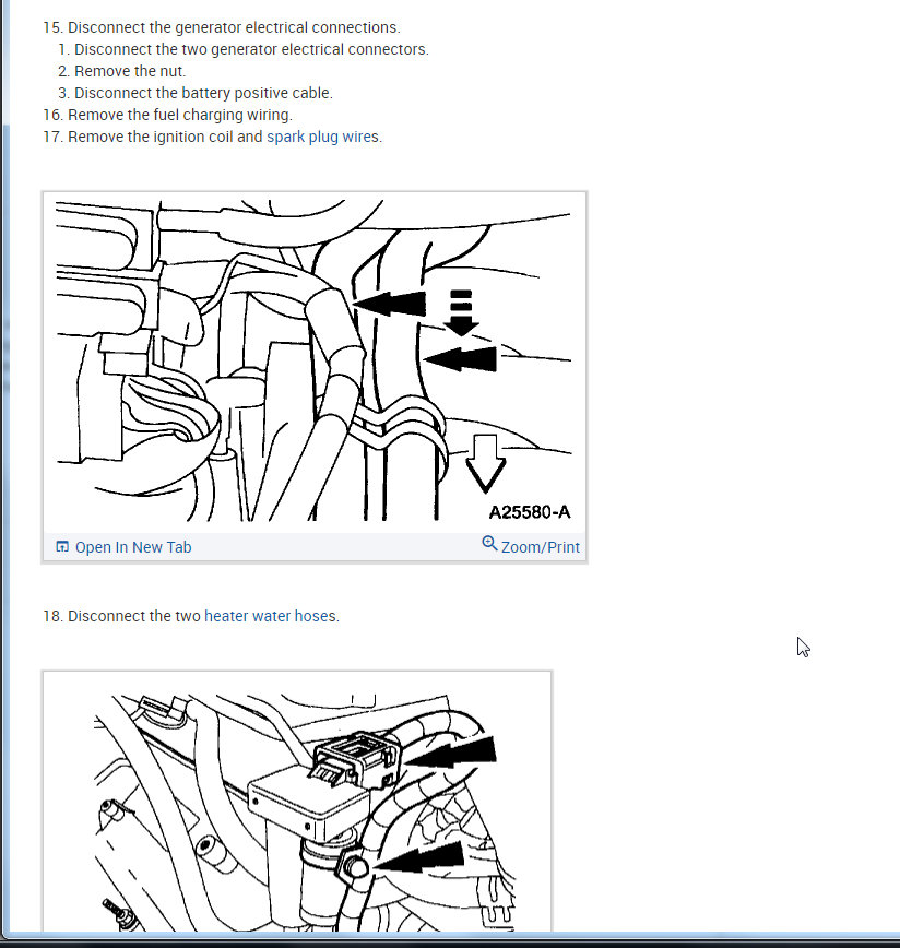

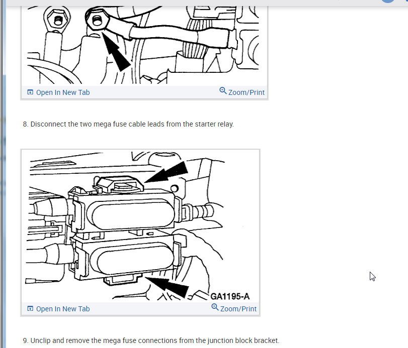

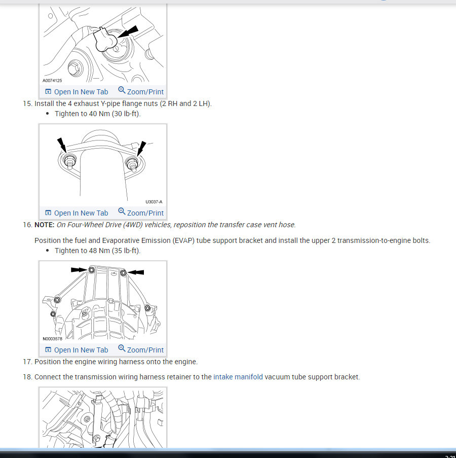

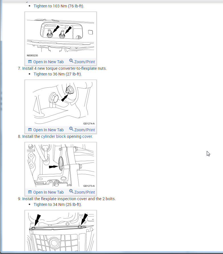

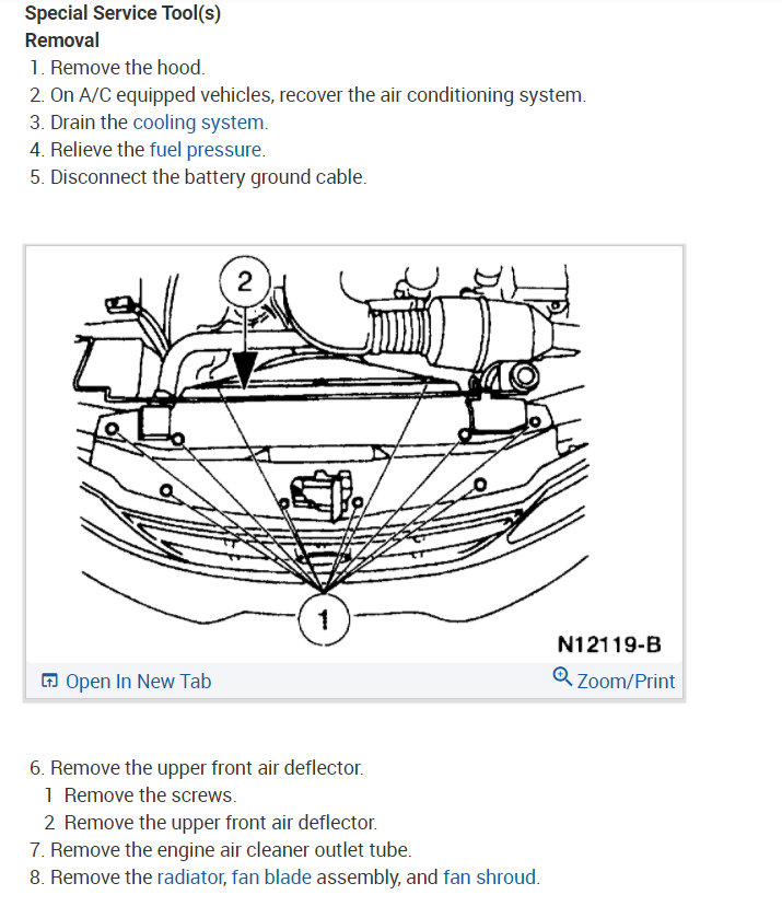

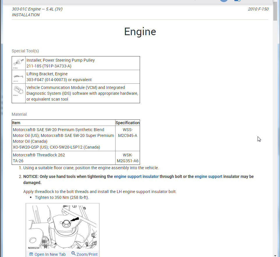

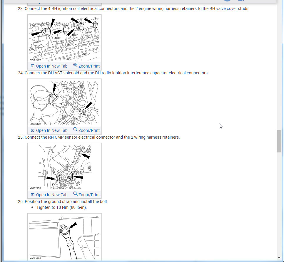

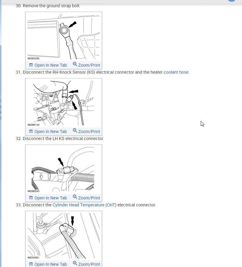

I have a truck with a 5.4L 3valve engine (VIN 8th digit V) and I needs the engine replaced. I recently purchased a 2004 f150 with a strong running 5.4L 3valve (VIN 8th digit 5) and I'm wondering if I could swap the engine from the 04 into the 10?
Apr 3, 2017 at 12:34 AM
Yes. You can use this engine but you may need to get a generic controller so that you don't have issues with the security system or performance parameters.
However, the engine will just bolt up with no issues.

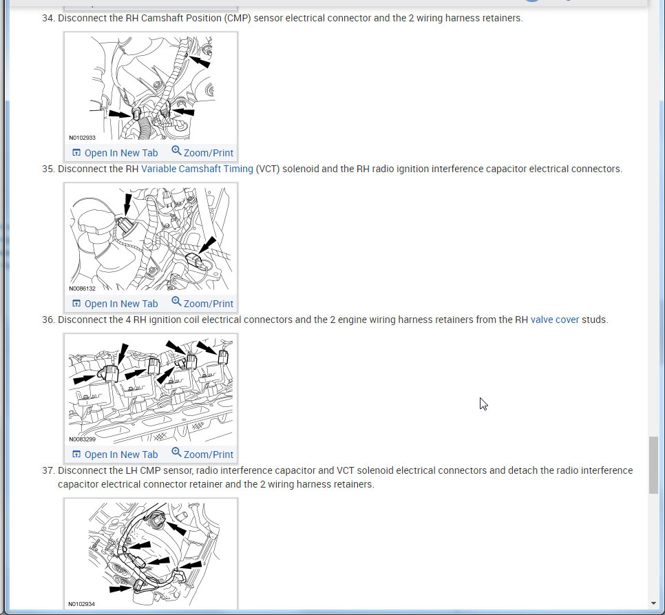

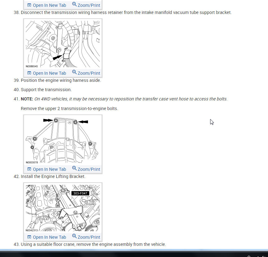

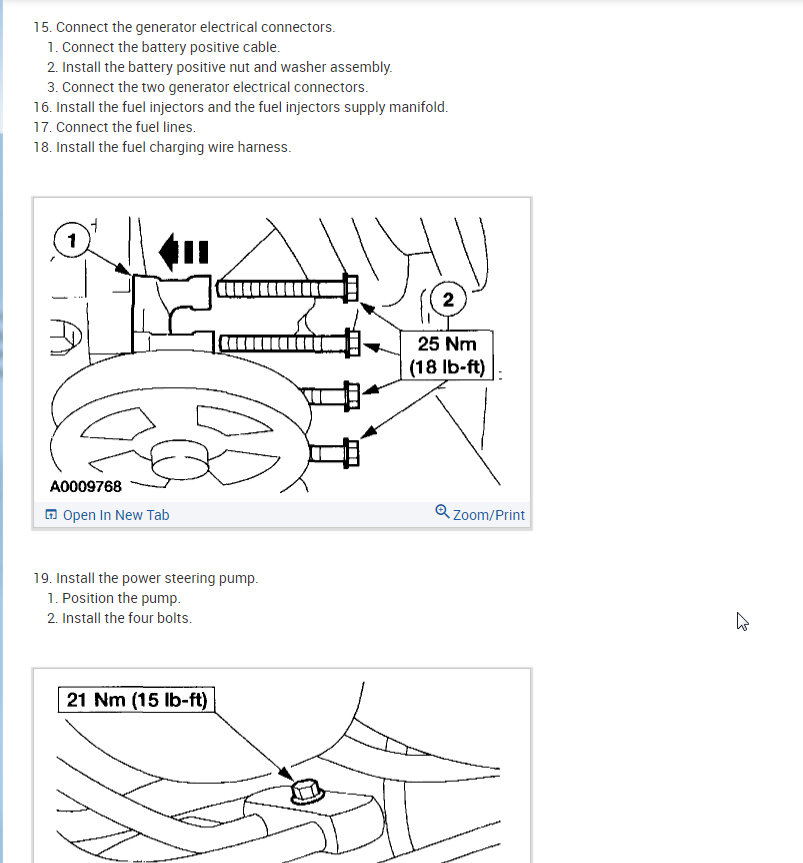

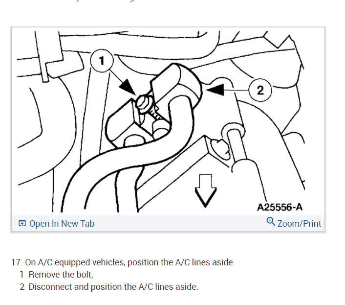

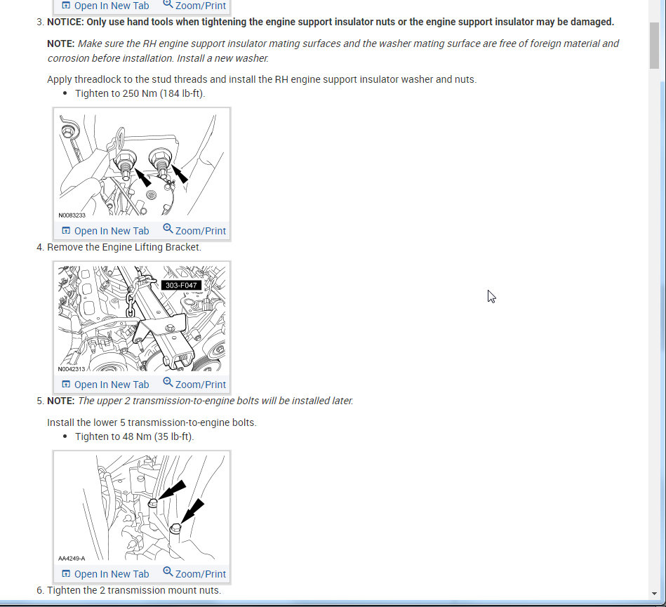

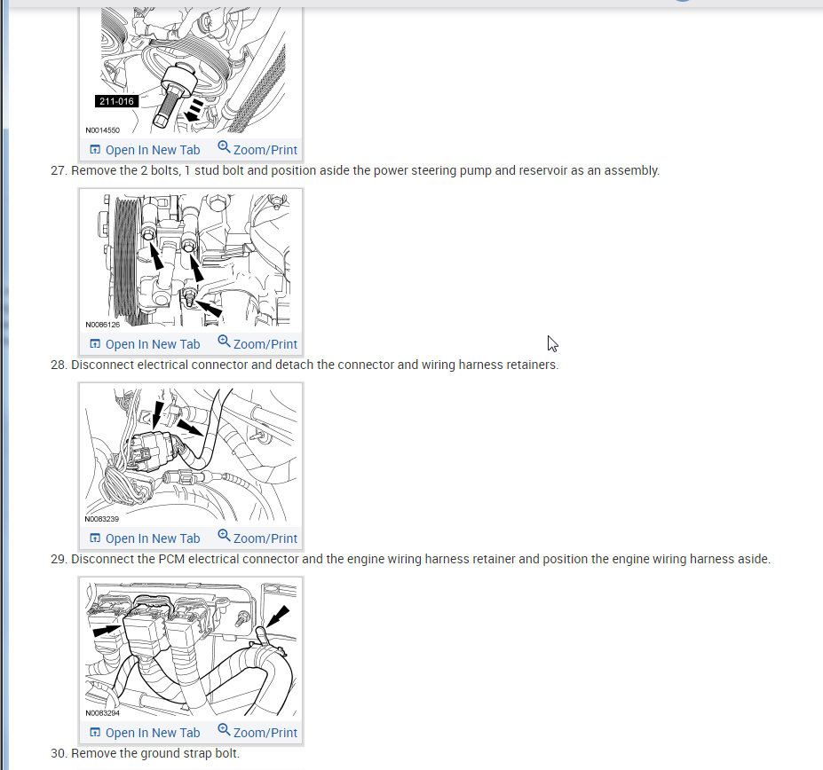

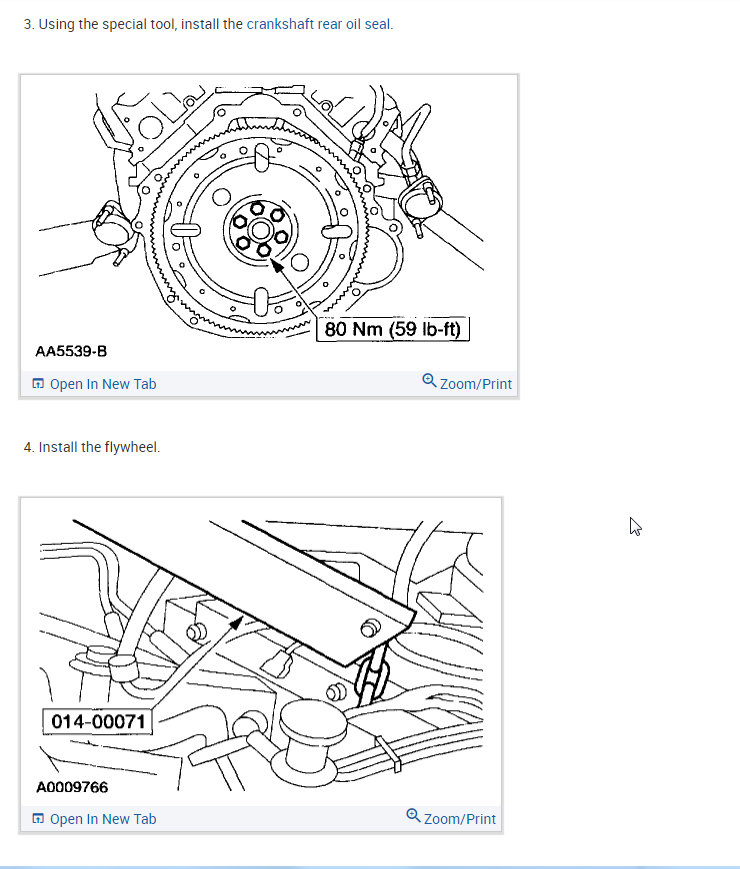

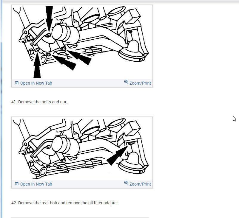

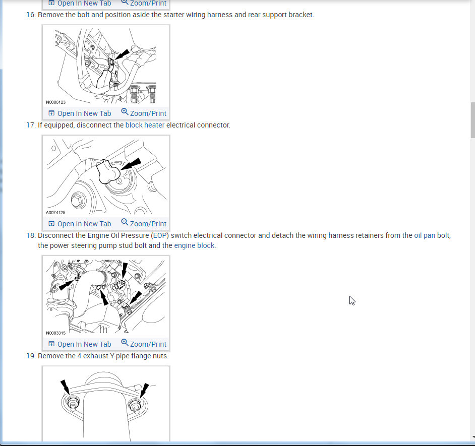

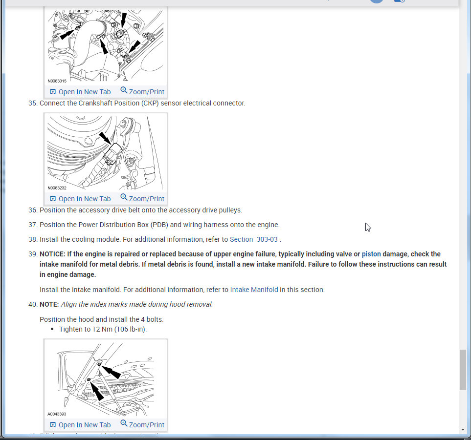

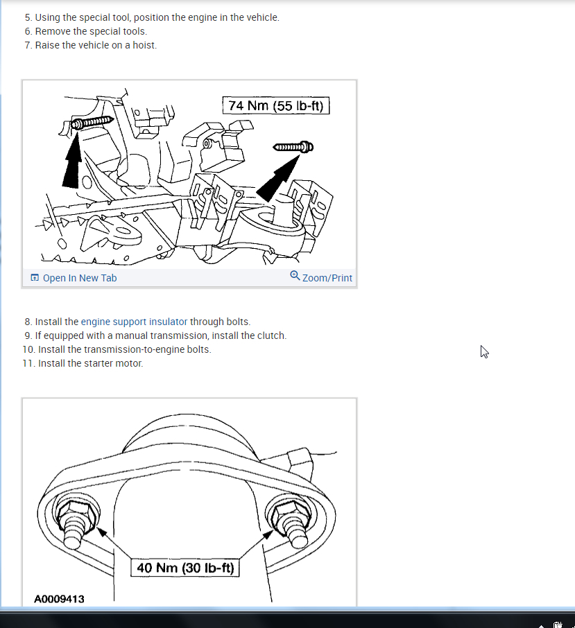

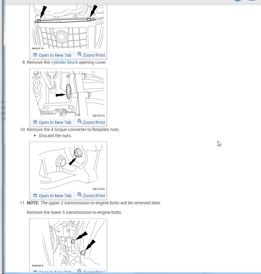

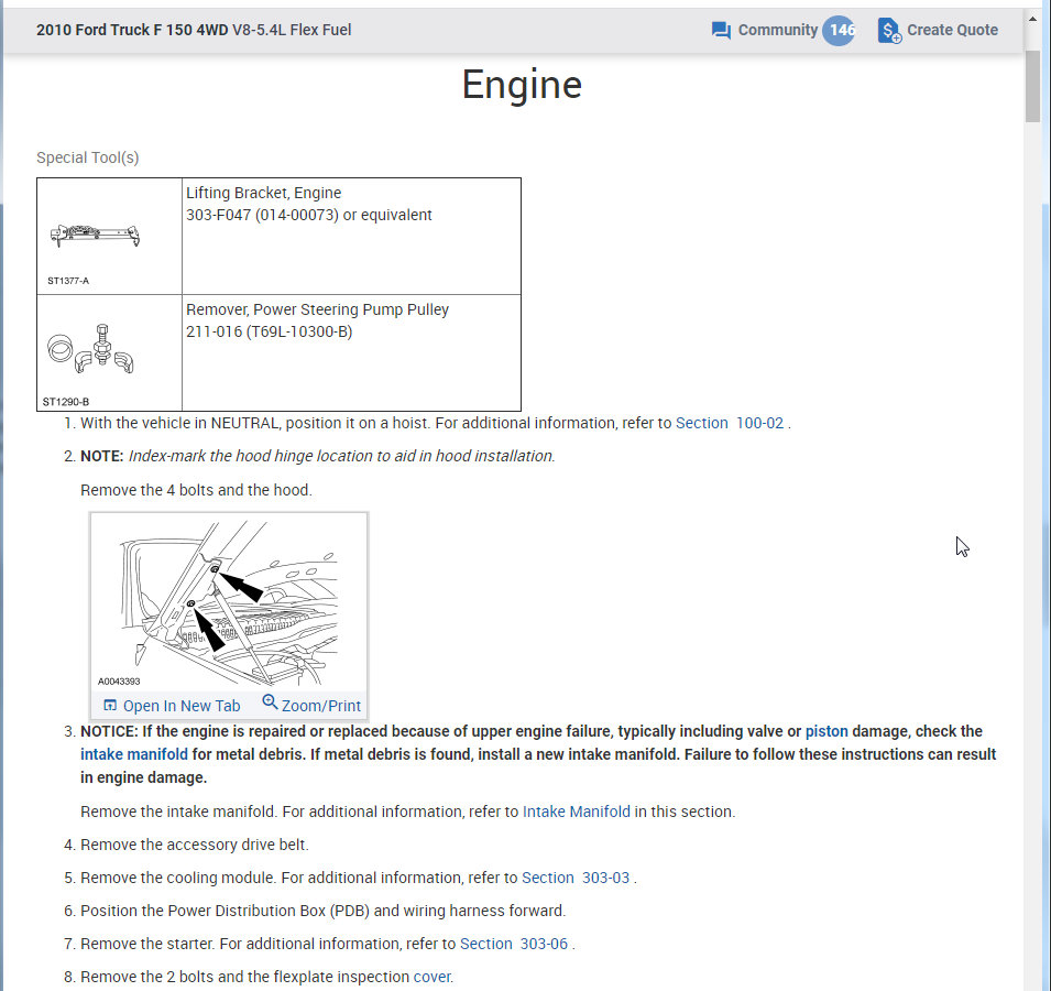

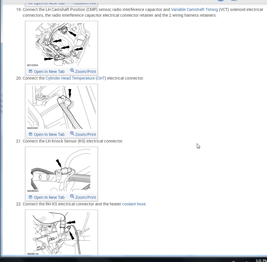

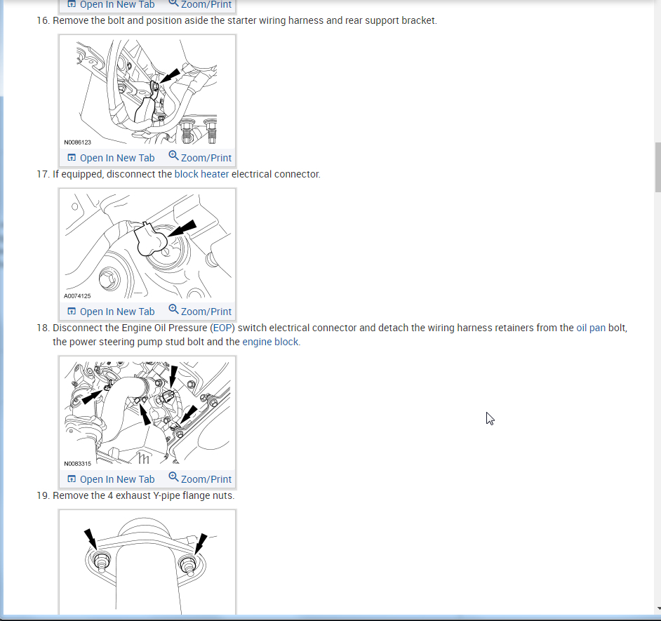

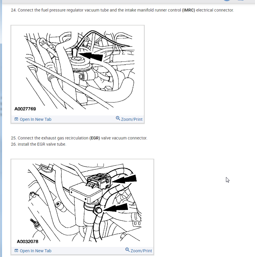

Below are the instructions from the manual on how to replace this. Let us know what questions you have. Thanks
Feb 9, 2021 at 4:26 AM
Good afternoon,
Yes, you can.
You will need to make sure you change over any exxternals that may be different.
I attached a youtube video of the procedure for you.
https://www.youtube.com/watch?v=EA-wi56daBQ

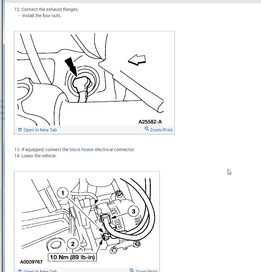

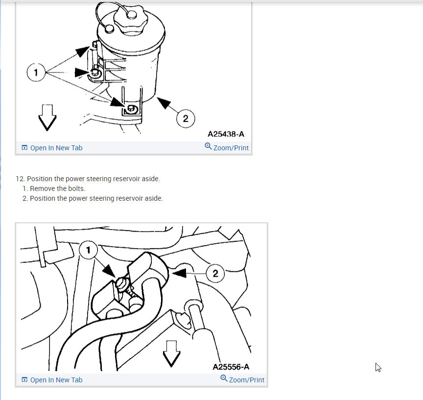

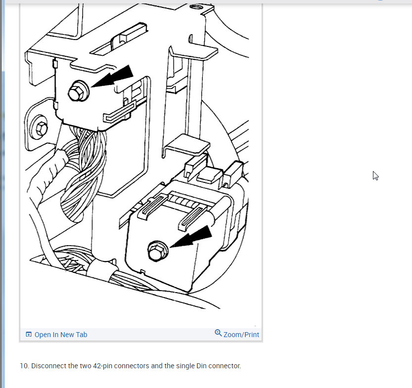

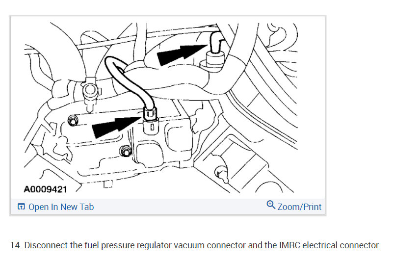

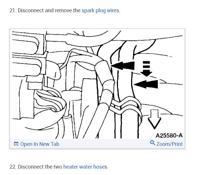

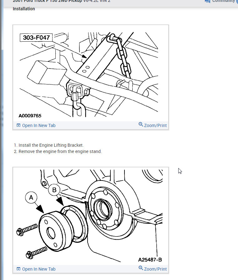

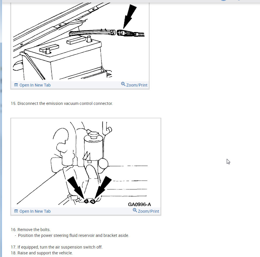

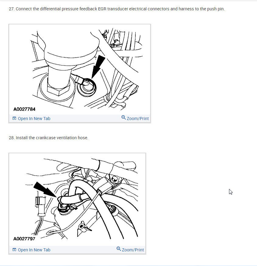

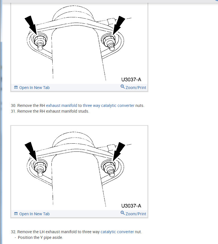

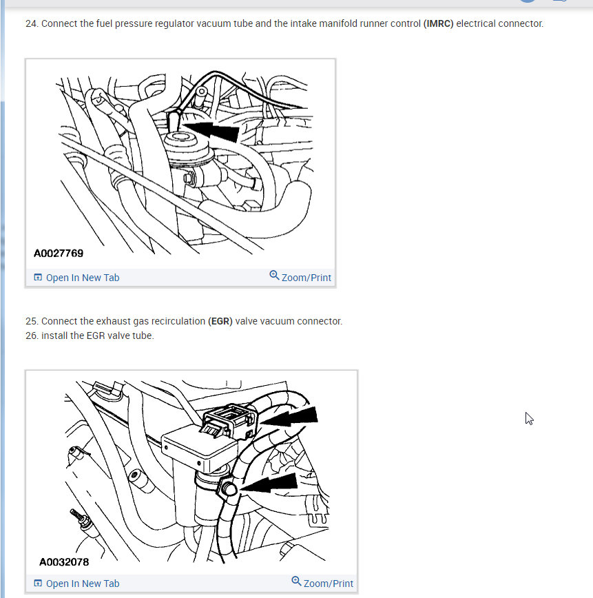

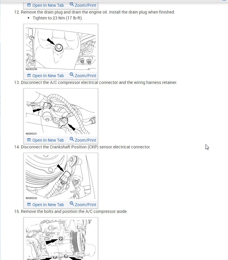

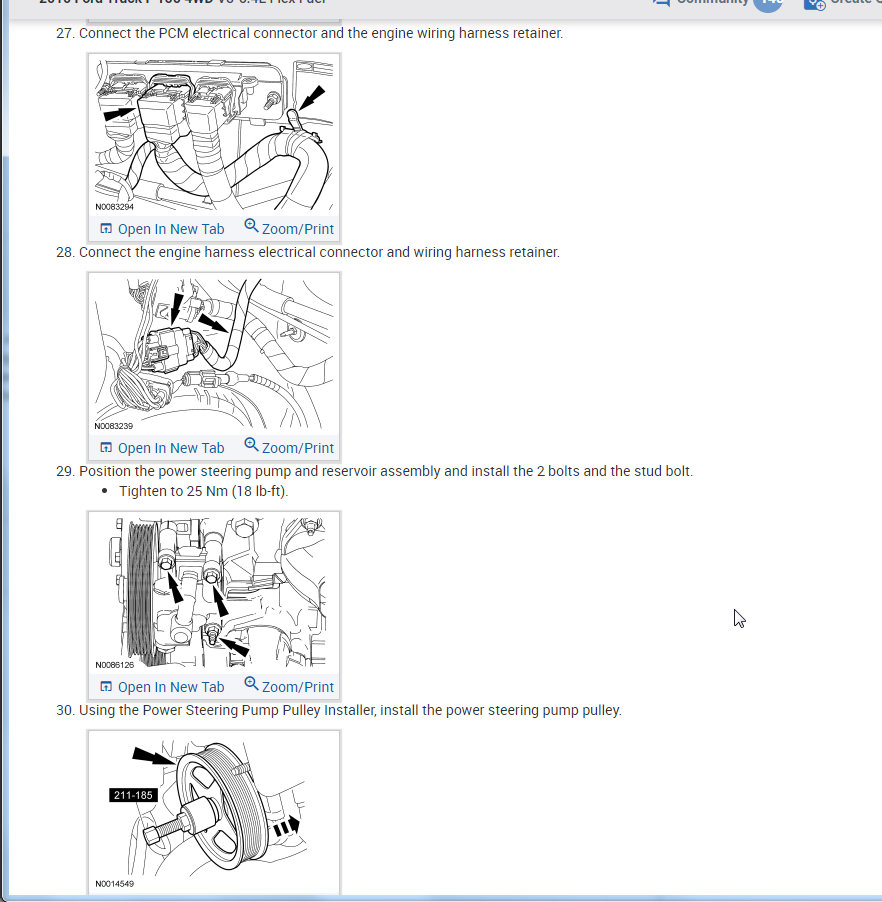

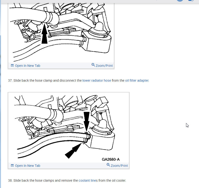

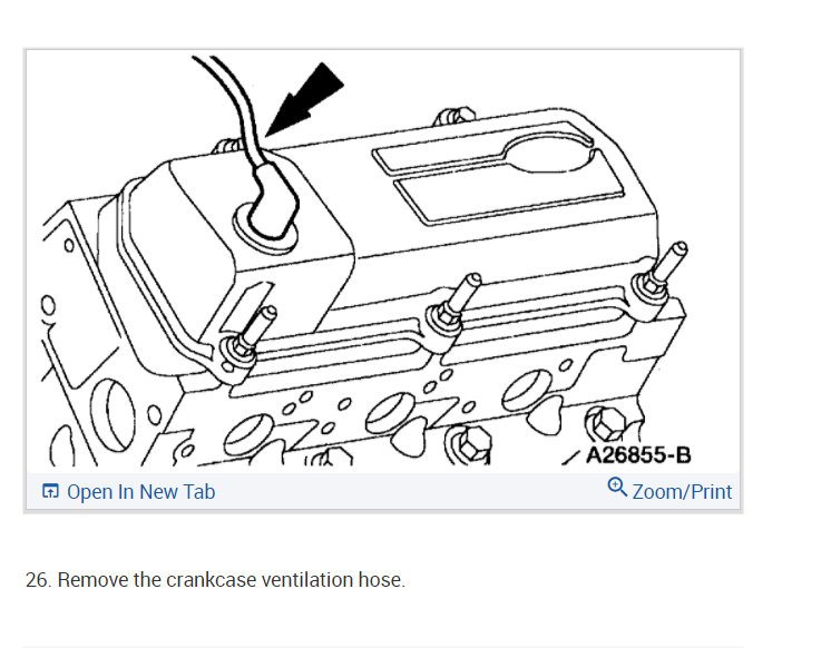

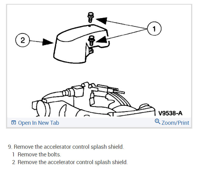

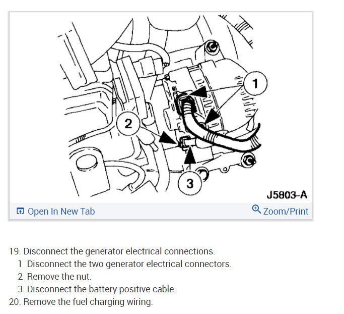

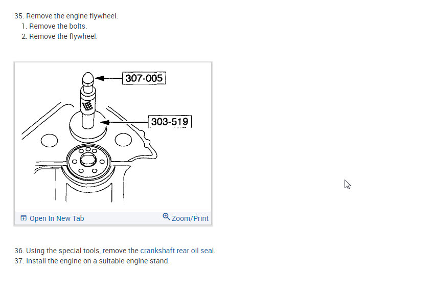

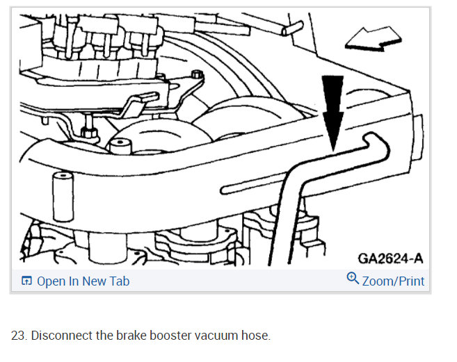

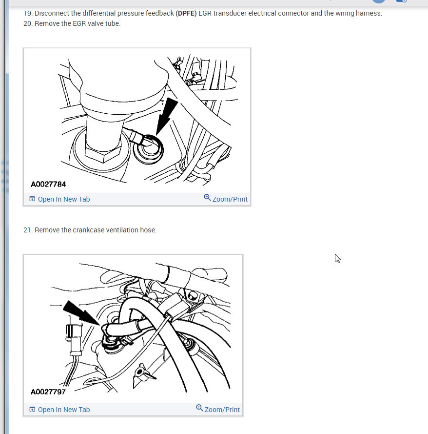

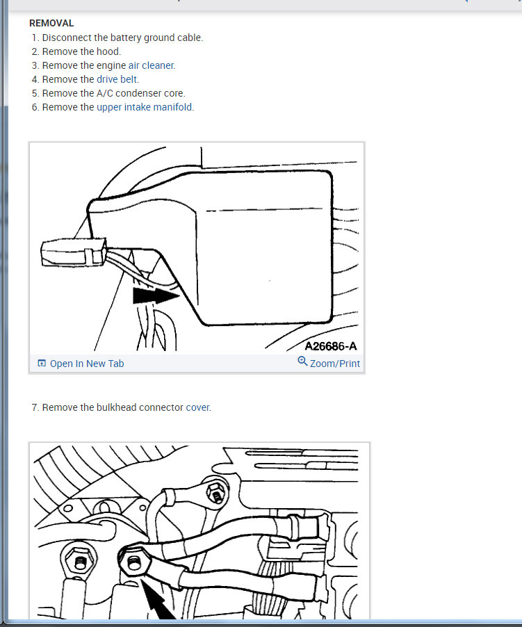

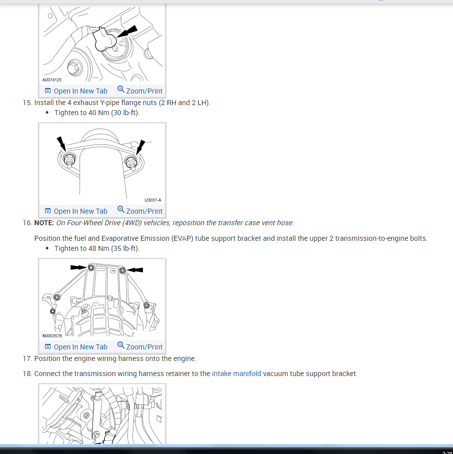

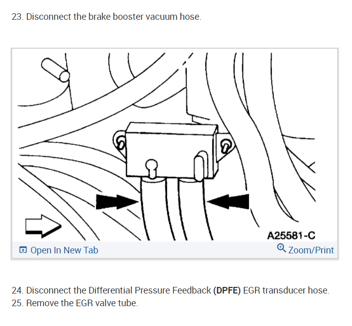

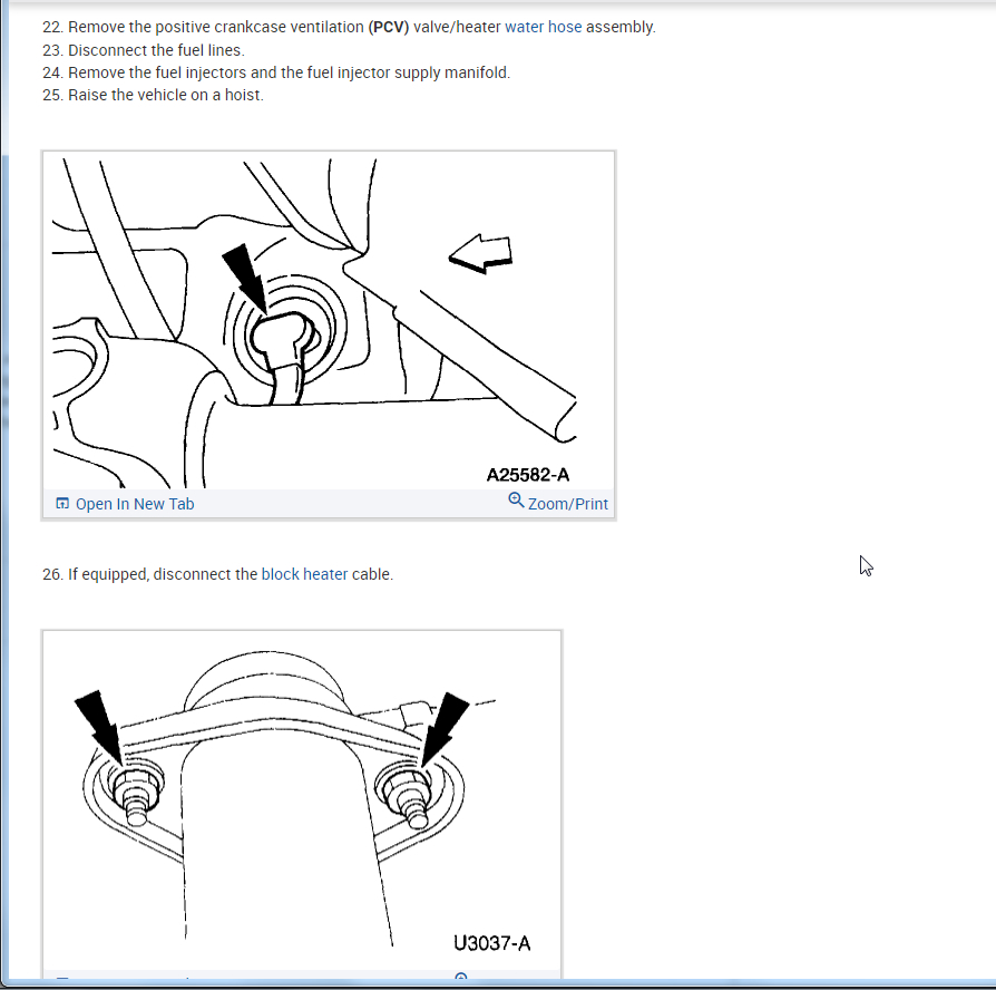

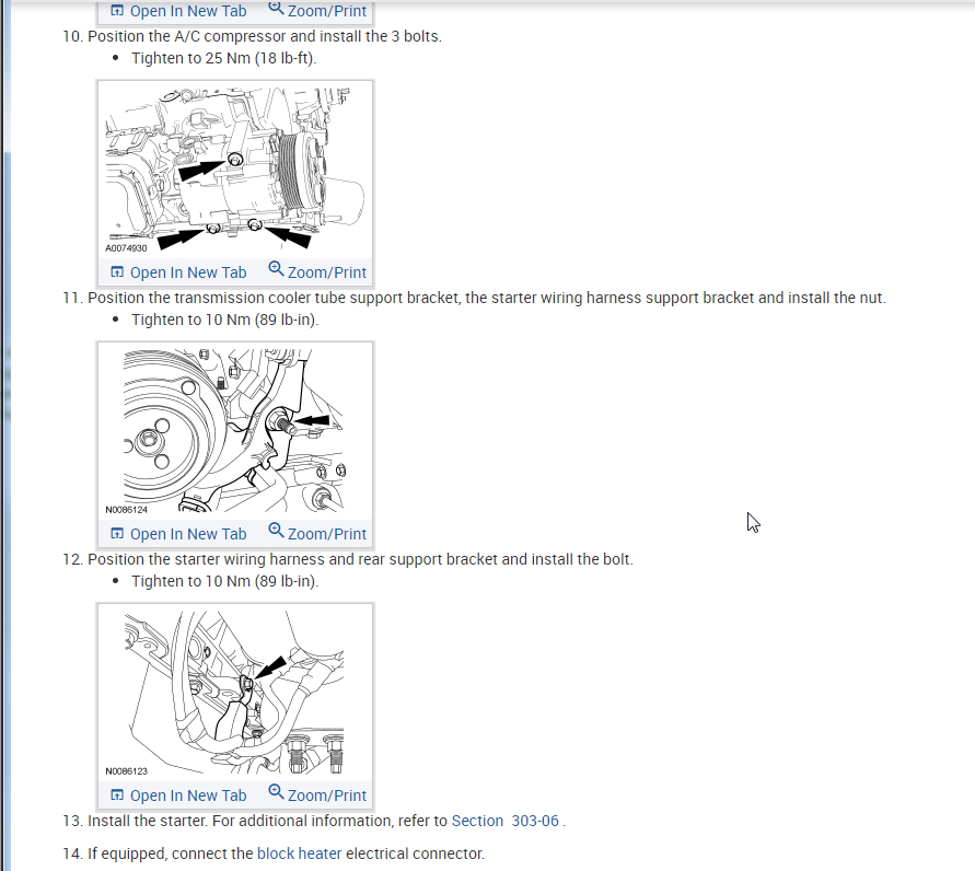

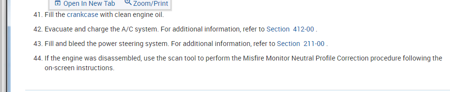

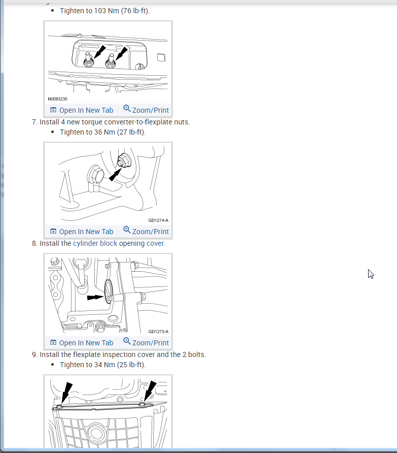

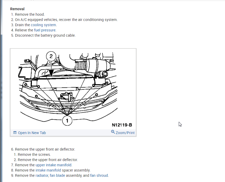

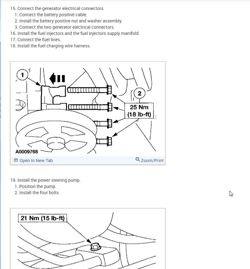

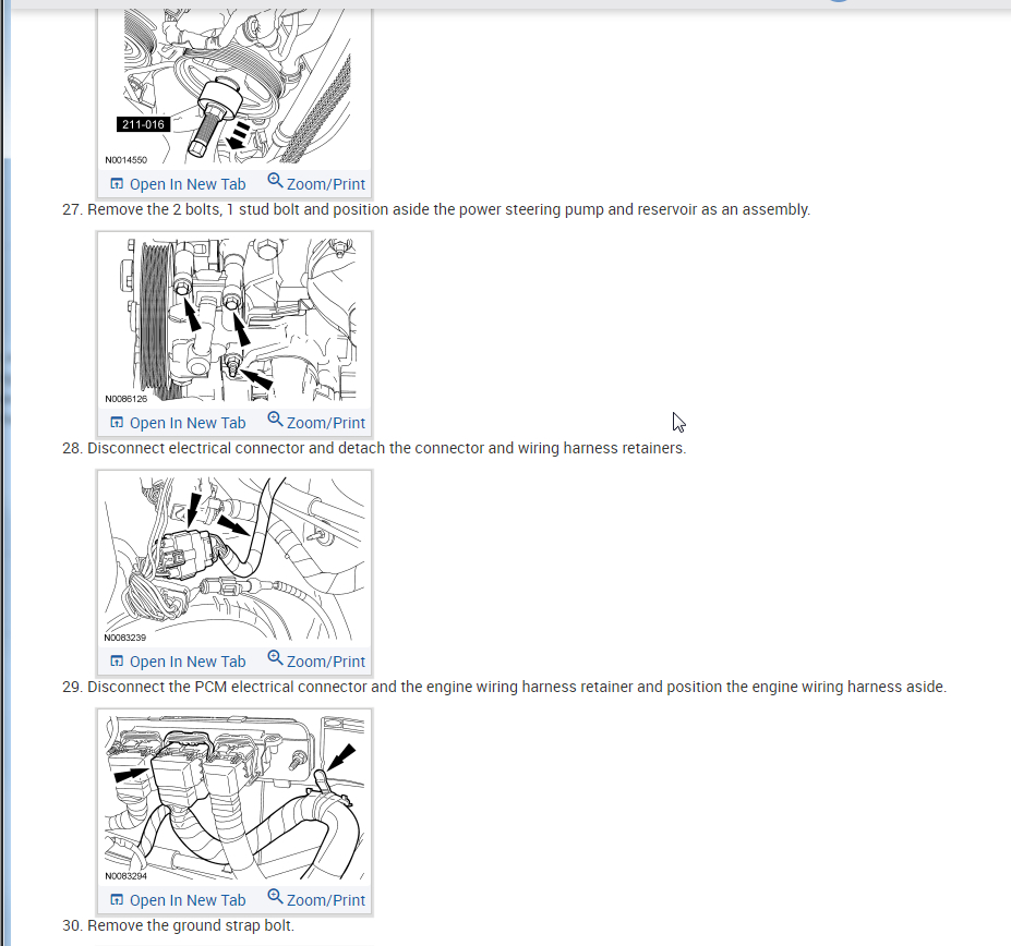

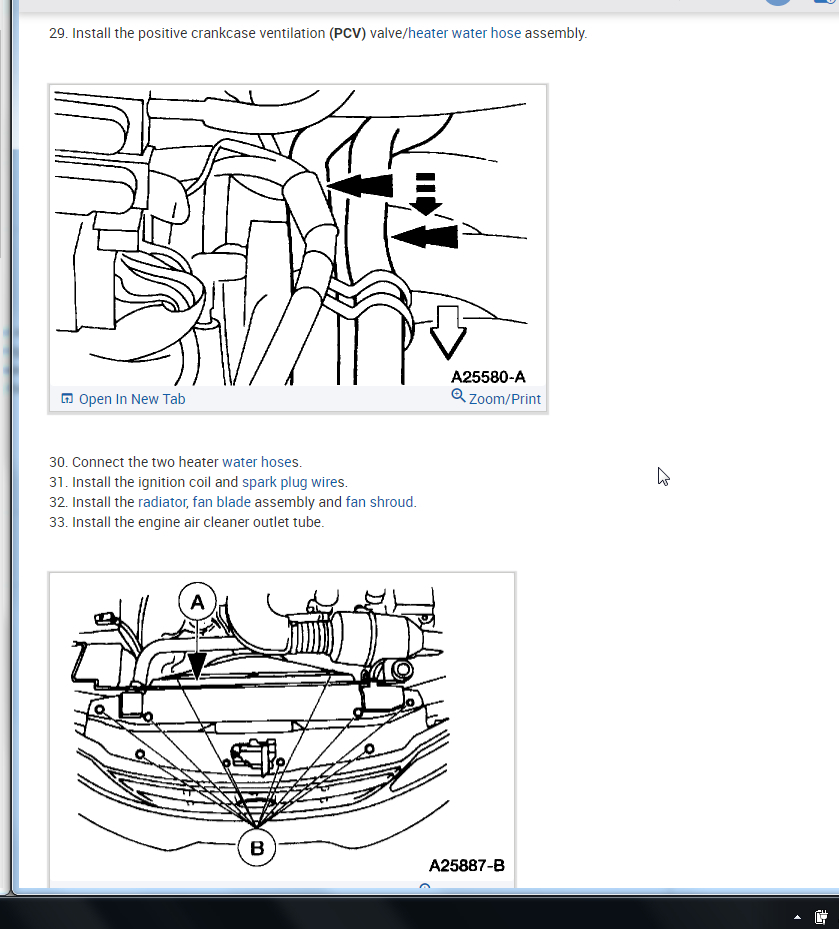

In the event that you want to replace the motor, below is the process from the manual if you need it.
Thanks
Feb 9, 2021 at 6:26 AM (Merged)

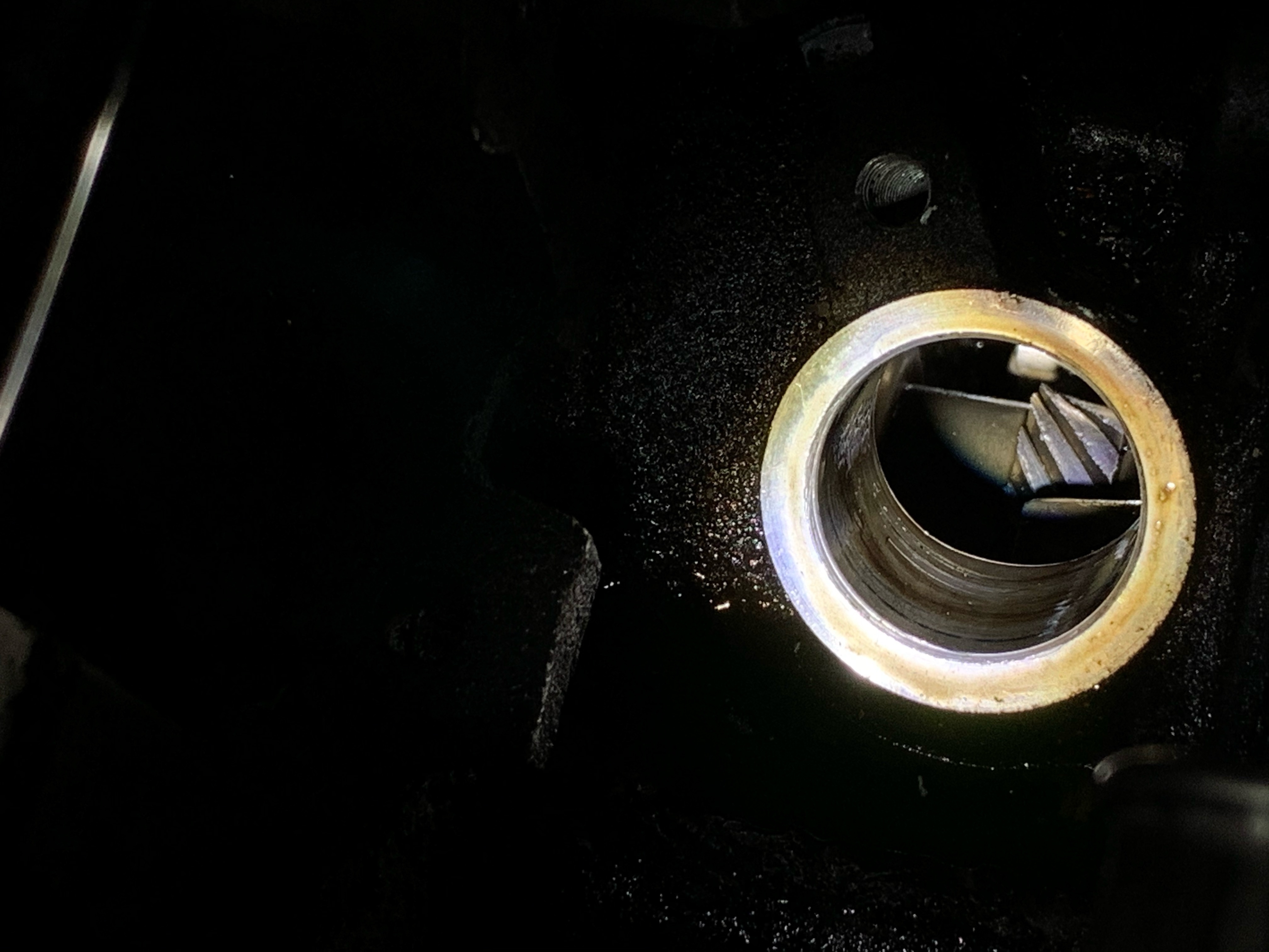

PRESTON HARRIS
Had no oil pressure and the oil pump drive shaft was not spinning so assumed the camshaft synchronizer was bad. Upon removal I found that the driving gear connected to the large timing chain sprocket was completely smoothed down. I cannot find a name for this piece or any info on how to remove it! Any help is appreciated. Image of the gear below.
  • 55,381 POSTS
That is part of the camshaft so you will need a new one. also, this usually happens when the oil pump pickup is clogged or the oil pump is going out. If this is the original engine it might be time for a rebuilt unit. First disconnect the battery and drain the coolant and engine oil. Here are the instructions on how to replace the engine in the diagrams below. Check out the diagrams (below). Let us know what happens and please upload pictures or videos of the problem.

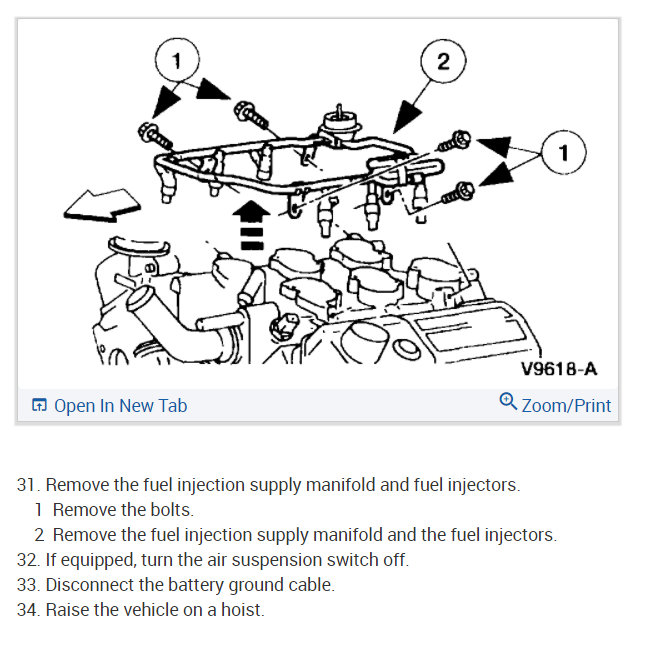

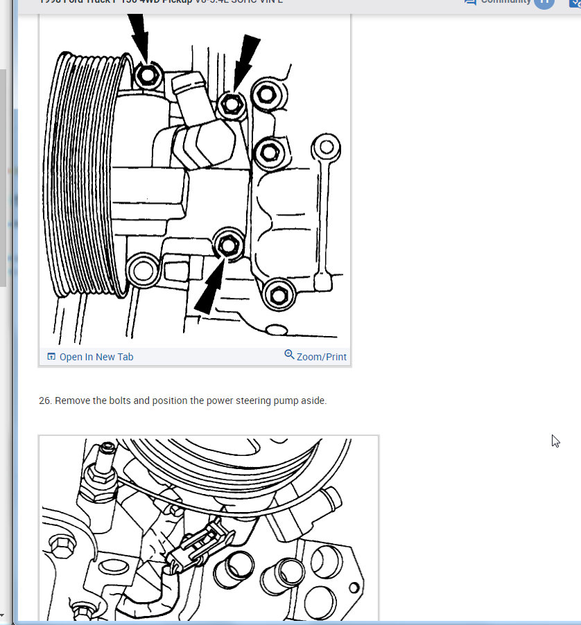

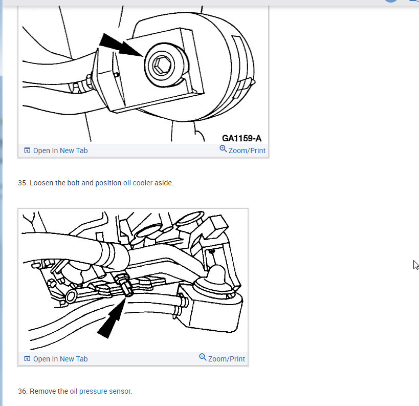

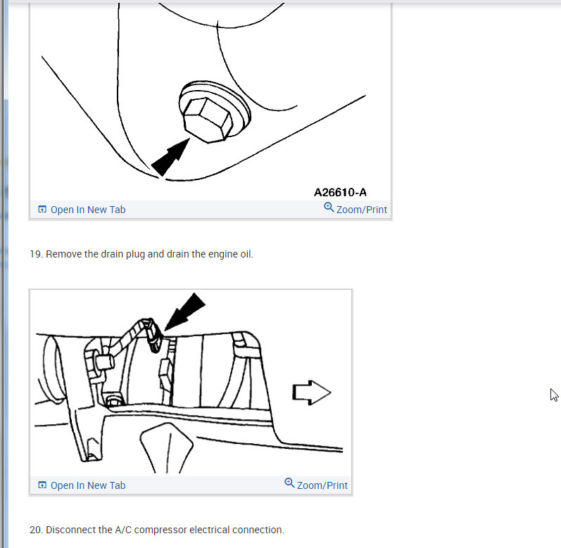

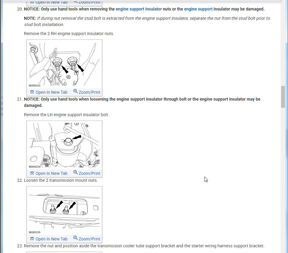

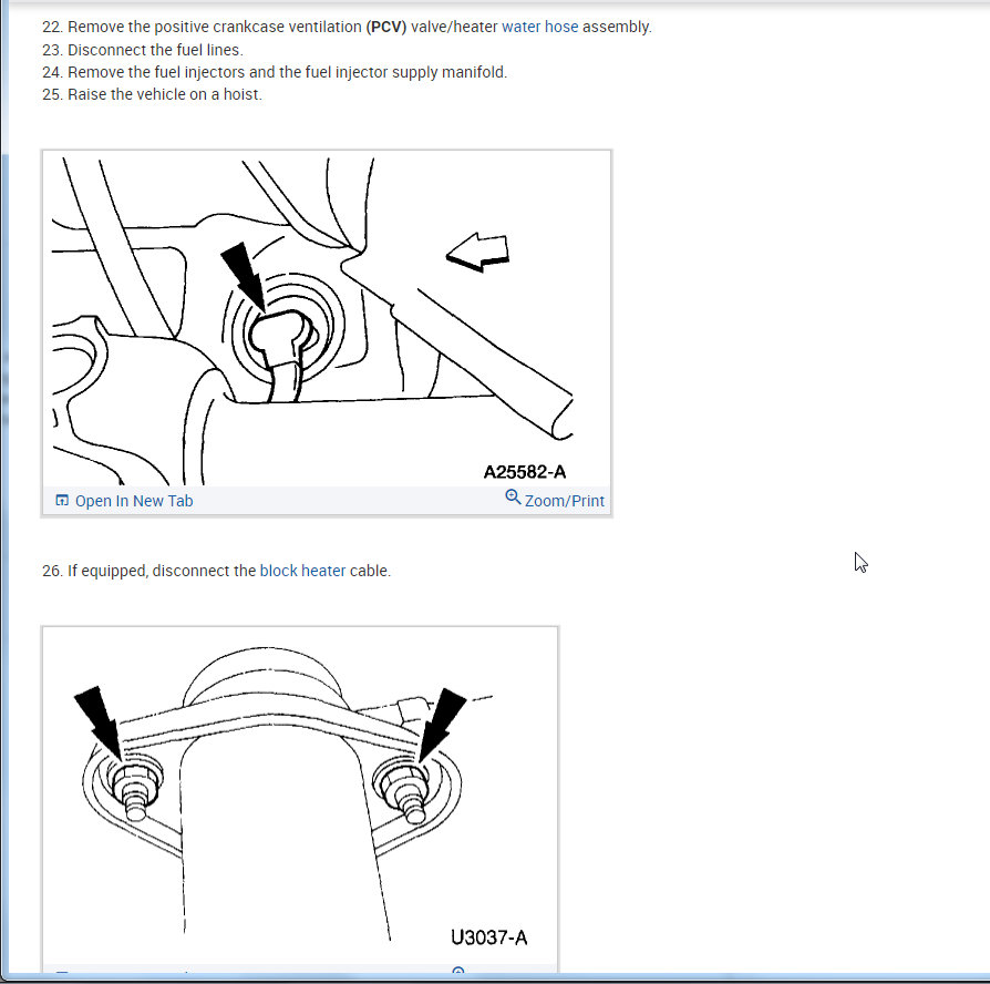

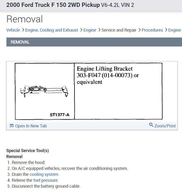

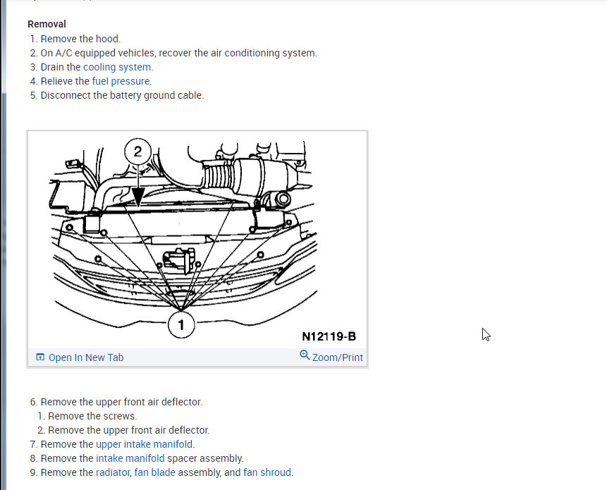

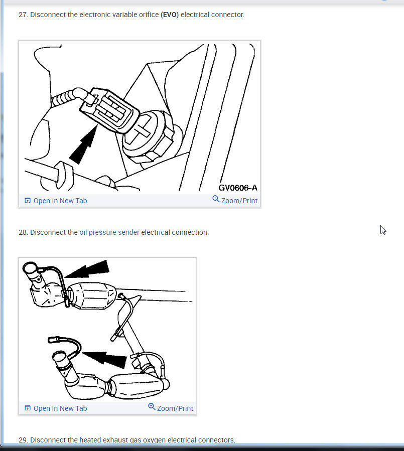

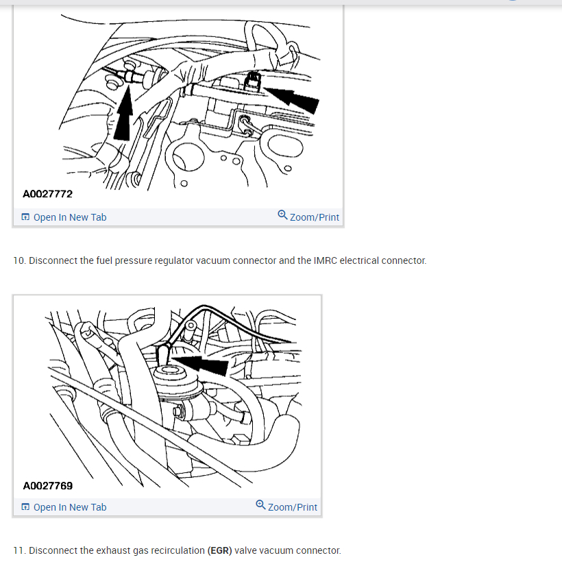

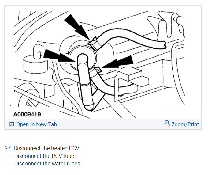

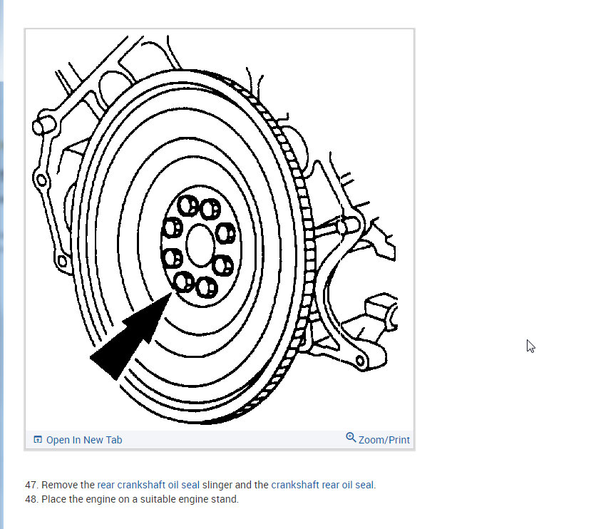

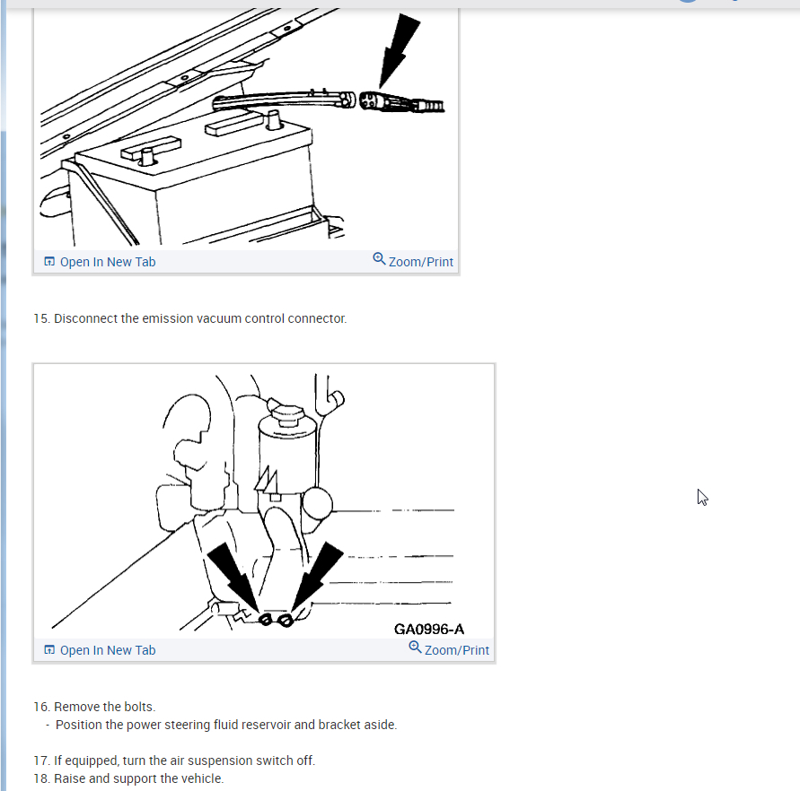

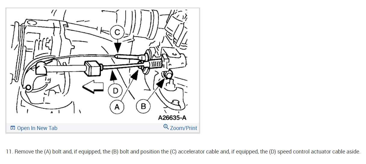

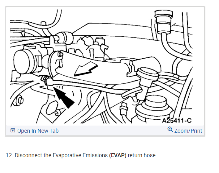

What all do i need to take off when removing my engine out of my truck listed above?
Feb 9, 2021 at 6:27 AM (Merged)

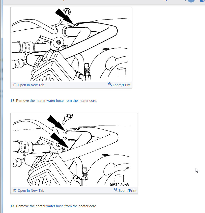

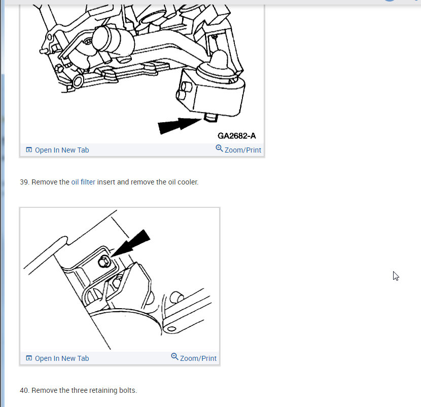

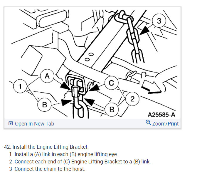

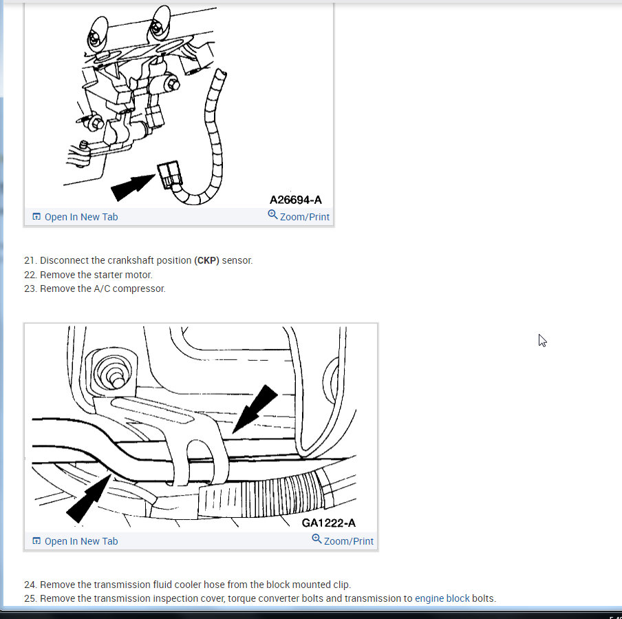

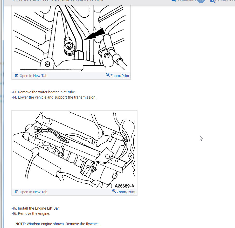

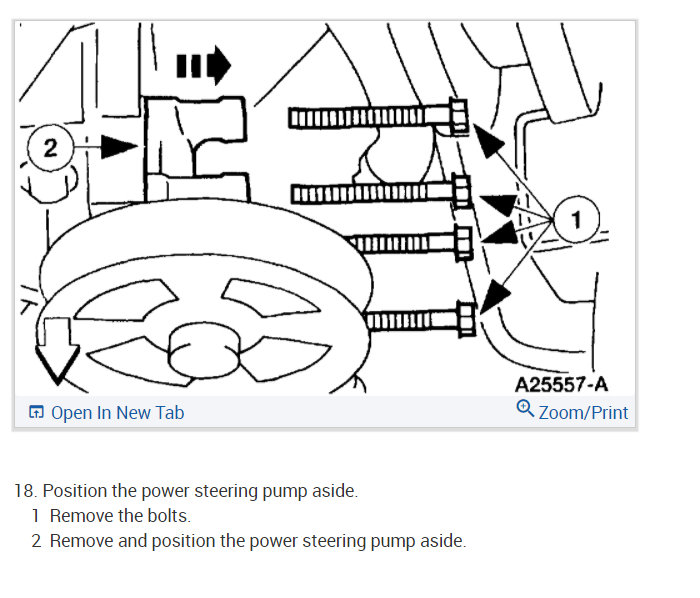

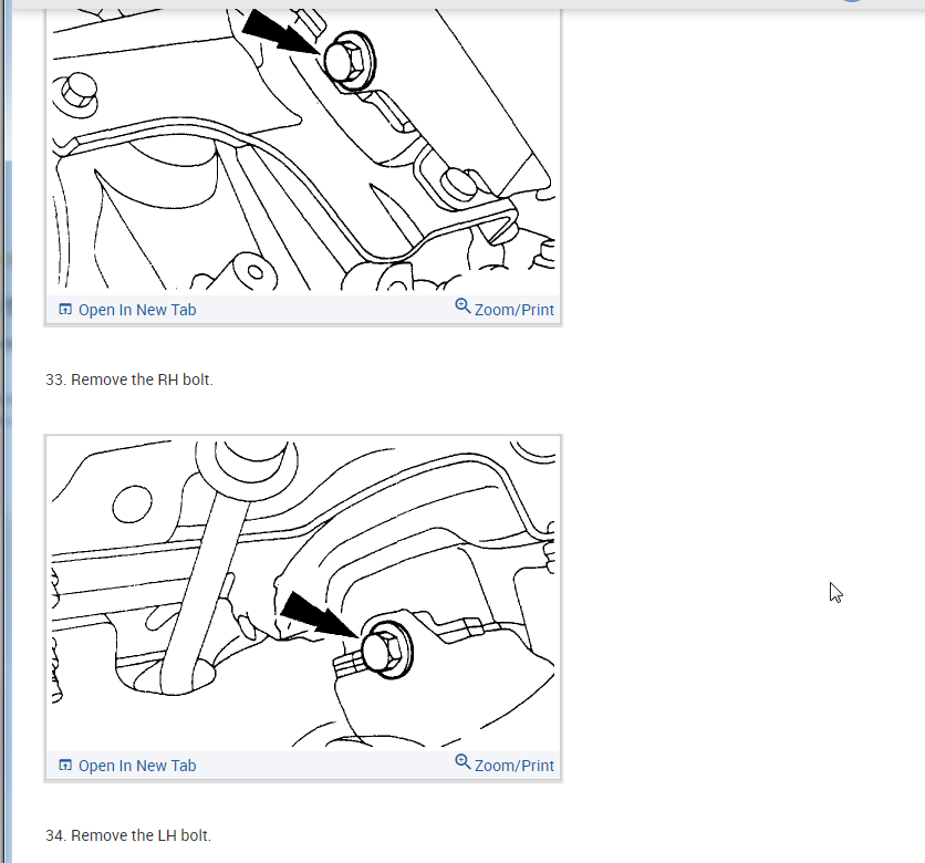

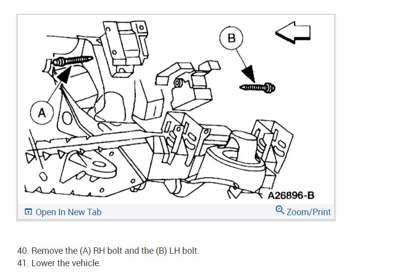

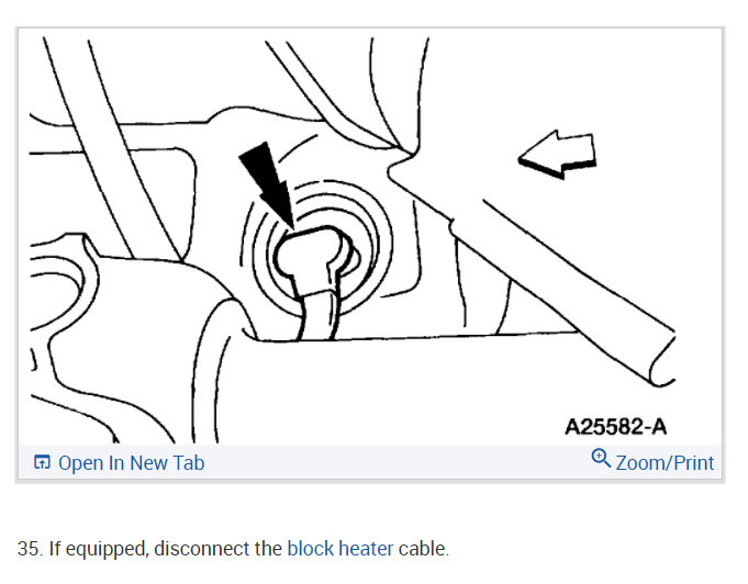

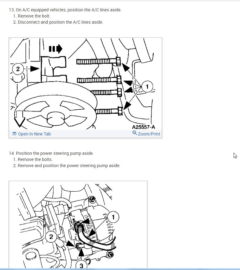

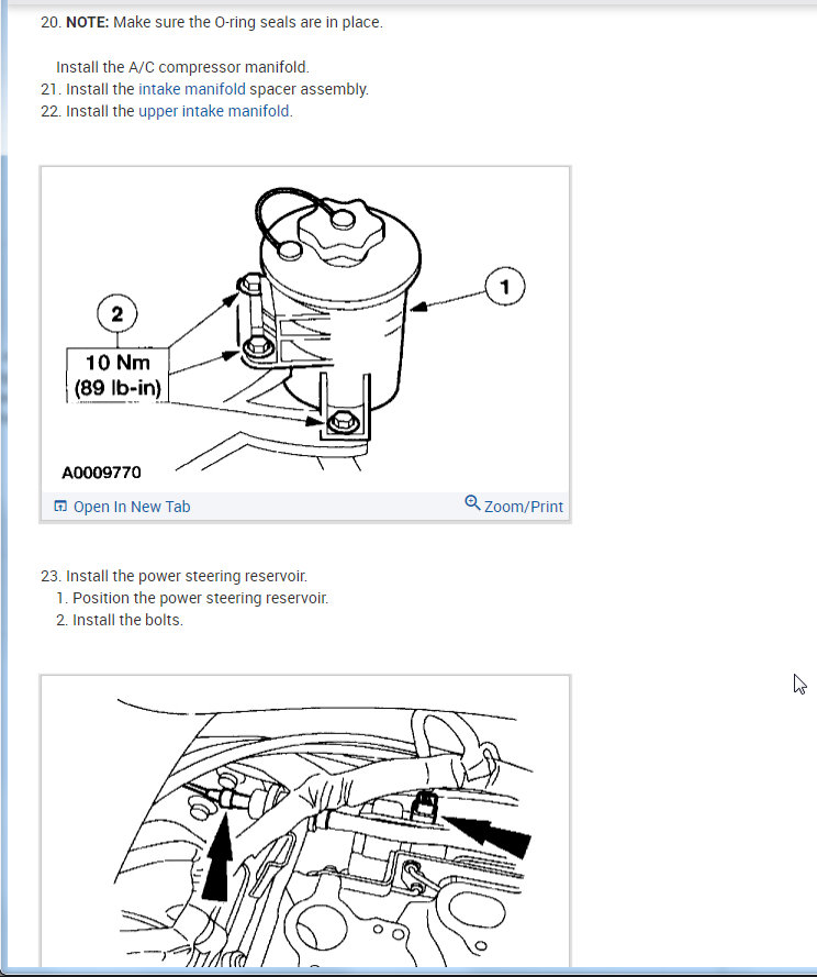

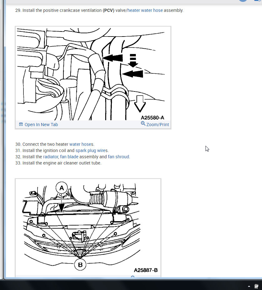

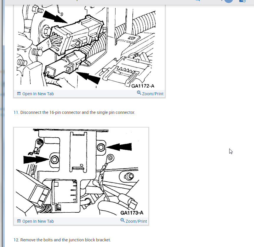

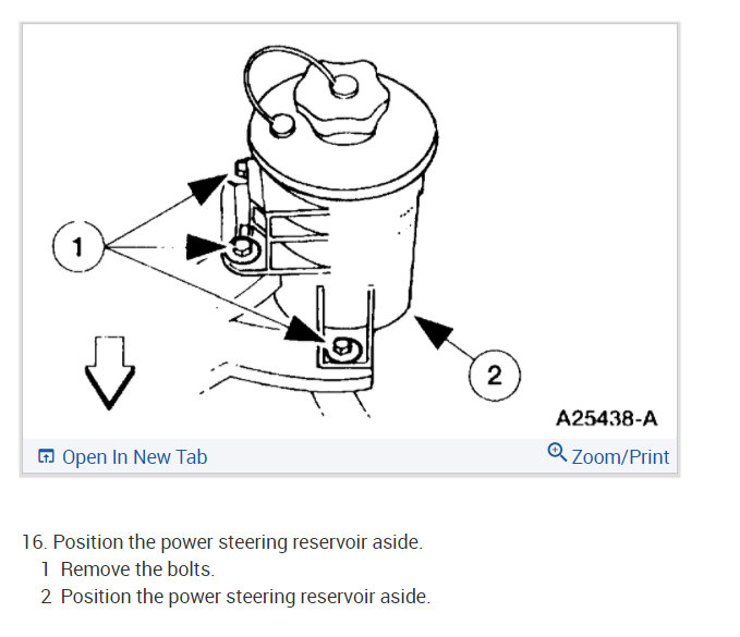

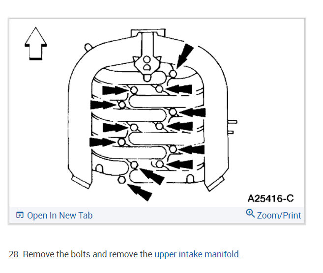

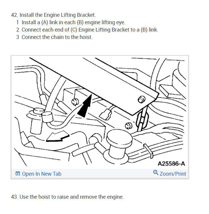

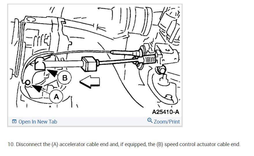

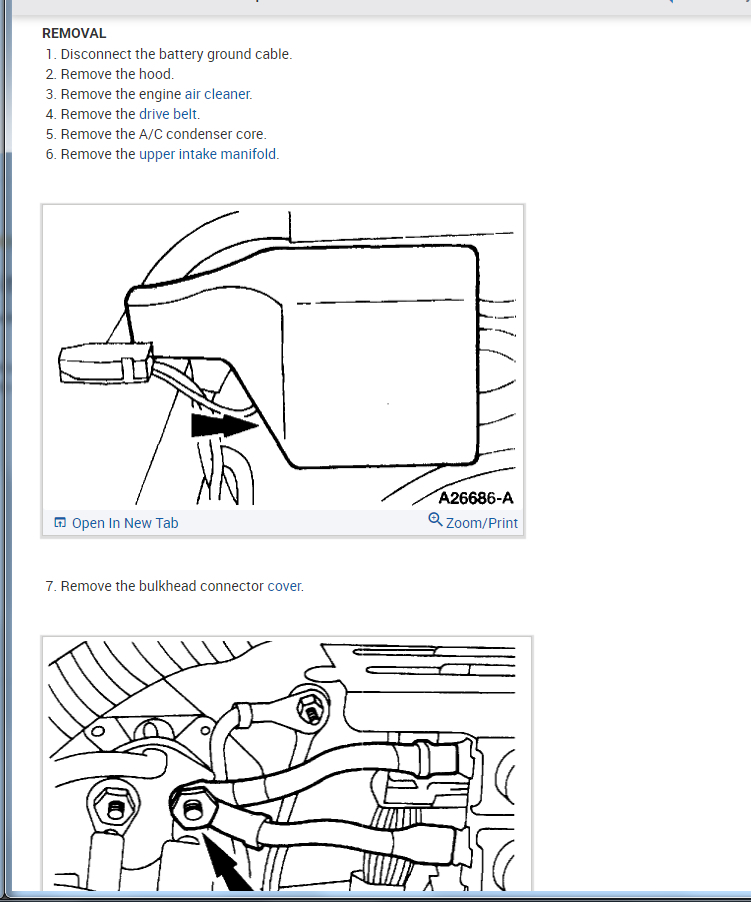

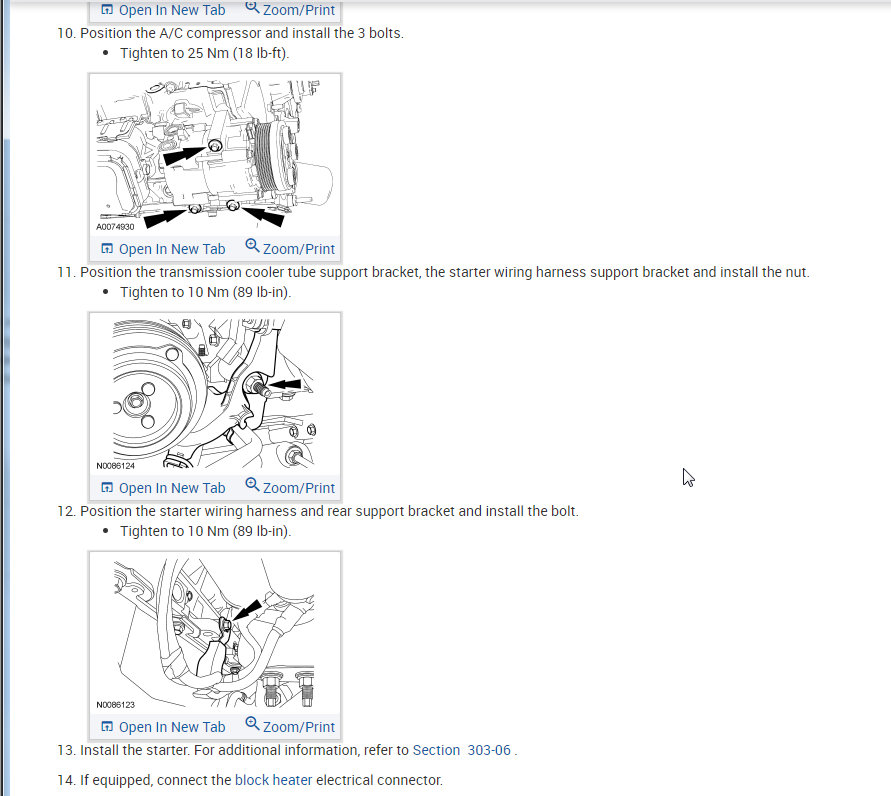

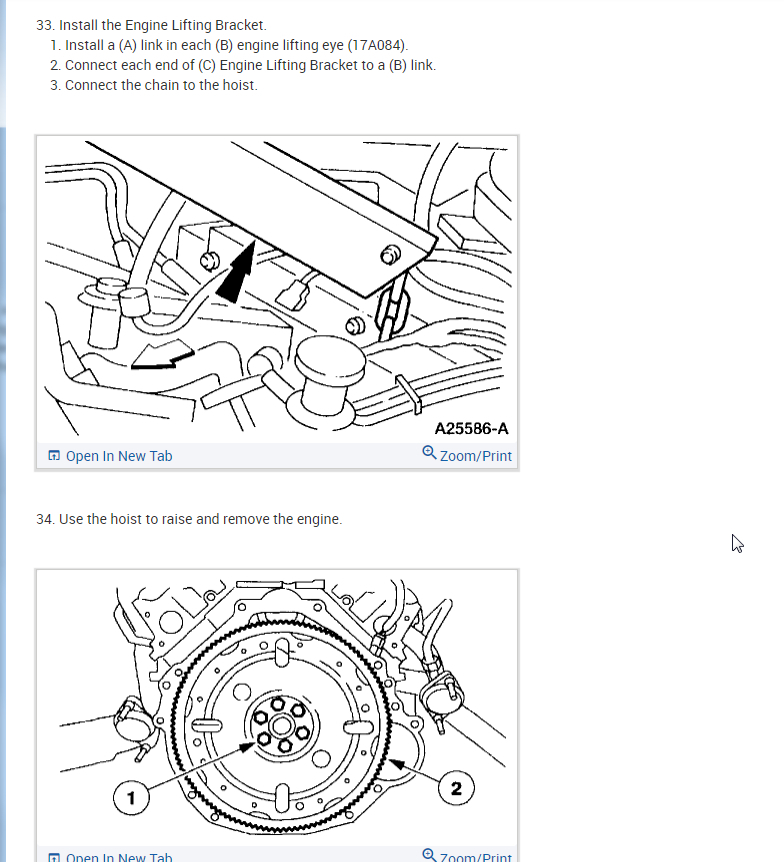

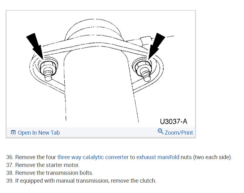

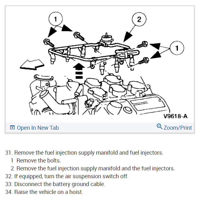

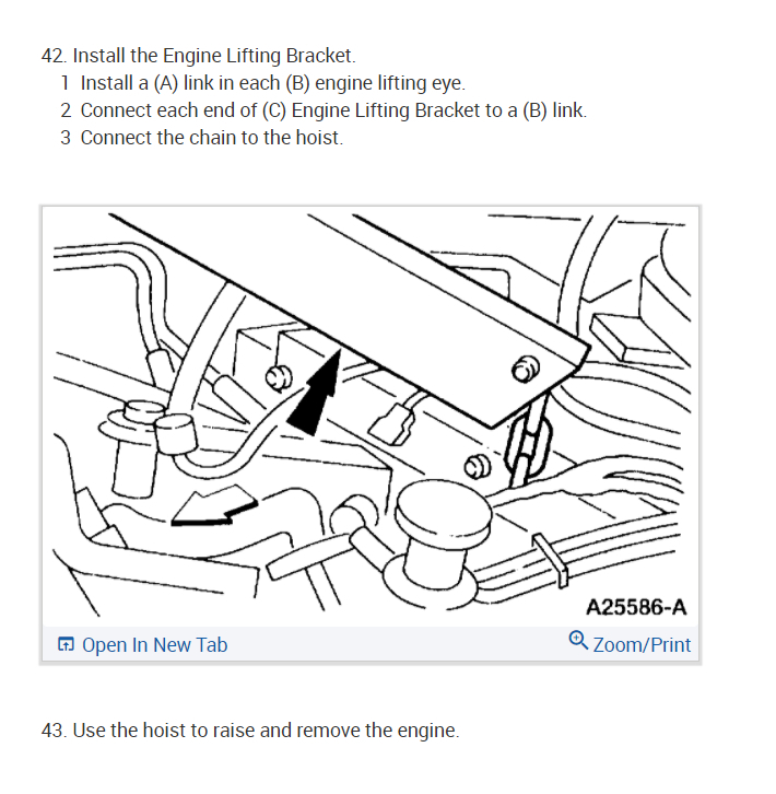

I am attaching the entire process from the manual on how to remove the engine. Let us know if you have other questions. It is pretty extensive but not too bad to remove this one.

i am changing out a 97 4.6 romeo motor in a f-150. i am replacing with a 99 4.6 romeo motor. i've pretty much stripped the old motor but cant get to the top two tranny-engine bolts. is there any way to get them out without pulling the cab or intake manifold???
BLACKOP555
  • 10,386 POSTS
remove engine supporting crossmeber and tranny crossmemember and drop the engine and trans.

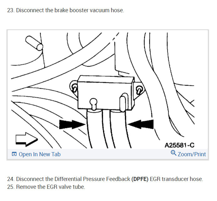

hey i have a 1996 ford f150 4x4 with the 5.0 was wondering if a 5.0 out of a 89 f150 would bolt straight in? thanks is it a straight swap?
HMAC300
  • 48,601 POSTS
unless they have changed the way the motor mounts in the truck meanign where the current mounts go in it should be although you will have to put the more modern equiptment onit so it will be a bolt in swap. meaning the intake/exaust, maybe oil pan and alternator, etc. make sur ethe intake pattern bolts are the same as they may have changed like going to a smaller bolt or metric.

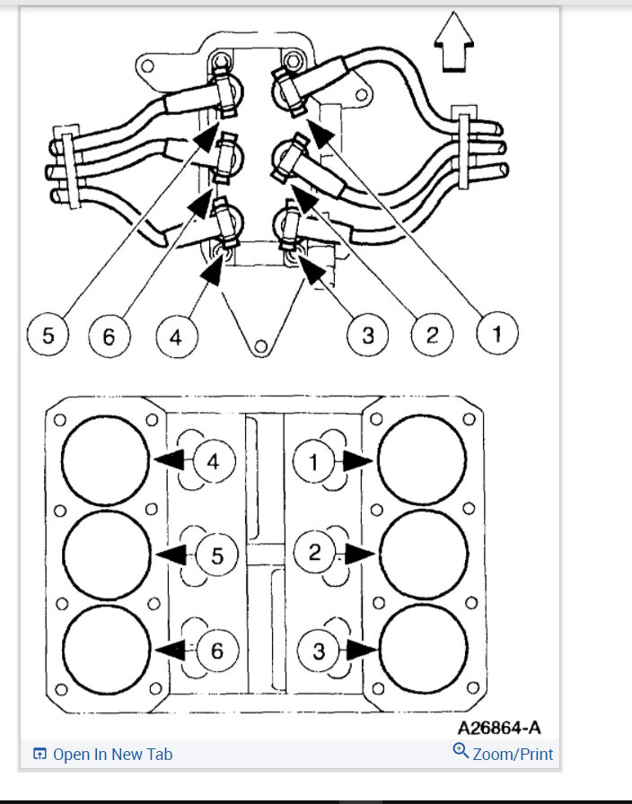

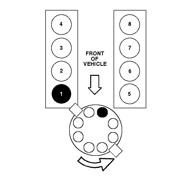

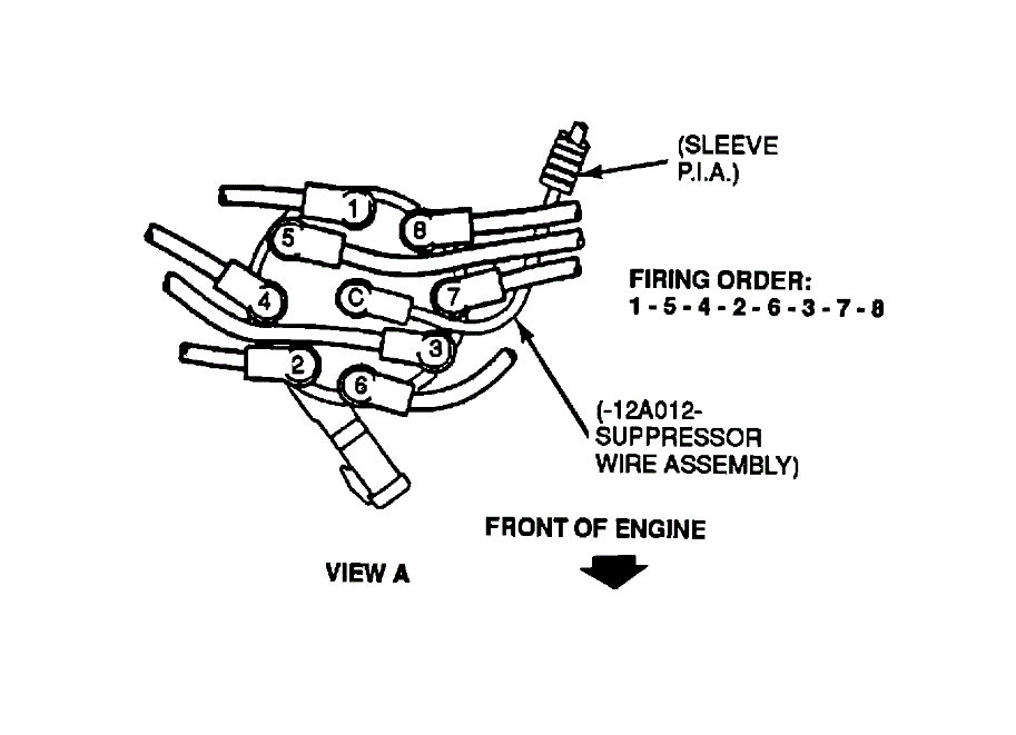

What is firing order on 93 5.o? Is it same as 90 5.o?
  • 110,240 POSTS
Yep, they are the same. I attached a couple pics. Hope they help.

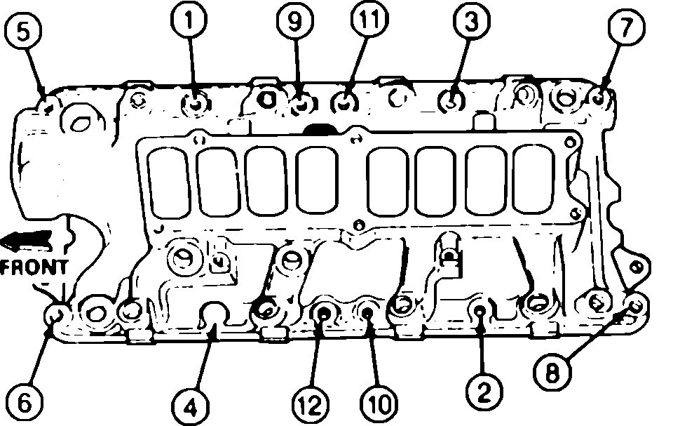

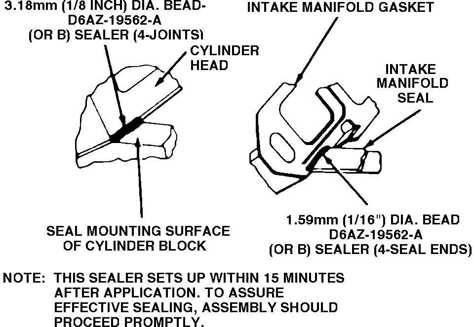

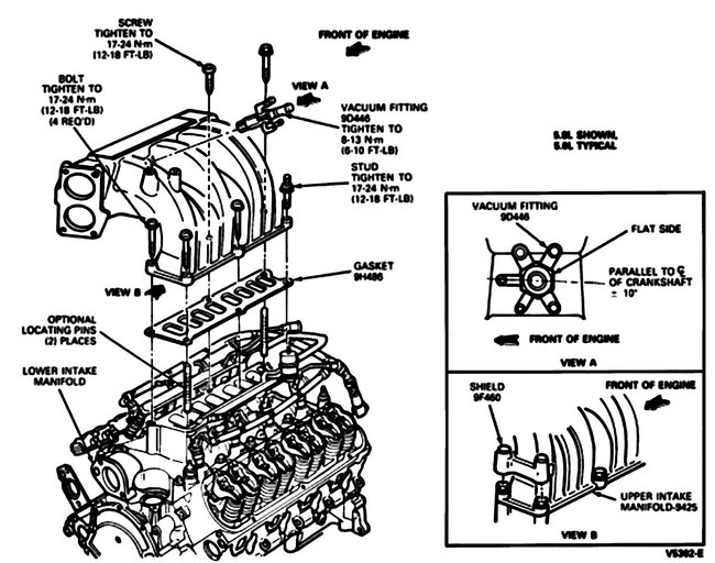

What size is torx bit on intake?
  • 110,240 POSTS

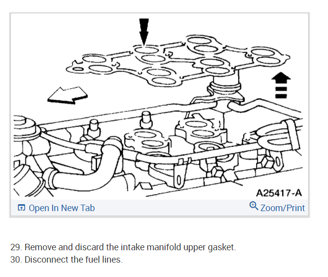

That is one I don't know off the top of my head. The manual doesn't provide that info, but usually those are around a T35.
___________________________

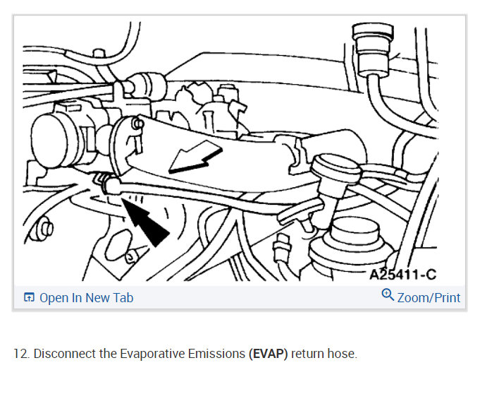

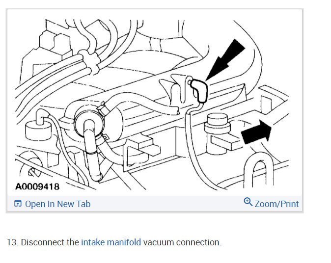

I don't know if you need them, but here are the directions for the 93 upper and lower intake removal and replacement. It includes torque specs. The attached pics correlate with the directions.
1993 Ford Truck F 150 2WD Pickup V8-302 5.0L
Upper
Vehicle Engine, Cooling and Exhaust Engine Intake Manifold Service and Repair Procedures Upper
UPPER
WARNING: DO NOT SMOKE, CARRY LIGHTED TOBACCO OR OPEN FLAME OF ANY TYPE WHEN WORKING ON OR NEAR ANY FUEL-RELATED COMPONENT, HIGHLY FLAMMABLE MIXTURES ARE ALWAYS PRESENT AND MAY BE IGNITED, RESULTING IN POSSIBLE PERSONAL INJURY.
Upper Intake Manifold and Throttle Body
Removal
1. Disconnect electrical connectors at idle air control valve , throttle position sensor and EGR position sensor.
2. Disconnect throttle linkage at throttle ball. Disconnect AOD (5.0L only) or C6 (5.8L only) transmission linkage from throttle body. Remove two bolts securing throttle linkage bracket to intake. Position bracket with cables out of way.
CAUTION: When disconnecting throttle cable from ball stud, use a screwdriver or similar tool close to the stud and pry slowly. Pulling by hand may damage the cable.
3. Disconnect upper intake manifold vacuum fitting connections by disconnecting all vacuum lines to vacuum tree, vacuum lines to EGR valve and vacuum line to fuel pressure regulator.
4. Disconnect PCV system by disconnecting hose from fitting on rear of upper manifold.
5. On Econoline models, remove the oil fill tube.
6. Remove canister purge line(s) from fitting(s) on throttle body.
7. Disconnect water heater lines from the throttle body.
8. Disconnect EGR tube from EGR valve by removing flange nut.
9. Remove bolt from upper intake support bracket to upper manifold.
10. Remove six upper intake manifold retaining bolts.
11. Remove upper intake and throttle body as an assembly from lower intake manifold.
Installation
1. Clean and inspect the mounting faces of the lower and upper intake manifolds.
2. Position new gasket on lower intake mounting face. The use of alignment studs may be helpful.
3. Install upper intake manifold and throttle body assembly to lower manifold making sure gasket remains in place (if alignment studs are not used).
4. Install six upper intake manifold retaining bolts and tighten to 17-24 Nm (12-18 ft-lb).
5. Install upper intake support bracket to upper manifold attaching bolt.
6. Install EGR tube. Tighten flange nuts to 34-47 Nm (25-35 ft-lb).
7. Install canister purge lines to fittings on throttle body.
8. Connect water heater lines to the throttle body.
9. Connect PCV hose to rear of upper manifold.
10. Install oil fill tube (Econoline models).
11. Connect vacuum lines to vacuum tree, EGR valve and fuel pressure regulator.
12. Position throttle linkage bracket with cables to upper intake manifold. Install two retaining bolts and tighten to 11-13 Nm (8-10 ft-lb). Connect throttle cable and transmission cable to throttle body.
13. Connect electrical connectors at idle air control valve , TP sensor and EGR position sensor.
pic 1

Fig. 13 Intake manifold installation
Pic 2
Fig. 14 Intake manifold bolt tightening sequence
pic 3
12. Reverse procedure to install. Apply sealer as shown in Fig. 13. Tighten manifold attaching bolts to specifications in sequence shown in Fig. 14.
Hope that helps. Let me know if you have other questions.
