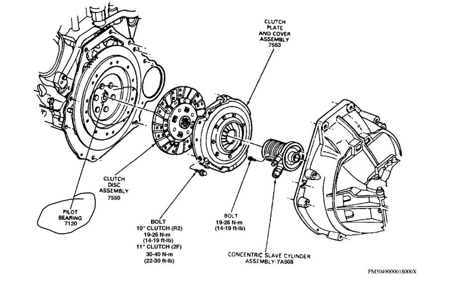

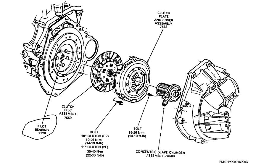

ALEX5150
  • 1987 FORD F-150
  • 4.9L
  • 6 CYL
  • 2WD
  • 20,000 MILES
1987 Ford F150 straight 6 blown engine so I bought a 1995 Ford F150 straight 6 for the engine. Mine was a automatic the new engine was a stick shift. What do I need to make the new engine connect with the new engine block? Please help
Tuesday, February 9th, 2021 AT 2:29 PM (Merged)
  • 52,797 POSTS
Good morning,
When you remove the donor engine, you will need to remove the clutch and flywheel. Then the pilot bushing inside the crank has to be removed as well. Then you can bolt up the automatic flywheel from your engine to the donor motor.
