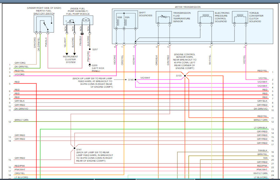

disconnected the fuel line and had my wife crank the engine and had no pressure?
BIGDADDYSPRADLIN

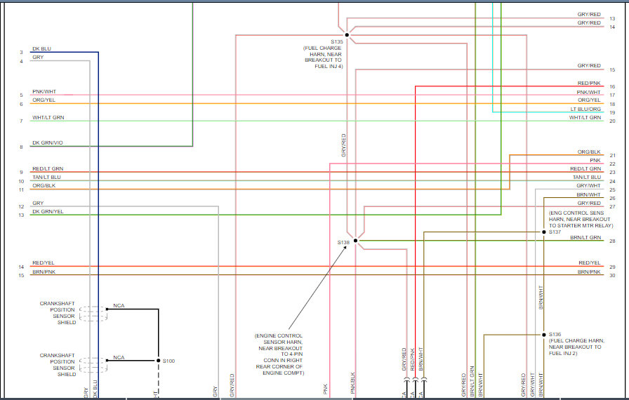

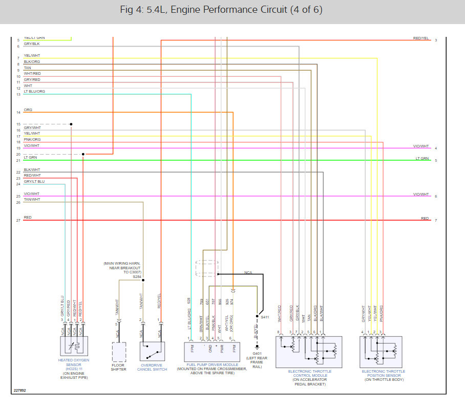

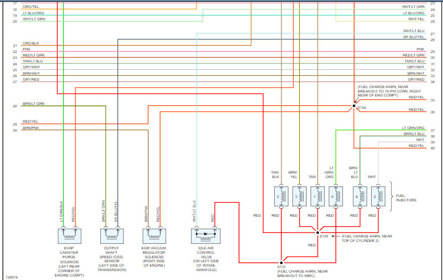

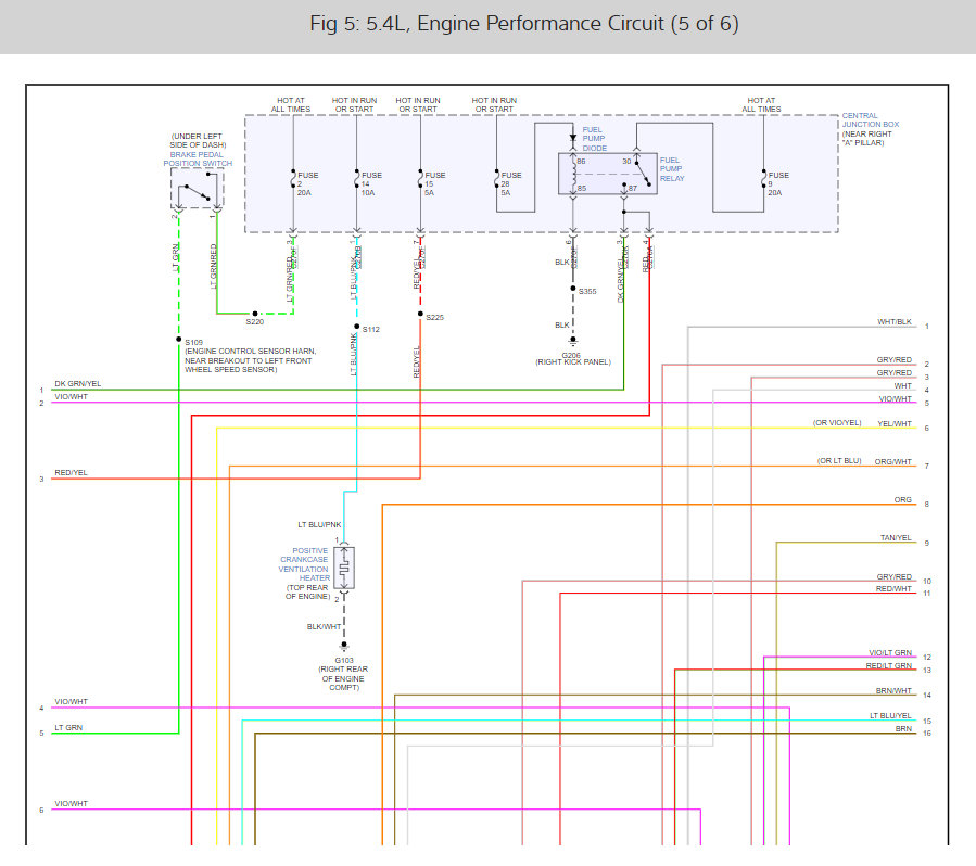

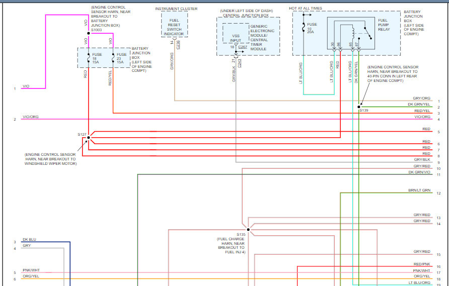

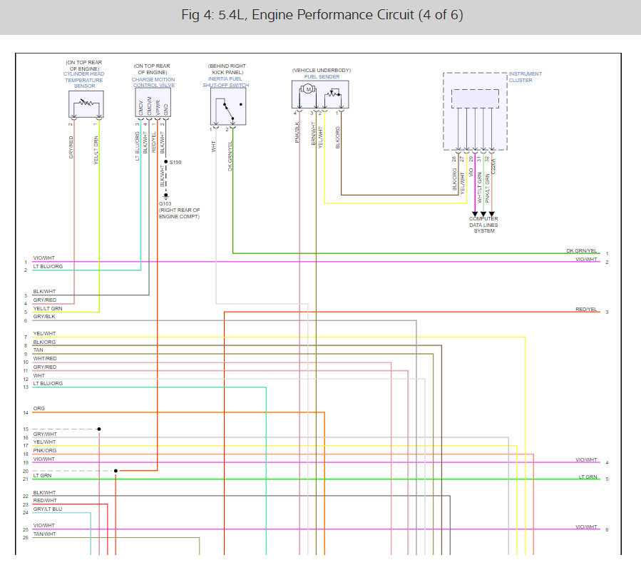

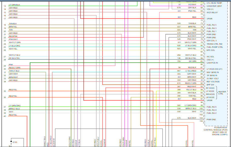

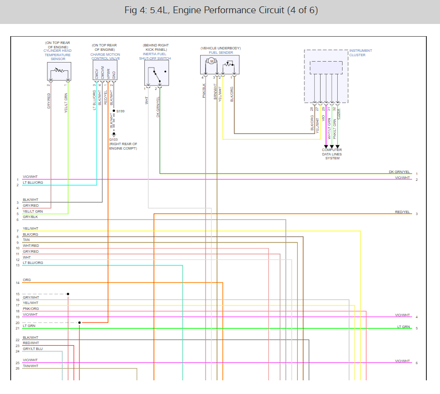

At first I thought my fuel pump had gone out. I disconnected the fuel line and had my wife crank the engine and had no pressure. After buying the 360$ replacement pump I decided to see if I had voltage to the pump before replacing it. 1 out of the four wires is always hot. But when I had my wife crank the engine again none of the three remaining wires recieved voltage. I checked the fuse and reset the IFS (inertia fuel shut off) switch. The rely is buit on to the fuse board and I dont know how to check that. Is there something im missing other than that rely? I should be getting 12vdc when the ignition is turned on to one of the other three wires correct? I have scoured the internet for a wiring diagram to no avail. I am at a stand still, and need some help. Thank you, -Jason

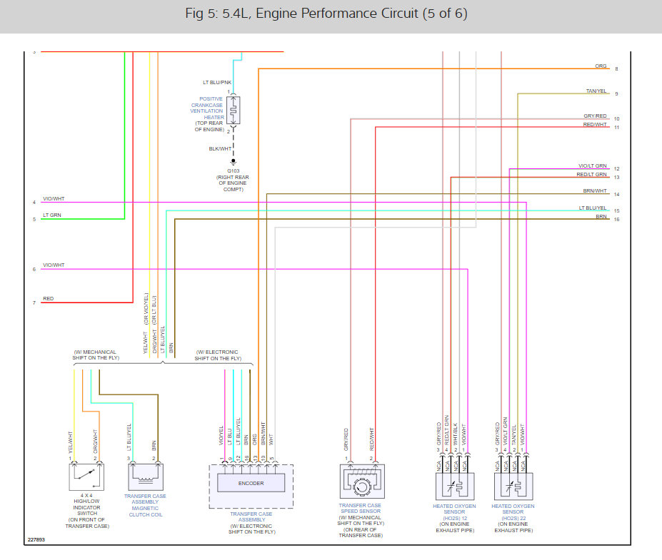

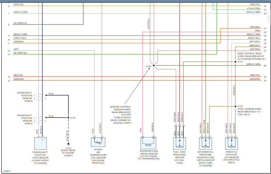

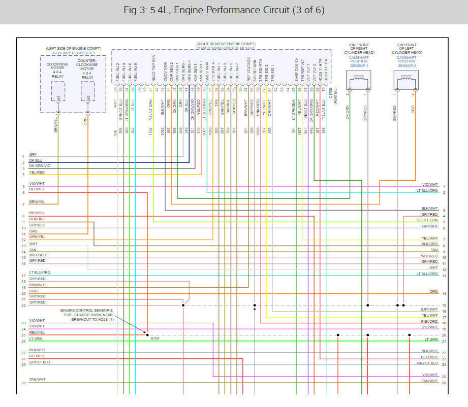

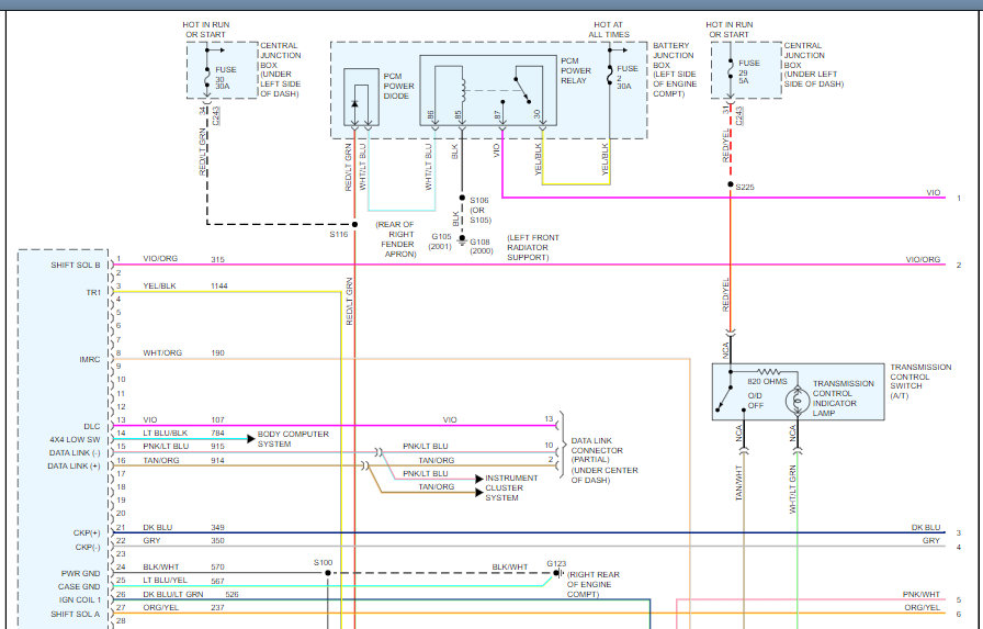

I don't think you really want to tackle this diagnosis. This truck uses a Pulse Width Modulated fuel pump system with variable pressure. It is controlled by a driver module that uses logic from numerous sensor readings. You really need a professional scan tool to diagnose this one. Here is a guide to help you step by step with instructions in the diagrams below to show you how on your car.
Check out the diagrams (Below). Let us know what happens and please upload pictures or videos of the problem.

Here is a tutorial showing how to test electrical wiring:

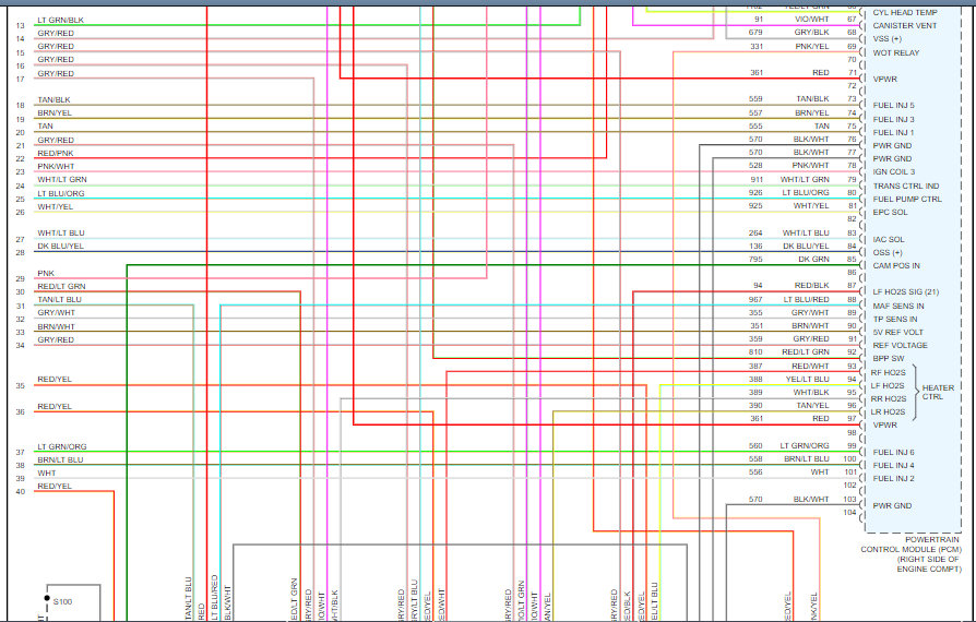

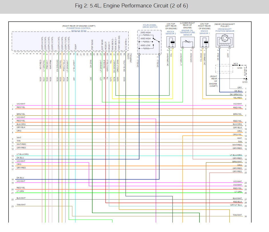

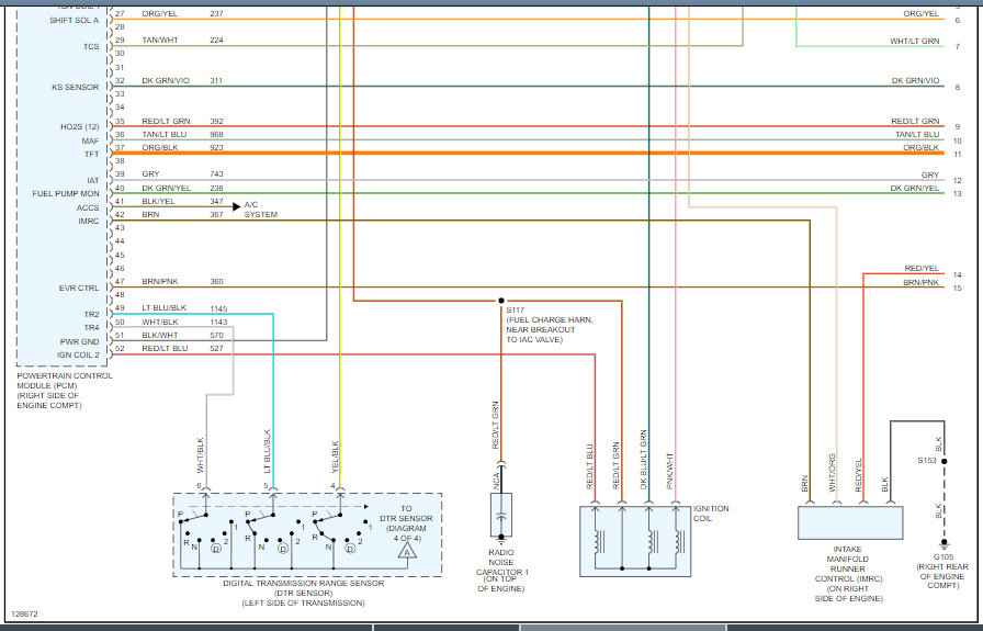

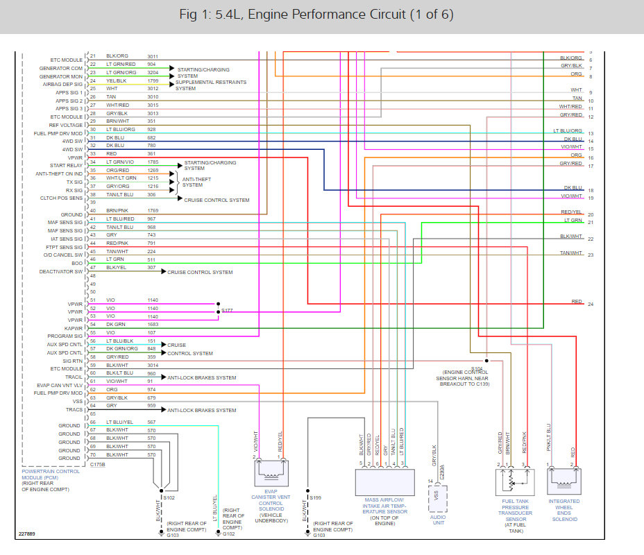

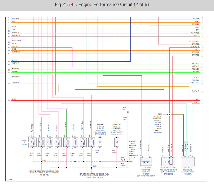

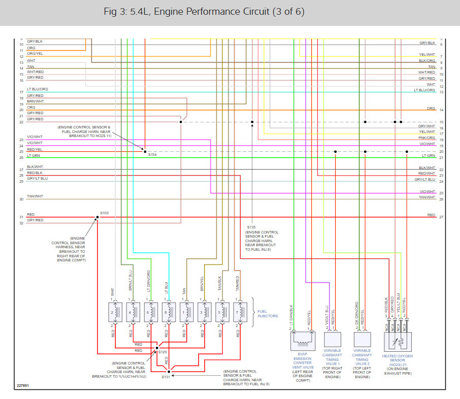

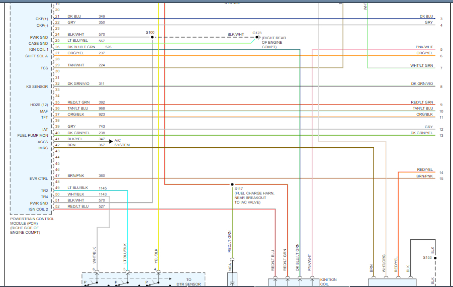

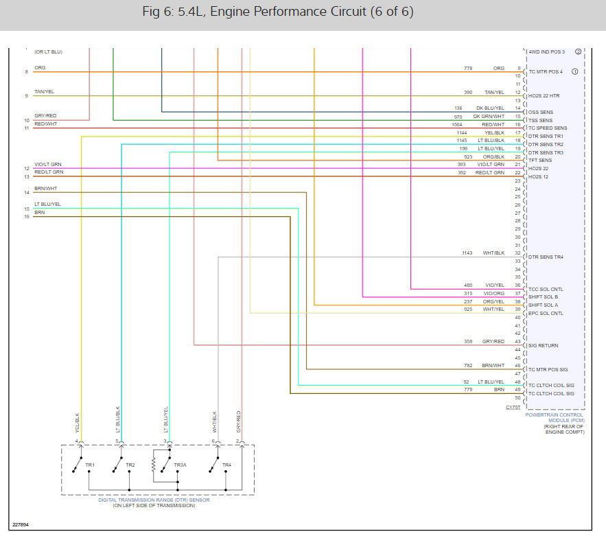

I've attached below the engine wiring diagrams for your truck that includes the fuel injector circuit. Hope this helps and thanks again for using 2CarPros.
Danny-
