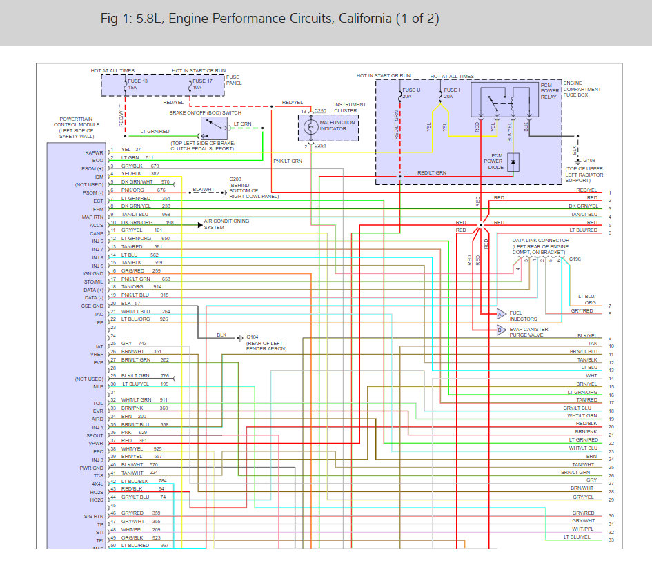

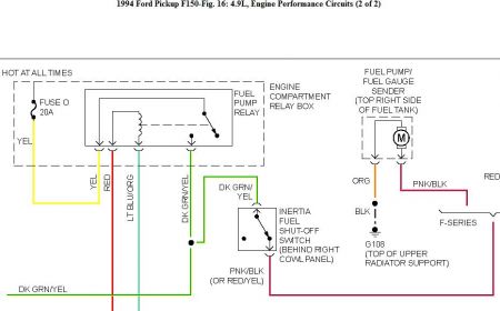

Where is the ground wire located at for the fuel pump. Fuel pump has been checked nothing wrong with it. Truck turns over but doesnt fire electrical code of 542 was reading.
Thursday, January 22nd, 2009 AT 8:18 PM
10 Replies
DAVE H
  • 13,384 POSTS
The ground is on top of the radiator support which can become loose or broken.
https://www.2carpros.com/forum/automotive_pictures/266999_fuel_10.jpg
Here is a fuel pump wiring diagrams and a guide to help you fix the problem.
Cheers

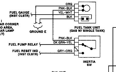

DMINION
I have already checked the inertia switch, and it was not triggered, although I reset it any way just to make sure. And it was located on the passenger side on the kick panel. My truck seems to be the complete opposite of what its supposed to be I swear. Any other suggestions? I am at a complete loss of ideas right now. Thanks
Friday, January 23rd, 2009 AT 2:39 AM

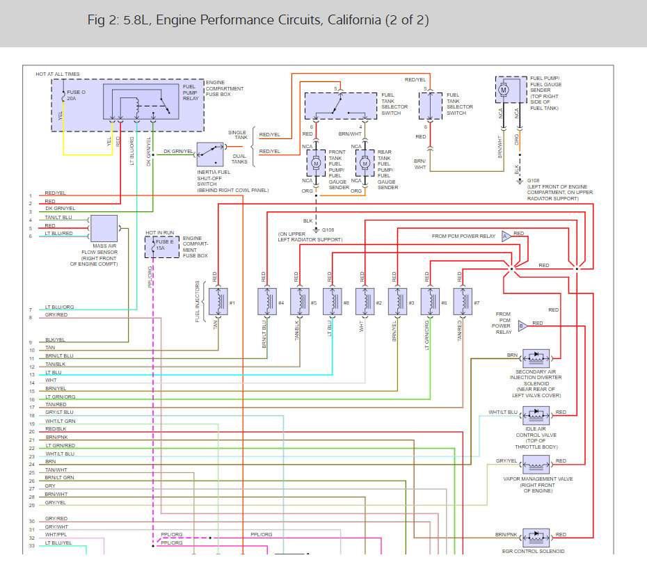

DAVE H
  • 13,384 POSTS
Is the vehicle definitely not getting fuel ? and there is definitely a hot feed to pump ..if yes .. check the ground(orange)wire near the top of radiator support or ground the pump(orange wire) to another ground point near the pump on the chassis somewhere .. or you could run a hot and ground direct from battery through a switch to the pump so you can check it is working correctly ?? making sure you remove the original hot and ground wires from pump ? let me know
Check out the diagrams (Below). Please let us know what you find.
+11
Friday, January 23rd, 2009 AT 8:22 AM

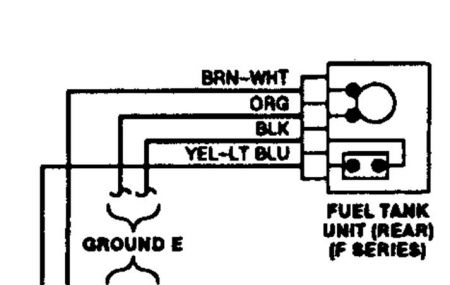

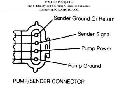

I have a 5.8L with a rear mount aft fuel tank. I dropped the tank to replace the leaf spring hangers. The plug on the sending unit just crumbled apart as the tank was lowered. Now I am not sure which wire goes on which post of the sending unit, and will the fuel pump work with out that plug just by snapping the end of the wires to the posts?
These are the sire colors:
Two wires are fatter than the other two
The two fat wires= orange and the other is black (or dark brown) with a white stripe.
The two thinner wires= black and the other is yellow with green stripe.
-2
Saturday, May 29th, 2021 AT 11:21 AM (Merged)
KHLOW2008
  • 41,814 POSTS
Hi dirtietruck,
Thank you for the donation.
Here are the schematics:
The thicker wires are for the fuel pump and they would work if you plug them in without the connector but ensure connections are tight as the fuel pump draws a rather high current and would heat up if connection is loose.
Orange = Pump ground.
Brown/White = Pump power.
Yellow/Light Blue = Sendersdignal
Black = Sender ground or return.
https://www.2carpros.com/forum/automotive_pictures/192750_Fuel_Pump_Connector93F150_1.jpg

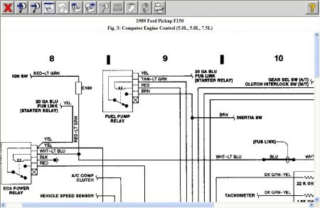

I am not getting power to the yellow wire going to the fuel pump relay the red and tan have power but the yellow should have power at all times I cant figure out why it doesn't have power where would I find the fuse link in the wire
-2
  • 75,992 POSTS
The fusible link is blue a 20 gauge wire at the starter relay. See below
Good Luck
https://www.2carpros.com/forum/automotive_pictures/12900_fuel_pump_relay_12.jpg
