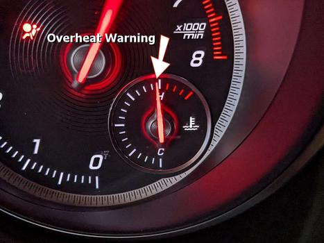

Automotive Engine Overheating Warning Light
engine overheating warning light
The engine temperature warning light is conveniently located inside the instrument cluster display panel, it's designed to alert the driver that the car's engine is overheating. This light is red because when the engine is overheating serious damage can occur and even engine replacement if the overheating is severe enough. Warning lights generally come in two colors, orange and red. Red is reserved for the more serious malfunctions that need attention immediately while orange is meant to be serviced at your earliest convenience.

Redundant System
When a car is designed with a temperature gauge along with a warning light it is called a "redundant" system, and is used as a failsafe. In this case the warning light works in correlation with the gauge and will only illuminate when the gauge is in the upper range of the gauge span.  Never depend on a warning light to illuminate when the temperature gauge is in the "hot" range. If the temperature gauge is in the "hot" range, shut the engine off in a safe place along the highway. Occasionally, the temperature sensor itself can become defective, illuminating the high engine temperature light even though the engine is not overheating.
