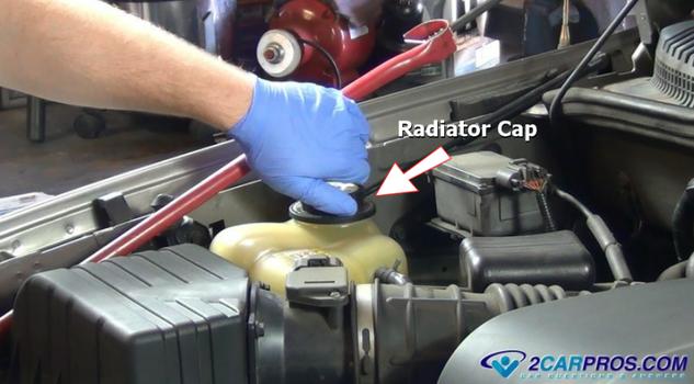

Start with the engine cool, and the vehicle on level ground. Raise and support the vehicle using jack stands, use latex gloves and protective eyewear. Slowly loosen the radiator or reservoir cap to relieve any residual pressure inside the cooling system, this will also allow the system to drain more rapidly.
remove radiator cap

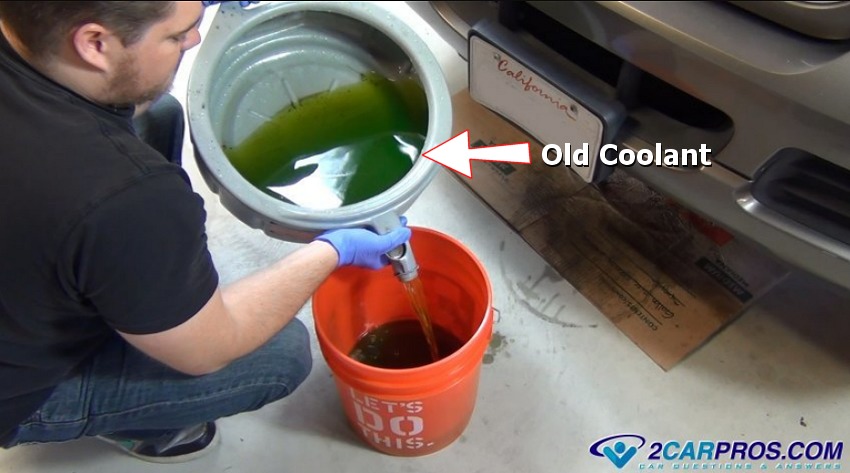

The engine coolant should be drained to avoid spillage when unbolting the pump from the engine block or timing cover. Use a fluid catch basin, and open the radiator drain valve or remove the lower radiator hose. (Keep coolant away from animals).
drain coolant

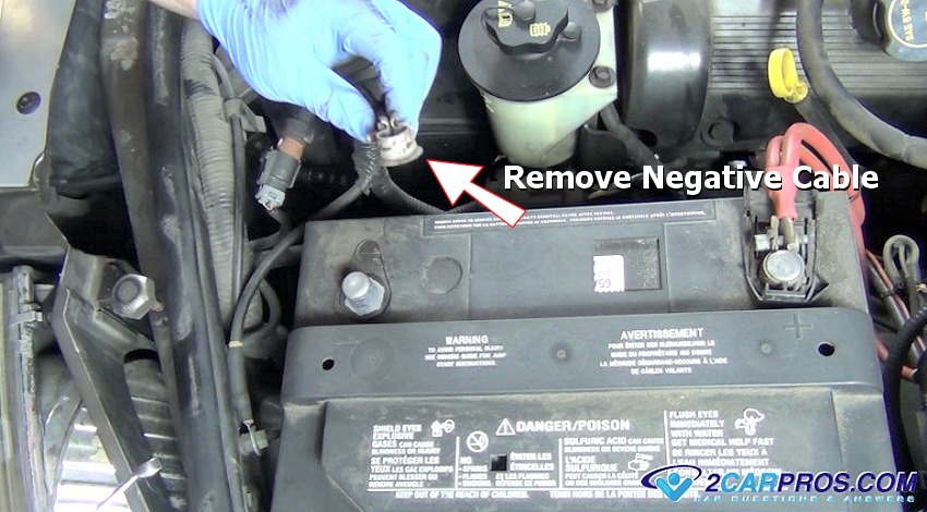

It's a good idea to disconnect the battery to ensure there are no accidental electrical short circuits while working.
remove negative cable

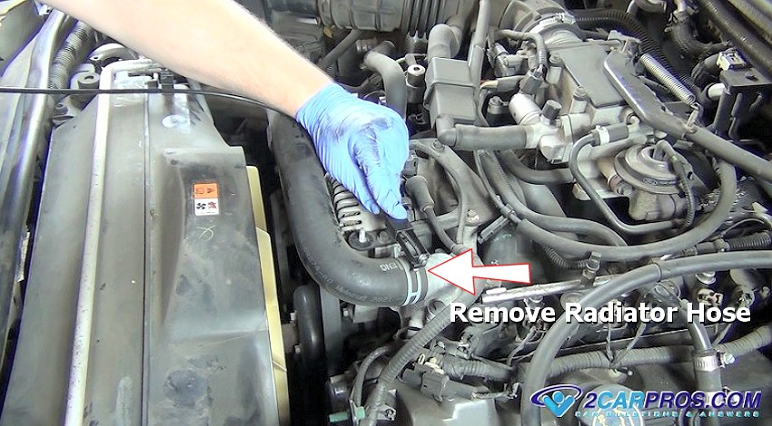

To help gain access to the water pump a few parts will needed to be removed first, such as plastic covers to help uncover the engine. Use a hose clamp tool to remove the upper radiator hose, a pair of channel locks can do the job as well.
remove radiator hose upper

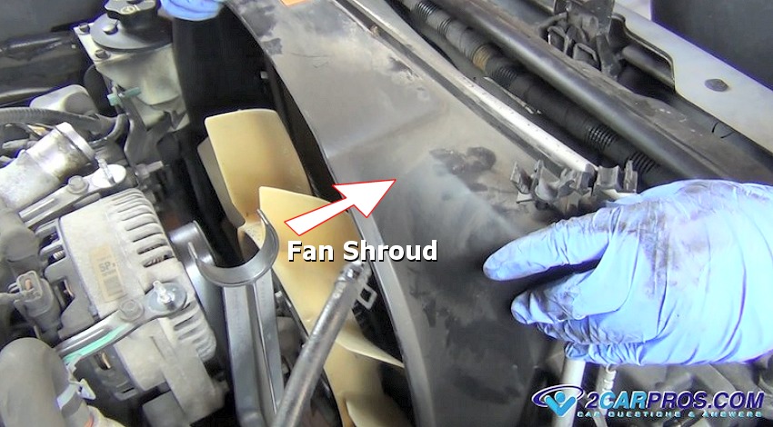

Remove the mounting bolts that hold the upper fan shroud to the radiator, also to the lower part of the shroud. In some cases the fan shroud is one piece, you will be able to remove the shroud completely once the fan blade is removed.
remove fan shroud

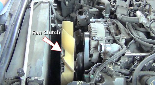

A cooling fan may be connected to the water pump, some cars use an electric fan which will be attached to the radiator shroud and will come out in one piece, in this example the fan is mounted to the water pump. A water pump pulley holding tool is necessary to keep the pulley from turning while loosening the clutch fan. You can rent this tool at the local auto parts store, watch this video to see how to remove the fan clutch.
fan clutch removal Fan Clutch Removal Tool

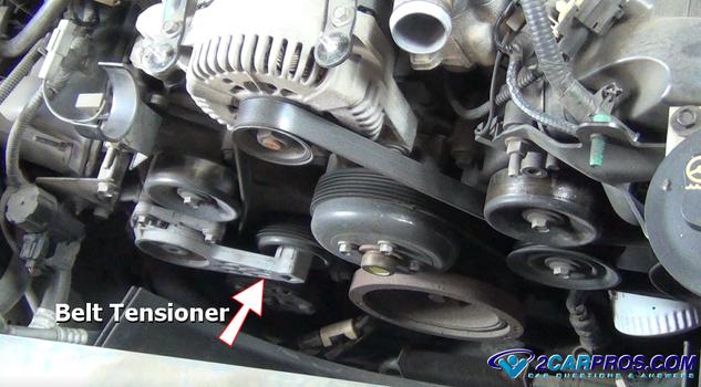

Use your cell phone to take a picture of the serpentine belt routing, then locate the belt tensioner which is spring loaded, apply downward pressure to release the belt from the pulleys, in this case we use a 1/2 inch ratchet.
release belt tensioner

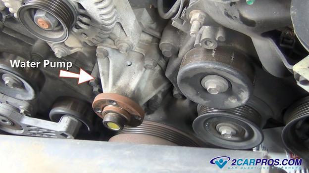

The water pump mounting bolts are now exposed, there may be additional hoses or brackets that will need to be removed depending on the design.
water pump

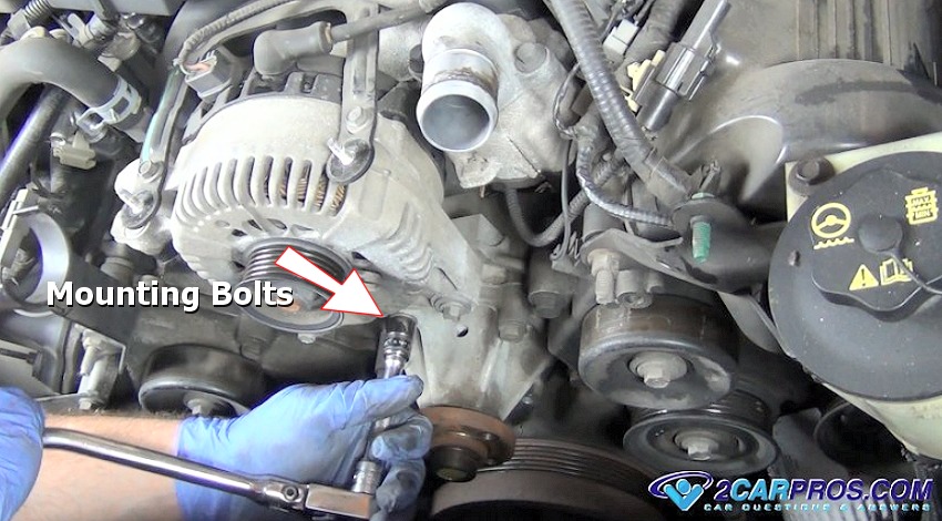

Locate the mounting bolts that hold the water pump to the engine block or timing cover, use a socket or wrench to remove the bolts, turn counterclockwise, take note on which bolts come out of which location because some bolts can be different lengths that can create problem during reassembly.
remove water pump bolts

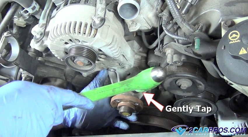

Make sure all water pump mounts bolts have been removed, gently tap the pump using a small hammer to break the seal which will enable the pump to be removed from its location, a small amount of coolant will also be released so have your fluid catch pan ready.

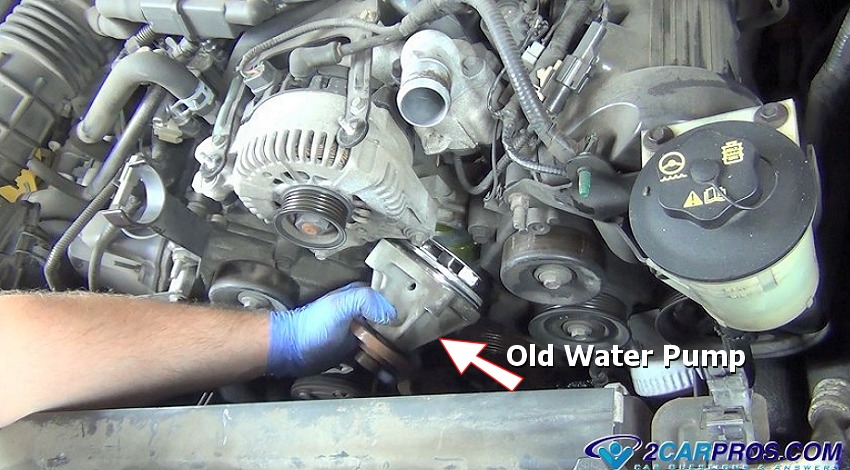

Firmly grasp the water pump and wiggle it loose, be careful no to drop it because it could roll into the radiator damaging it.
old water pump

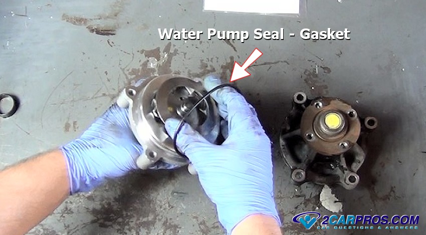

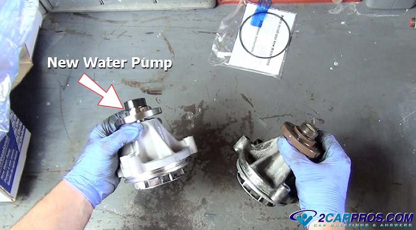

Remove the new water pump from the box and match it to the old pump, check the mounting flange for the fan clutch and the gasket surface, they should be identical. A new gasket or O ring will be included with the new pump, this will help seal the pump to the block or timing cover and avoid leaks.
new water pump
Install the new gasket or O ring seal while making sure not to damage the integrity of either the gasket or the seal, this step is important because it can cause a leak.
water pump gasket

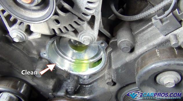

Before the new water pump can be installed the sealing surface must be prepared, this is done by using a gasket scraper or razor blade to remove old gasket making the surface as clean as possible. Use a shop towel and wipe away any dirt and grease from the area until the metal is clean and smooth.
clean water pump gasket seal surface

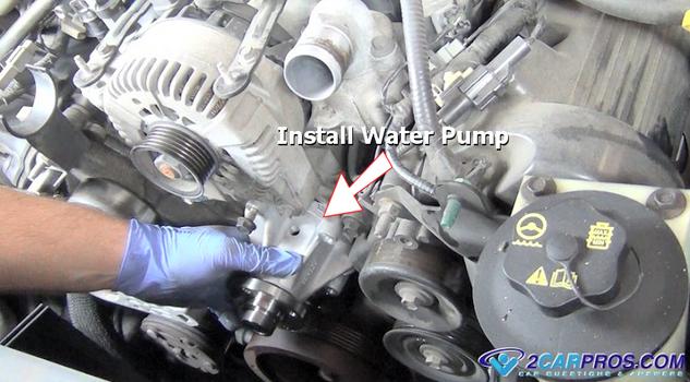

Use a small amount of gasket sealer (silicone rubber) while mounting the gasket to the pump. Lower the new water pump down into the engine bay and gently insert it into the engine block or timing cover and push it into place. Insert one of the pump's mounting bolts to help keep it in place and tighten it by hand, follow up with the remaining bolts. Be sure to insert the right length bolts into their rightful place or damage can occur when tightening.

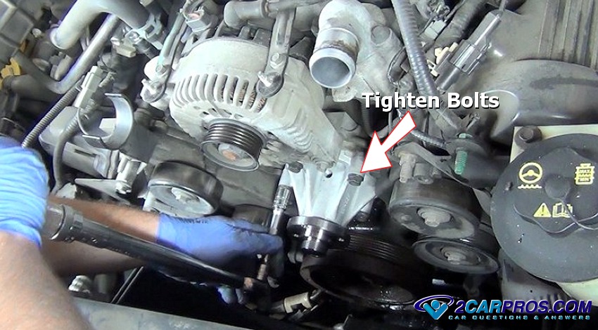

Use a wrench or ratchet to tighten the mounting bolts in a even cross pattern, torque to factory specification which is usually between 19 and 22 foot pounds.
tighten water pump bolts

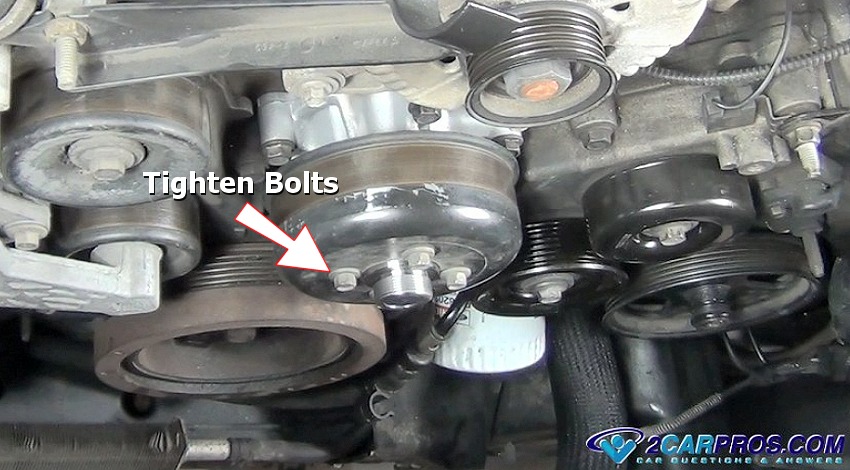

If your water pump is equipped with a detachable pulley reinstall the pulley back onto the pump and insert and tighten the mounting bolts in a cross pattern. Use a large flat blade screwdriver to hold the pulley from turning while tightening. The bolts can also be tightened once the serpentine belt is reinstalled.
