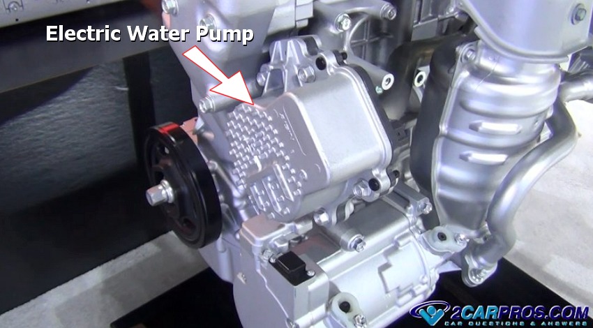

Hybrid Water Pump
As the engine's RPM changes the water pumps flow rate will increase or decrease as well. This is not the case for water pumps designed for hybrid cars. Most hybrid engine's water pumps are electric and are driven by a small electric motor mounted inside of the pump housing. An example of this style of water pump is featured in the image below.
electric water pump
