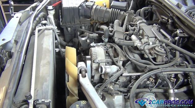

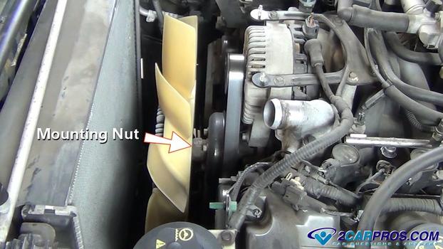

1. Identify the Nut Size
Each fan clutch will have its own mounting nut size which will range from 22mm to 36mm depending on the application and manufacturer. You can also use a large adjustable wrench if you do not have the proper tool. You may need to remove the fan shroud to get at the cooling fan.

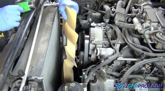

2. Hold the Water Pump Pulley
You must hold the water pump pulley in order to remove the fan clutch from the water pump. They make a special tool for this which you can get from Amazon for about $20.00 bucks or you can rent one for free from your local auto parts store. We loaned out our tool for this job and are waiting for its return so in the meantime we have this large pipe wrench which we were able to sneak onto the pulley to hold it for removal.

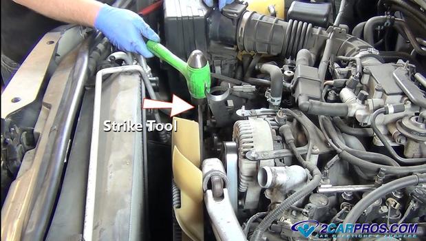

Next we installed a large crescent wrench onto the fan clutch nut. Then we hit it with a hammer to loosen the fan. If you are ever wondering which way to loosen the fan nut (some are reverse thread) it will always loosen in the same direction as the fan turns when the engine is running.
Once the fan is loose simply keep rotating the fan in the same direction while watching the threads to make sure the fan clutch in turning without the nut. If the nut is not turning use the wrench to help it along. Use your opposite hand to support the fan blade so it does not hit the radiator and cause a leak when the fan becomes loose. That would take the fun out of the job. The image below shows the two handed removal method.

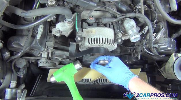

4. Replace the Fan Clutch
There will be four to six 10mm bolts that will hold the actual clutch part of the fan to the fan blade itself. Remove these nuts and the clutch will come free from the blade. Once you have matched up the old fan clutch to the new unit reassemble it by installing and tightening the nuts in a cross pattern.
