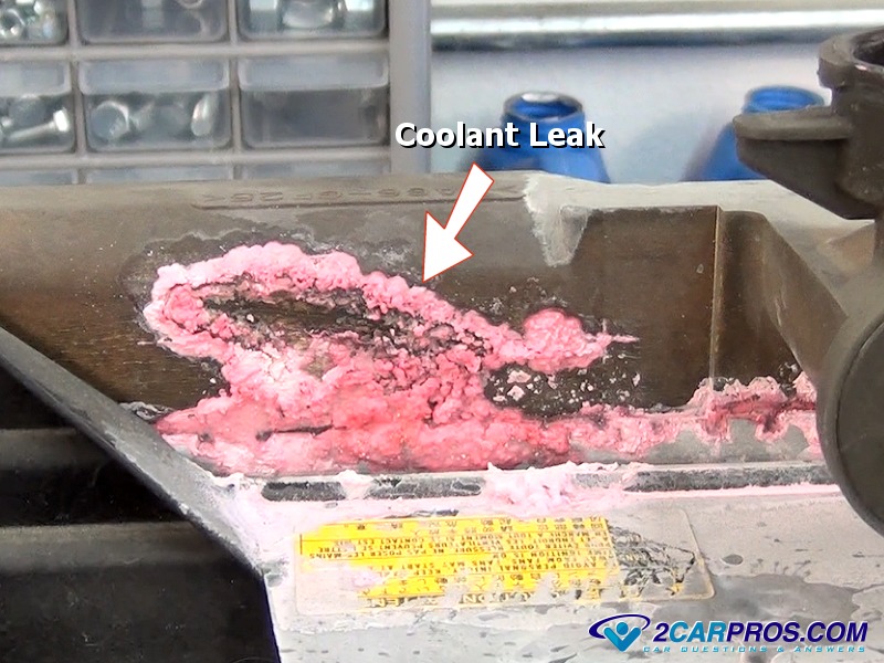

 If coolant levels are left unattended they can become low which hinders the performance of the vehicle's cooling system. This is detrimental to EV's as it leaves the battery pack susceptible to overheating which can render the battery pack useless. On gasoline powered vehicles the same can happen, only its the combustion engine that will pay the price by seizing up or losing compression leaving you stranded. When there is a small coolant leak it can evaporate which is difficult to detect. The reservoir is usually near the radiator and has a colored cap labeled “Coolant” or with a temperature warning icon.

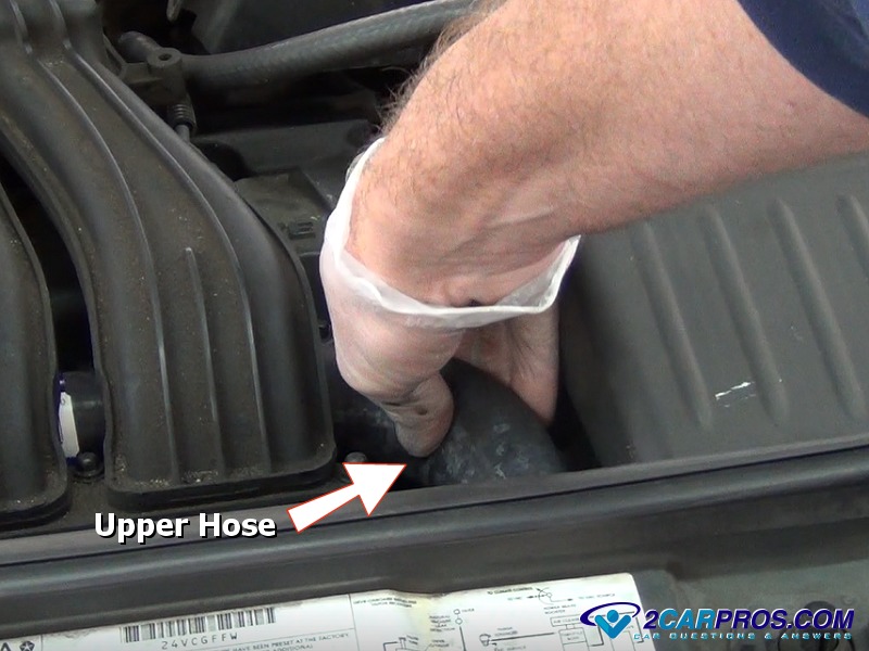

4. Before removing the system cap wear gloves to help protect yourself, also squeeze the upper radiator hose to determine how much pressure remains in the system.

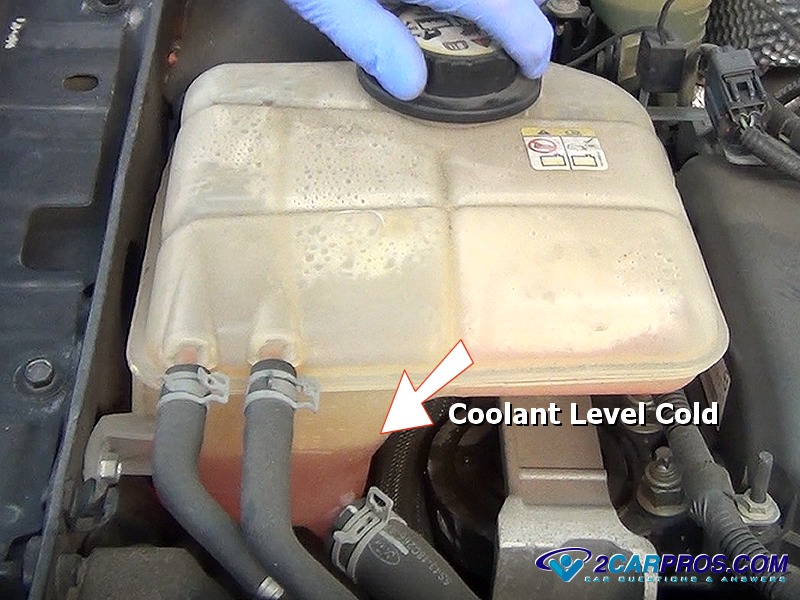

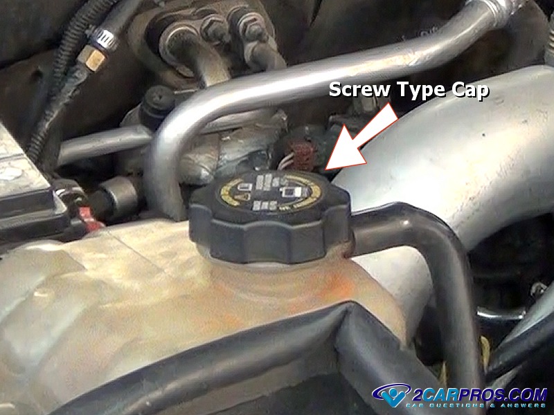

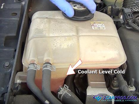

5. Most vehicles have a pressure cap on the coolant reservoir, open the cap slowly (counterclockwise), this will allow any residual pressure to escape. Most radiator cooling systems, (except EV's) are designed with an overflow expansion tank (pressurized) which should be about half full when the engine is cold.
automtoive cooling system screw on type reservoir cap

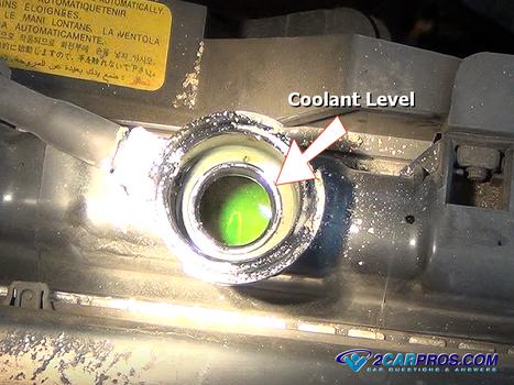

6. Once the cap has been removed use a flashlight to inspect the coolant level, the translucent plastic tank with “MIN” and “MAX” level lets you see where the level should be, if low add only manufactures recommended coolant types. If the level is way down or the system is empty, the cooling system has a coolant leak which should be immediately addressed. After adding coolant, securely tighten the reservoir cap until it clicks or is fully sealed.

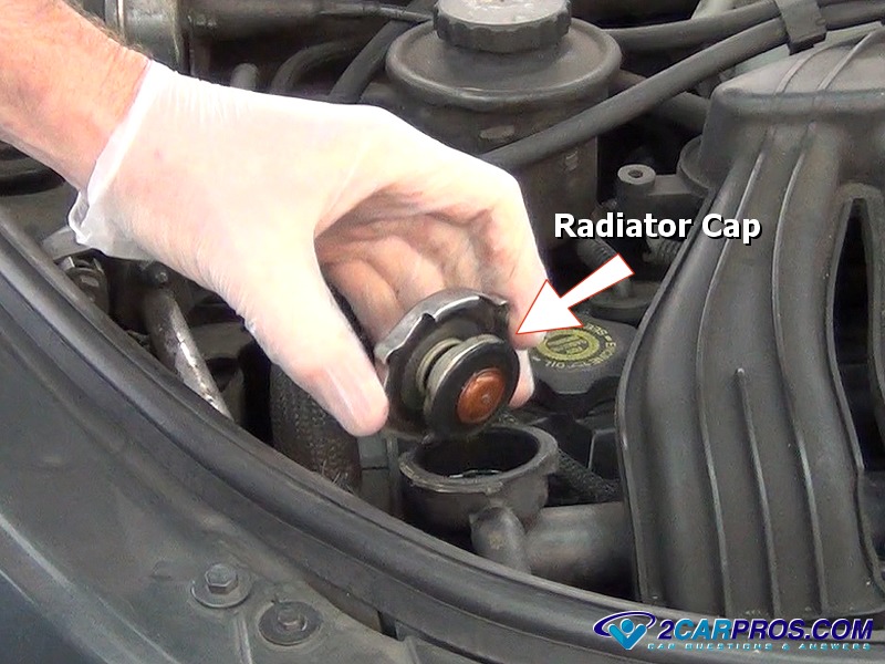

7. Older cars have a radiator cap which has a two step safety "built in" which requires you to press down firmly while turning the cap counterclockwise to remove, we suggest using both hands to remove the cap.
How to remove an automtoive cooling system radiator cap
