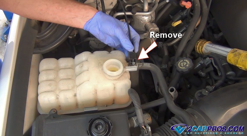

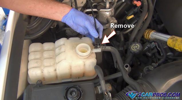

1. Removing Coolant Reservoir Overflow Hose: Remove the reservoir cap and place it to the side. At the top of the coolant reservoir there will be an overflow hose which is designed to relieve the pressure once opened. Using a pair of pliers gently force the tube from the fitting.
2. Remove Coolant Pressure Hoses: Some coolant reservoirs will have a small upper pressure hose designed to transfer air out of the radiator and into the upper portion of the reservoir. Using a clamp removal tool or pliers remove the upper hose. There will be a lower coolant hose which is designed to transfer coolant into the radiator as well, it too will need to be removed by using a hose clamp removal tool.

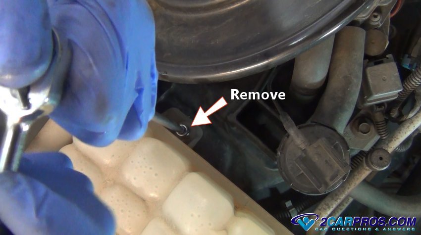

3. Remove Mounting Bolts: There should be two to three mounting bolts or screws holding the coolant reservoir in place. Locate these screws or bolts and remove them using a small socket or screwdriver and turning them counterclockwise. Some mounting bolts could be under the car or in the fender well.

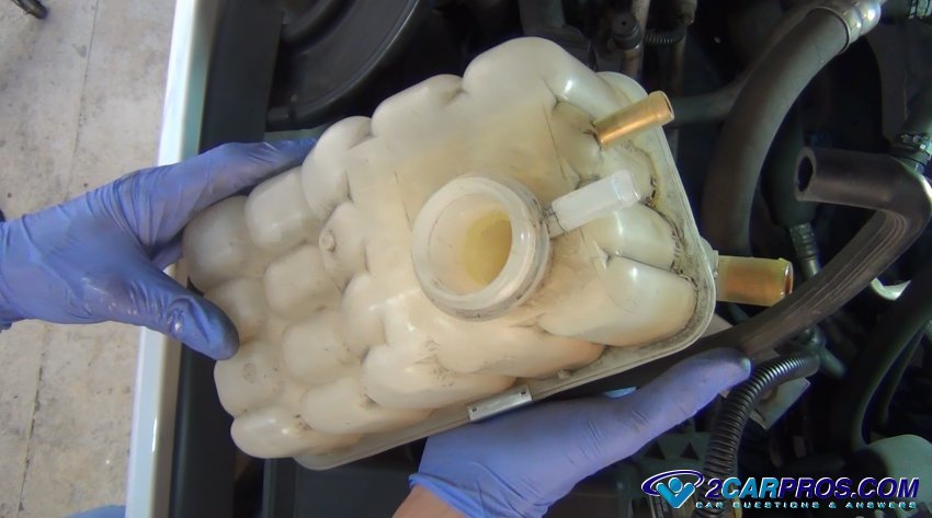

5. Remove Coolant Reservoir: Now the coolant reservoir will be loose in the engine compartment. Grasp the container and maneuver it from the engine compartment. Residual coolant may dribble out of the reservoir so use caution.
remove automotive engine coolant reservoir
6. New Coolant Reservoir: Remove the new coolant reservoir from the box and lay it next to the old unit. Observe the hose connection, mounting tabs and electrical connectors to make sure they or present and in the same locations. Some reservoirs include a new pressure cap like the one in this example. The overflow tube configuration is a little bit different in the replacement unit but will still work as intended.

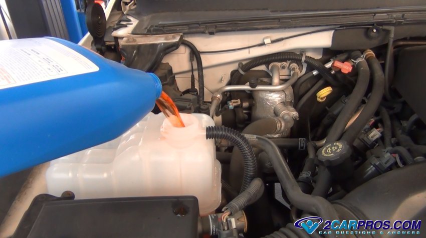

10. Refill the Reservoir: Remove the reservoir cap and refill the cooling system, once the reservoir is about half full, start the engine and allow it to warm up until the thermostat opens and the coolant can fully circulate. Recheck the coolant level and add as needed until it reaches the "full when hot" line on the side of the container. Reinstall the cap and recheck the job for leaks and you are all set.
