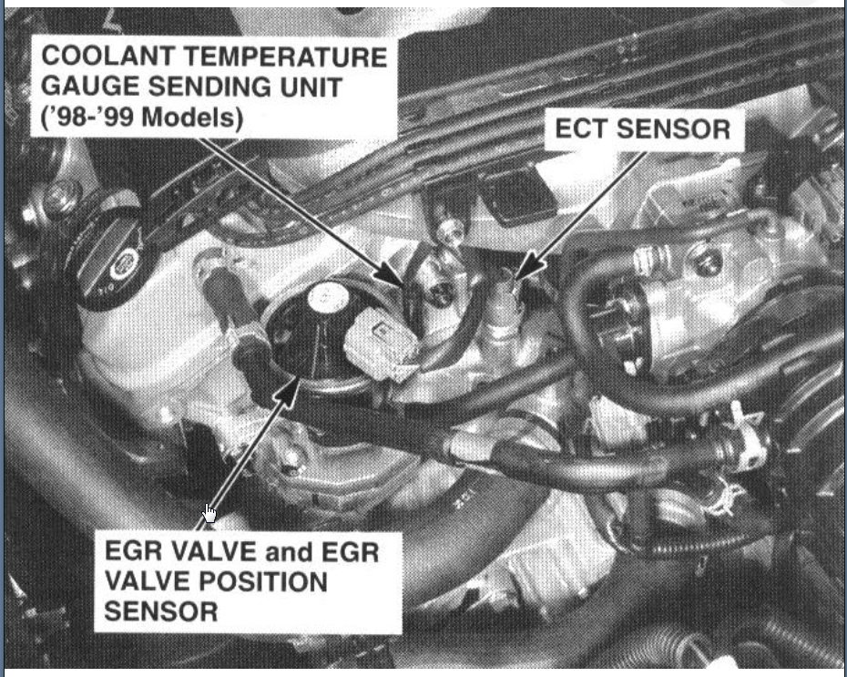

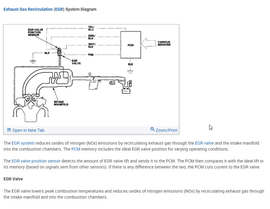

This code is a random misfire and on this vehicle that means the EGR is most likely clogged.
I would remove the EGR valve and see what it looks like. They can be cleaned with the rest of the system but I would just replace the valve and clean what you can of the rest of the system.
This would explain the stalling and the black plugs.

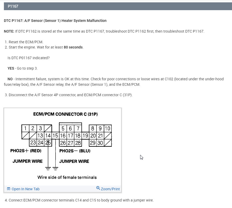

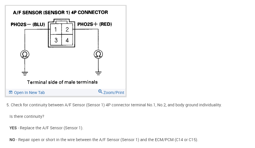

Got a p1167 code for my car.
Aug 7, 2019 at 2:49 PM

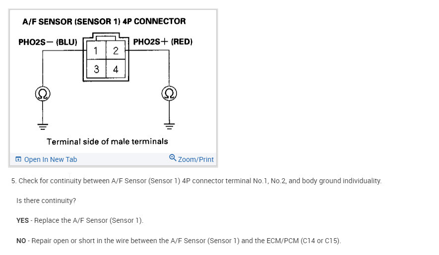

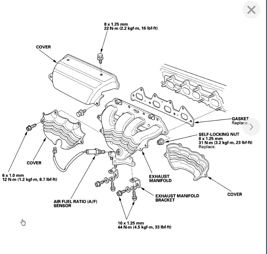

Okay. This could would make sense with the issue you described. This is the Air Fuel Ratio sensor.
This code is saying that either there is a wiring issue with it or the sensor has failed.
Attached is a test for it and a diagram showing where it is located. Let me know what you find. Thanks

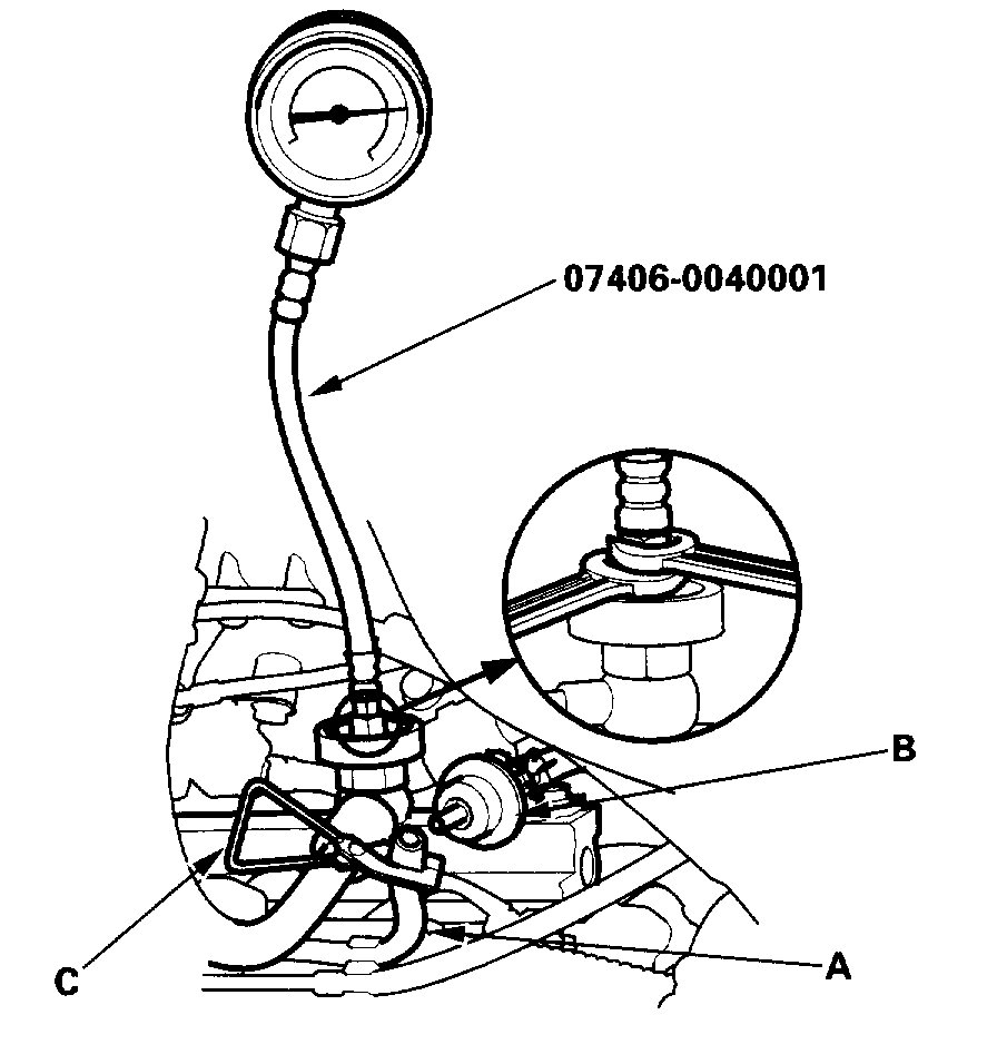

There isn't a fuel shut off. Can you hear the pump run? Have you confirmed fuel pressure?
First, I would check fuel pressure to confirm the pump is working. It could be working and not producing. Here is a quick link that shows how to check:
Here are the specific directions including specs:
Fuel Pressure Test
Special Tools Required
- Fuel pressure gauge 07406-0040001
- Fuel pressure gauge attachment 07VAJ-0040100
1. Relieve the fuel pressure.
See picture 1
2. Use a wrench to remove the fuel pulsation damper from its fitting, then attach the fuel pressure gauge attachment.
See picture 2
3. Attach the fuel pressure gauge.
4. Disconnect the vacuum hose (A) from the fuel pressure regulator (B) and pinch it closed with a clamp (C).
5. Start the engine and let it idle.

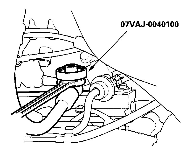

Next, check fuse number 1 in the under dash fuse / relay box. See picture 3
_________________________________________________
Do these tests and let me know what you find. Note: When checking the fuse, confirm there is power to it as well as out from it.
