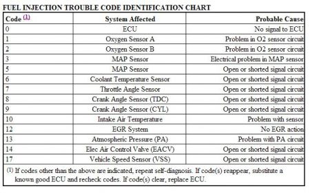

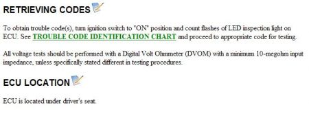

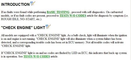

OK, I have done a bit of research and you can do a flash code reading your ECU, the ECU is located under the drivers seat. follow the instructions below and report what code you get.
mark
https://www.2carpros.com/forum/automotive_pictures/61395_1_47.jpg
https://www.2carpros.com/forum/automotive_pictures/61395_2_12.jpg
https://www.2carpros.com/forum/automotive_pictures/61395_4_4.jpg

Ok I looked under the drivers seat and all I found was a wire with nothing connected to it.
Friday, August 28th, 2009 AT 7:47 PM
MHPAUTOS
  • 31,937 POSTS
You must have a carby engine, when you said that you had touched sensors I was thinking that yours was EFI. So no when it wont start you will have to check for spark and make sure that there is fuel in the carby, check this next.

My engine is definately pgm-fi it says right on the engine. I cant figure out where the ecu would be located at. I looked under passengers seat its not there either
Saturday, August 29th, 2009 AT 2:12 PM
MHPAUTOS
  • 31,937 POSTS
If is injected, it got to have an ECU, best give me all the model info you can as Mitchel 1 data base is saying that is where It should be, we will find it.
