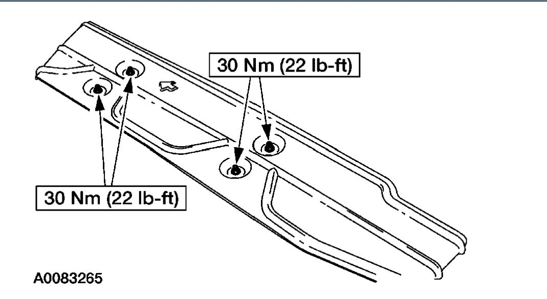

Sounds like the pump has failed. 10-12 lbs is no good.
Replace the pump.

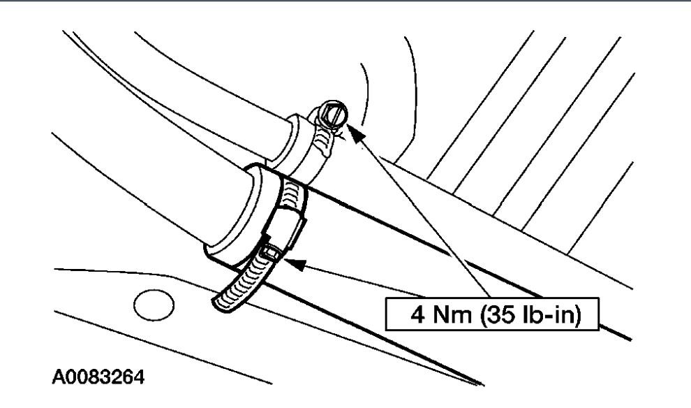

4. Disconnect the fill pipe hoses.
- Loosen the fill pipe main hose clamps.
- Disconnect the fill pipe main hoses from the upper tubes.

5. Remove the four nuts (two per tank strap) and remove the skid plate, if equipped.

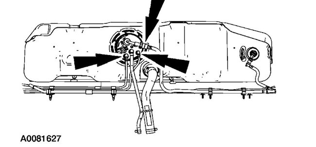

7. Remove the bolts and pivot the fuel tank support straps away from the fuel tank.
ImageOpen In New TabZoom/Print

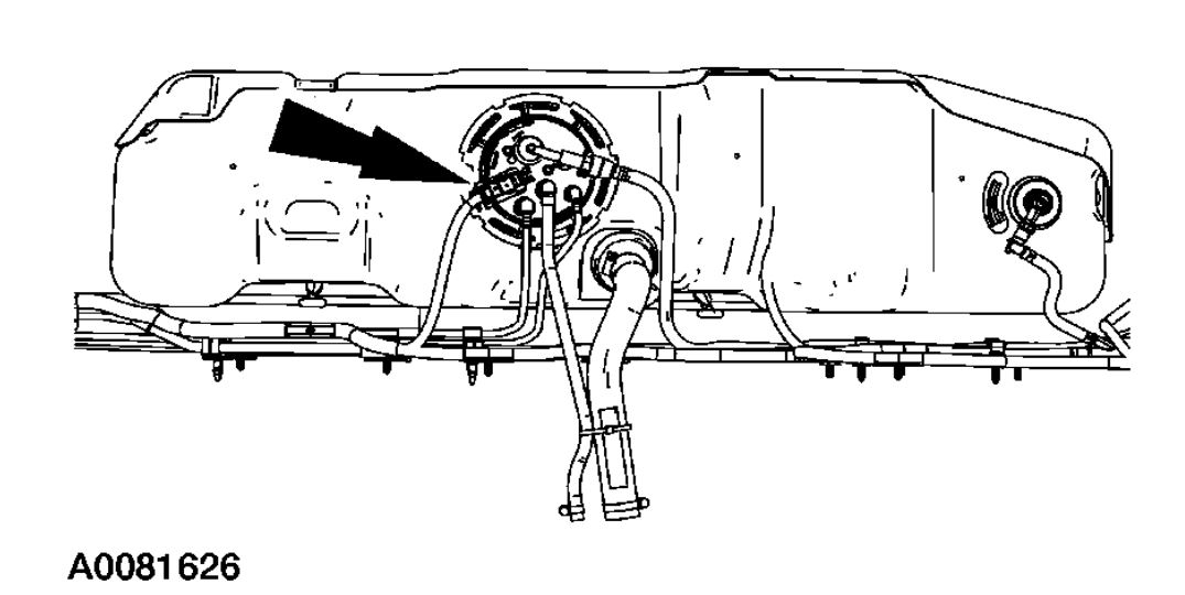

8. Disconnect the fuel pump electrical connector.
- Partially lower the fuel tank for access.
- Disconnect the fuel pump electrical connector.

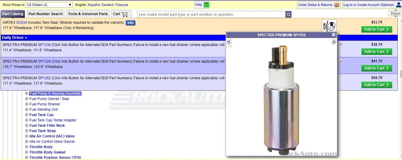

Thank you! Now more comfortable. How can the pump fail and then work so good? A bad valve inside? The pump is an assembly. Your pic shows just the pump. Didn't know you could buy separately. And would that be reliable to do? Want this truck to be trustworthy again.
Tom
Tuesday, March 2nd, 2021 AT 11:26 AM
  • 52,797 POSTS
The motor itself internally is the issue. It can work one minute and not work the next.
