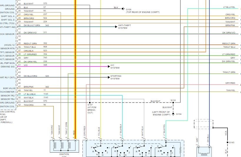

Good morning, No to the inertia switch. If it was bad, you would have had no fuel pressure. When you turn the key to the on position without cranking the engine over can you hear the fuel pump run in the tank for 5 seconds?
Please run down this guide and report back.This sounds like a spark issue. Let me get you a diagram for the ignition system. Roy

Do you have battery voltage to the connector for the coil?
When you crank it, does the tachometer move up a little?

Follow the diagram with the wire I highlighted. Go to the source and check for voltage. I believe it is a common feed from the ignition switch.

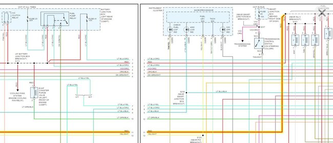

Okay, it quit. After doing CPS test and started afterwards, I closed hood. Now won't start. Yeah! I had added a light bulb to where inertia switch plugs in so I could observe cycle. Short light for short pump run when first turn key on. Then lights constant on while running. After closing hood, I get no light, even when started for short time to run fuel out of rail. Measured volts at inertia sw. Get 12.30 momentary on DG/YE power wire. Then it drops to 6.83v. Any ideas?
Mar 2, 2021 at 3:26 AM
TOMDERWOODS
  • 29 POSTS
My light, I used old sw to use plug in so I didn't cut wires. Soldered across contacts.
That voltage comes from the relay.

Okay. With light connected, same as sw plugged in, it gives me 12.5v then goes to zero. With sw out of circuit, unplugged relay zero goes to 6.92v. Should be zero if relay is only connection to wire.
The pump should run for two seconds. Then full when cranking and running.
Yes it should be 0. At 6 it will run the pump.

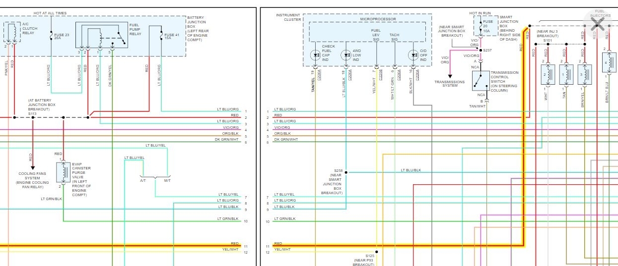

Exactly! I agree. If relay is good, I swapped all 4 into fuel pump position, then it can only be one thing. Connectors at inertia sw plug. The 6.83 volts is at the relay contacts that goes to the cpu pin 40. So I would say floating voltage. You? As I understand, cpu mostly connects the ground circuits. True?
Correct.
