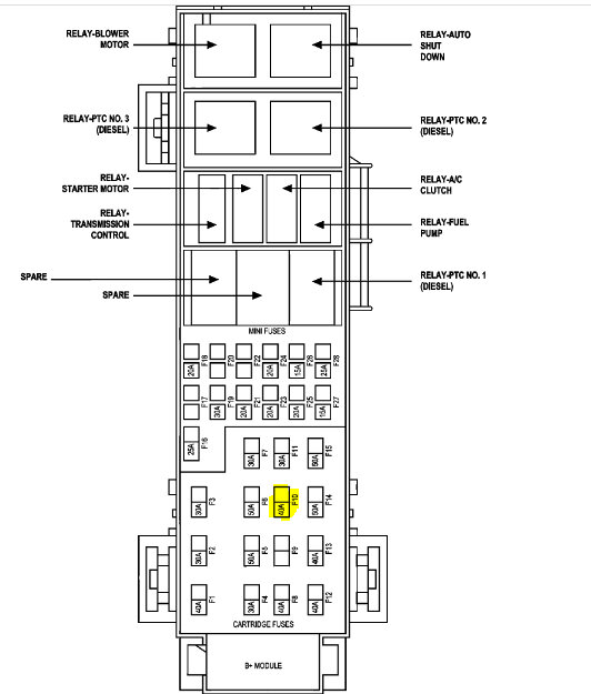

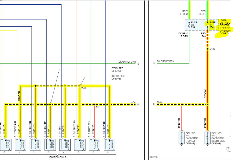

It sounds like you have more than one issue. There are two fuses that can affect the ignition coils. (Fuse 6 and fuse 16) both are in the power distribution center under the hood. Additionally, there is a relay called the automatic shutdown (ASD) relay. If that isn't operating correctly, you won't have power to the fuel injectors and pump, so it sounds like it is. That leaves fuse 16 specifically.
Here is what I want you to try. At each coil, there will be a red wire with a tan tracer. With the key on, that wire should have power. Check that first. If it doesn't, check fuse 16 in the PDC. When you check the fuse, make sure there is power to it.

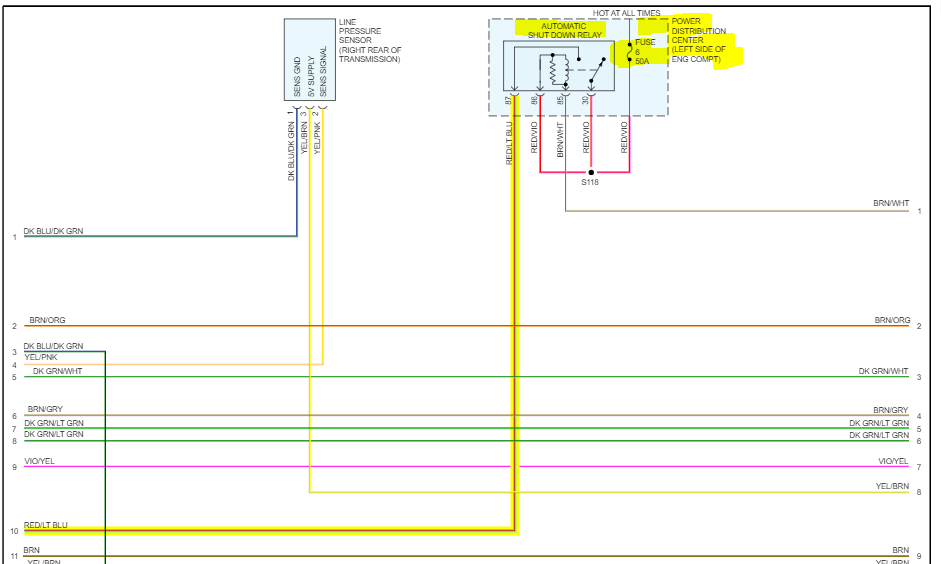

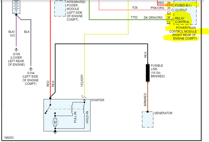

I attached the schematic below so that you have a reference. The first two pics are of the ignition system. The second two are the starter circuit. If the PCM isn't providing a ground path via pin 85 on the relay, the starter won't engage. Additionally, pin 86 is the power supply from the PCM to the relay. Both pins 85 and 86 need checked to see if we have what is needed. Note that both will require the key to be in the start position, so you will need a helper.
Let me know if this helps or if you have questions.

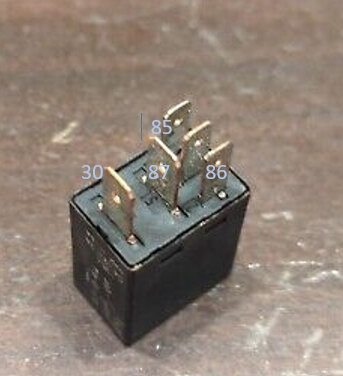

Or remove the starter relay. You indicated it is getting power. Each of the 4 pins is numbered on the relay. Pins 85 and 86 are for the primary side. Confirm one of them has power. If it does, attach the alligator clip of the test light to the battery positive and probe the other connector. Have someone turn the key to the start position. In that position, your test light should turn on. If that doesn't happen, that is why the relay won't actuate.

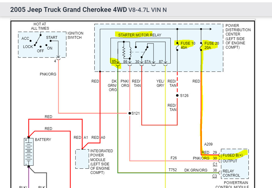

It should have a connector schematic on the relay itself. As far as the yellow wire, if there is no power, check fuse 10 in the power distribution center under the hood. Also, check it for power. See pic below for the fuse location.
Keep in mind, the yellow/gray wire will only have power if the relay is working, and the key is in the start position. I'm assuming there is power from the ignition switch to pin 86 when in the start position and ground at pin 85 in the start position.
Let me know what you find. Also, I realize giving directions online are not the easiest to follow. Please let me know if you have questions or if I'm not making sense. LOL
See pic below.
Nov 9, 2023 at 8:26 PM

okay, so, the yellow wire is 87 on the relay so to test that I have to have the relay connected? also, what am I looking for at the ignition switch? As in the wires that would be involved In my situation, also is there a way to test the skimm?

To check pin 87, yes it needs to be connected. Use a thin paper clip or wire and push it in with the relay on pin 87.
As far as the ignition switch is concerned, don't worry about the switch at this point. When the key is in the start position, pin 86 should get power. If it does but pin 87 doesn't, then I need you to check pin 85 for continuity to ground when the key is in the start position.
The easiest way to check for a ground path at pin 85 is this. Take the alligator clip end of a test light and connect it to the battery positive. Probe pin 85 with the test light. When the key is placed in the start position, the test light should turn on if a ground is provided.

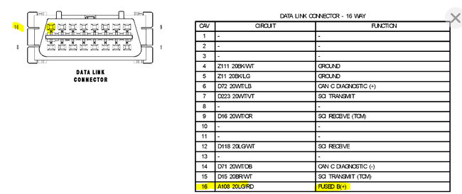

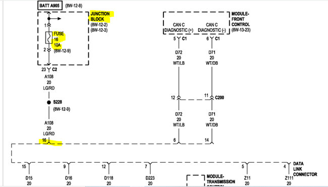

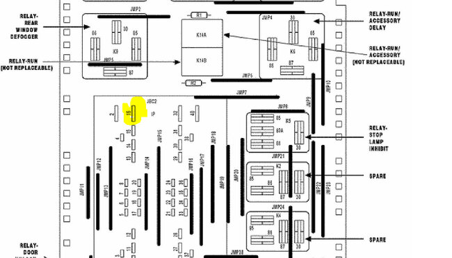

  • 110,194 POSTS
Pin 16 in the DLC should have battery voltage at all times. Check to see if that is the case. If there is no power, check fuse 16 in the junction block. When you check the fuse, confirm there is power to and from it.
I attached a pic of the DLC to help locate pin 16. Pic 2 below shows the fuse in the junction block.

Update- the obd2 port is not communicating with the PCM I tried to have my key reprogrammed and he couldn't do it because of this.
Dec 9, 2023 at 11:23 PM
  • 110,194 POSTS
Check to see if there is battery voltage to pin 16 at the data link connector. If there isn't, check to see if fuse 16 in the under-hood fuse box is good. See pic below.
See pic below.
