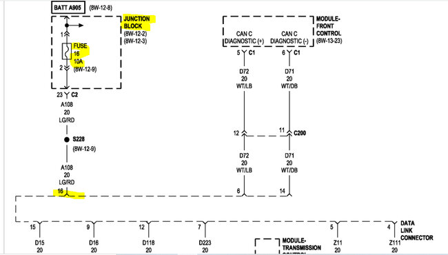

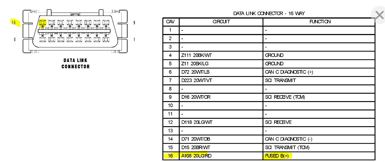

Pin 16 in the DLC should have battery voltage at all times. Check to see if that is the case. If there is no power, check fuse 16 in the junction block. When you check the fuse, confirm there is power to and from it.
I attached a pic of the DLC to help locate pin 16. Pic 2 below shows the fuse in the junction block.
Friday, November 10th, 2023 AT 10:29 PM
BILLY WEBSTER
  • 31 POSTS
The pin has power.

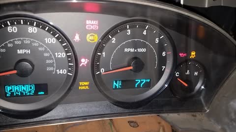

I don't know if this helps. Not even sure if it was making that squealing noise before now.
Tuesday, November 14th, 2023 AT 10:18 AM
  • 109,913 POSTS
I believe the red flashing light indicates the immobilizer is activated. Am I correct that is the light?
Tuesday, November 14th, 2023 AT 2:54 PM
BILLY WEBSTER
  • 31 POSTS
I'm pretty sure but I haven't found much documented on it. Every other jeep light I saw had symbols not just a red light.
Tuesday, November 14th, 2023 AT 3:10 PM
BILLY WEBSTER
  • 31 POSTS
It's starting to add up I think because I had a similar issue after I started working in it. I changed the timing chains and when I put it back together if I remember right I was having a no-crank issue after replacing the crank and camshaft sensors and eventually the PCM at the same time I changed the head gaskets I was stoked because I hit the key and it turned over and started for a second a few times then stalled out. I figured it was old gas but the next day I went to crank it and got nothing.

As far as the PCM, you need to run a can-scan, but that can't be done with the DLC issue. Did you check the pins identified as ground in the DLC pic above?
Tuesday, November 14th, 2023 AT 8:35 PM
BILLY WEBSTER
  • 31 POSTS
Yeah, I had the pis on 16 and neg on 4 and 5 and it read 12 ish for each.
Tuesday, November 14th, 2023 AT 8:57 PM
  • 109,913 POSTS
Double-check all connections at the PCM. If they are good, chances are the PCM is the issue. If we have power and ground where it's needed, that is my first suspect.

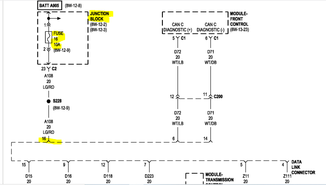

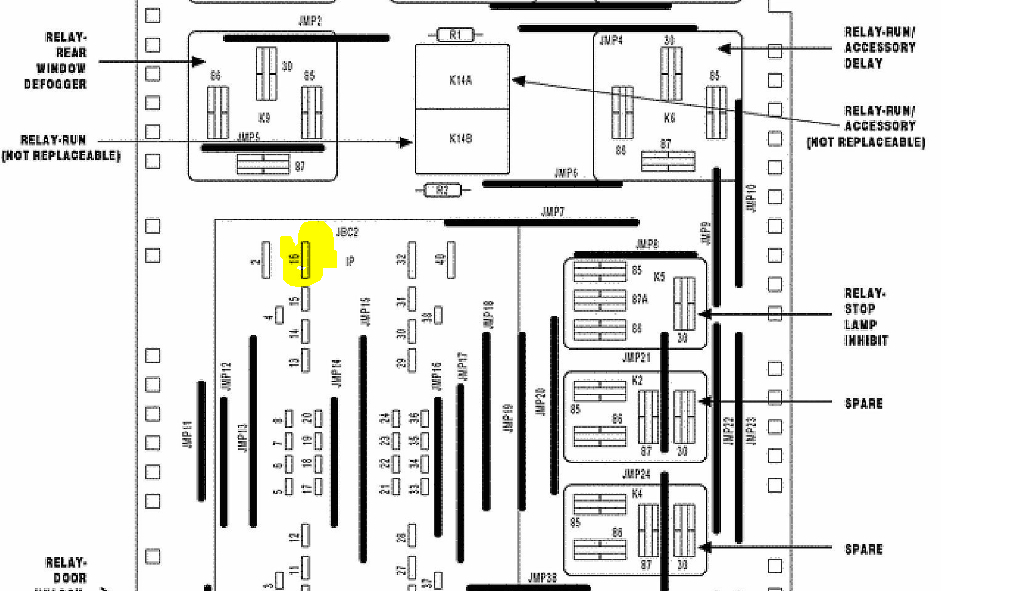

Check to see if there is battery voltage to pin 16 at the data link connector. If there isn't, check to see if fuse 16 in the under-hood fuse box is good. See pic below.
Let me know what you find.
See pic below.
