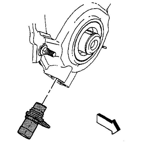

SIMPERFI84
  • 14 POSTS
Hey Roy, finally found time to work on truck, I checked compression on all 8 cylinders and this is what I got. Cylinders, 2, 4, 6, 5, read 210psi, cylinders. 1, 3, 7, and 8 read 205 psi. I also checked spark at all eight plugs I have good spark at all eight. I did discover cylinder #3 seem to me like it was firing continuously, ( no gap in spark). I hooked a timing light to the #3 wire and it was almost a steady light little to no strobe. Hope I explained that well enough for you to understand me. I am guessing a bad distributor cap. What do you think. I have not replaced cam sensor yet either, ran out of day light today. Let me know your thoughts please. Thanks.
Wednesday, September 2nd, 2020 AT 6:01 PM
  • 52,797 POSTS
Okay, if you spray starter fluid in the air filter, will it start and stall?
SIMPERFI84
  • 14 POSTS
No it will not. I do know it is getting fuel I have pulled upper peluim and visually confirmed injector pulse and had helper crank engine to see if each injector was spraying fuel.
SIMPERFI84
  • 14 POSTS
Hello Roy, Just wanted to update you on my truck issue. As I mention #3 plug was continuously firing. Done a little research and came across a post with similar symptoms. They said they unplugged the # 3 wire and truck started right up. So I gave that a try today, sure enough it fired right up. Turns out it was the distributor cap. Which I had swapped but after I pulled the distributor to check it for damage. Long story short, I installed it 180 degrees out which still had the same issue. Anyway I swapped caps again just to check putting bad one back on and I also reset distributor. Anyway I got it sorted out and truck is running fine, I will have to scan it for correct cam retard but it has to be pretty close, running good and no codes. Thanks for your help.
