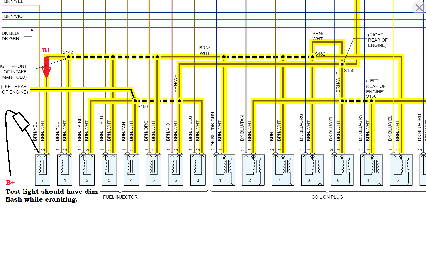

Parked the truck went to leave 3 days, later and crank no start. Fuel pump runs 50ish PSI in the rail fires with starting fluid. changed oil sending unit. Checked fuses and relays seem good.
I crossed the ASD relay, and the truck started and ran. Please help me!

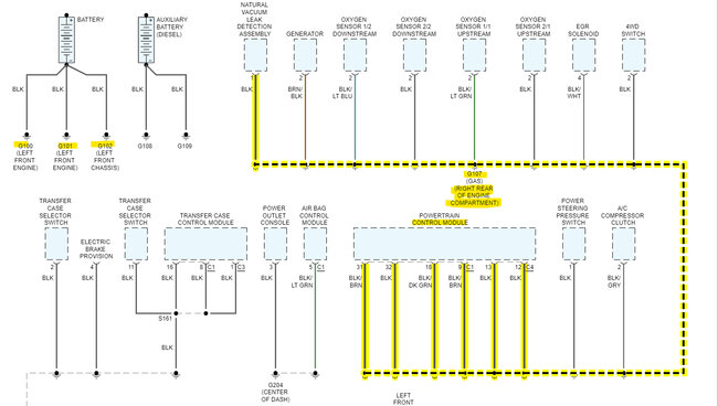

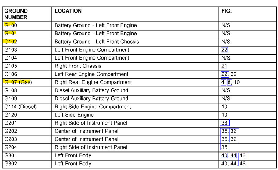

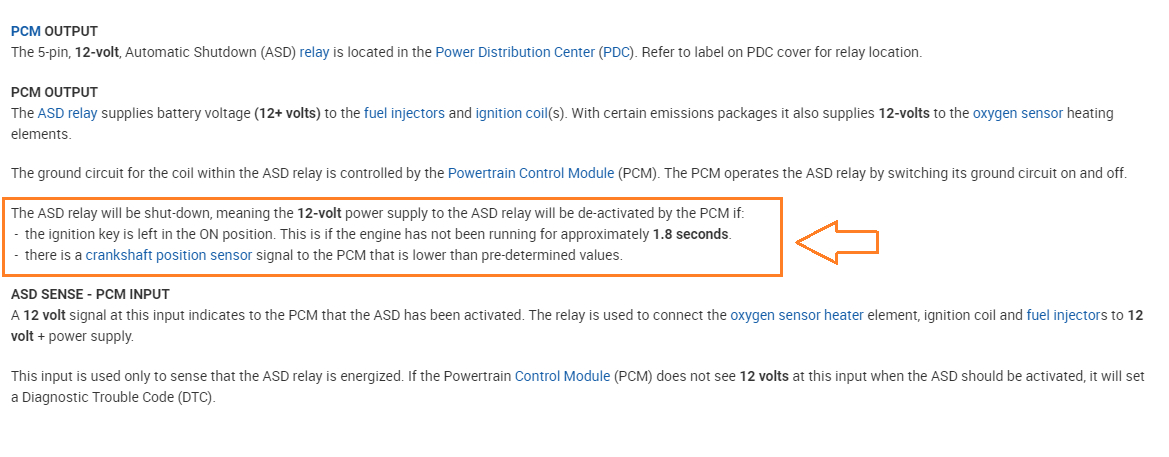

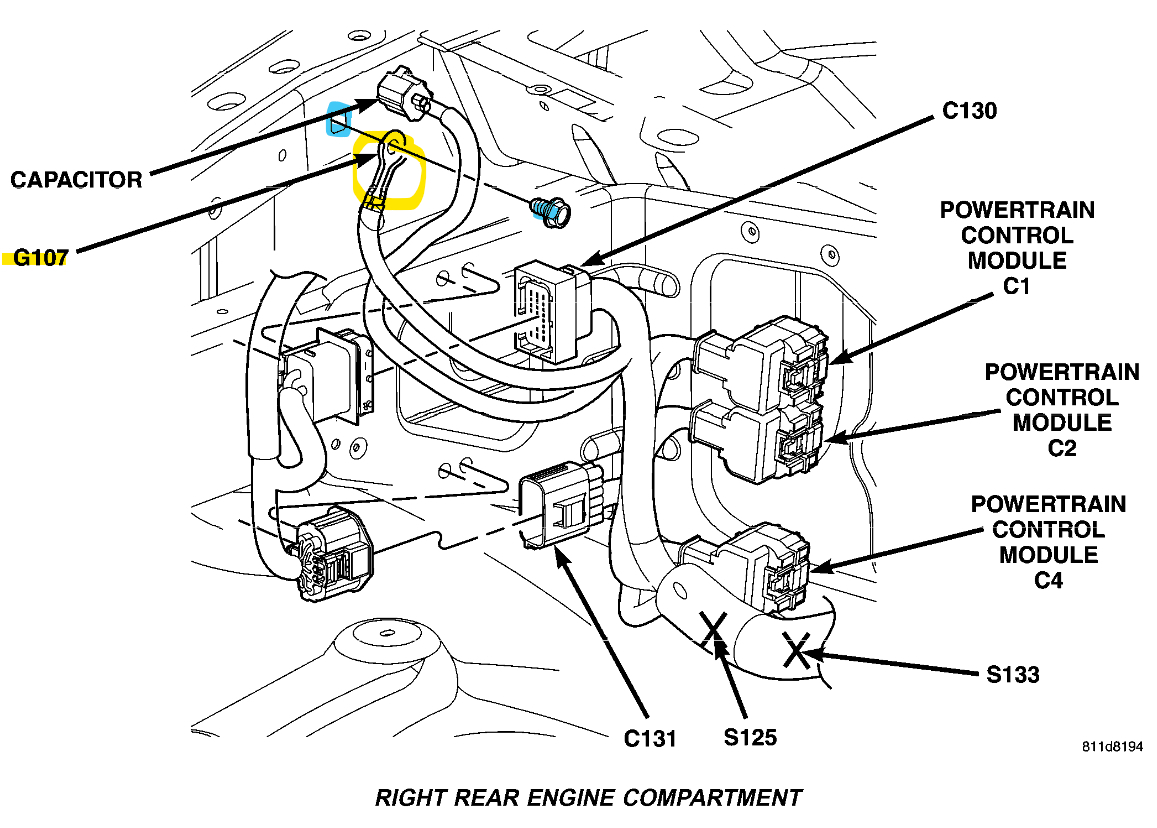

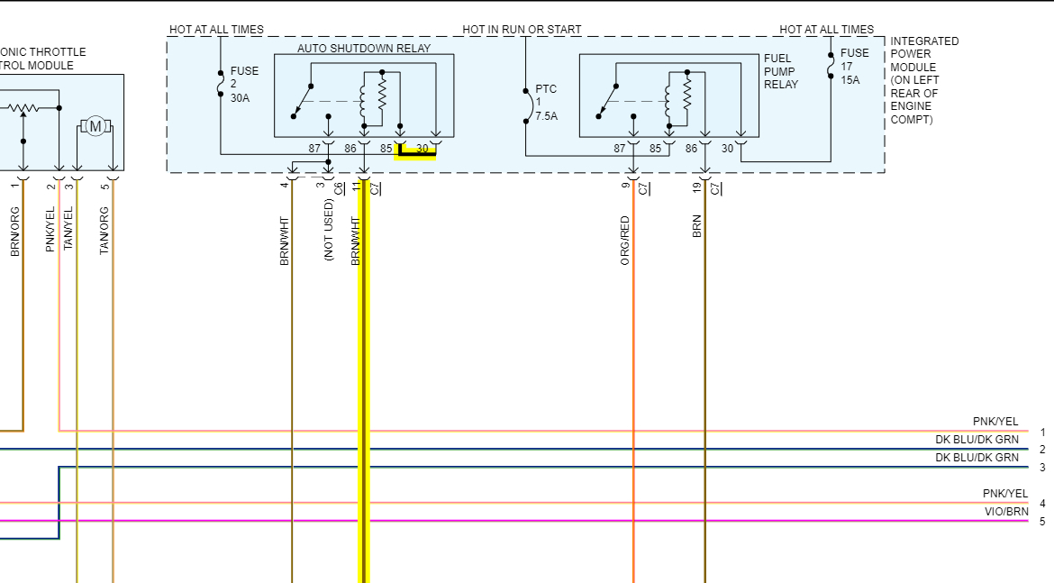

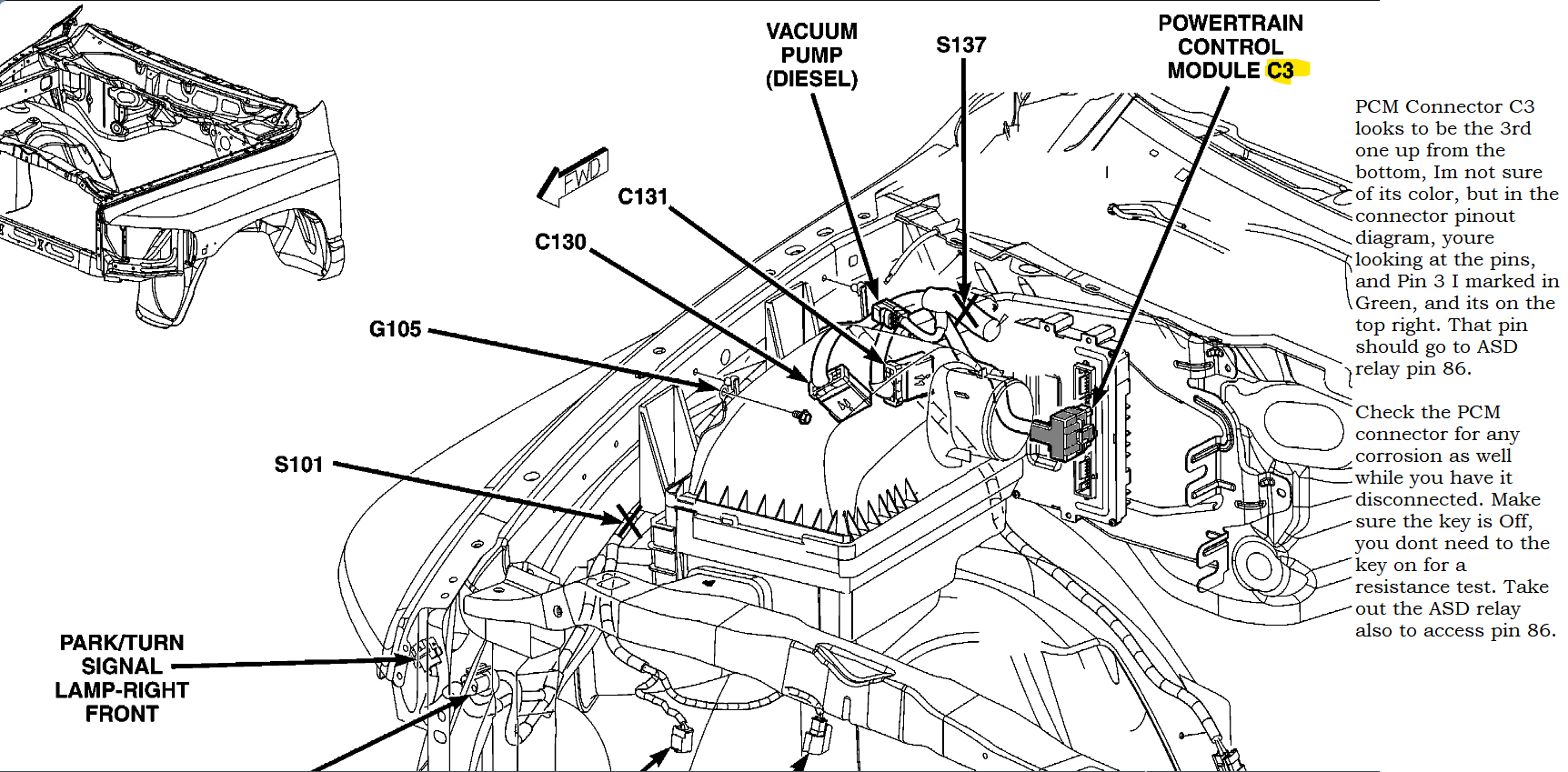

Hello, the ASD Relay powers up pretty much everything. With the relay out, you should have 12v on 2 of the pins where the relay sits, and 1 pin should be grounded by the PCM when key On or cranking. So, it sounds like the relay is missing its ground control. Have you gone through and checked all the grounds on the vehicle? Does the Check engine light come on when you turn the key to the on/run position?

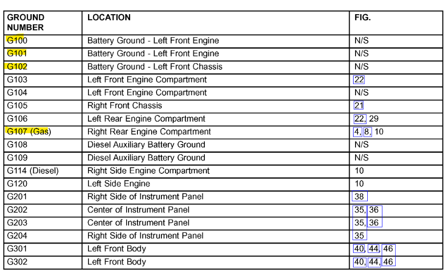

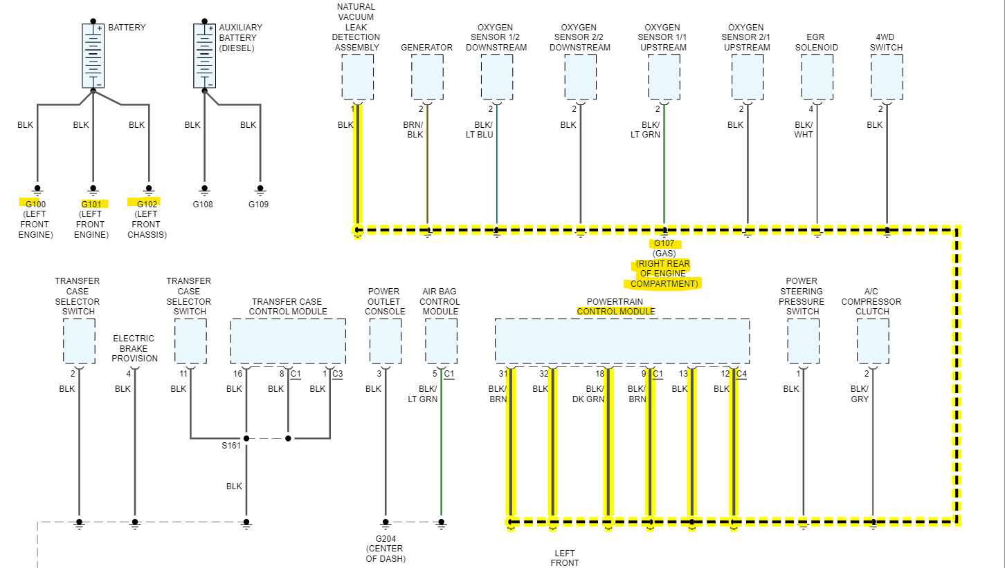

Here are some Ground locations to check for the PCM.

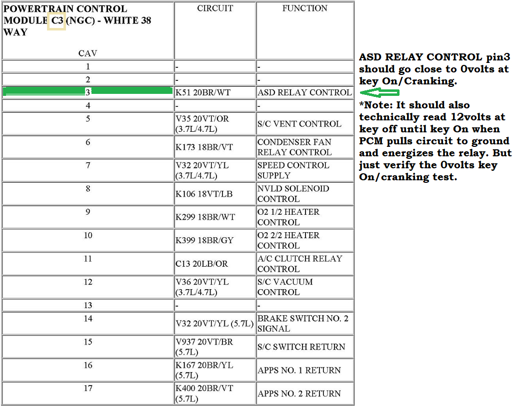

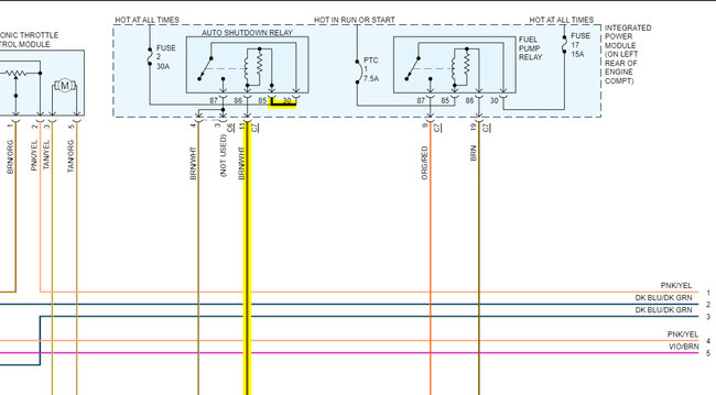

And the 1st diagram has the wire that the PCM should ground for the ASD Relay.

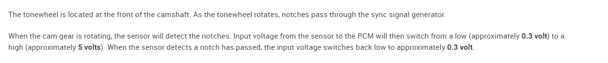

The PCM will also shut down the ASD relay if the crankshaft position sensor signal is lower than it should be, but since you can get it running by jumping the relay, it sounds like there is a lack of grounding for the relay. Check the frame to body ground straps too, sometimes those braided ground straps fail but you can't always tell by looking at them.
Its best to use a basic multimeter and with the key on, check for voltage drop from the battery negative to the engine block and frame, then to the body and see if there is any large voltage drop happening around the truck.

Okay. I'm sorry I didn't explain further, but pins 30 and 85 should have 12volts all the time, key on or off. They are hot at all times. Pin 86 is the pin that should be grounded when the relay is energized by the PCM. So, you can put one meter lead on battery negative and the other on pin 86, and if you have someone else first turn the key to just the on/run position you should read just about 0volts (or very low mv) for a couple of seconds.
The PCM only energizes the relay for about 2 seconds at just key on. And then cranking you should read the same, a very low reading because the PCM should be grounding the relay during cranking, The ASD Relay powers up the Fuel Injectors and the Ignition Coils. Thats why when you jumped it the truck ran ok.
But if the PCM is not grounding pin 86, then that's an issue. If you find that it doesn't, then we will take it from there. It might be a bad relay, a wiring issue back to the PCM, or something else is causing the PCM to not energize the relay.

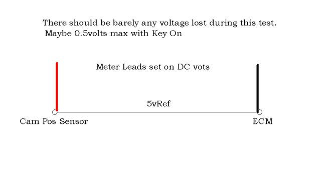

Below is just a very simple example of voltage drop testing, here you can see I am checking from a cam sensor to the ECM, I am measuring how much voltage is being lost from one point to another, that's all it is. But the circuit has to be on, you can't have any voltage drop unless some current is flowing between those 2 points.
So, if you want to check for voltage drop from Battery negative to the engine block or frame, you have to have at least the key on.
Thats the first simple explanation for it, it does get much more complicated in some situations, but for now, and easy test you can do with an incandescent 12v test light is to hook the test light clamp to Battery Positive and touch the test light tip to the engine block and then the body and frame.
The test light should light up brightly, because you have current flowing through the test light to Ground on the engine block, frame, and body. If it lights up very dim or not at all, you know you don't have a good ground from the battery to engine block, frame, body etc.
But do the first test with a meter in the first paragraph up top there and see if the PCM is grounding pin 86. You should be able to do that with the relay out. The PCM will set a code for the ASD relay in this case because it has a circuit that watches for power coming from the ASD relay, but for testing purposes we won't worry about that right now.

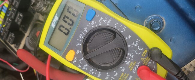

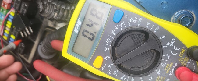

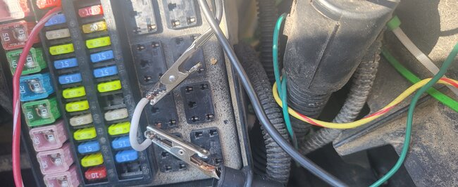

Okay, here's what I did, I took out the ASD relay and hooked up the negative to the negative post and had my wife. Turn the key to the on off position. Then I touch the positive to the 86 pin at roughly the same time. And it went point 3 six, and then jumped to something. A different higher number and then back to point 36. Then I had her turn the Ignition to turn it over and did the same thing. And the numbers were the same point 3 six, roughly point 36. After it bounced up and then came back down.
Aug 2, 2023 at 9:04 AM
LONNIE CARR
  • 52 POSTS
Okay, here's what I did period I took out the ASD relay and hooked up the negative to the negative post and had my wife. Turn the key to the on off position. Then I touch the positive to the 86 pin at roughly the same time. And it went point 3 six, and then jumped to something. A differen. T higher number and then back to point 36. Then I had her turn the Ignition to turn it over and did the same thing. And the numbers were the same point 3 six, roughly point 36. After it bounced up and then came back down.
LONNIE CARR
  • 52 POSTS

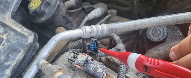

Afterwards, I hooked up the test light to the positive post and checked the block. The frame and the body and the light was bright on the test light the picture I sent you was what the multimedia red after. I had the Ignition completely on to run and tested it. Without anything else, that's what it was reading, and I showed you that I have my multi meter set the way I do. If that's incorrect, please let me know, thank you.
Aug 2, 2023 at 9:07 AM
AL514
  • 5,674 POSTS
Okay, so, you had 0.48v on pin 86 with the meter going to battery negative when you turned the ignition switch to the on/run position and cranking? Did you try swapping the relay out with the A/C compressor relay? Actually, almost every relay that looks like the ASD Relay in this truck has the same part number, you just can't use the fuel pump relay because you need that to start the truck. But a voltage drop of 0.48v (about 1/2 a volt) is good. It should run with a different relay in there. Do you hear or feel that relay click when key On or cranking?

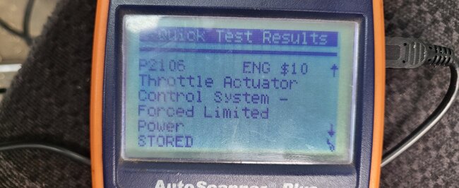

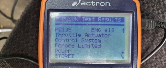

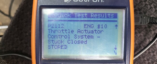

I checked the throttle body and cleaned out some of the carbon. The lightning bolt comes on now after. And the check engine light comes on and stays on. I guess the lightning bolt flashes. I had to change the Ignition switch in the column in January. Cause the blower motor to quit. I finally the last part I changed. Was the Ignition switch and that was it? There are a couple burn marks where the Ignition switch plugs in. I added a snowplow in January. That's some nothing major.
Aug 3, 2023 at 1:00 AM
AL514
  • 5,674 POSTS

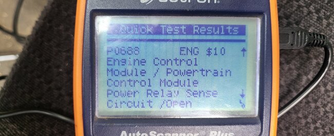

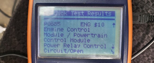

You didn't force the throttle plates open to clean them, did you? As for all these codes, erase them and see what comes back. Most of these were set while you had the relay out with the ignition switch on during testing. But forcing the throttle plates open on a drive by wire system can damage the electronic motor that controls the TAC (Throttle actuator). But do any codes come back with the relay in place, and everything normal?
Aug 3, 2023 at 1:30 AM
LONNIE CARR
  • 52 POSTS

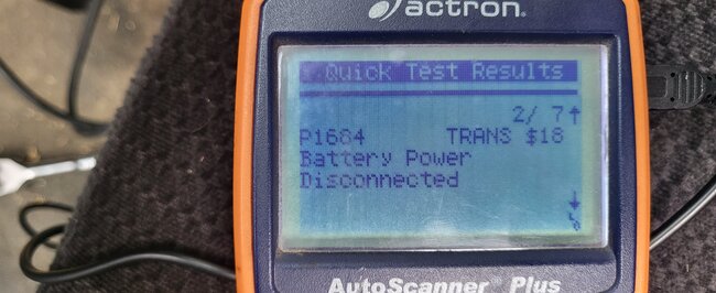

I had P0562, and P0700 Pop-up, I also switched batteries from another vehicle that runs period Put a battery that had 12.5 V resting. I did not get a load reading off of it. Cranks over just fine did not start. Yes, I did mess with the actuator.
Aug 4, 2023 at 4:32 AM
AL514
  • 5,674 POSTS
Well, the throttle plates on these electronic throttle bodies are not supposed to forced open by hand, but what you can try to verify they are still opening ok is turn the key to the On/run position and have someone push on the gas pedal for you and you should see the throttle plates move, but yeah both of those codes are still low voltage codes.

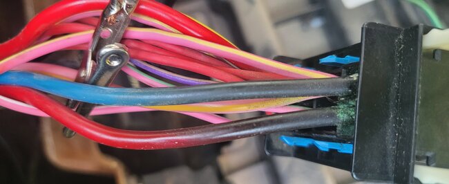

Those burn marks on the ignition switch harness plug would be the next concern here, if the connector got that hot, there was high resistance in that location. Can you reach the plug you mentioned and try a wiggle test to see if that connection is having a pin fitment issue? Any time connectors get even warm, the first thing that comes to mind is pin and connector issues, even after the components changed out. With these voltage codes that needs to be checked. I'll see if I can find a diagram for the ignition switch and we'll check for power making it through. There might be some sections that are not sending a full 12volts or are breaking down under an electrical load.

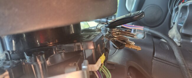

Switched the new ignition switch out with the old one thinking that something else burnt out, No luck. The ignition switch I'm talking about is in the steering column. I will take pics. I wasn't keying on that because the pins that plug into the burn out, control the blower control switch and it works.
Aug 4, 2023 at 6:03 AM
AL514
  • 5,674 POSTS
Yeah, I was meaning the ignition switch on the column too. There wasn't any burn marks on the ignition switch harness plug?

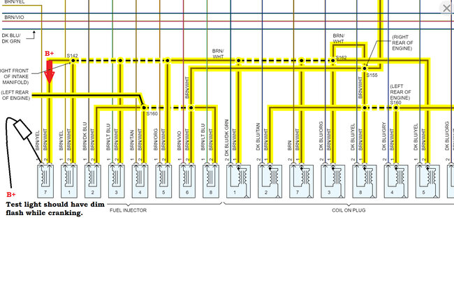

Let's go back to the basics here. that will tell us if there something else going on with power to the PCM. You said in your first post the truck will run with starting fluid, correct? If so, then there is no fuel injector pulse.
With your test light hooked to battery negative, key On check for power at one of the fuel injector wires, if you have power, then hook the test light to battery positive and probe the other fuel injector wire, while someone cranks the engine over for you, the test light should have a dim pulse to it. The PCM should be pulsing the Ground (control) wire of the fuel injector, and this will cause the test light to pulse. If the test light does not pulse at all, there is no injector control. This is an injector guide below, but we just need to know there is power to the injectors for one, and then know that the control side is being pulled to ground by the PCM,
It can be a quick 5 min test. and we'll know there's no injector control. You had enough fuel pressure, so really, we should have started with the basics first, but that's okay, let's see what you get.

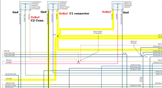

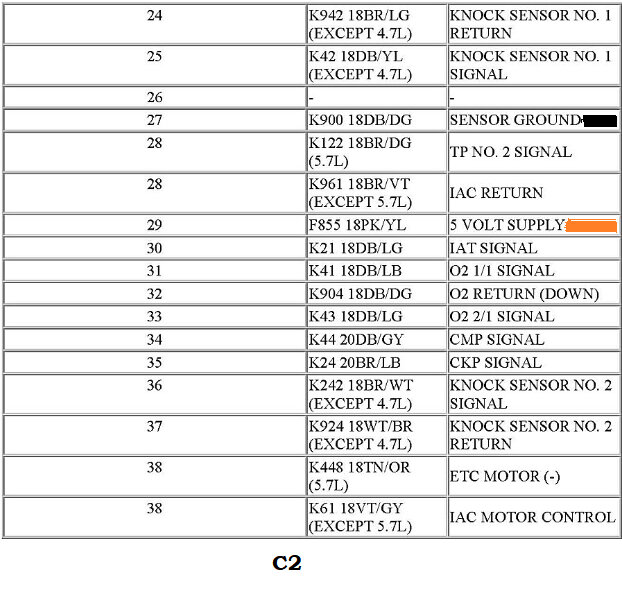

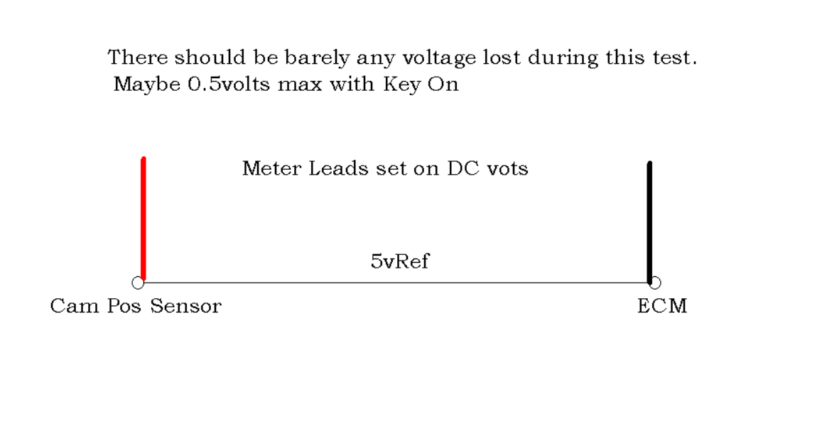

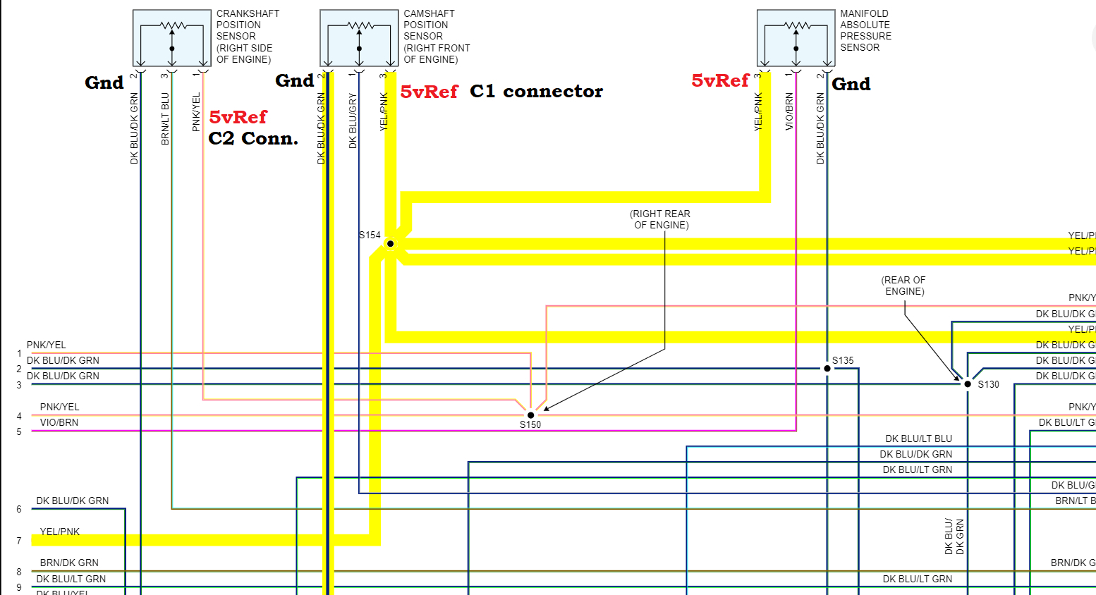

The 5v Reference feed for the Crankshaft position sensor looks to be a different 5vRef than the one for the Camshaft position sensor. So, it might be the cam sensor that's not working.

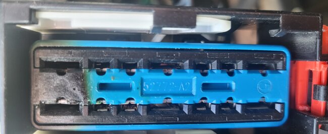

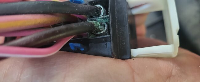

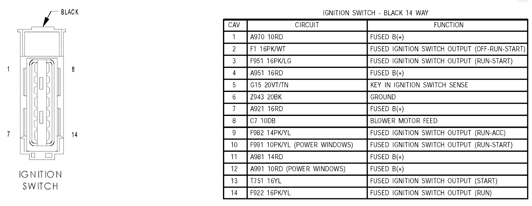

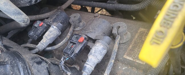

There might be more of a problem than I realized. After looking a little closer, this is what I've got. The line on the left is actually a red wire. It is burnt about an inch up the Wire, the other one is a blue wire.
Aug 4, 2023 at 6:54 AM
AL514
  • 5,674 POSTS

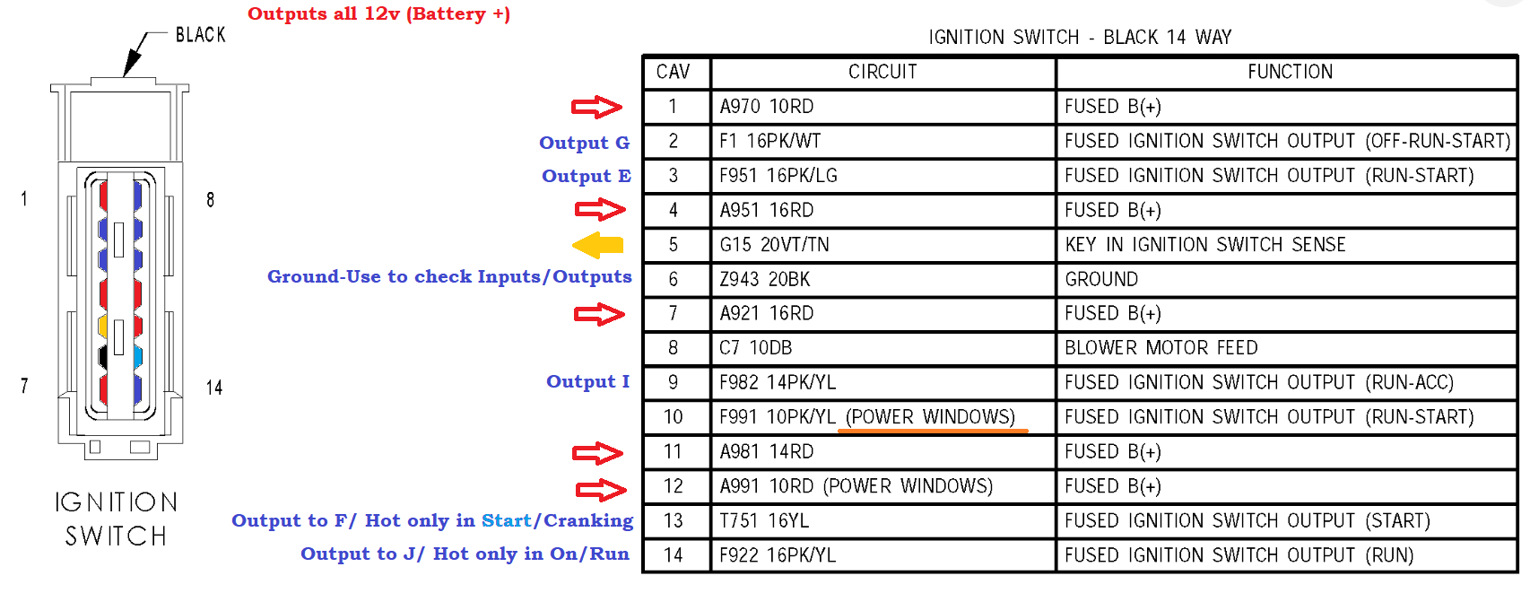

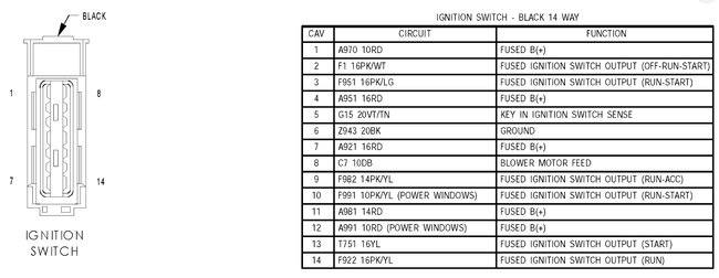

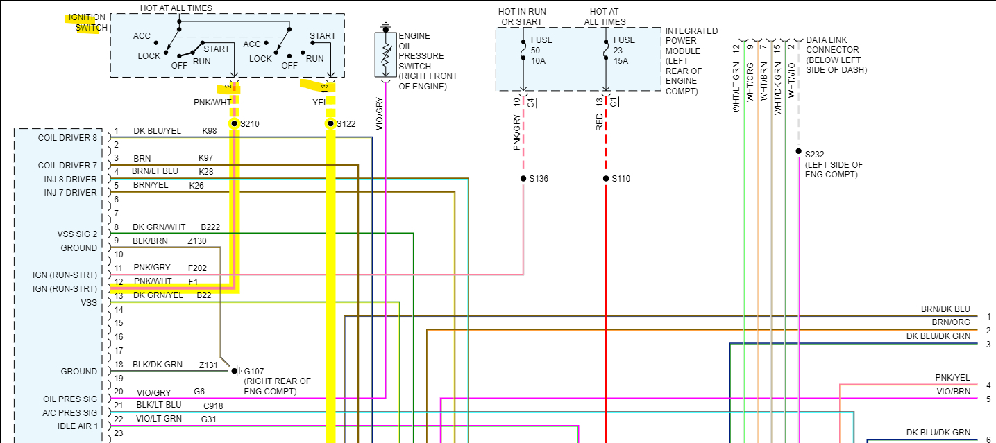

Oh wow, there's the problem, in that second picture the green corrosion, those overheated connector pins. This is the ignition switch connector, correct?
That green corrosion is causing resistance and overheating those wires. The red wires are the feed from the fuse panel and the other colored wires are the output wires.
I would replace that entire connector, get a new pigtail for the switch.
Here's the pinout for the ignition switch connector.

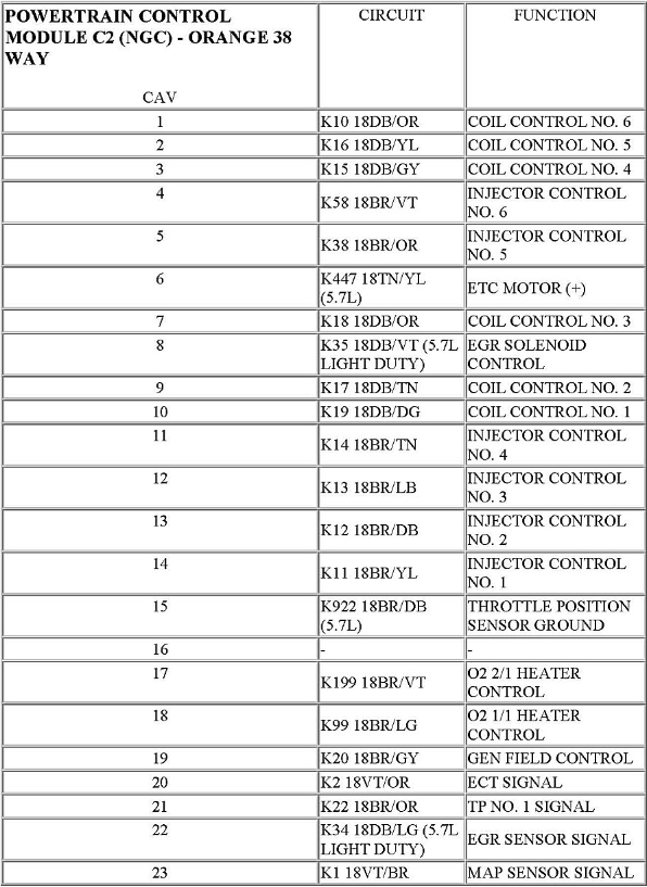

Hello, sorry for my delay, I just got power and internet back on today due to the huge storm that hit a couple days ago.
Okay, did you check for power going in on the red wires and power coming out on all the other colored wires? I'm writing up a testing diagram for you, there is this one circuit I'm concerned with, it's this "Key in Ignition Switch Sense" circuit. Service info states it opens and closes a Ground circuit for a Central Timer Module. So, I'm not sure if that is the Ground labelled on the Ignition switch connector diagram or a different one. But you can check if the pin 6 (Ground) opens and closes a ground circuit with putting the key in the ignition and taking it out, I'm labelling all these other Outputs to check as well because some of them are only hot in either Start/Cranking or on/run.
The concern would be that with the harness connector getting as hot as it did, there might be some damage we just can't see. So I'll have you check all these B+ inputs and Outputs first from the connector, Im just checking where this sense circuit goes first,
We're still at just a Crank No Start condition, correct?

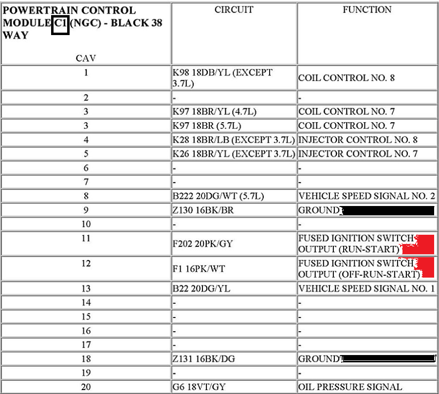

Here is the voltage input/output testing for that ignition switch connector. Check this first, then we're just going to go right to the PCM for testing to see what's missing.
Now when back probing the PCM connectors you have to be very careful, using a T pin or back probing pin, very easily slide the T pin along the wire into the connector you're testing. We need the PCM connectors to be plugged in to see if the PCM is receiving the voltage it's supposed to. You may have to remove the back cover of the PCM connectors to do this, but don't force them, just probe far enough to get a reading. Use a multimeter hooked to battery negative for both power and ground testing. Write down the results of each pin. There's not that many to check, I've noted what should be there and the one that is a cranking test. If you don't know, what back probing pins are I can post a picture if needed but let's just go right to the source here and see if the PCM is missing any power or grounds. Let me know if you have any questions
Go through and check for any blown fuses as well, that ignition switch looks like it may have shorted out, connectors don't get that hot without doing more damage.

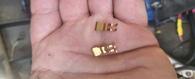

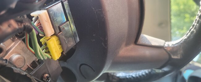

The brass tabs fell out of one of these connectors, the yellow or the white. That's part of the steering column. It's just right behind the steering wheel and betmean the tilt or well, just next to the. The next pictures are going to be of the coil wire and the test light. Make sure I'm doing it correctly. There is no light when I'm hooked from the negative and touch the wires of this connector on the coil. I did not test with the Positive post because I have nobody to crank. And I figured with no juice 2 from the negative. It didn't make a difference anyway.

Pins 1,4,7,11 and 12 tested at 12.11 V.

That yellow connector might be for the airbag, so I wouldn't mess with it too much until I can figure out what they are for.
They are for the airbag, do not touch that yellow connector or you might trigger the airbag and it will go off in your face. That's a serious hazard.

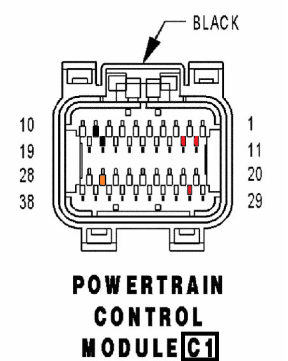

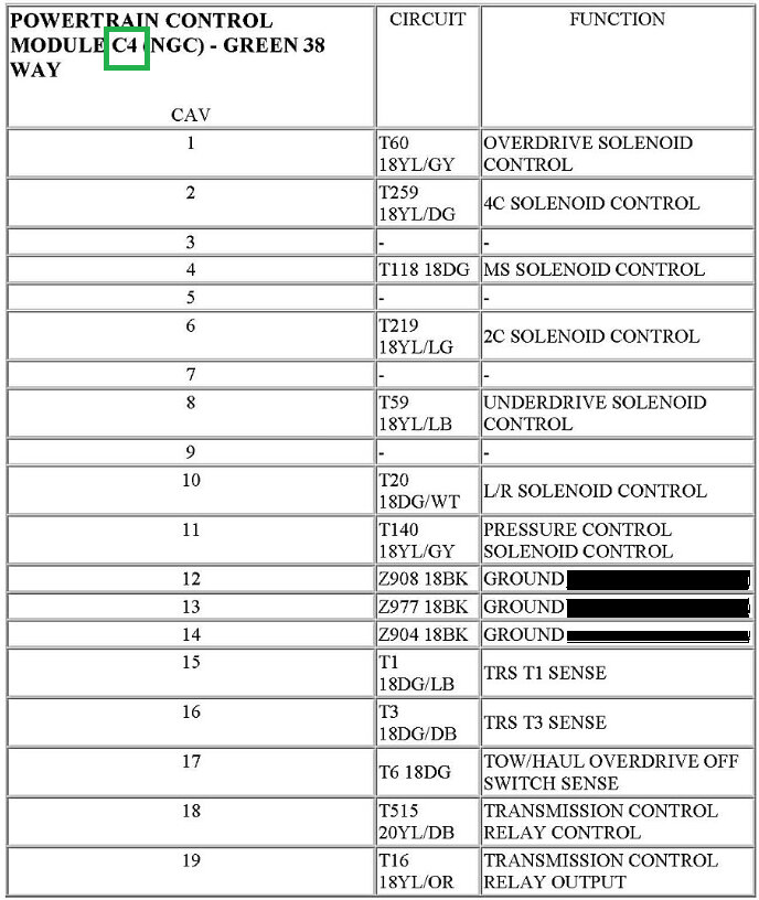

Okay, 6 is a ground, so use that for your ground location while testing to verify its good. Or hook to a 12v source and touch pin 6, you should read 12v. The Key in Ignition Switch sense might be the issue. If the PCM or security system does not sense the correct key or any key at all, then its preventing starting from the Ignition switch. I'll check what is supposed to be there for a voltage signal. I would think just 12volts. But ill verify that.

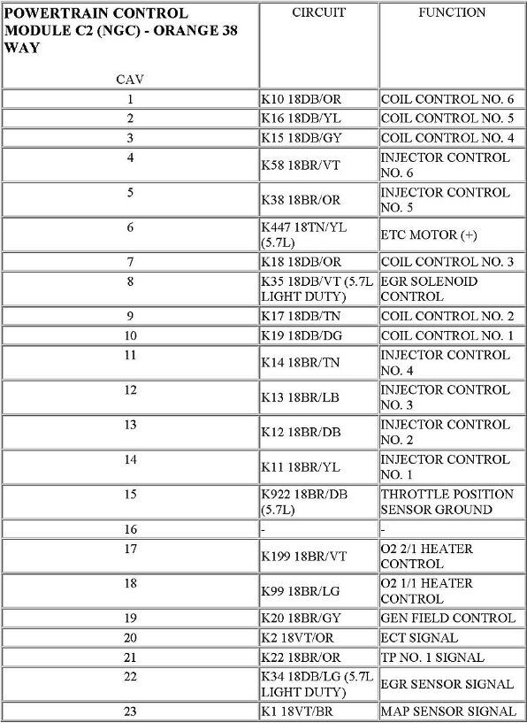

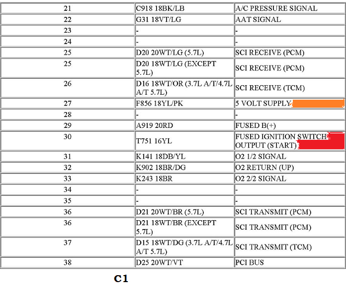

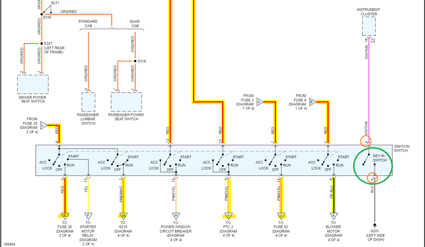

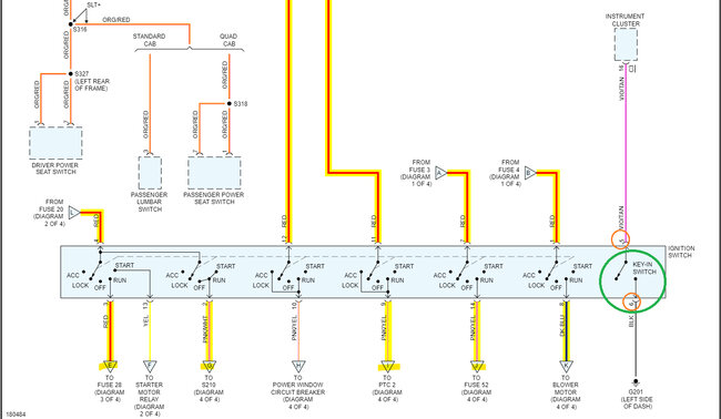

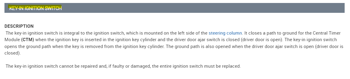

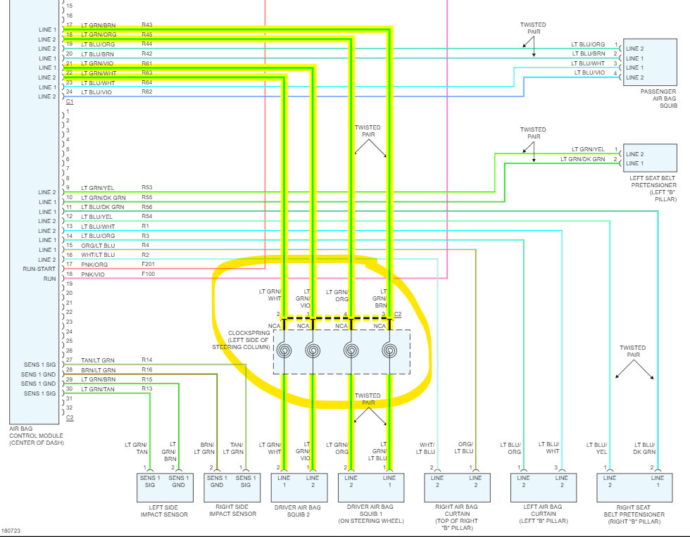

Ok the way they word this is a little confusing, But the key in sense closes a path to ground for whatever this Central Timer Module is, so it looks like pin 5 should create a Ground when the key is inserted, the service info here states something about the driver's door being open, but it doesn't really make a lot of sense as to what they are doing with the door switch. For testing purposes, I would try to tape the driver door switch closed so it's not messing with testing the Ignition switch. With the way that was overheated. I would be surprised if it's not damaged. But try getting the door switch to stay closed while checking that. I'm going to dig around for more info on the operation of this circuit.

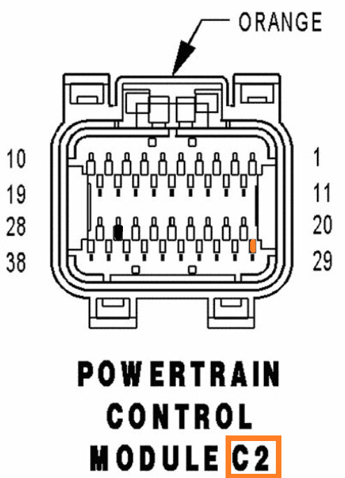

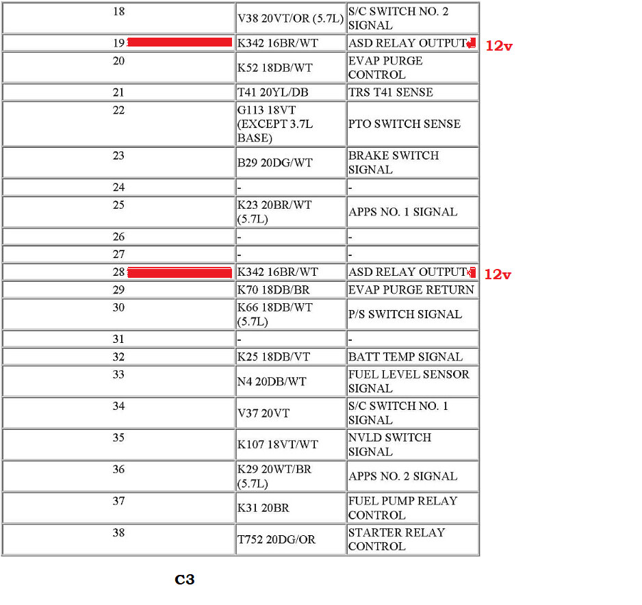

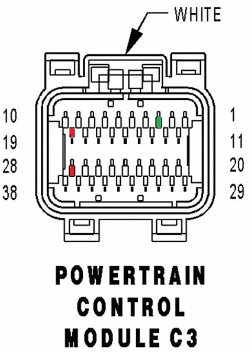

Okay, the 3rd diagram shows what pin 5 and 6 do, they complete a Ground to the BCM, so with the key in the Ignition switch there should be continuity from 5 to 6, and 6 to ground.

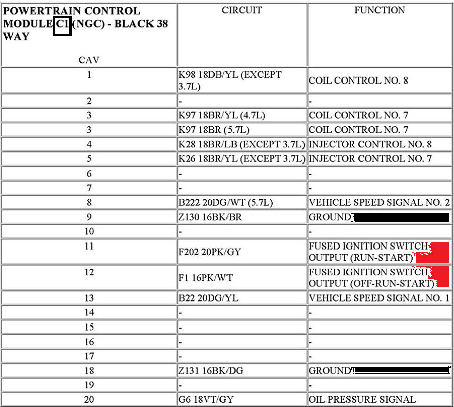

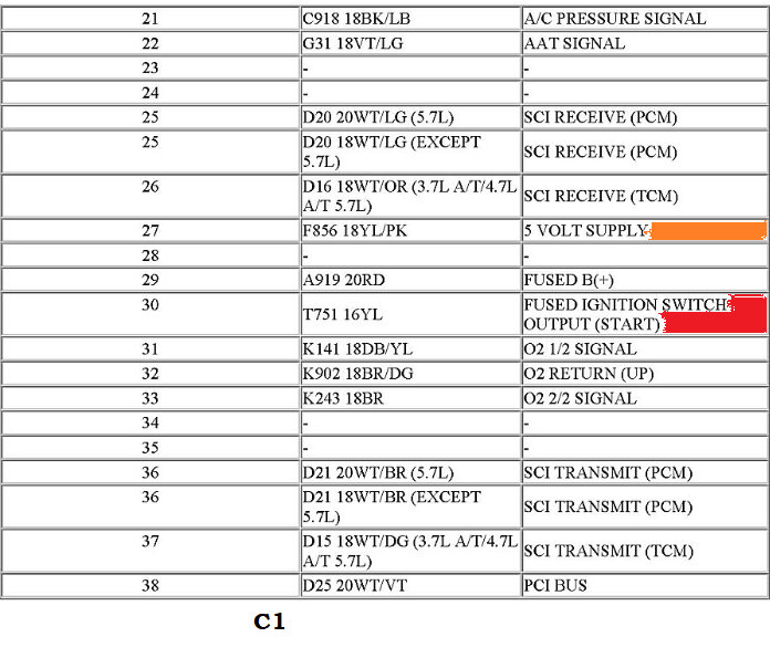

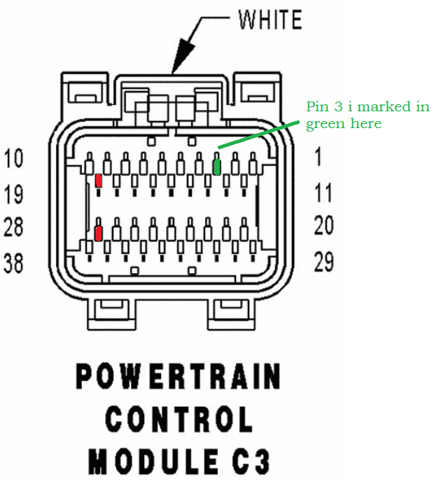

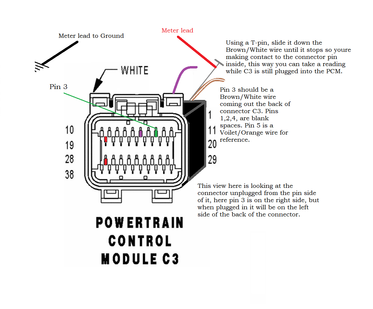

If all that checks out ok, then we need to go directly to the PCM connector C3 pin 3 and see if the PCM is giving the ASD relay ground. If it is, then there is an open circuit between the PCM and the ASD relay Ground for pin 86.
PCM connector C3 should also read an output from the ASD relay on pins 19 and 28, they should read the 12volts coming out of the relay. You can see this in diagrams 4,5,6.
So, I would back probe C3 pin 3, it's a brown/white wire and it should read 12volts until you turn the key on and then crank it should go to 0volts because it's activating the relay and being pulled to ground.

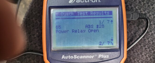

Let's go right to the PCM and check there, because you did have a code for the power relay being an open circuit. Let's make sure this is not an open wire somewhere causing all this.
Aug 16, 2023 at 2:37 AM
LONNIE CARR
  • 52 POSTS
Yes, there is a chime at times it's continuous other times it's not at all periods. Also, I was using the machine wrong.
I got everything reset and read. Did the codes and it only showed 4 codes, and that was at the engine only. One of the codes I don't remember the number, but it was ECM was open. Doesn't that mean that the ECM is bad? Or that there's a bad connection or a wire or some that could be the problem.
Aug 16, 2023 at 3:05 AM

No, it means one of the wires coming from the ASD relay is an open circuit. Thats why I posted the PCM C3 connector diagrams in my last post. What other codes did you get?
If you back probe the C3 pin 3 wire, that is the wire that goes to the ASD relay pin 86. So it should read 0 volts when the relay is activated.

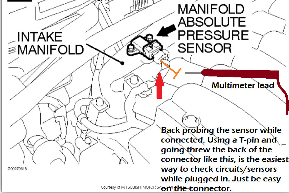

Please explain what you're meaning by back probe.

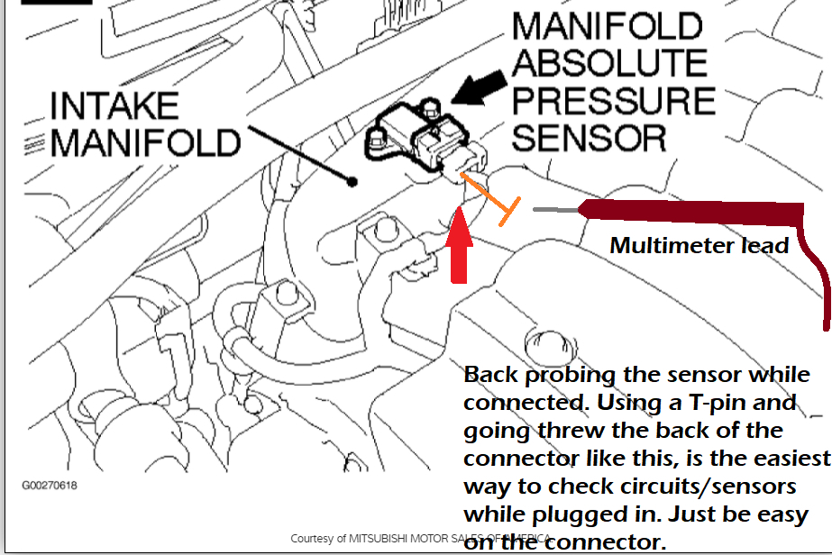

Okay, give me a couple minutes I'm going to make a diagram to show exactly how to do this, but you will need to remove the back cover off the PCM connector C3 so you have access to the wires while the connector is still plugged into the PCM.

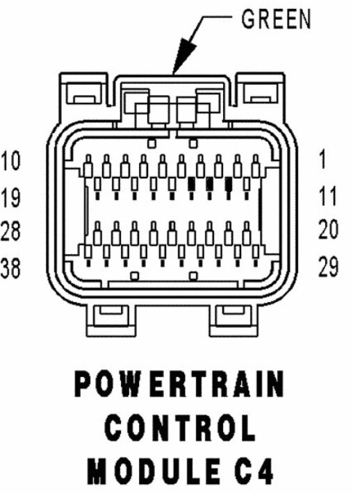

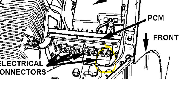

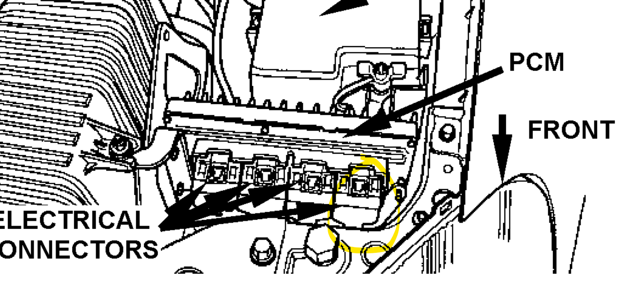

It's okay, when you're looking at the PCM, it has 4 connectors, In the 2nd diagram you're looking at the back side the connectors plugged in, when you unplug the connector from the PCM you'll see that is has a plastic cover on it, those are just clipped on, and to access the wires going into the connector you need to remove the cover, then you'll see all the wires running into it and you can plug the connector back in, and I use a T pin to slide down the wire into the connector, making sure you don't touch the T pin to anything. But that's how you get a reading at the PCM without having to pierce the wire.
The 3rd diagram I made a while ago shows how to back probe a MAP sensor connector, same idea here, except you need to remove the back PCM connector cover, Sorry for my terrible artwork. But does that make any sense? If it's easier for you, we can just try a resistance check from the PCM connector disconnected (pin 3) to the ASD relay pin 86 and see what the resistance of the circuit is.

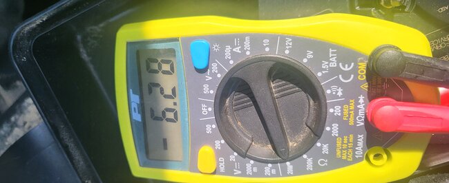

I went back and got a good connection on everyone and I missed spoke they red anywhere between 105 and 1 0 7.
Aug 17, 2023 at 1:18 AM
LONNIE CARR
  • 52 POSTS
I think I did it right this time. I used the multi meter to Test the pins where the relay plugs in to the fuse box with the key off. I get no reading at all.
Aug 17, 2023 at 1:39 AM

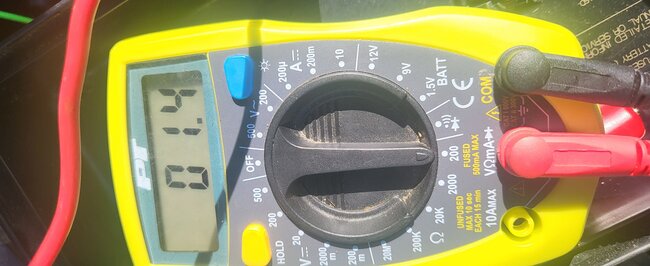

LONNIE CARR
  • 52 POSTS
I change the multimedia to 20m and I'm getting this.
