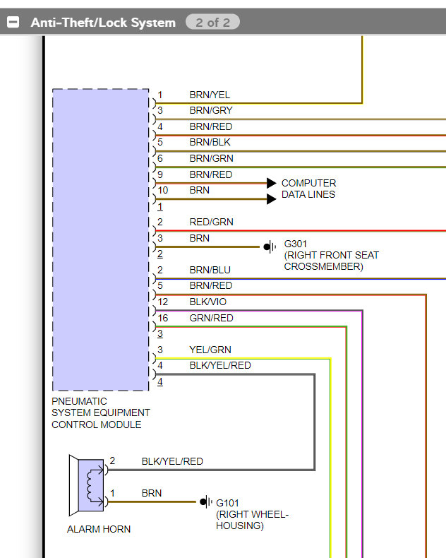

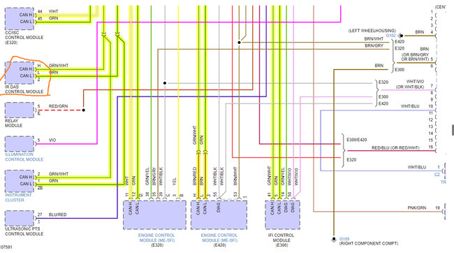

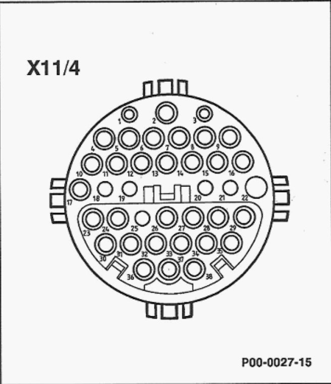

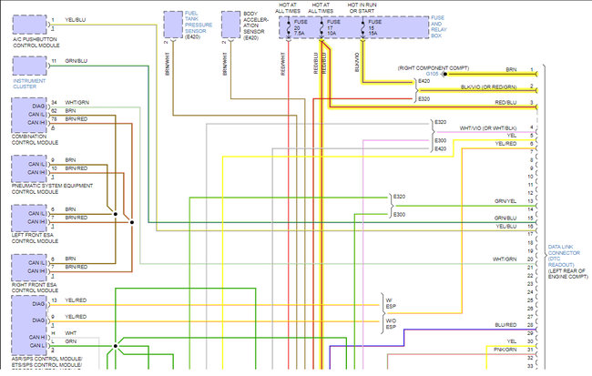

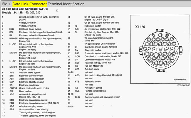

I wanted to give you these diagrams too, they are for the 38/32 Pin connector. I think you should check for power here, just to be sure you're not missing power somewhere or a fuse is blown. Trying to rule out all possibilities here. Some of these pins need to be checked with the key in the "on" position. Pin 16 on the small Data Link Connector is 12v power as well. Pin 4 is ground on that connector too, since you were able to pull a code out of the ECM, that tells us the ECM is awake, so I think you should try verifying battery power at a few locations.

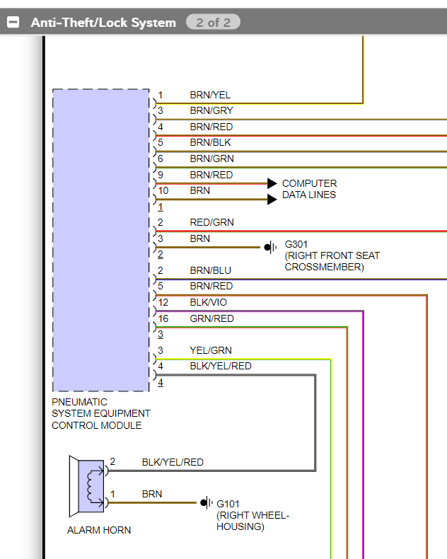

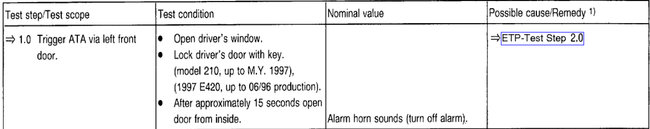

I put up another test as well. (4th diagram) It may set off the alarm, I'm not sure, but if it does, I guess you can unhook the battery to turn it off. The trigger ATA is to disable the Anti-theft and Alarm.
I'm not sure this will work considering the new key is not programmed to the vehicle. But I'm just trying to come up with anything to try before you have a mobile tech or have to tow it somewhere.

My thinking might be a little for-fetched and maybe I am wrong by saying this: Data can be stored within the ECM as stored Data or as current Data. I am wondering if when the previous tech flashes the ECM or reprogram it the data saved as current and wasn't saved as store data. By me disconnecting the battery for a few days, the current data got erased and maybe that's how all this mess started. One thing to remember German electrical engineering was never that great; you can see it in their cars and other products. They tend to over engineer, over think the process making things become complex and over price. But I will give them credit for innovation and pride in their craftsmanship. Funny enough, I did the ATA test, and the alarm went off. I had to insert the key into the ignition and turn it to position 2 to disarm the alarm. The infra-red anti-theft lock module (210 820 52 26) is offline because it was removed from the car and possible the connector is disabled; making the IR-FOB not to work which affect the red and green LED lights on the rear-view mirror from working; this could contribute to the cause of this problem. I got a used anti-theft lock module to buy so I installed it, but it also needs to be program.

If the ATA test worked, then it's just fob holding it back, because the vehicle needs the infrared and the radio frequency from the fob. its two signals from it. I think if you get the new fob and the other unit it should start, I think you're just missing the signal from that worn-out key, with the worn-out antenna. Reflashes don't lose their programming, if that was the case then every time a battery was changed out of any car it would revert back to its original programming which is now gone. When a reflash is done it overwrites the original programming, I've done a million ECM reflashes. Been through recalls for ECM programming issues and had to do tons of them every day at dealerships.

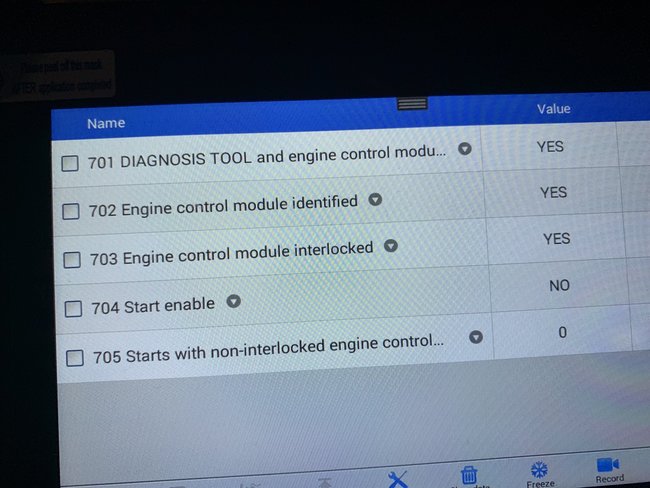

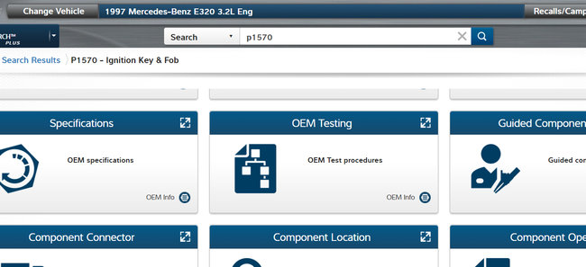

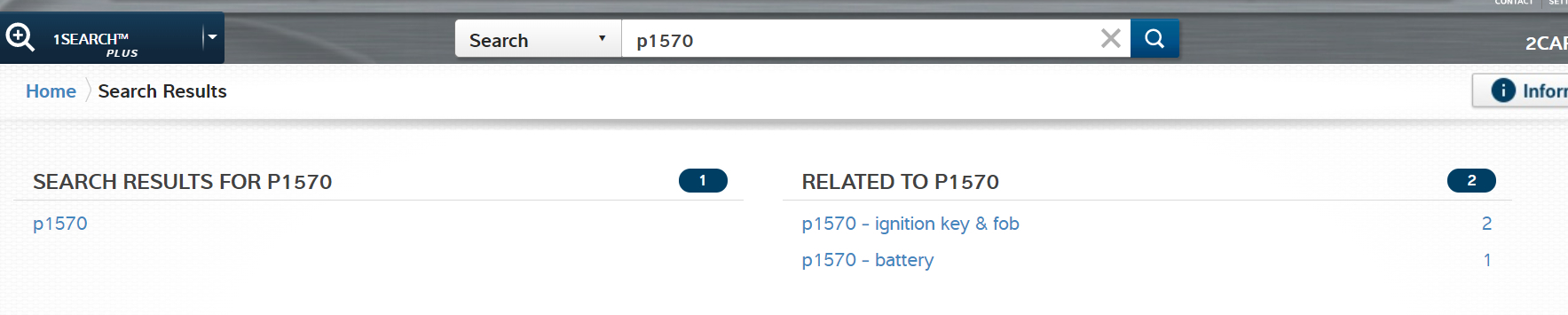

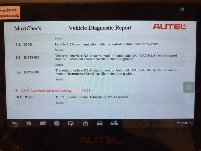

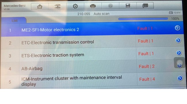

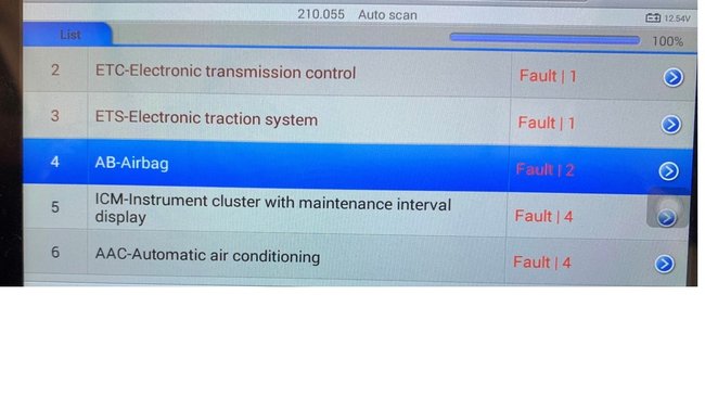

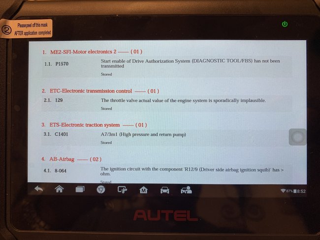

Okay, I got the 38/32 Pin connector and was able to do a full scan on the system.

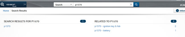

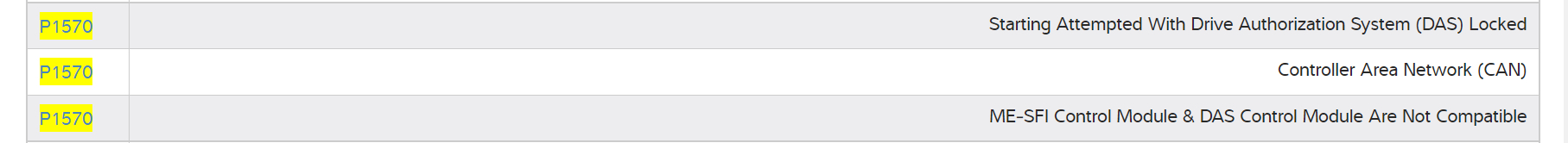

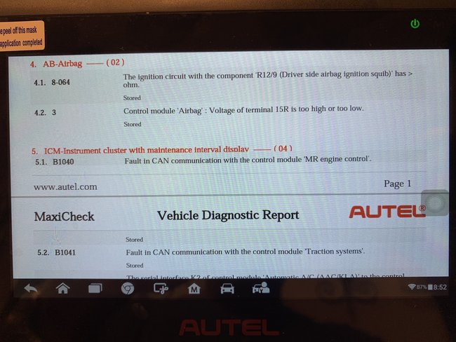

The first list fault is the ME2-SFI Motor electronics 2 with the P1570 Start enable of drive authorization system has not been transmitted. The other list of faults 2 - 6 are in the screen shots below. Each screen shots are labeled coordinately to the list number.

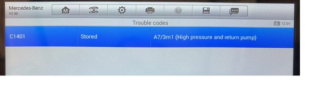

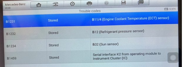

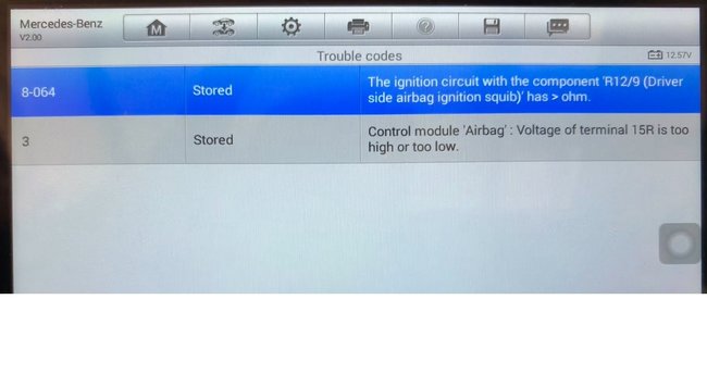

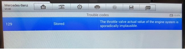

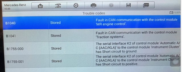

I just notice the uploaded files lost the image names, so here are the list of faults.

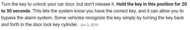

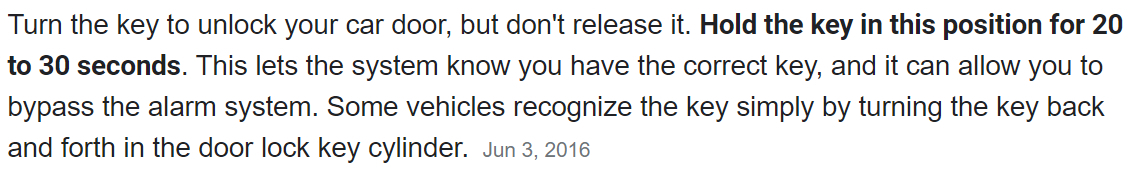

I want to know if any of the other above faults would also play a role in the crank but no start issue. I also redo the ATA test and the alarm went off; I use the key in the door lock to turn the alarm off. The key was also able to turn all 4 windows down when the key is held in the unlock position for a few seconds. The rear passenger door lock did not unlock, the knob stayed down, I had to pull it up. I will have to check if the actuator is bad.

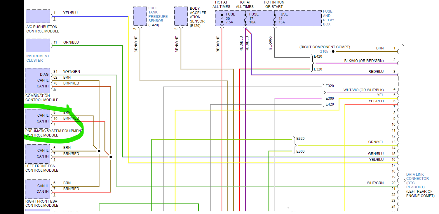

Okay, with this many codes, there has to be a communications issue on the CAN bus network. There's too many modules unable to talk to each other, I looked up the code B1040 and there is a TSB about moisture intrusion into the CANbus circuits,
Are there any bulk connectors you can take apart with the key off, and start checking connections for moisture or any green corrosion. This thing definitely has wiring issues. Or the underside of fuse/relay panels, look for any green corroded connections, relays, module connectors and pins. There's way too many codes for this to be a simple key fob fault,

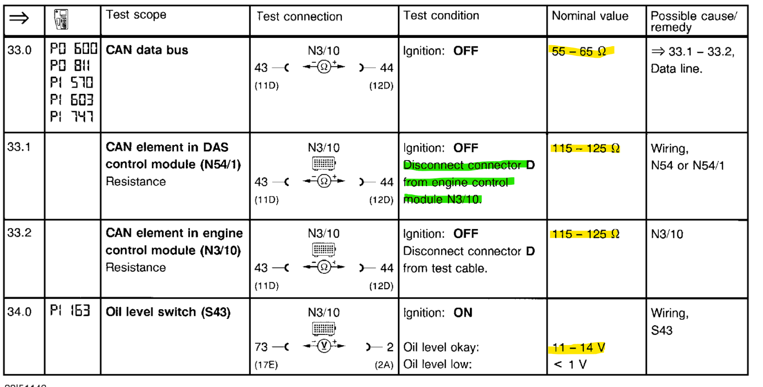

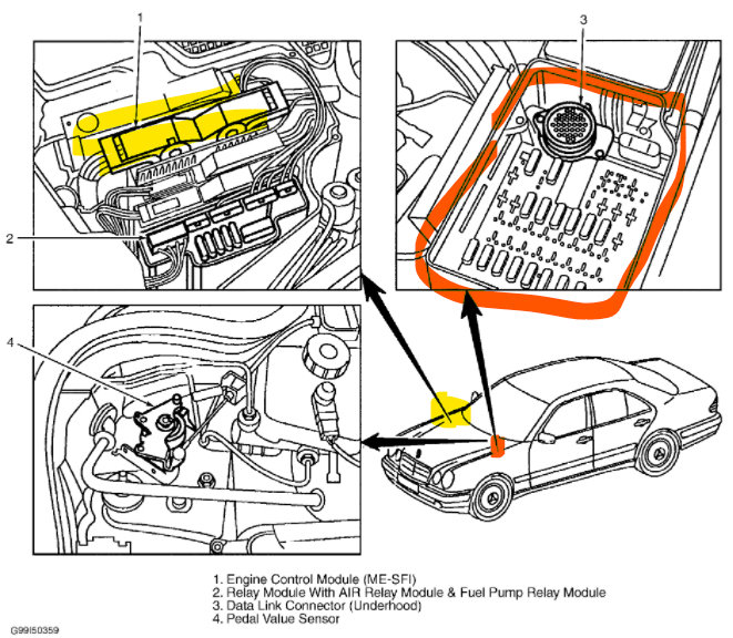

The Engine control module looks like it has four connectors A,B,C,D. The D connector has 24 pins. There's 2 wires, Pins 11 and 12. 11 is green/white stripe and 12 is just green. These two wires are the CANbus High and Low circuits. You need to see if you have any voltage on these circuits, I use an Oscilloscope to check CANbus networks, but a multimeter will have to do. The relay module is located right near the ECM, check the relays too for corrosion. Also, the fuse panel in orange, there are too many issues going on here. You have codes for everything, and there's no way all those components failed at the same time. So, there must be a bulk connector or wires that have been chewed through. Something to tie this all together. Did you unplug the ECM connector to check for issues? just make sure the key is always off. If you can back probe those two wires, I mentioned with it plugged in and Key On, you should have at least a Bias voltage of 2.5 volts. The multimeter will average out the two signals to 2.5 volts. You took pictures of all the codes, so you can also try erasing them all, and see what comes back right away, those will be hard faults happening right now.
