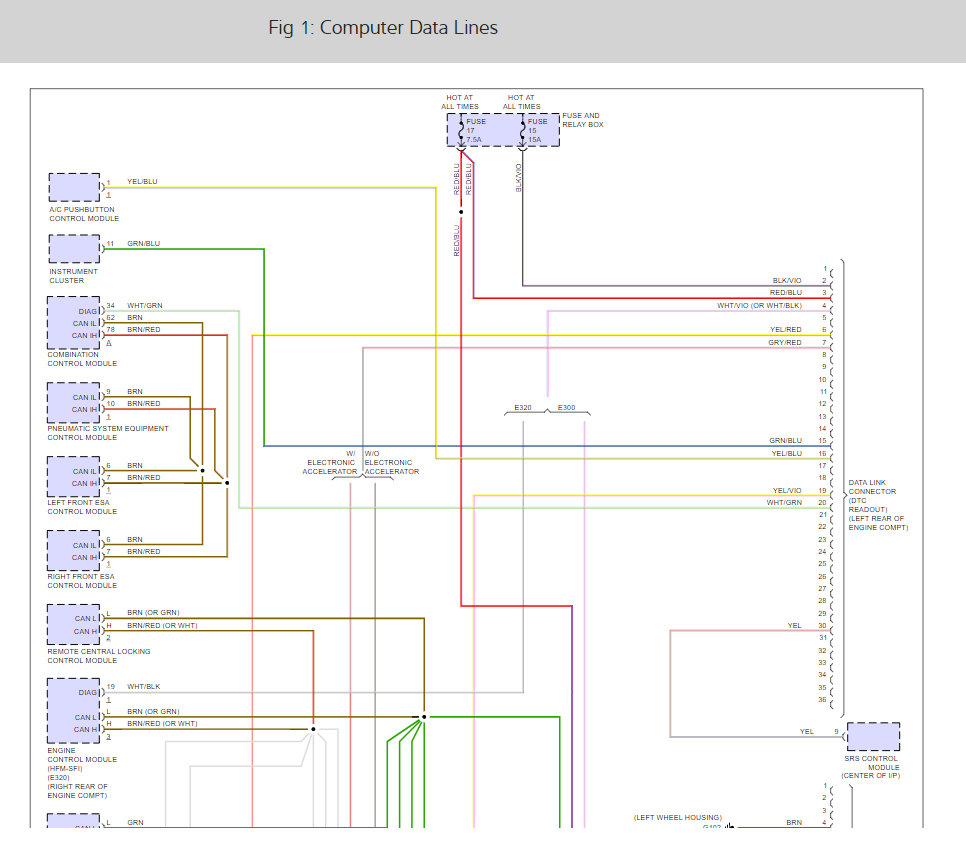

Each time I have tried scanning my vehicle for codes using the OBDII scanner, there is a message on the scanner stating that it is unable to communicate with vehicle. There are lots of issues with my car, but I am not able to correct them because of the OBDII issues. I do not want to continue to buy parts without knowing what the specific issue is. I will appreciate any advice or any help.
Aug 31, 2013 at 2:31 PM
  • 55,433 POSTS
Does the check engine light work? It should come on with the ignition key in the on position. If not please check the system fuses 17, and 15. Also check the ALDL for corrosion and clean up the terminals as needed.

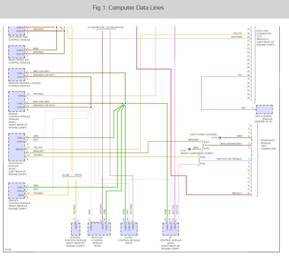

Here is a wiring diagram which pertains to most cars showing the power going to the ALDL connector.(below) If anyone reading this needs the wiring and the fuse ID to there car please send there request here.
Also, check to see if the scanner works on a different car.

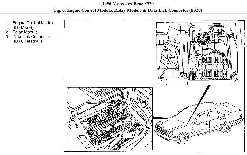

Here is a diagram for your car on where the components are located. It sounds like it could be a computer problem by itself, but more testing is needed. Also, if the check engine light itself is out it will cause this problem.

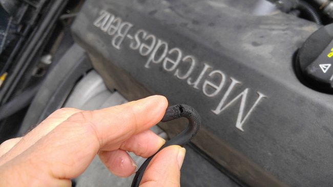

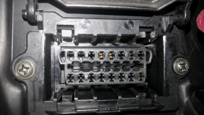

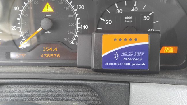

Hi, I have a 1999 E320 Mercedes, 210 chassis. It has very high miles, 436,000, but a much newer engine, it is due for its yearly safety emissions inspection. The check engine light has been on for the last six months. All was well until recently it started having extended crank times, and then the last few days it's been stalling upon cold startup but it restarts right away. So I bought a Torque Pro plug in ELM 327 OBD2 scanner for my phone, but when I plug it in there is no communication. So I went to FLAP and they plugged in their scanner, and it says no communication, just like mine. So I looked at the plug in under the dash, and only four the many holes actually have contacts. But what could the problem be? The car is a two owner before me, and is really original and untouched, nothing has been hacked in any way.
Oct 2, 2016 at 1:57 AM
  • 55,433 POSTS
Hello Corvairwild,
Do not worry about the connector not having that many pins in it most have pins missing which is normal. Try using the scan tool on other car first to see if it is working before checking the Mercedes. If it works check to see if the check engine lights works.
Please let us know what you find so it will help others.
Best, Ken
Oct 3, 2016 at 1:50 AM
CORVAIRWILD
I tried my ELM327 Bluetooth, no connection, AutoZone tried theirs, same, friend tried his, same, a friend plugged in his Snap On Solis $4,000.00 scanner, brought up EGR code. I found a dried and split vacuum hose. I replaced it and another friend with a brand new $9,700.00 Snap On scanner was also able to read my codes. A new one appeared, intake air temperature, but that was probably a not well connected plug I had just removed and replaced. He turned off the lamp, and I have not had a chance to check the intake temperature plug, and it is raining now and I will be putting the car away for the winter in a couple of days.
Oct 21, 2016 at 1:05 AM
CORVAIRWILD
I also removed the EGR Valve and it was minimally blocked with slimy residue, not a problem as it was ten percent blocked. The car occasionally stalls upon cold startup, and sometimes has extended crank time. I think that may be a weak fuel pump or bad crank sensor. Just a guess

Good find on that problem, on the older Mercedes it sounds like the more expensive scanner is the only thing that will work on some models.

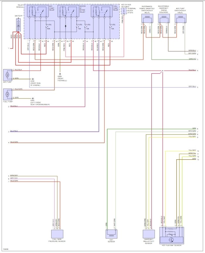

Th engine cranks, but it will not start. It is getting fire to the plugs. The fuel pump and filter are new new.
The fuel pump is not getting a ground when key is on. I wired it to the battery and it worked great. Still would not start. I can pour fuel into the intake and it runs. Getting fire to the injectors but no pulse. I had a scanner hooked up and it said no communication between it and the computer. All fuses are good. All electronics work. Just will not start. Also, it has the ring around the ignition. Not sure if that is the problem. Was told that does not shut off the fuel pump though. Any suggestions would be greatly appreciated.
Apr 26, 2017 at 3:52 AM (Merged)
  • 55,433 POSTS
It sounds like the relay module is no good please check the wiring diagram below and get back to me. also, check all system fuses.
