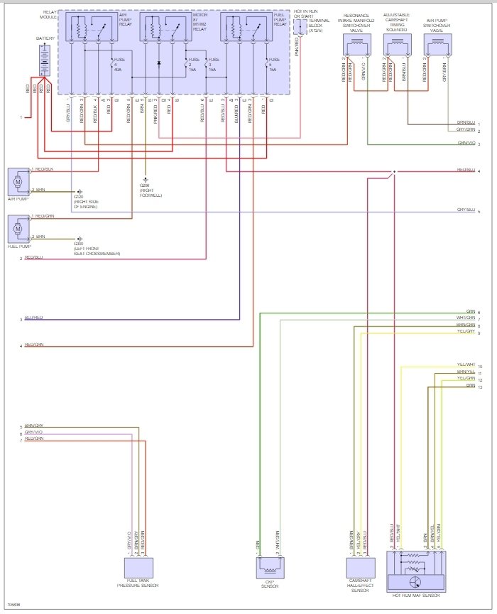

Th engine cranks, but it will not start. It is getting fire to the plugs. The fuel pump and filter are new new.
The fuel pump is not getting a ground when key is on. I wired it to the battery and it worked great. Still would not start. I can pour fuel into the intake and it runs. Getting fire to the injectors but no pulse. I had a scanner hooked up and it said no communication between it and the computer. All fuses are good. All electronics work. Just will not start. Also, it has the ring around the ignition. Not sure if that is the problem. Was told that does not shut off the fuel pump though. Any suggestions would be greatly appreciated.

It sounds like the relay module is no good please check the wiring diagram below and get back to me. Also, check all system fuses.
Let me know what you find
Best, Ken
