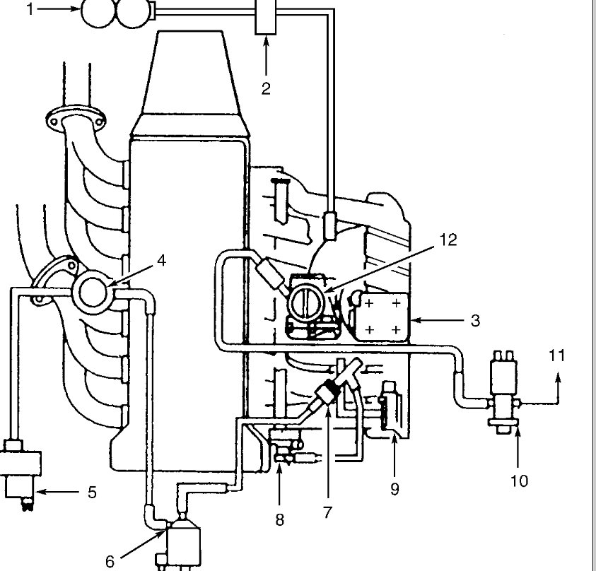

Replacing vacuum pipes as they are perishing. Must have connected up in correctly as I replaced three this morning. Car working before I started but now starts, backfires and shuts off immediately!
Jul 9, 2017 at 1:45 AM
HMAC300
  • 48,601 POSTS

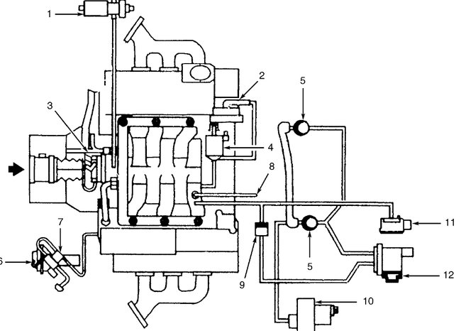

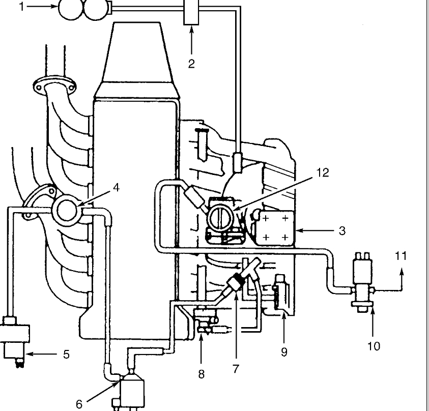

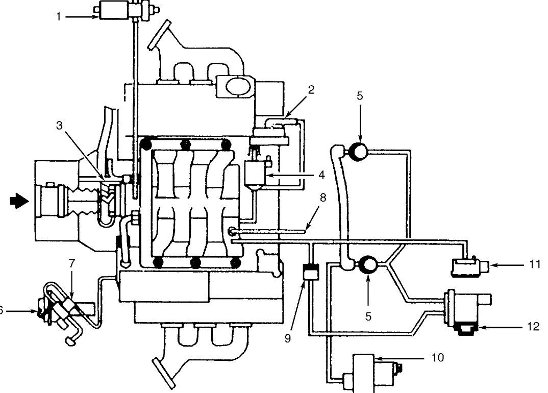

there are two 3.2L engines I have sent pictures for both. first two are for straight six.
Jul 9, 2017 at 2:43 AM
NUTHOUSE123
Many thanks. I will go to see what I did wrong. Hope I did not damage something else in the process!
Jul 9, 2017 at 3:04 AM
HMAC300
  • 48,601 POSTS
You might try scanning for codes. My fault I did not read your engine and sent one you did not need, but second one is right.
