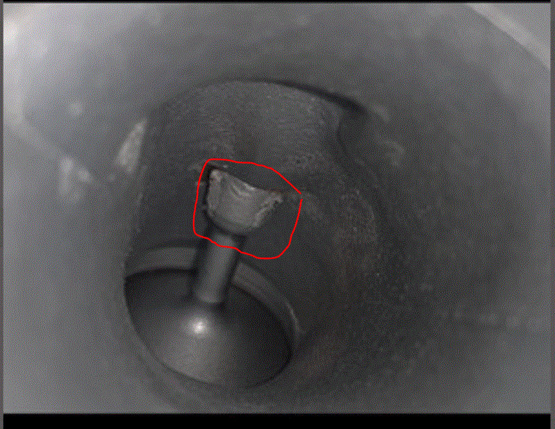

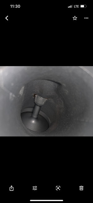

Yes, and every time I try fluid spews out of the fitting the second, I turn the car on. The noise from my head sounds like lifter tick and something else clacking. It also weirdly sounds like it’s low on oil but it’s not. I have barely driven it since the rebuild so it shouldn’t be making noise already. I sent a video of it right before I sent the pics of those codes. It’s on the previous page, I believe. Lol, thank you. It’s crazy how someone in another state is trying so hard to help me when I can’t even get someone close by to answer a phone call. You said you’re 3,000 miles away, yet you’ve have helped me so much already when I can't even get someone on my street to hold a wrench on the tensioner while I put the belt on, lol. I am going to upload a picture of something that looked strange to me when I got my heads back. Maybe it is what's causing the noise. The rest of them looked normal, but this one looked weird. I showed the machine shop and they said it was fine, but I’ve learned I can’t trust anyone to take responsibility for their mistakes so I’m not sure if they were telling the truth or not.

I found the video. It sounds louder on the driver's side but not bad. I do hear a tick. As far as the pic above, what is hanging down at the top of the valve? Were any of the others like that as well? I wouldn't think that is a valve guide. Is that cylinder head on the driver's side?
It's hard for me to tell for sure. Do you remember if it was metal?
As far as no one is willing to help, that is really depressing to hear. I think you live in the wrong place. LOL, I'm near Pittsburgh. People are almost always ready to help others. Well, most are. Things seem to be changing though. I really worry about the state of the world and our country at this time. And as far as wanting to help, it's because you are willing to do it. Not many people have your work ethic anymore and willingness to try. Respect that.
Let me know about what I circled in the pic below. Is that what you are referring to?
Let me know and take care. I hope you are relaxing tonight.

No that was the only one like that. I don’t remember which side it was, and I don’t know what it is. They said it was just paint. I’m not sure but maybe I can find a better picture. And yes, I’m for sure in the wrong place or perhaps just haven’t met the right people. And no relaxing for me. Where I live, I trade rent for fixing the place up, so I always have to work on the house when I’m not working on the car. I Just finished adding bricks and a concrete walkway to the front porch now I’m working on adding footers to the wooden posts. Just used my car jack as a post jack, lol.
I don’t see a picture with your response so I’m not sure what you circled, lol.
Friday, April 29th, 2022 AT 8:01 PM
  • 109,901 POSTS
I forgot to add the pic. Ugh!
Let me know if that is what you were referring to. As far as the masonry work is concerned, you do it all. My father was a stonemason. He taught me before he passed, so when I built my house, I dug over 100 tons of stone from the ridges, loaded the truck, cleaned it, and then put it on the house. Like you, I have to do a lot of things myself. I built the house myself. I'm a lot like you. I think that's why I want to help so much.

Yes, that’s it.

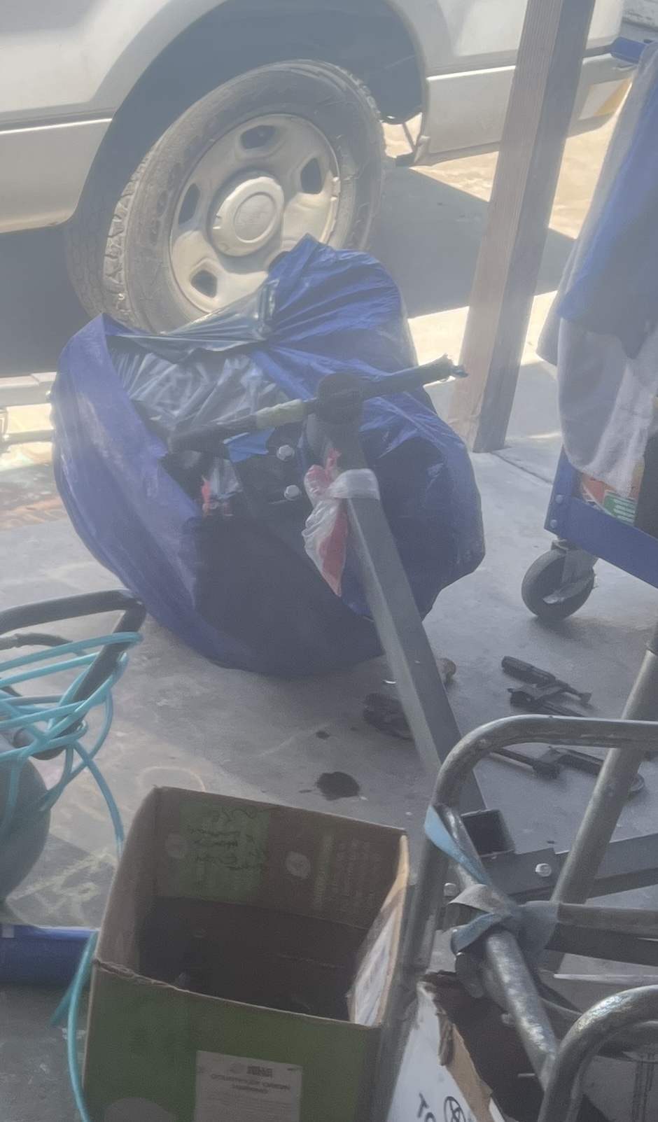

Once again, all for nothing. My engine just stands just broke and my engine fell to the concrete floor. I’m pretty sure it’s done. Coolant and oil coming out of it and everything. Things keep going wrong and I keep getting knocked down only to get right back up, but I think I will stay down this time. Thanks for the help, Joe.

First, nothing can keep you down. Where are the leaks coming from? How far did it fall? If it was on an engine stand, I suspect the front of the engine fell first.

I emailed you a couple of times, but never heard back. It's leaking from the heads. I don’t know where else it’s leaking from because honestly, I haven’t even picked it up. I can’t bring myself to look at it, so I haven’t been back to where it fell since it happened earlier today. So, it’s still sitting where it fell.

When you have a chance, check where the leaks are coming from. I will watch for your reply.
