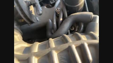

The shop that honed my block also rebuilt my heads. My car has barely been driven since the rebuild. Am I wrong or should I not be hearing lifter tick and valves clacking? Can you hear it? There’s another noise almost like I’m low on oil but I’m not. Also, I never did figure out that hose at the end of the video lol. The machine shop told me to just use thicker oil, but I shouldn’t have to if I paid them a bunch of money to rebuild my heads right?

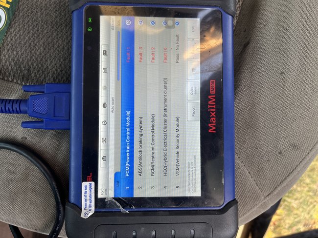

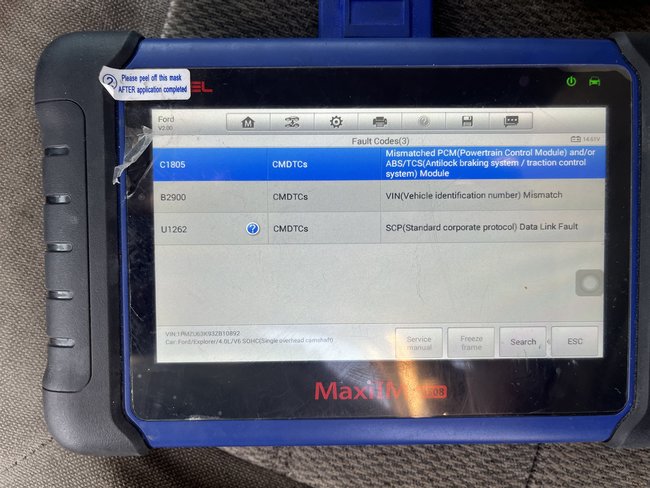

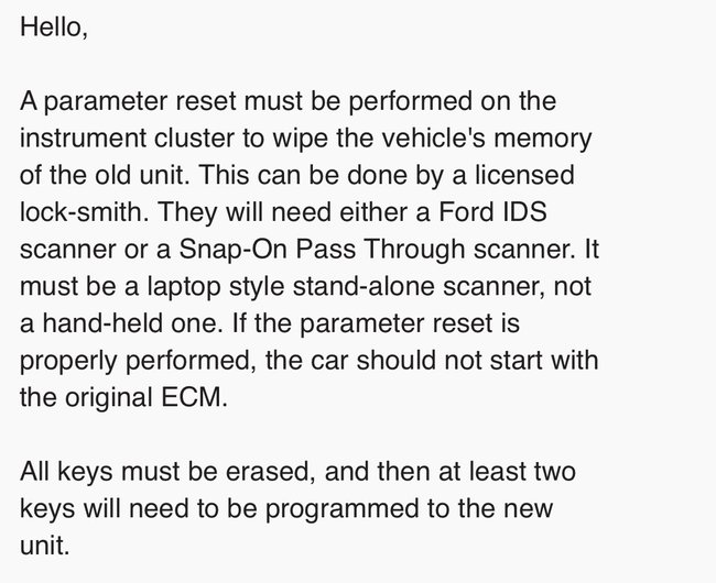

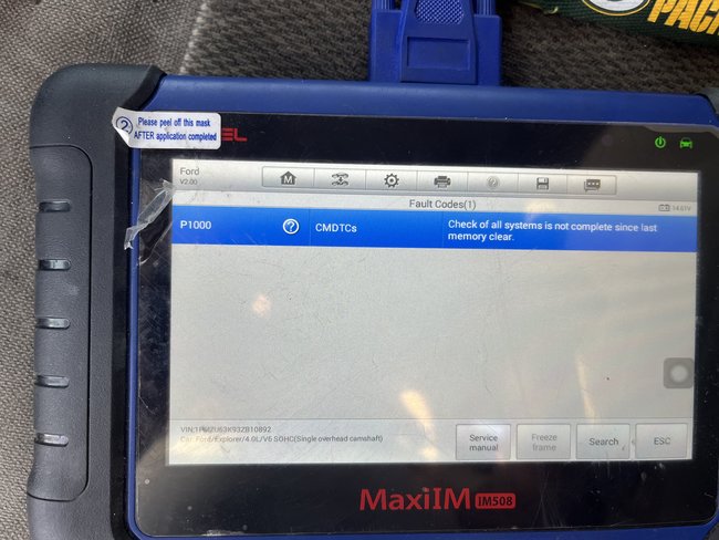

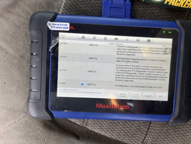

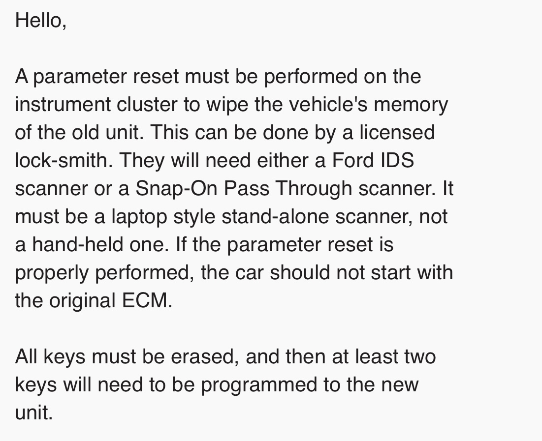

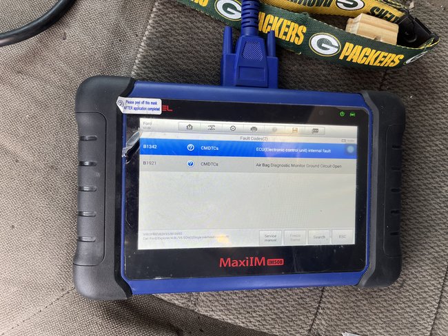

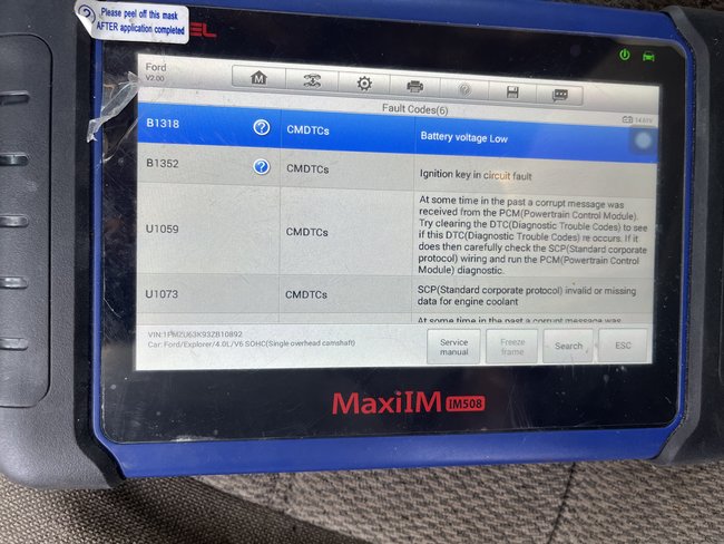

Also, these are the codes popping up now. I will also show the message from the place that sold me the PCM. I accidentally clicked the same picture a couple of times, but it won’t let me erase it, lol, sorry.
Monday, April 25th, 2022 AT 7:13 AM
  • 109,901 POSTS
Ariana,
I read through the codes. I'm not seeing anything specific to the transmission or valve body. Ugh! These guys are driving me crazy. LOL
I am waiting for a reply from Ken. As soon as he gets in touch, I will let you know.
Take care and I hope all is well.
Monday, April 25th, 2022 AT 6:02 PM

I fixed it! Well, I didn’t. Although I don’t understand because the problem was the fluid. I have the Ford attachment for the transmission fill or drain plug and I pumped fluid until it came back out and waited for it to be a steady stream but apparently it was low. They said something about having to put it up on a lift and putting it in drive then park so that it fills the torque converter also. Weird. But it runs now with no issues. Well, no transmission related issues. Now I’m having issues with shuddering when I accelerate but it’s probably because of my rear CV joint boot. I don’t know why but it’s spitting grease all over the place. Not sure if I need a new one. If it’s not one thing it’s the other. Also, a little confused because on two different Autel scanners I’m getting different results. The pics I sent are from one and another one has no codes pop up. Not sure what to think about that.
