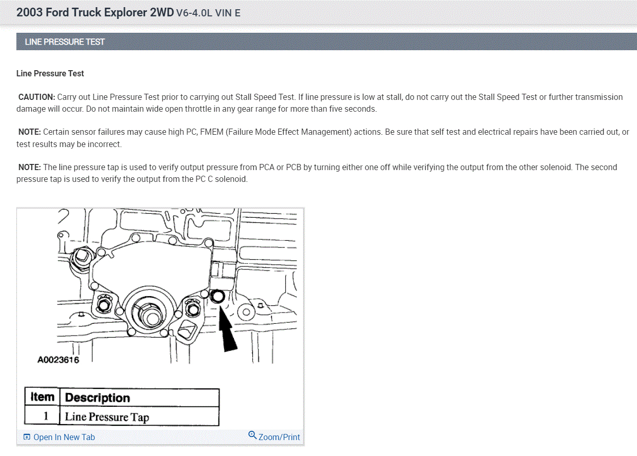

If it is a line pressure issue what would cause that? The guy reversing the polarities. The transmission shop messing up during the overhaul. Me switching the cooler. I called them and they said my warranty is voided because of the stuff I did to the engine which doesn’t make any sense to me. And my valves are clacking very loud, so I also called the shop that rebuilt my heads and they said there’s no warranty, so I asked for a receipt, and they said there’s no receipt because they didn’t charge me taxes because they were trying to “help me out” price wise. I swear I’m never letting anyone touch my car again. Every shop I’ve been to is full of crooked people who only care about money. This is insane. I am just going to have to get a bus pass or something and save up to get a transmission overhaul kit and an engine overhaul kit and start over but do it 100% by myself this time instead of having a shop build my heads and hone my block and having a shop rebuild my transmission. I will do it all by myself this time. It’ll probably take me another year and a lot more money. Crazy my car isn’t even worth $2,000.00 online and I’ve already put more than that in for everything I’ve done to it.

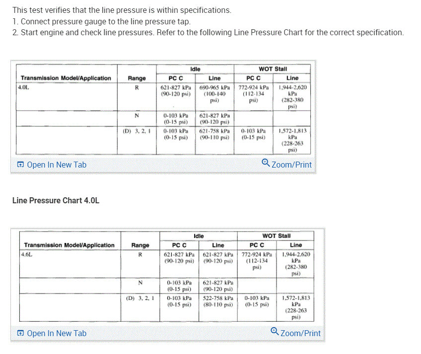

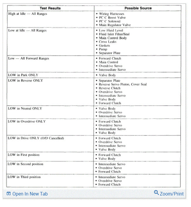

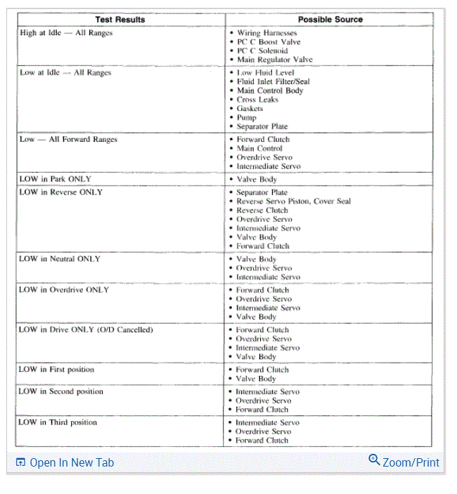

As far as line pressure, there is a line pressure solenoid (pressure regulating solenoid.) I may be wrong, but I feel that is where the issue is coming from. Were you able to perform the pressure testing?
If you want to see what the part looks like, the OEM part number is XL2Z7G383AA.
And no, I don't feel this was caused by you. Also, the valve noise doesn't make sense. Can you record it and upload it for me to hear? The valve lash is controlled by oil pressure. Are you having issues with pressure?

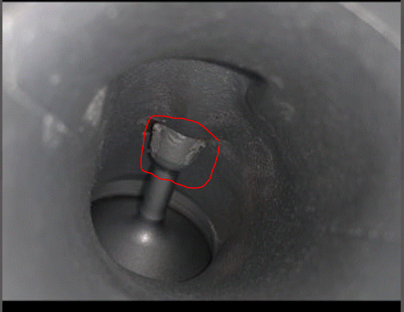

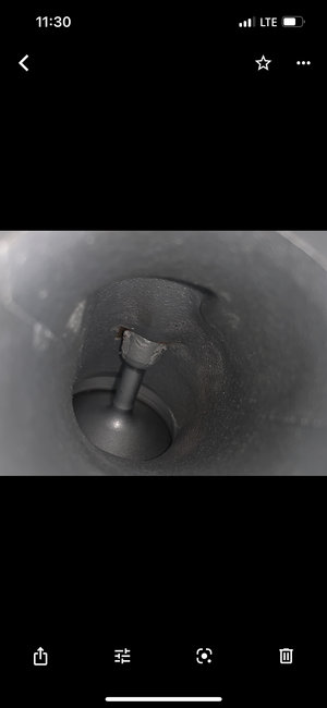

Yes, and every time I try fluid spews out of the fitting the second, I turn the car on. The noise from my head sounds like lifter tick and something else clacking. It also weirdly sounds like it’s low on oil but it’s not. I have barely driven it since the rebuild so it shouldn’t be making noise already. I sent a video of it right before I sent the pics of those codes. It’s on the previous page, I believe. Lol, thank you. It’s crazy how someone in another state is trying so hard to help me when I can’t even get someone close by to answer a phone call. You said you’re 3,000 miles away, yet you’ve have helped me so much already when I can't even get someone on my street to hold a wrench on the tensioner while I put the belt on, lol. I am going to upload a picture of something that looked strange to me when I got my heads back. Maybe it is what's causing the noise. The rest of them looked normal, but this one looked weird. I showed the machine shop and they said it was fine, but I’ve learned I can’t trust anyone to take responsibility for their mistakes so I’m not sure if they were telling the truth or not.

I found the video. It sounds louder on the driver's side but not bad. I do hear a tick. As far as the pic above, what is hanging down at the top of the valve? Were any of the others like that as well? I wouldn't think that is a valve guide. Is that cylinder head on the driver's side?
It's hard for me to tell for sure. Do you remember if it was metal?

Let me know about what I circled in the pic below. Is that what you are referring to?

No that was the only one like that. I don’t remember which side it was, and I don’t know what it is. They said it was just paint. I’m not sure but maybe i can find a better picture. And yes, I’m for sure in the wrong place or perhaps just haven’t met the right people. And no relaxing for me. Where I live, I trade rent for fixing the place up, so I always have to work on the house when I’m not working on the car. I Just finished adding bricks and a concrete walkway to the front porch now I’m working on adding footers to the wooden posts. Just used my car jack as a post jack, lol.

I forgot to add the pic. Ugh!
Let me know if that is what you were referring to. As far as the masonry work is concerned, you do it all. My father was a stonemason. He taught me before he passed, so when I built my house, I dug over 100 tons of stone from the ridges, loaded the truck, cleaned it, and then put it on the house. Like you, I have to do a lot of things myself. I built the house myself. I'm a lot like you. I think that's why I want to help so much.

Yes, that’s it.

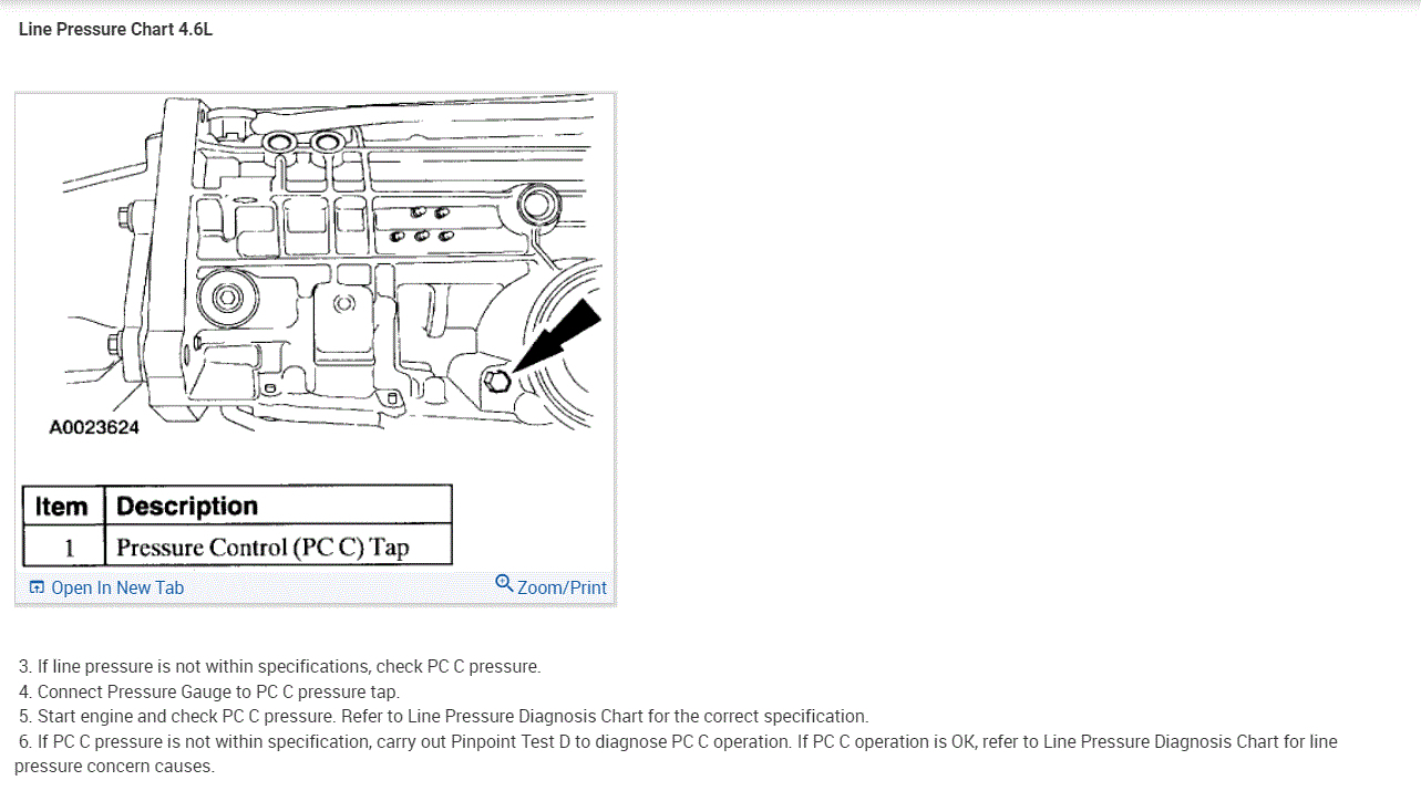

What should I do about the line pressure test? It just leaks out the second the car starts so I haven’t even been able to do it.

I hope you are enjoying your Saturday and are not working. LOL As far as the line pressure test, I'm questioning if there is an O-ring or something missing on the connector. Does it fit tightly? Did you rent the tester? If you did, inspect it to make sure someone didn't damage it before you got it.

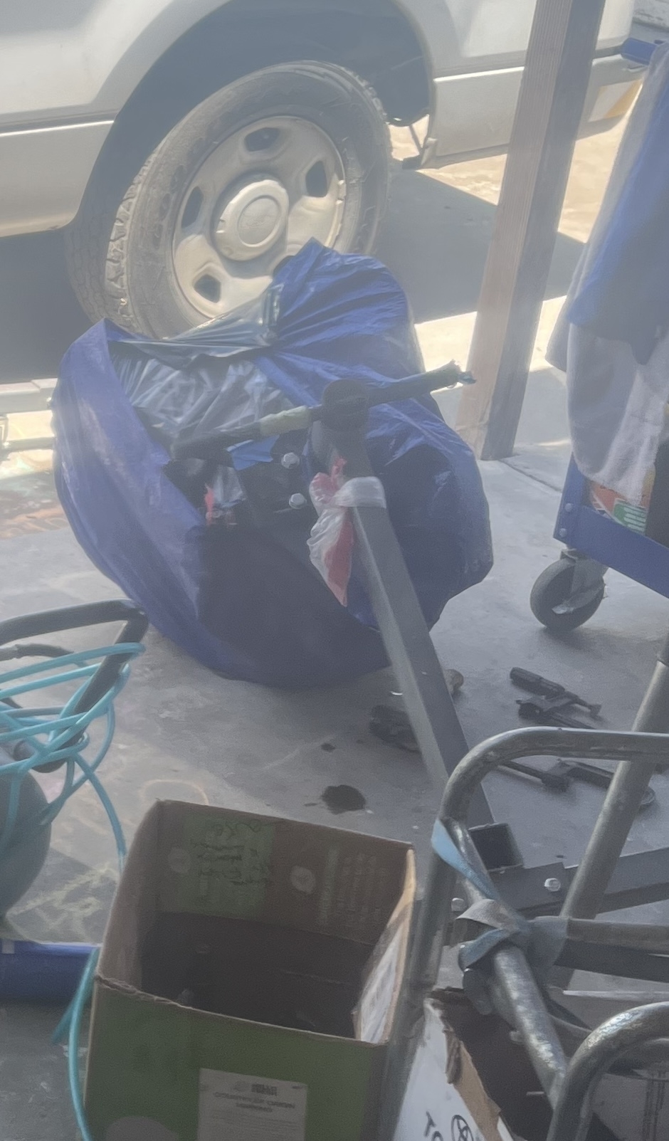

Once again, all for nothing. My engine just stands just broke and my engine fell to the concrete floor. I’m pretty sure it’s done. Coolant and oil coming out of it and everything. Things keep going wrong and I keep getting knocked down only to get right back up, but I think I will stay down this time. Thanks for the help, Joe.

First, nothing can keep you down. Where are the leaks coming from? How far did it fall? If it was on an engine stand, I suspect the front of the engine fell first.

I emailed you a couple of times, but never heard back. It's leaking from the heads. I don’t know where else it’s leaking from because honestly, I haven’t even picked it up. I can’t bring myself to look at it, so I haven’t been back to where it fell since it happened earlier today. So, it’s still sitting where it fell.

When you have a chance, check where the leaks are coming from. I will watch for your reply.
