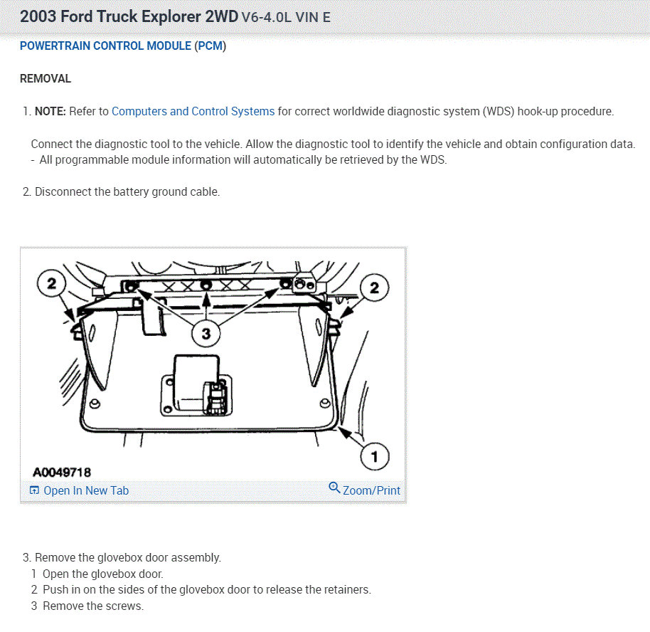

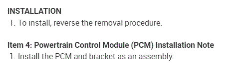

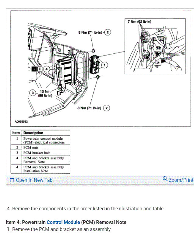

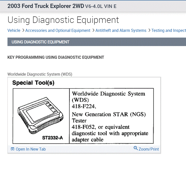

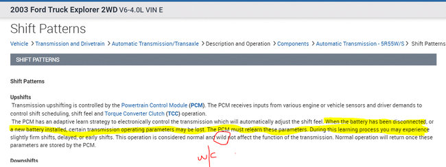

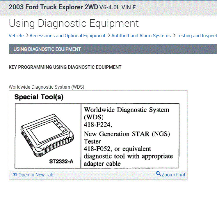

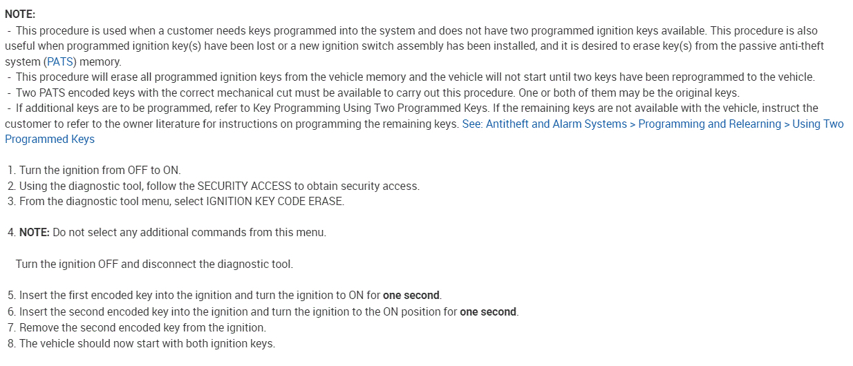

If you look at the attachment below, it provides the programming procedure. This will erase the presently programmed keys. Please read through the description note.
Beach town? Must be nice. You are living my dream. Today, (and I'm not making this up) we had sun, rain, hail, snow, and then back to rain. Ugh!
Apr 9, 2022 at 2:35 PM
ARIANADANIELLE5345
  • 402 POSTS
Thank you, I’m going to try it right now. I’ll let you know how it goes. And I guess the grass is always greener on the other side because I’d love to see snow or rain right now, but I’ve only seen snow like twice, lol. I’ve never been where it’s actually snowing, I’ve just seen snow on the ground, lol.
Apr 9, 2022 at 11:50 PM
ARIANADANIELLE5345
  • 402 POSTS
It’s the same procedure even though mine is a vin k and the picture says vin e, right? Sorry I know i asked this already about one of your previous posts, but I just want to make sure that the same rule applies.
Apr 10, 2022 at 5:15 AM
  • 110,251 POSTS
I just double-checked to make sure there were no differences, and they are the same. The VIN code K indicates it is a flex-fuel vehicle. Other than that, there are no differences.

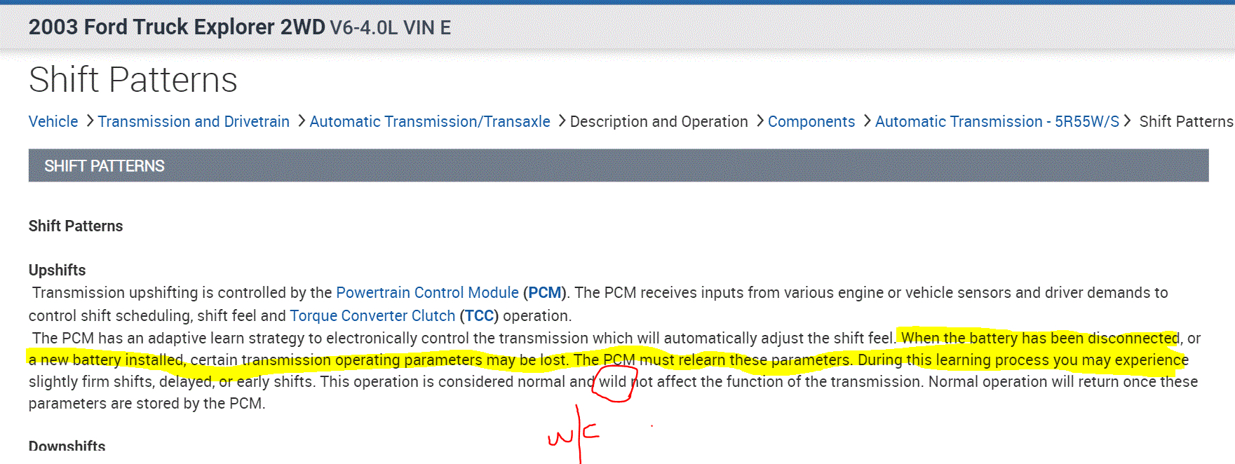

The relearn procedure is done while driving and really isn't something you program. Take a look below at the attached pic. I highlighted the area to read. I circled a word choice error on the manual's behalf. LOL
Sorry, in addition to being a mechanic for 30 years, I'm also a schoolteacher. I bet you have never heard of such a thing.
Let me know your thoughts.
See pic below.

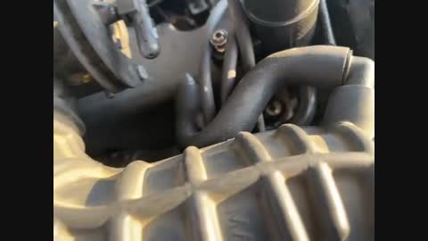

Here is a video of what’s happening.
Apr 20, 2022 at 12:59 PM
  • 110,251 POSTS
Ariana,
That seems like a line pressure-related issue. I now understand what you meant by a neutral drop. LOL

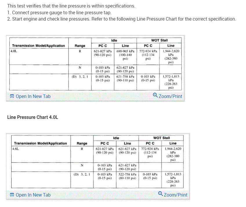

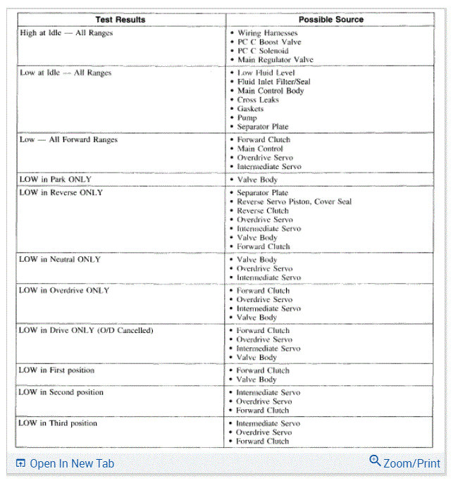

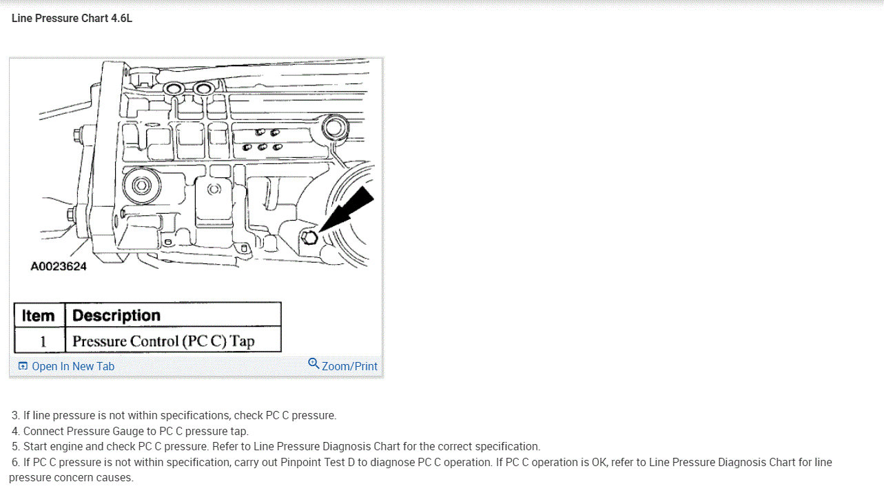

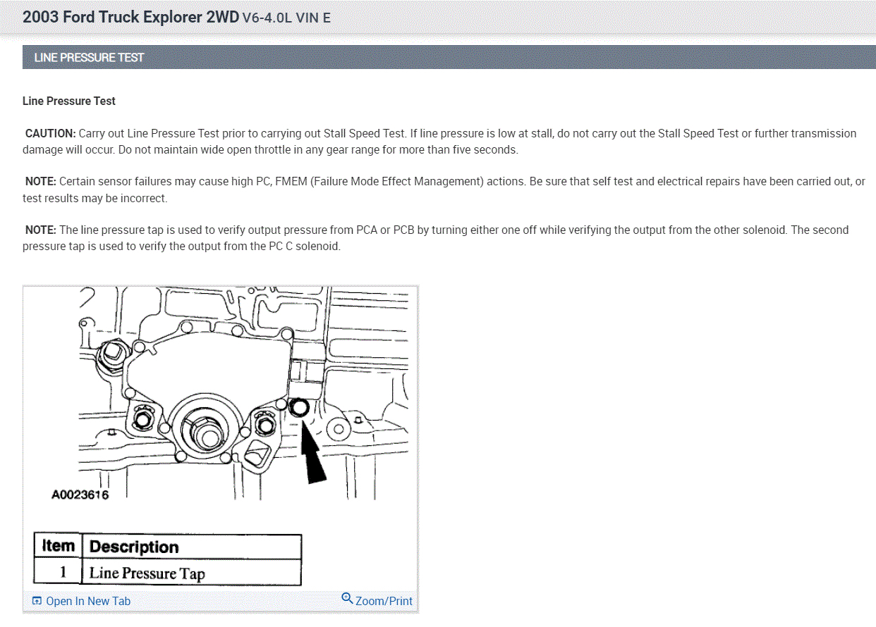

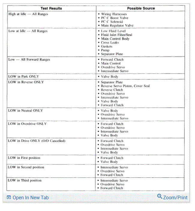

I feel bad suggesting this, but we need to determine if the line pressure is low in the transmission. That is what it is acting like.
There are three pressure control (PC) solenoids located in the solenoid body assembly used to control line pressure, band and clutch application pressure within the transmission. If one was damaged and is causing low pressure, the engine needs to rev before enough pressure is produced to engage the gear.
I feel so bad recommending another test. But I attached how to test line pressure. Ariana, let me know your thoughts. If I didn't live 3,000 miles away, I would come and help. This has been a total nightmare for you.

Don’t feel bad, please. Of all the people I’ve asked including Ford, Aamco transmissions, and mobile mechanics you are the very first person to have any sort of idea of what’s going on. Everyone else says, “I’ve never seen that before. I don’t know what to tell you. That’s a hard one.” So, no matter how many tests I have to perform, please don’t feel bad. Thank you so much! I’ll do it in the daylight tomorrow and I’ll let you know. Also, my transmission fluid is light pink, and I read that that means coolant is getting in there but I only touched an external cooler so I don’t know how that could happen. It was sort of bubbly so maybe I overfilled it. What do you think? Tomorrow I can send a picture of what the fluid looks like.

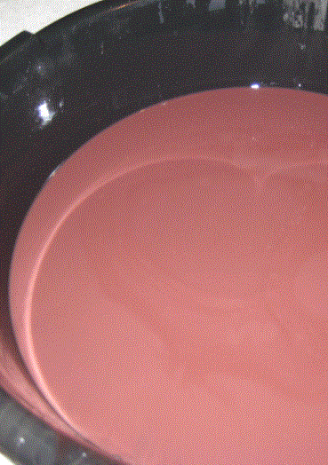

As far as the transmission fluid color, does it look like the pic below? Is there any evidence of fluid in the coolant reservoir or radiator?
Apr 21, 2022 at 9:03 AM
ARIANADANIELLE5345
  • 402 POSTS

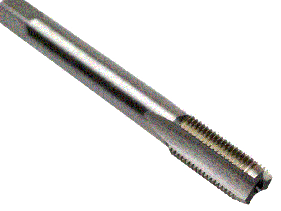

What does the tool look like that I need for the tap? And no coolant is fine. I changed the cooler but it’s external, so I don’t think I could’ve gotten coolant in there. I’ll send a pic of the fluid. One sec.
Apr 21, 2022 at 12:45 PM
ARIANADANIELLE5345
  • 402 POSTS
I guess it only turned pink when the car is on because I just tried to take a little bit out and its normal red.
Apr 21, 2022 at 12:50 PM
  • 110,251 POSTS
That's good news. Coolant will usually take out bearings and other things in the transmission.
You asked about a tool, a tap. Are you rethreading something? I attached a general picture of a tap below. Let me know if that is what you needed.

No, I meant for the line pressure test it says something about a line pressure tap and pressure control tap.
Apr 21, 2022 at 2:06 PM
  • 110,251 POSTS
LOL, sorry.
When they say tap, it just indicates a place to attach the gauge. It's been a while, but if I remember correctly, the gauge should simply screw into the tap.

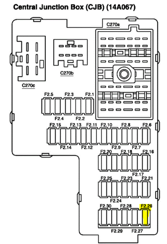

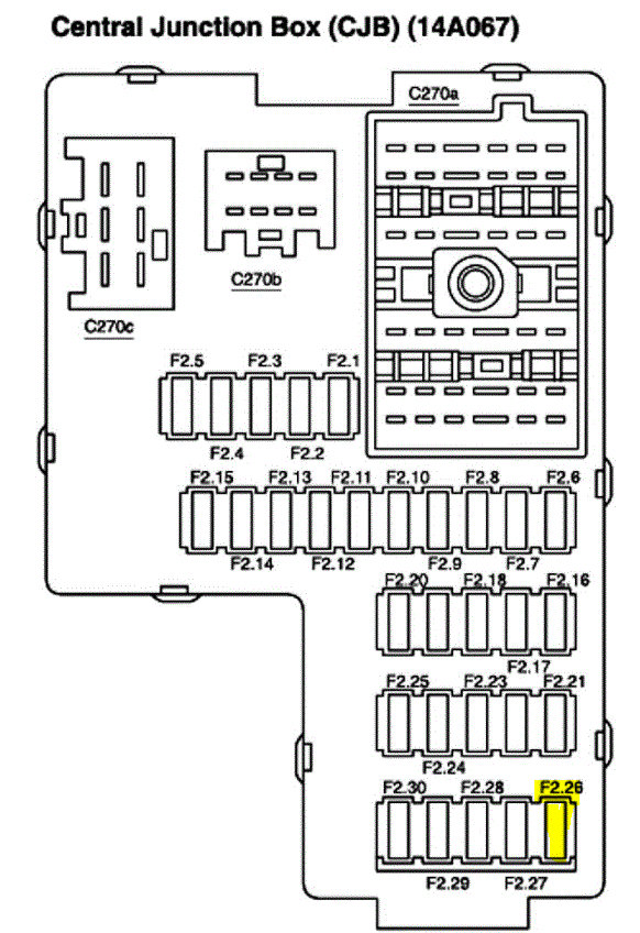

Since my PCM was fried, should I check the sensors first because the picture you sent said bad sensors can cause the problem. If he fried the PCM, there could be more that he fried too, right?

Anything is possible. One would hope the fuse would fail first, but it doesn't always happen. I'm not sure what they mean by a hard kickback when placing it in gear. The idea that you have to rev the engine tells me either it's low on fluid (which I know it's not) or the pressure is low. I have seen in the past where there is a delayed engagement due to valve body issues. But in your video, it doesn't engage until you rev the engine.

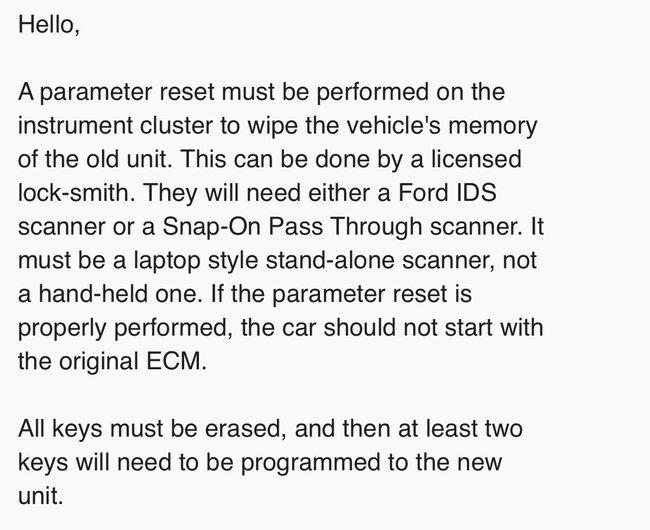

The shop that honed my block also rebuilt my heads. My car has barely been driven since the rebuild. Am I wrong or should I not be hearing lifter tick and valves clacking? Can you hear it? There’s another noise almost like I’m low on oil but I’m not. Also, I never did figure out that hose at the end of the video lol. The machine shop told me to just use thicker oil, but I shouldn’t have to if I paid them a bunch of money to rebuild my heads right?

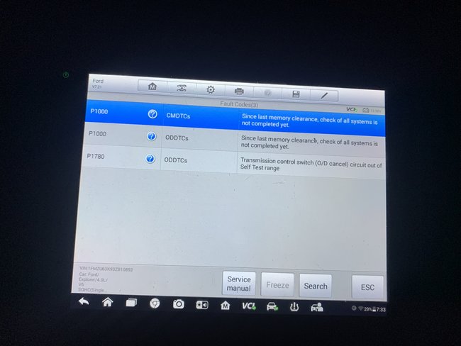

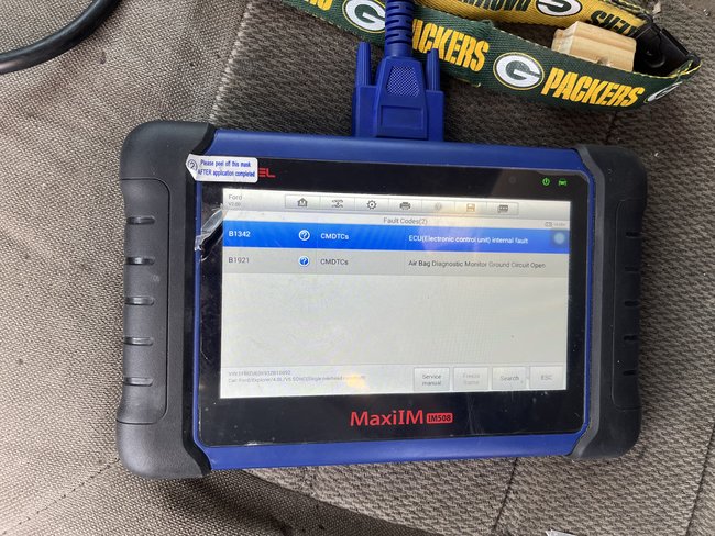

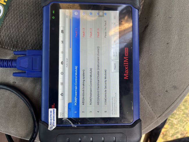

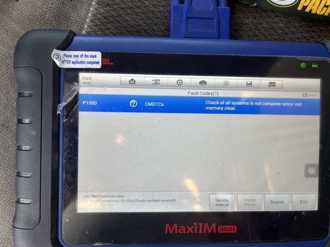

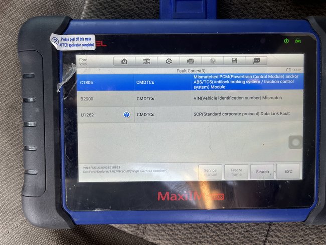

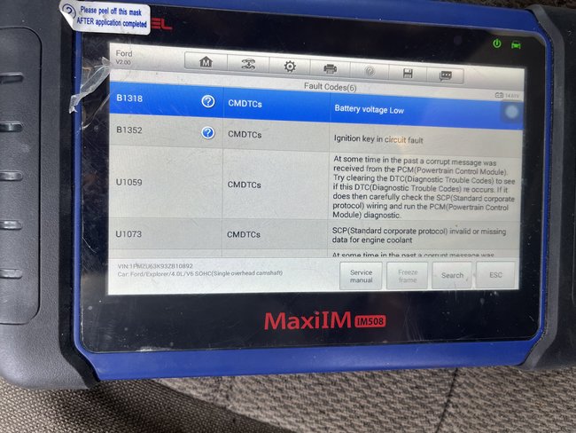

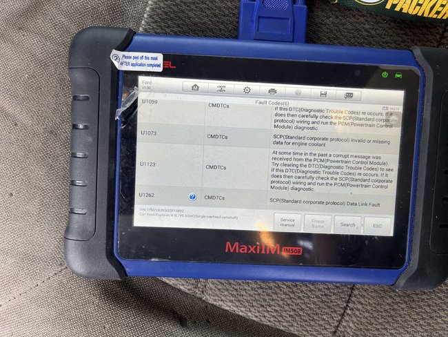

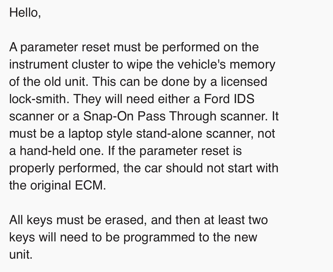

Also, these are the codes popping up now. I will also show the message from the place that sold me the PCM. I accidentally clicked the same picture a couple of times, but it won’t let me erase it, lol, sorry.
Apr 25, 2022 at 12:13 AM
  • 110,251 POSTS
Ariana,
I read through the codes. I'm not seeing anything specific to the transmission or valve body. Ugh!!! These guys are driving me crazy. LOL
I am waiting for a reply from Ken. As soon as he gets in touch, I will let you know.

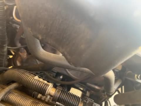

Could this be happening if I had connected up the external trans oil cooler lines backwards?
Apr 27, 2022 at 4:24 AM
  • 110,251 POSTS
Was it the original cooler? Is it an auxiliary cooler or is it integral with the radiator? If you switched them and it was an original part, it would have backflushed dirt that was built up and causing a flow restriction. It's just a theory.

I’m not sure if it was the original and yes, it’s an auxiliary cooler that doesn’t go through the radiator.
