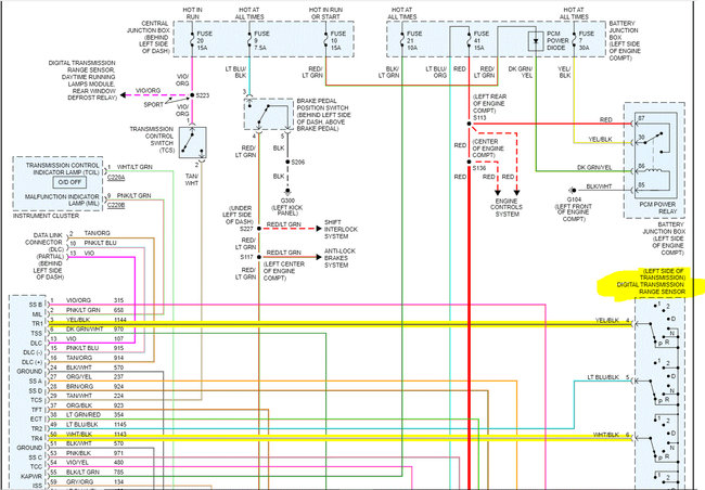

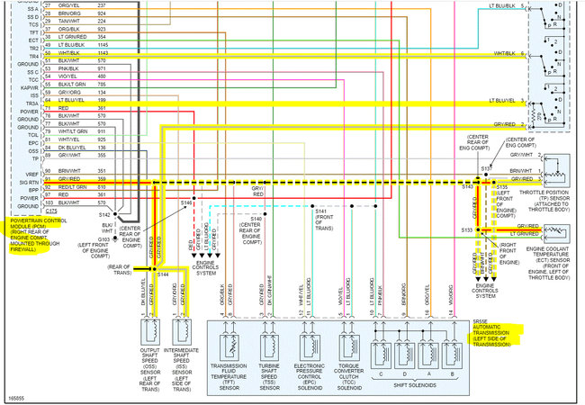

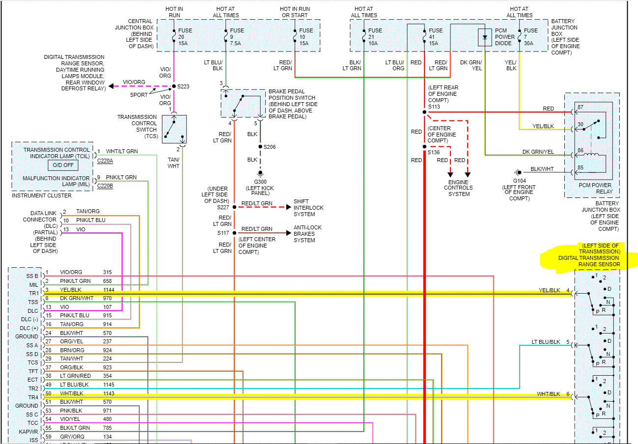

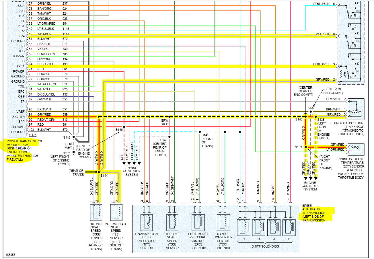

Ariana, when you shift through the gears either with the key on only or with it running, does the gear selector indicate the correct gear? There is a transmission range sensor that determines what gear the vehicle should be in. That could be bad. Note that the range sensor signals the powertrain control module for gear selection. From there, the PCM communicates with the transmission control modules, sensors, and so on.
Let me know if you noticed any changes with the indicator. Also, I attached the wiring schematic below for your review. I highlighted all wires from the range sensor for you.
Let me know your thoughts or if you have other questions. If the gear indicator isn't working or is off, I suspect the range sensor was damaged. If it is working properly, I suspect the PCM was damaged.
See pics below. Note: I had to cut the schematic in half to make it readable for you. I did overlap them so you can follow from one to the next.

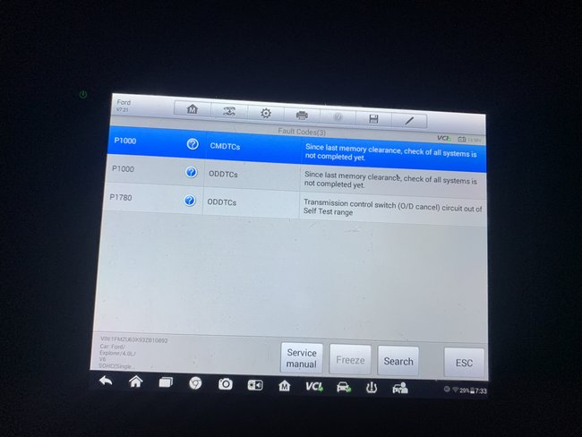

Okay. so, what’s happening is the delay in shifting is because for some reason my trans is having trouble building pressure but once it does it engages, and everything is fine. If I go to switch gears again the pressure reads at 0 when my car should be moving, then all of a sudden it has pressure and boom the car moves. It sounds like a seal or something inside the transmission is worn but they are all brand new because my torque converter was rebuilt right before I did my engine rebuild. None of this happened until the guy switched the cables. So, I’m not sure what to do. This is what I got on the reader.
Mar 22, 2022 at 1:59 AM
ARIANADANIELLE5345
  • 402 POSTS
And on another reader, it said something about can’t control speed. Also, I know my overdrive doesn’t work.
Mar 22, 2022 at 2:01 AM
  • 110,244 POSTS
The P1000 simply indicates symptom readiness test isn't complete. Basically, it tells you the system has not completed testing all components in preparation for an emissions inspection.
The P1780 is a different issue. That is specific to the transmission. When it won't move or the pressure is at 0 PSI, pay attention to the gear indicator light. See if it stays on or if it turns off.

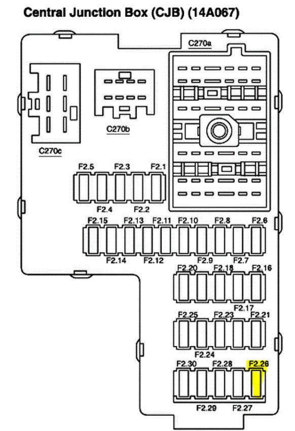

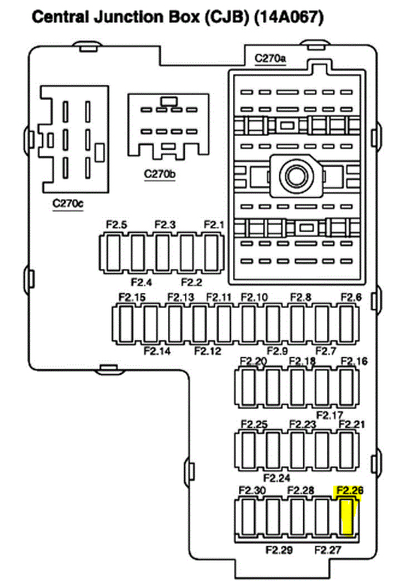

Next, I want you to check fuse 26 in the central junction box (under the dash). In addition to checking the fuse, confirm there is power to and from it. Here is a link you may find helpful:
I attached a pic below of the CJB and highlighted the fuse to check. It's possible that it failed when the battery issue happened.
See pic below.

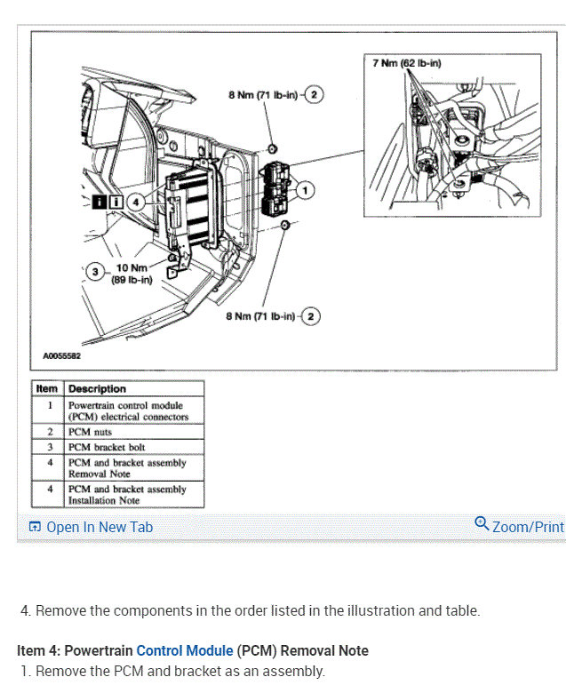

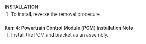

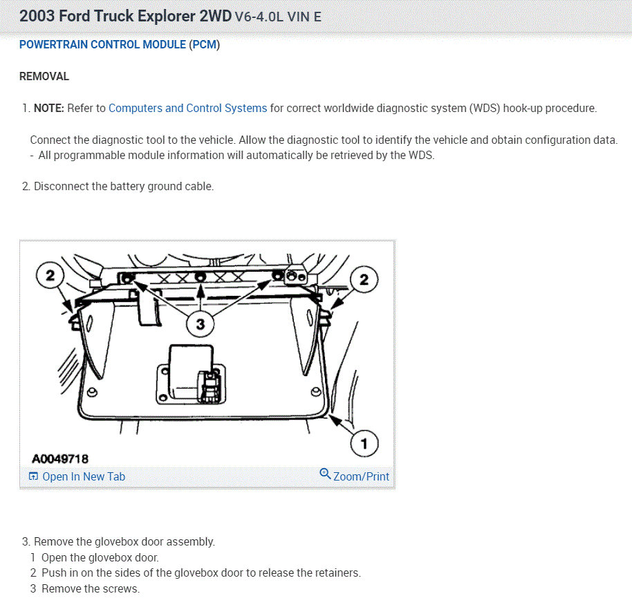

Hi Ariana,
Plug and play is figurative language indicating you install it and it's ready to work. In other words, it requires nothing more than plugging it in.
I attached the directions below for the removal and installation of the PCM. When you connect it, make sure the battery is disconnected. Once the new PCM is installed and connected, then you can reconnect the battery.
Let me know if this helps. Also, I'm sorry to hear you are going through all of this. It seems a person's character is no longer important to some.
Apr 3, 2022 at 9:24 AM
ARIANADANIELLE5345
  • 402 POSTS
In the picture I saw VIN E. Mine is vin K. Does that matter or is it the same procedure either way?

You have very good eyes, Ariana. I wish you worked for me. LOL As far as the code, the K indicates it is a flex-fuel vehicle. The procedure is the same, but I'm glad you checked.
