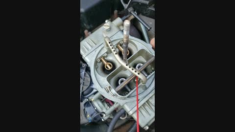

Took a little 15 second video of the stumble. Going to try to figure out what it takes to upload to YouTube. Once I do, I'll post a link to it for ya.

Let's see if this works.
https://youtu.be/rGrExHFPP8g

You don't have to upload to YouTube, you just upload directly to this site. Could you do that again without the air cleaner on, want to see what the secondaries are doing as the throttle opens, also open it a bit slower please.

I have 2 videos. 1 with slow acceleration to stumble the other I think I accelerated a little too quickly, but it does include carburetor cleaner with an improvement. I'm hoping you're able to see the butterflies in both videos.
Let me know if you can't and need a better view or anything.

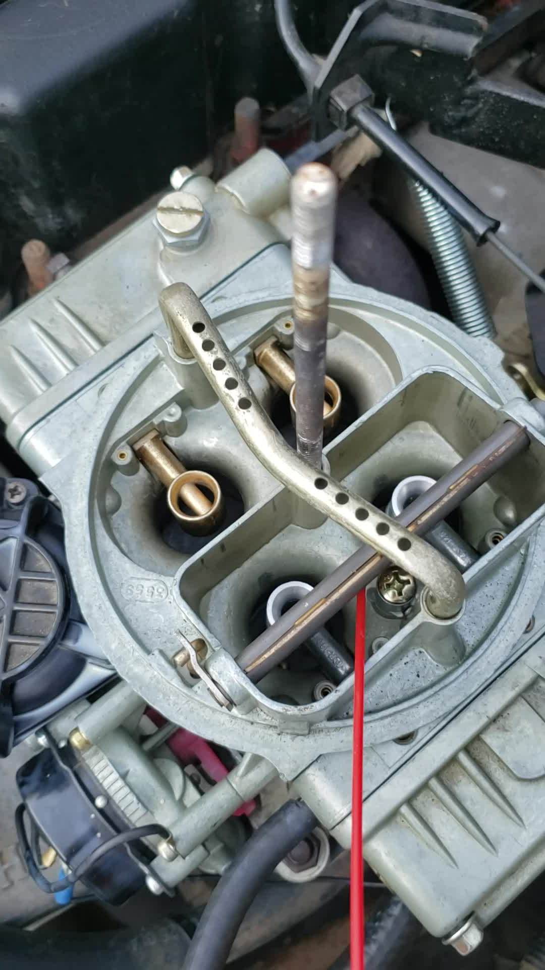

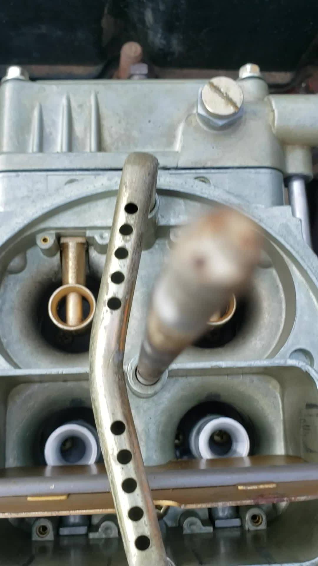

It looks like the secondaries are not adding any fuel? Cannot tell for sure but I can see the accelerator pump squirt on the primaries, and fuel spray there. The other side looks dry. Do you see fuel on the other side?

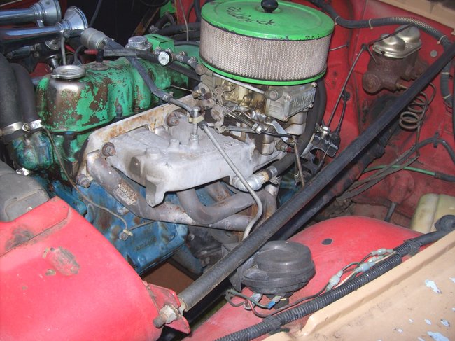

CJ MEDEVAC
  • 11,004 POSTS
That picture was meant for my last answer.
I don't think the vacuum secondaries can kick in with the vacuum being high.
I think his is like mine, no squirters on the secondary side, I feel sure the other end will be dry until it's on the road under load.

No squirter on the secondary side (single pumper not double) there are jets. The jets are stock on both sides at 57.
This carb wants 7psi at idle (optimal per Holley specs) I'm 1psi low right now
I think it wants 4.5psi to run & can't remember off hand how many gpms it wants

Try reaching in there with a tool and opening the secondaries as it stumbles. If it starts running better it shows a definite lack of fuel. Pressure wise I don't think you need to worry yet, The higher pressure just ensures the bowls are kept full under higher flow, at the moment you cannot get that engine to run hard enough for that to be an issue.

I've manually opened the secondaries as it stumbled and, yes, it picked up and ran/sounded great.

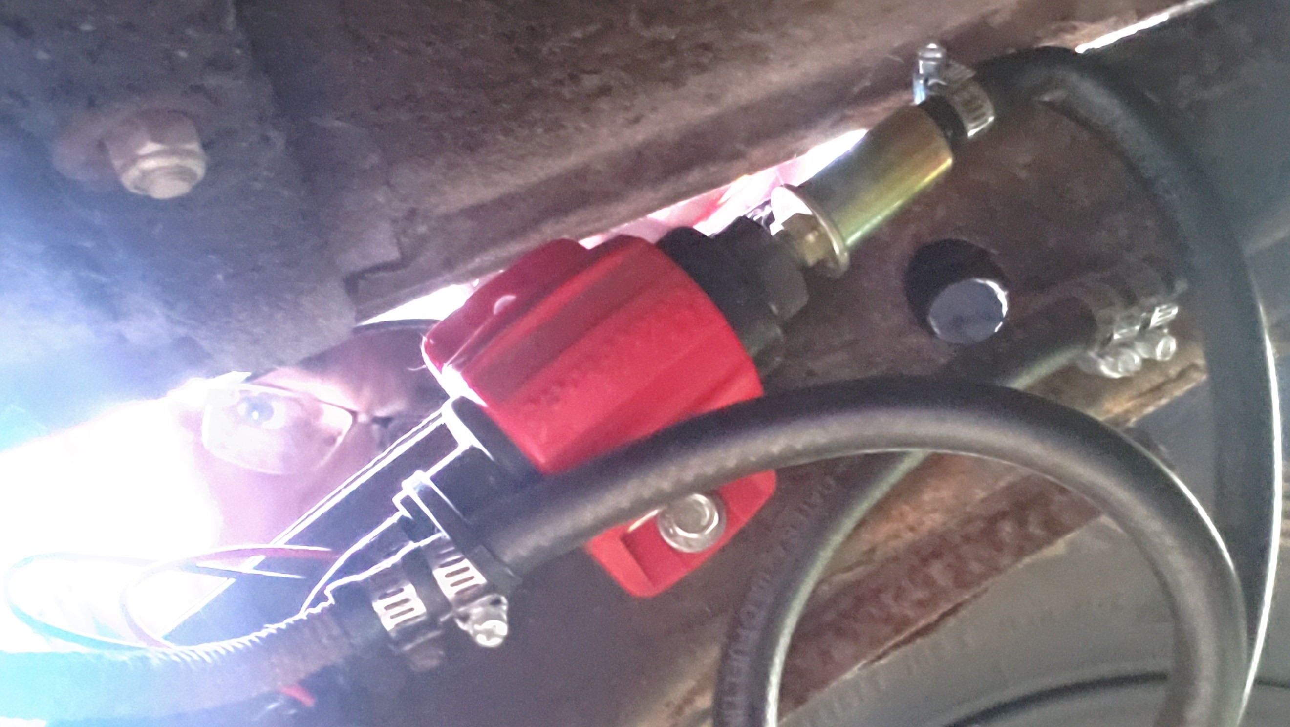

Holley has this selector thingee.
https://www.holley.com/retailer/carbselector/
You might call their support number and tell them what you have, see if they can help with the jetting.
The Medic
Jul 18, 2019 at 11:35 AM
JDUB80
  • 52 POSTS
Installed the 52 jets and 10.5pv... no change.

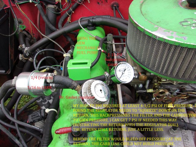

Gonna try to drop the tank so I can get the return line and 3 port filter installed.

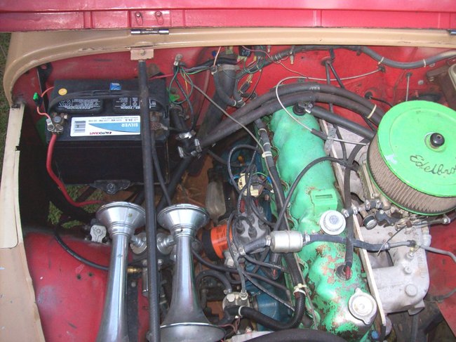

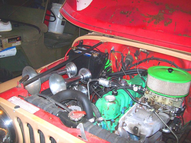

With my regulator having 2 outputs should I keep one plugged and setup like on Mr. Jeep (regulator on return line), should I install the regulator before the filter, or use the 2 port filter before the regulator with 1 output to the carb and the other to the return?
I know, too many options... I'm thinking I'll start with the setup like Mr. Jeep and regulate the pressure in the return side.
I'm all ears gentlemen
Jul 20, 2019 at 2:18 AM
CJ MEDEVAC
  • 11,004 POSTS
I think I'd stay with the latest Mr. Jeep pic I sent.
Regulator on the return line, Gauge on the carburetor feed line.
This will let you see and adjust the actual pressure to the carburetor.
(Before, the regulator was before the filter, I finally realized with the "open" return line the pressure/ volume was being bled off and could only build pressure to a certain point.
This better way, regulator on the return, still allows fuel to return to the tank, not over-powering the needle and seat. It now allows better pressure and volume to the carburetor. It's sort of like squeezing the return line with pliers to increase everything before.)

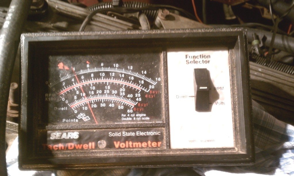

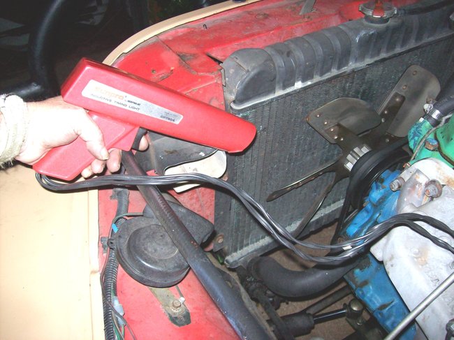

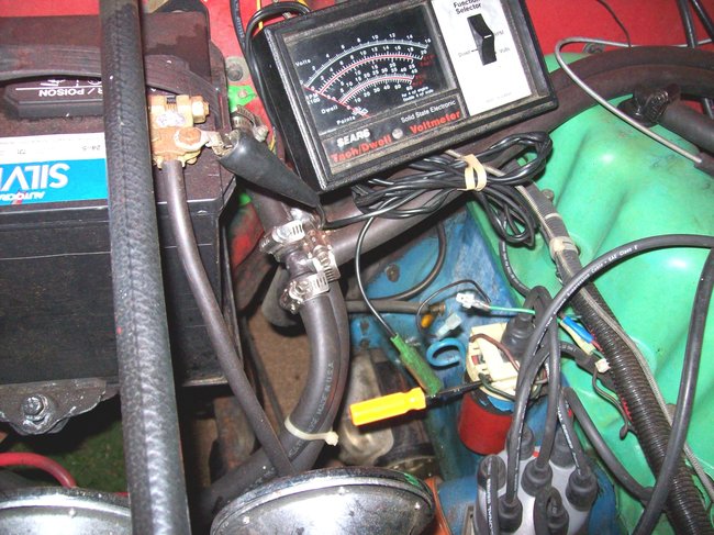

Just had a coworker suggests converting my distributor to a points and condenser type... pro's? Cons?
Fyi: I don't own a dwell meter or possibly other tools for that setup, so I'm rather hesitant to go that route. Still thought I'd throw it out here&get other thoughts on it
Jul 23, 2019 at 3:25 AM
STEVE W.
  • 15,349 POSTS
Electronic is a lot better that points. Hotter spark, better control and less messing around as they don't wear like points.
Jul 23, 2019 at 6:58 AM
CJ MEDEVAC
  • 11,004 POSTS
I concur!
Stay OEM
Everybody wants you to convert to something totally odd and hard to work on. On a Jeep, there's really no more betterment in changing stuff, just more confusing to hook up and use. I suggest leaving the distributor and ignition system alone. Unless you want to make a backup system to use after the ICBMs stop falling and the EMPs have destroyed all electronics. A point system could be installed fast and be usable.
A dwell/ tach is a really good tool, I like it better than using a vacuum gauge to tune the carburetor. A plain Jane non-adjustable timing light works well too.

As far as tools. I have an adjustable timing light (not a fan, using my father in laws normal one). Vacuum gauge and tachometer... I mount it under hood when needed, later I'll install inside the cab, cause I tend to watch rpm's while driving.

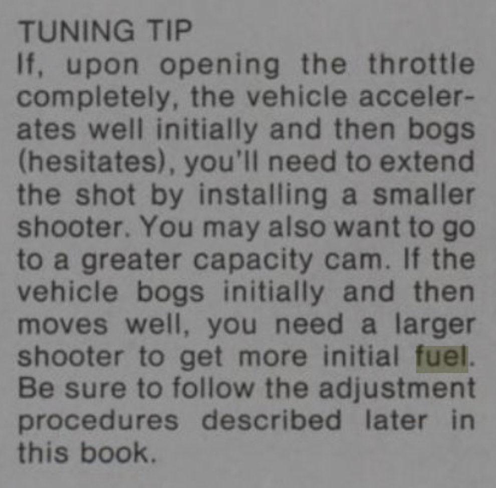

Guys, I finally had a little time to work on Carl... in the meantime I've been reading anything I can on tuning Holley carbs.
To keep this under 5000 words... once I got home today I changed out the pump cam. First I tried the blue, then the brown. Gotta say, MAJOR improvements! Actually got to drive him down the road today & made it up to 50 fairly quickly.
From what I was reading, looks like I still need to get a much smaller shooter (pump nozzle) to extend my pump shot a little longer.
Can't say how excited I am that something improved the way he runs the way I was expecting it to... especially after so many attempts and misses.

It seems that I was not properly setting my timing. Specifically my vacuum advance... I might not have understood there was an adjustment for that. (It's okay to laugh, I laughed at myself)
Once i learned of my mistake, i spent a few minutes adjusting and voila! He's not falling at his face every time I open up the throttle.

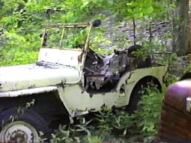

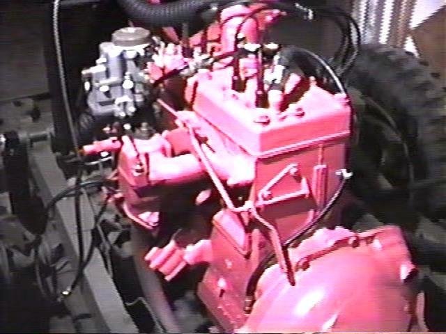

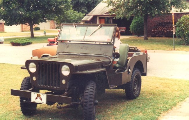

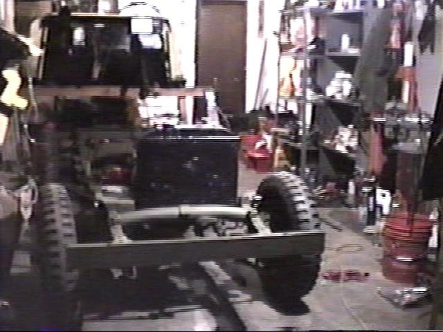

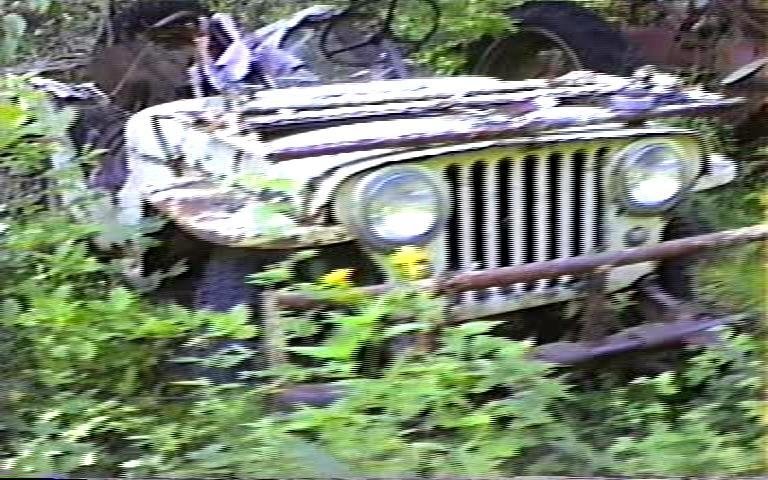

Just a thought, I've answered bunches of CJs, and a lot of other vehicles too. As far as the CJs go, you might Google search 2carpros, cj medevac, Jeep and then hit "images". You might find something that interests you. All of the stuff is not mine, but quite a bit is.
Well my pictures did not win either the front or back cover of the recent Willys parts catalog contest. :-(
These were some I did/ or was going to send in.
Send us an action shot of yours!
The Medic
