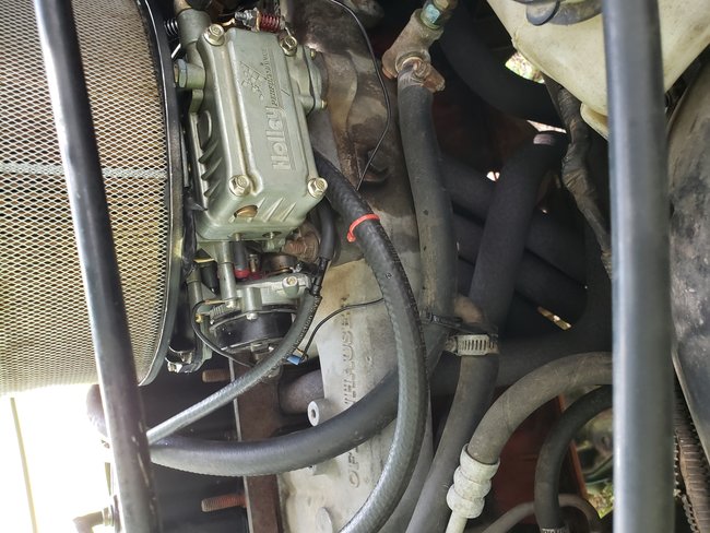

I've seen/read numerous posts on here about CJ's stumbling, tried most suggestions but can't seem too get mine running right.
Vehicle: 258, with Holley truck avenger 470 carburetor. Nutter bypass. Computer is sitting in the back seat as of an hour ago. (All wires cut by PO, so I pulled it out of the dash today.)
Carburetor details: 37 squirter, currently 10.5 power valve (initially had a 6.5 then tried a 2.5 trying to get something to change to no avail.) can't remember primary/secondary jets but i verified that they are stock. Full manifold vacuum with 18-20in, approx 8* initial advance. (Need to check again. I don't trust my timing light. Think I broke it)
Symptoms.. well really only one starts and runs great, as long as I only use the first 1/4 or so of the throttle. Anything beyond that, at any time, the engine stumbles and will quit running.
I'm sure I'm leaving it details that would help, but I'm not sure what they are yet. Let me know and I'll definitely find out or provide them as soon as I can. I am brand new here, so I don't know how the notifications work yet, but I'll be checking in anyway.
Thanks in advance!
Sorry, currently no engine pics. I'll add some tomorrow though. Advice on what to photograph is welcome.

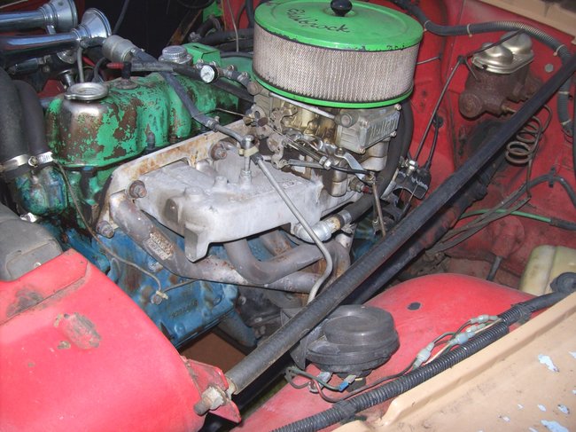

JDUB80
  • 52 POSTS

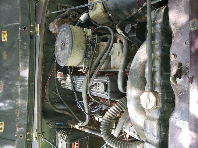

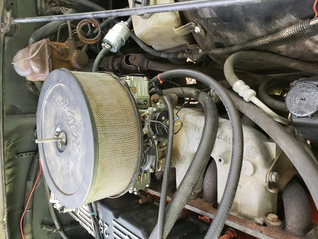

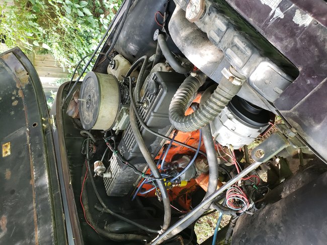

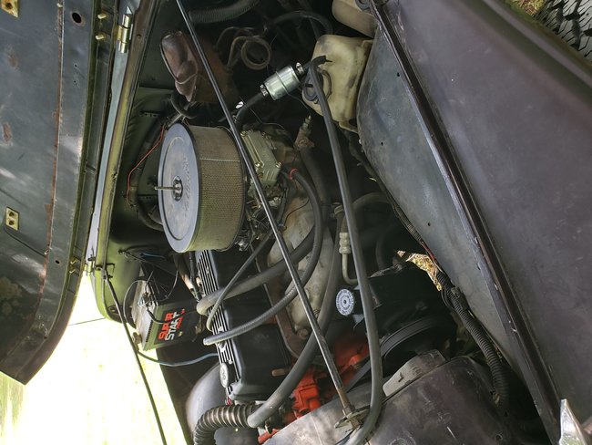

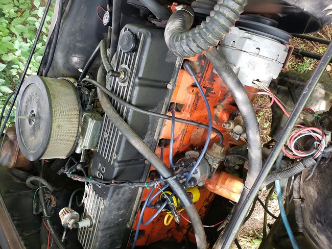

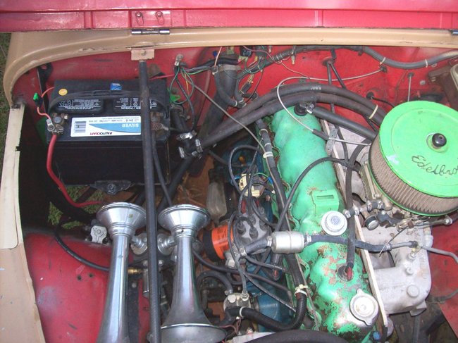

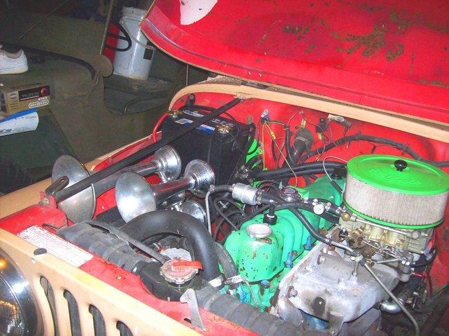

A few pictures under the hood. seems like I read I'll only be able to upload three at a time... so here goes nothing.
Jul 6, 2019 at 3:34 AM
JDUB80
  • 52 POSTS
Round 2
2 this time, 2 next.
Jul 6, 2019 at 3:36 AM
JDUB80
  • 52 POSTS
That's all I got for now.. going to check timing with a borrowed light that I think is better than mine.

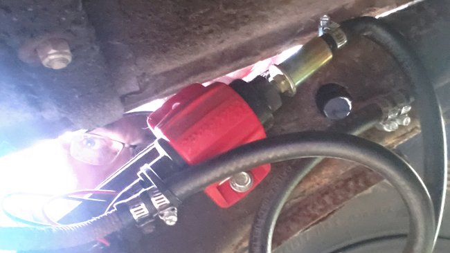

I have an electric fuel pump on frame near tank... noticed a small kink in lines but I don't think it'll effect flow (fingers crossed, but I'll get a pic later. )
The mechanical is still mounted to the block, untested.
Currently only have a 2 port fuel filter and return line is dangling (& in BAD shape) new 3 port filter and return line should be here Saturday.

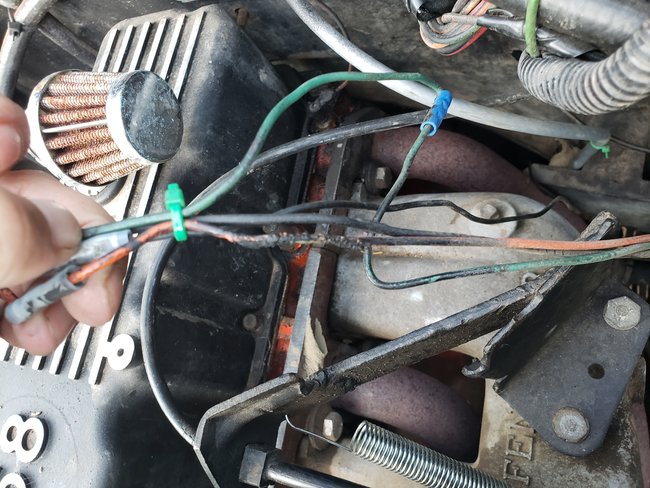

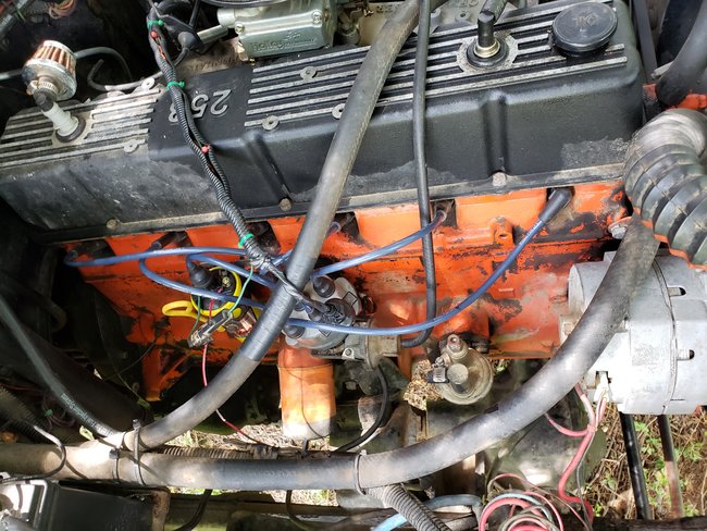

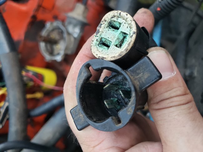

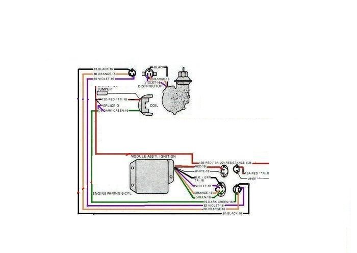

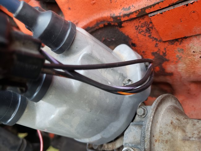

JDUB80
  • 52 POSTS

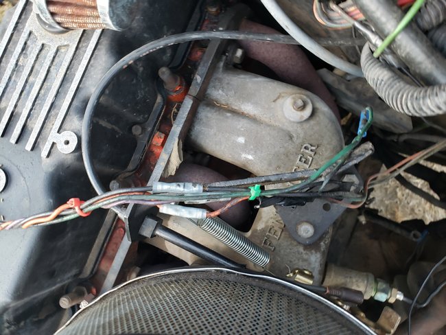

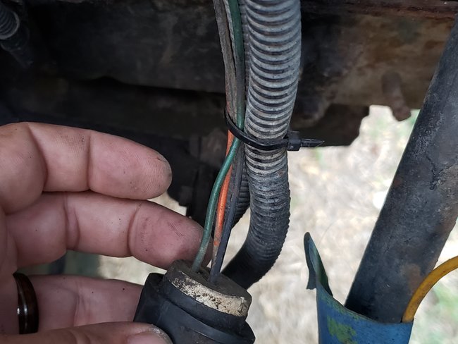

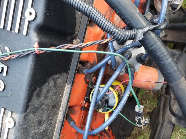

Pictures as promised.

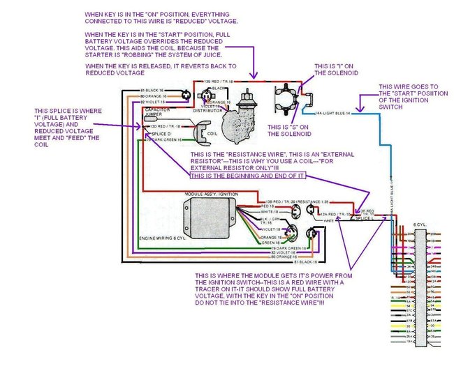

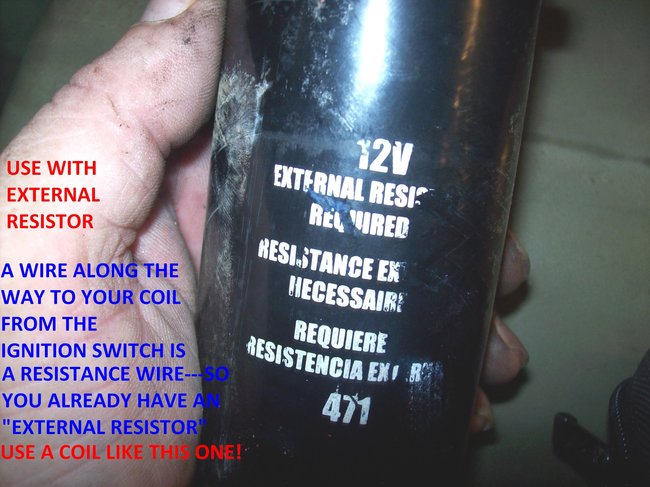

While I was unwrapping wires from the distributor, I noticed a black wire that was disconnected. It turned out to be a piece that was spliced into the purple wire. The orange, black, and green (from coil) all go into the ignition module. Also there was a single wire with a butt connector coming from the ignition module. It appeared to be either dark blue or purple, couldn't really tell nor could I get a decent picture without removing stuff.
I guess my question is: should I reconnect these two wires? The diagrams I found weren't clear enough for me to determine and I don't wanna mess anything up.
Also, I noticed a section of orange wire that appears to have touched the exhaust manifold. I believe it's visible in the pic with several butt connectors. I'll get that repaired and fix up the connections. (Need to get a soldering iron.)
Is there anything else jumping out at you that needs attention or any additional pics needed?
Carl and I will be here once you're able to reply.

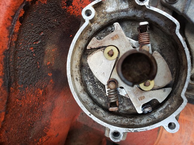

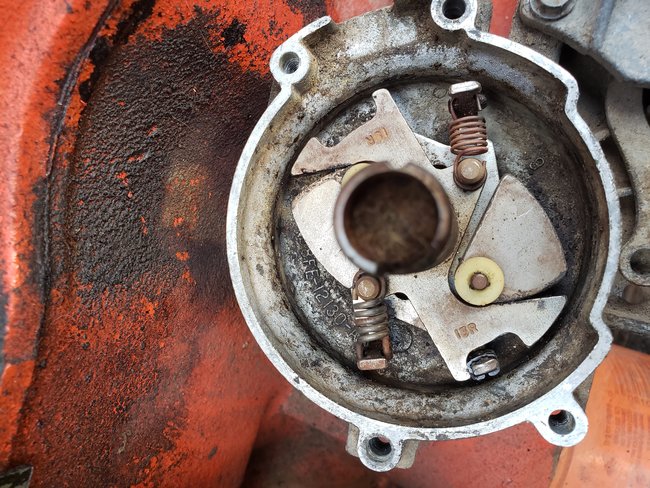

Jul 11, 2019 at 11:42 AM
CJ MEDEVAC
  • 11,004 POSTS
Let's go back to ported vacuum while we try to figure this out.
Let's go into the top of the distributor.
Dig on down till you get to the "weights" at a standstill they should have springs sucking them inward.
Spring broke? (or weights unable to move)
They will permanently be thrown outward.
If this be the case, somewhere in the past the timing was, let's say 8 degrees.
Spring broke at some point, timing suddenly went to (maybe) 18 degrees.
It got discovered that the timing was off at some point and time.
It was reset t 8 degrees.
All seems good now?
Nopey Opey!
We have lost "mechanical advance" completely when Mr. Spring broke!
It will not climb into the RPMs, it will act like it's holding back when it's accelerated.

I took the distributor apart a week or so ago. Decided I didn't know what to do, so I reassembled it. Nothing appeared broken, but I didn't know what I was looking for.
I'll pull it apart again tomorrow evening for pics. (Too dark to do anything right now.)

Fuel pressure to carburetor?
Voltage at positive side of coil with key on? (trying to find out if you are hooked to the resistance wire or not).
If hooked to resistance wire, is your coil designed to be used with external resistance as was the OEM coil. See picture 1.
Wire colors are really irrelevant, The main thing is do they start and finish like in picture 2.

Here's the coil I have on right now:
https://shop.advanceautoparts.com/p/accel-super-stock-coil-8140/5024269-P?navigationPath=L1*14923%7CL2*15034%7CL3*16064
Jul 11, 2019 at 3:27 PM
CJ MEDEVAC
  • 11,004 POSTS
Lower down in your link, I found text saying it must use an external resistor.
So what is the voltage at the positive pole of the coil with the key on?
This will let us know if you are tied into the original resistance wire
or
If you are tied into a regular ole wire and need a ballast resistor installed in the system.

Today, I rewired the 3 wires from the distributor to the ignition module, keeping as much of the old wires as possible. I removed the melted places and previous connectors. Started him up, brought up to temp. No changes. That's ok, it's beer thirty.
Now on to the requested testing:
Voltage at coil on positive side is 7v. Is this lower than it should be? (I know it shouldn't be the full 12v)
Btw, negative battery cable disconnected, gave a 12.8v reading. Random test while I had the meter handy.
Fuel pressure at carb with ignition key on was 9-10lbs (with a slight leak at my meter)
I'm guessing I should get a regular with the new return line installed?
Attached are a couple pics of the mechanical advance, looks fine to me... but again I dunno what it should look like. Thoughts?
Last pic is my pickup coil plug/ connection. Could this be causing an issue or is it something to cleanup later?
Your turn, my friends
