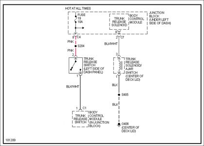

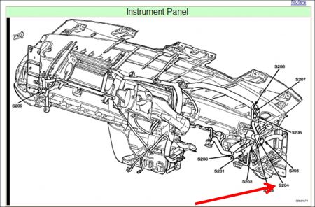

I have attached the circuit for the trunk release if that helps at all. But as we both know it goes through the BCM.

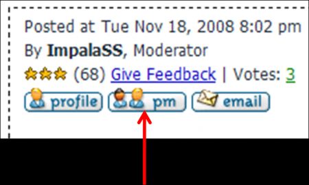

Oh. . .. . ...if you would and don't mind, can you go into the PM part under my name and provide me with your complete address. . .. . .. . ..this way not everyone on the post knows it.

Thanks for the schematic. I printed the same one last night just before throwing in the towel for the day and buttoning everything up. I've compared this schematic to the main one for the BCM circuits and just now realized that I was mistaken about the BCM schematic as it relates to the trunk release circuit. If you look for the C-4 pin 8 designation on the BCM circuit schematic you won't see it. It was really causing me some concern last night because the C-4 connector from the trunk release schematic isn't the C-4 on the BCM itself, like I misread the trunk release schematic to mean. I now see it should have been the C-4 of the junction block. This means that my problem with the trunk may be a junction block issue. DRAT! That also means the other issues may be junction block and not BCM.

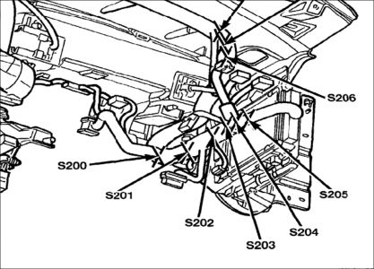

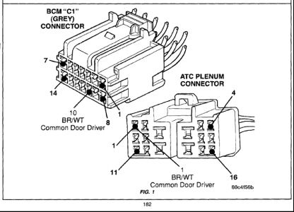

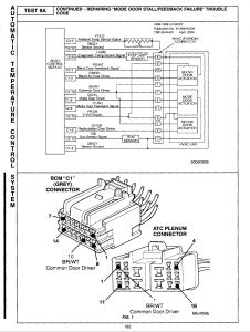

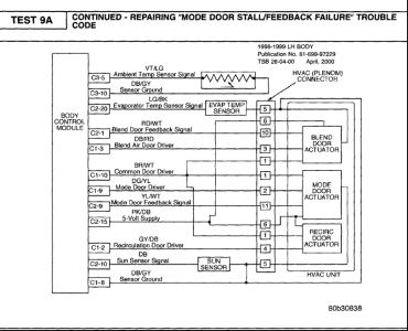

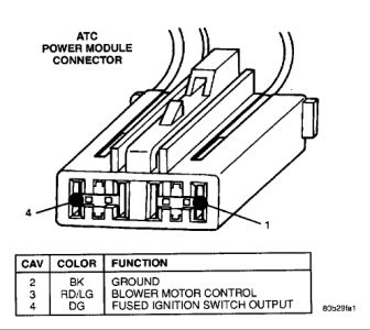

Hey, I attached a couple of pics. . .. . .. . ..not sure if that helps. . .. . .. . ..
Also, have you tried to let it recalibrate itself?? I thought about that when you replaced it and it did okay. . .. . ...then went weird again. . .. . .. . ..just a thought. . ...
REPAIR PROCEDURE:
1. With the vehicle at room temperature 10 °- 27 °C. (50 °to 80 °F.), remove the M-1 circuit fuse for ten minutes to erase DTCs.
2. Install the M-1 fuse and start the vehicle, this will initiate the HVAC system calibration. Allow approximately five minutes for the calibration to complete.
3. Operate the vehicle and HVAC system to verify that Symptoms and/or DTCs are gone. If tapping noise or Blend Stall/Feedback DTCs re-occur, additional diagnosis will be required.

Yes. . ...sorry I didn’t respond on the PM. . .. . .I did get it. . .. . .. . .thanks. . ...I should have responded back to let you know. . .... . ...I did send you a snail mail. . .. . .. . ...it is crossing the frozen tundra heading to sunny CA.

Well, I know where to find the "secret" M-1 fuse now.
In pokin' around the net today (really busy at work as you can tell.) I found one of the other sites that offers help via a similar process that 2carpros uses and found a parallel discussion where the car owner basically said he had looked all over the car for an M-1 fuse and couldn't find it. Well it turns out that the name "M-1 fuse" actually refers to one of the fuses on the Junction Block rated at 10 amps. You know you got it when the radio display goes blank. I'm guessing this is the "always hot" fuse indicated on the BCM schematic. Less hassle this way as compared to removing the battery negative terminal. "Every day is a learning experience."
I'm very tempted to purchase the Chrysler body diagnostic manual (81-699-97229). I can get it for about $22 plus shipping from an online source. It would be great if the libraries had a technical manuals section where you could just go in, browse, make notes, copy pages, etc, then go home and play with the car. In looking around, I also ran across some Motor Manuals of the same vintage of the Beast. I used to use Motor Manuals all the time "back in the day". The other option is to cave in and order the Chrysler service manual on CD at $90. The problem is, I already know they're going to say, "Now, hook up your scan tool and write down the codes."

Isn't that interesting......... You pull the fuse and it goes blank etc.......I am sure you are going to do some poking around in that area....... Corrosion, ohm a fuse..... Etc. If I remember correctly from the beginning of this movie..... Scene 3 take 4, didn't you have a minor front end bang up and that is when we thought it may be that sensor on the front?
Did the other information "the pics" help at all or did you have that in your manual?

The image you included in your posting didn't really help that much because its size is reduced significantly and the resolution is way down. I've tried copying the image and viewing it outside of the posting, but the resolution prevents you from even reading the labels in the image. Thanks for the thought, though. If we were working from the same manuals, you could just tell me the image you're looking at. In some of the earlier postings, I recognized the images as being from the Mitchell manual I'm using. Those helped me to be sure I was in the right area.

I went back and was looking over some wiring diagrams again. The first one you see that fuse 23, Dark Green goes to the ATC.
Fuse 17, white wire goes to the ATC also but is probable for lighting.
https://www.2carpros.com/forum/automotive_pictures/248015_Picture7_14.jpg
Now thought one, splice a wire in and put a meter on it and while you drive around you can see what the volts are. If it goes wacky. . ...you see the reading.
Okay, next pic. By the way. . ...both of these pics are spliced together to make them bigger so there is some goodies that are missing but I didn't think they were important. I just followed the wire we were looking at.
Okay, next pic. . .. . .. . ..the mystery fuse 19.
You follow that little red wire guy and it goes from fuse 19 to spice S204. I thought this was interesting. . ..look at what is connected to the splice besides the ATC. . .. . ...yep. . ...the trunk release switch.
Okay, so splice S204 is located on the left side of the dash. I gave you 2 pics of that. . ..a broad pic so you have an idea of the location and then a close up. . .. . .. . ...it looks like the entire splice is pink wires going to all those different items.. . .. . .. . ..
https://www.2carpros.com/forum/automotive_pictures/248015_Wiring_1.jpg
https://www.2carpros.com/forum/automotive_pictures/248015_Splice_204a_1.jpg
https://www.2carpros.com/forum/automotive_pictures/248015_Splice_204b_1.jpg
Me, that is the first place I would go. . ...I would open that splice are up and see if the ATC and Trunk Release wire are chaffed, touching etc somewhere up and down that area and follow those wires as long as I could.
Let me know if the images are not good enough for you. . .. . ...I will find other ways to get them bigger or to you. Who knows, maybe I could blow them up, fax them to the local Chrysler dealership and. . .. . .. . .. . .okay. . ..maybe not. Really though. . .let me know and we will figure something else out.
Here is the pics from the last time...blown up more.
https://www.2carpros.com/forum/automotive_pictures/248015_Test_1_1.jpg
https://www.2carpros.com/forum/automotive_pictures/248015_Test_2_1.jpg

I looked at the trunk release issue again this afternoon and still have questions.
The power from fuse 19 (M-1 is visible below the fuse on its raised mount!) Is available from the fuse itself, through the junction block and connector C4 pin 8 to the trunk release switch and then to the BCM connector C1 pin 1. I checked continuity of the circuit as well as looking at the availability of power throughout the circuit. On the surface it would seem to definitely be the BCM since I have a signal in from the switch but no response from the BCM. Only problem is this is a logic circuit not just a simple switched circuit. The system will only unlock the trunk if it senses that the transmission is in Park. That is not shown on the manual's schematic. This information comes from the Owner's Manual.
I'm ready to ditch the Mitchell manuals and fork over the bucks for Chrysler maintenance manuals or another system that tells me the entire story. If I went entirely on what is in the Mitchell system, I'd be replacing the BCM for this problem. I have until Jan 5 to make a final decision on this and either keep and use a BCM I received or return them for credit. If I finally reach my limits and decide to just live with the non-auto ATC, I can rig a diode to pass the power around the BCM and direct to the circuit going to the trunk release solenoid. I'd much rather locate the real problem and fix it, but there may come a time where I decide it's not worth the headache, especially if I can't get a manual that will tell me all that I need to know about the system. :-(
