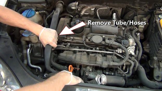

Step 1: Serpentine Belt Removal
Unbolt and remove any tubing or hoses to gain access to the serpentine belt for removal. This tubing is used for emissions and air filter intake proposes and is usually easily removed by undoing minor bolts or screws. Next, the serpentine belt must be removed which drives the compressor except for hybrid and electric cars.

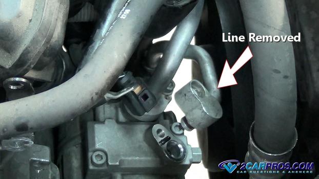

Locate and remove the high and low side refrigerant line mounting bolts or flare nuts depending on the manufacturer's design. Again, on some models this step may need to be performed after the mounting bolts have been removed and the compressor is loose.
remove compressor hose high side
Firmly grasp and wiggle the bulkhead of the refrigerant lines to slowly pull upward to disconnect them from the compressor. There is an O ring seal which can make a tight fit, also a small amount of refrigerant (pressure) maybe released as well which is normal. Complete this step by removing both high and low side hoses.

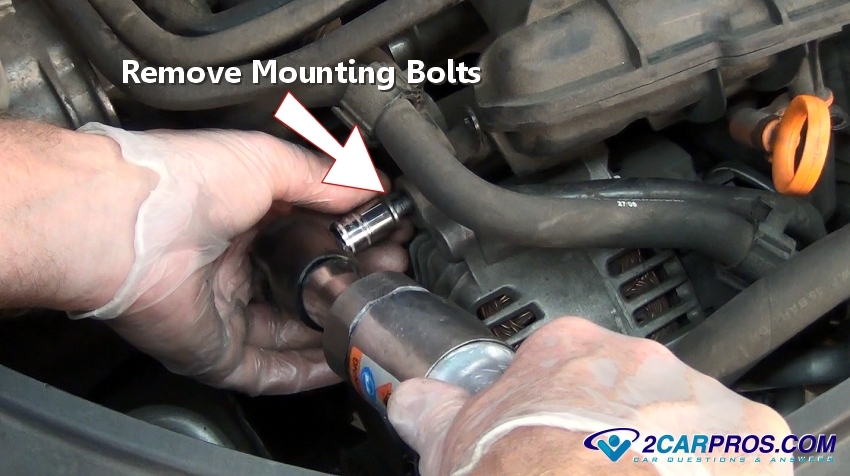

Locate and remove lower and upper mounting bolts. These bolts can consist of long and short bolts which sometime can be obscure and difficult to get to, if so use a universal joint socket or small wrench to aid in the removal. Always leave at least one loose bolt connected to the bracket or block to hold the unit in place.
remove compressor mounting bolts
Grasp the unit while removing the last mounting bolt. The compressor is a little heavy and a bit awkward so be careful it doesn't fall and cause damage to the unit or yourself. Once completely loose remove it from the engine bay. This can sometimes take some finagling, or possibly even loosening the engine mounts while using a floor jack under the oil pan with a block of wood to help lift or lower it slightly. Other times the radiator or cooling fan shroud must be removed as well.

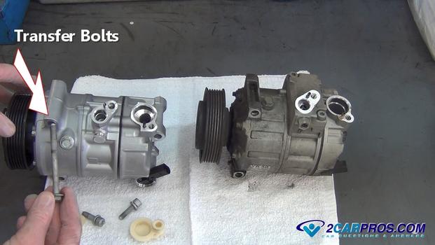

When installing the new compressor into the engine bay it's a good idea to transfer some of the mounting bolts from the old unit to the new one before lowering or raising it into the engine bay, this will help for an easier installation.
transfer compressor bolts

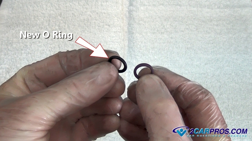

Step 5: Replacing O Ring Seals

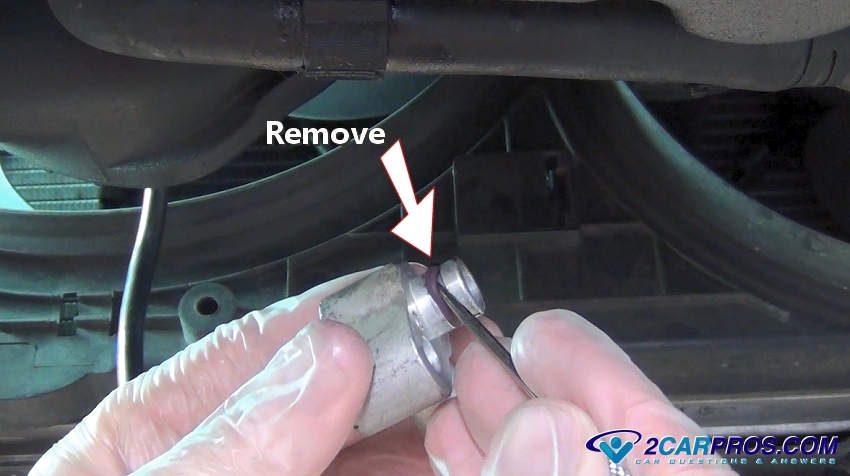

O rings are used to seal the high and low side lines to the compressor housing. These sealing surfaces must be clean and free from dirt or damage to keep them from leaking. Use a small screwdriver or pick to carefully remove the old O ring seals from both the high and low side lines without scoring the sealing surfaces.
remove o ring
Match the old O rings to the new ones to ensure a proper seal. Keep an eye on the O ring thickness because some rings can be smaller in diameter then others. It's a good idea not to reuse the old seals because they become flattened over time due to pressure and heat and may leak which would cause the job to be redone.
new o ring seal

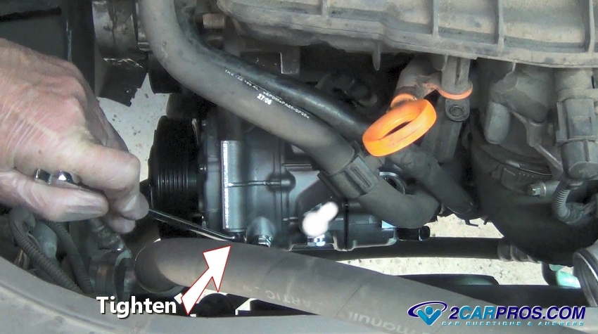

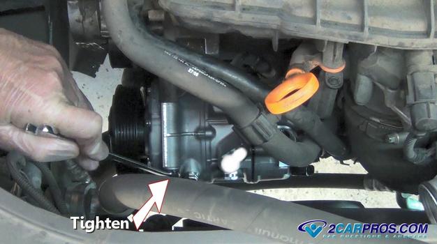

Once all mounting bolts have been hand threaded in, use a wrench or socket to tighten the mounting bolts evenly and in a cross pattern. This will help to not distort the housing which can cause premature failure.
tighten compressor bolts

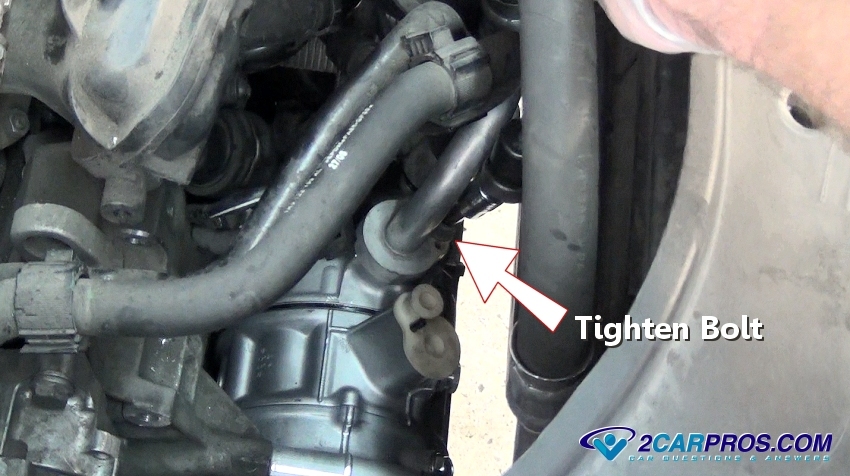

Remove the port dust covers and install both high and low side refrigerant lines with the mounting bolts and then tighten. These bolts don't need to be extremely tight just snug enough to not come loose and seal against the housing. Torque specs for the bolts can help.
tighten line bolt

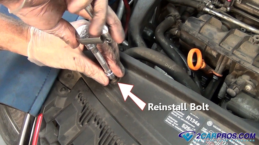

Reinstall any tubes or hoses removed in the replacement process, continue by tightening all bolts, screws, clips or brackets previously removed. Now the system is ready to have a vacuum down and recharge service performed. Never simply fill the system with refrigerant because there is moisture is present inside the system due to the normal atmosphere that entered once the system was opened. This can cause the compressor to fail prematurely and the AC system not to work as well as it should.
reinstall bolt
